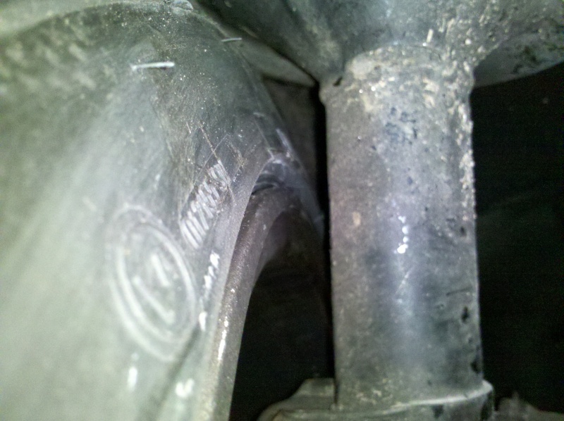

Just whipped my rear wheels off and i dont know if its some sort of optical illusion, but it almost looks as if the inside of my tires are lower than the outsides. as if its dipped in the middle. but there is more tire wear the the middle (at 32psi) which I think is bizarre. I thought 32psi was ideal? Any takers?

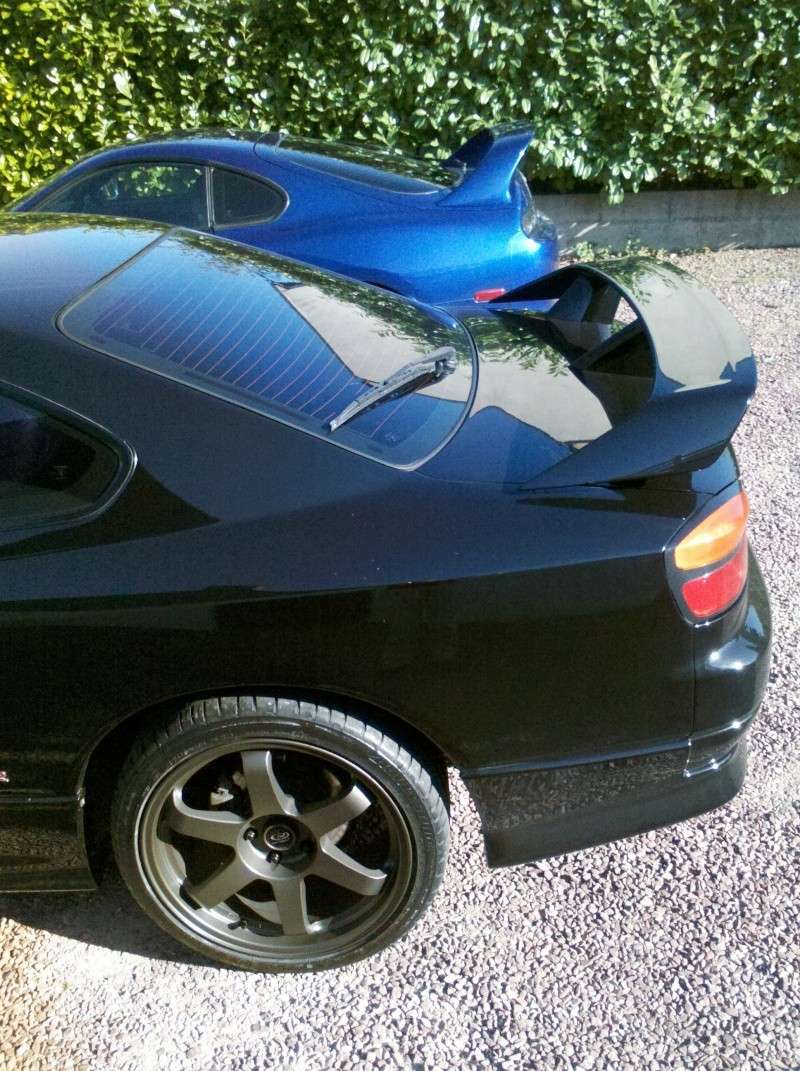

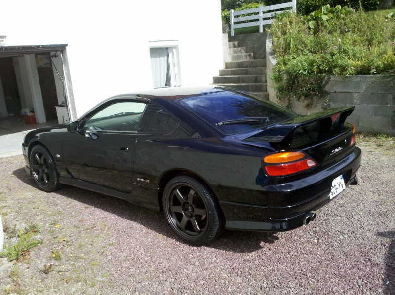

Wheels: Rota Drift Grid Matte Bronze
Offset: +30
Tyres: Bridgestone Potenza S001 - 225 40 18 92Y XL
Spacers: no
Suspension: stock
Comments:
These wheels fit perfectly on a stock S15 :
The offset is perfect, not too much. The wheels are about 0,5 in out of the fenders.
My rear fenders are rolled, and I tried the same wheels with an offset of 20 and it was OK.
(ET 20 wasn't OK without the rolling, but I think ET30 will be OK)
Careful with the front shock absorber : there is not a lot of room between the rim and the shock.
With a stock shock, there is about 1/4 in (a bit less than 1 cm)
At rear, there's still a lot of room...
Compared to the stock wheels, the handling is incredibly better...

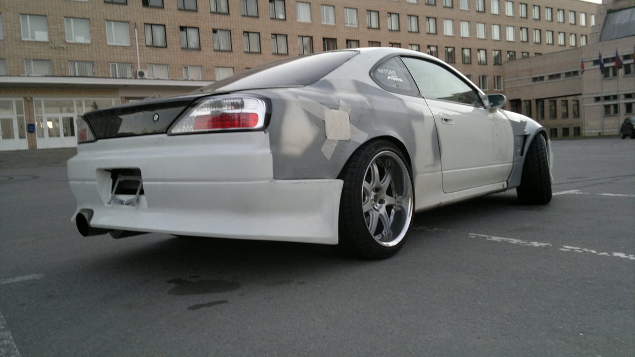

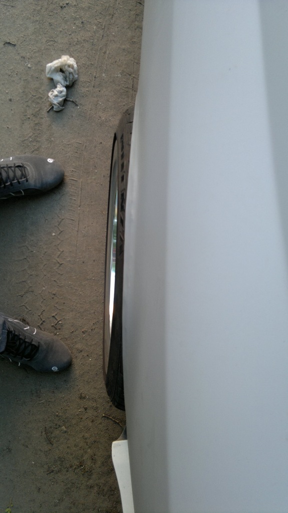

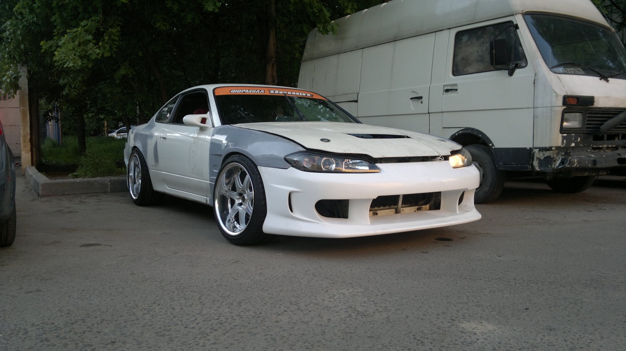

Hello!
I got 18x10 +12 all around. Here is some pictures before fitting a widebody:
p.s. Sorry for big pictures...

It was my first season with this wheels, so I had 265/35 18" all around.
Now I have a pair of 255/35 18" and thinking about other pair of tyres.... or may be another set of rims :)
