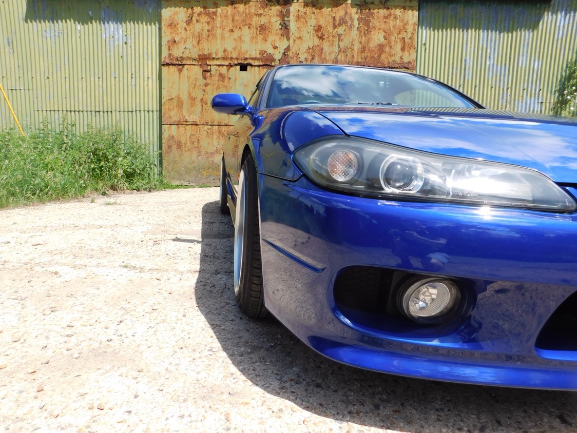

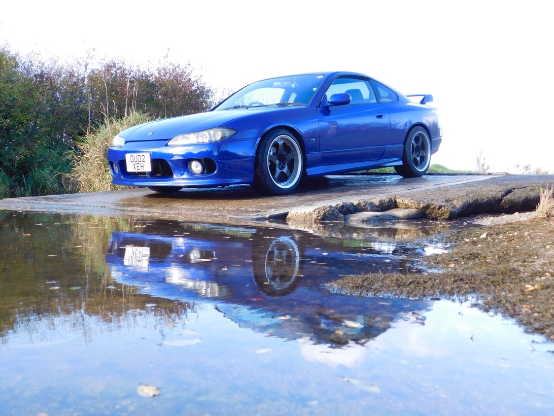

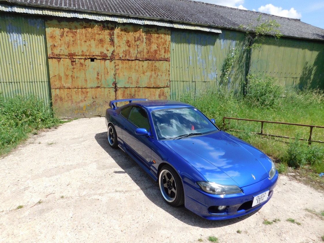

You could run those offsets but you would need a fair bit of camber to actually fit them under the arches (unless you did some serious arch flaring which always looks rubbish in my opinion).
To give you some perspective, I have 17x9 ET22 (front) and 17x9 ET19 (rear) and with no camber they both stick out by a good 10-15mm so I have an ever so slight amount of camber (maybe on about 1 degree) so that they fit nicely.
^ The front is about an inch lower since that last photo was taken but it should give you an idea of how much they stick out!

Thanks man! Your advice is great and you've really helped me with making my decision!
Your car looks amazing - good photography as well (love that one with the reflection in the water!)
