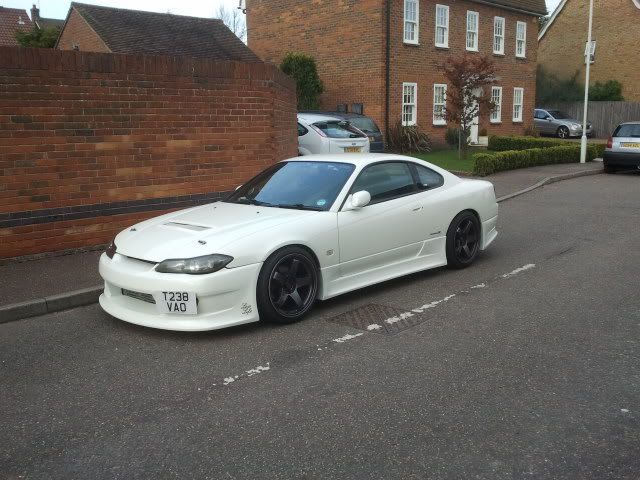

Rota GTR drift
Fronts - 18x9.5 et 30 225/40/18 tyre with a 20mm spacer...3.5 deg negative camber
Rears - 18x9.5 et 30 225/40/18 tyre...2 deg negative camber
no rubbing, sits V close to the coilover locking collar but clears it with the smaller width tyre on, 235 rubbed the rim protection o the collar
rolled arches all round. No flair.
