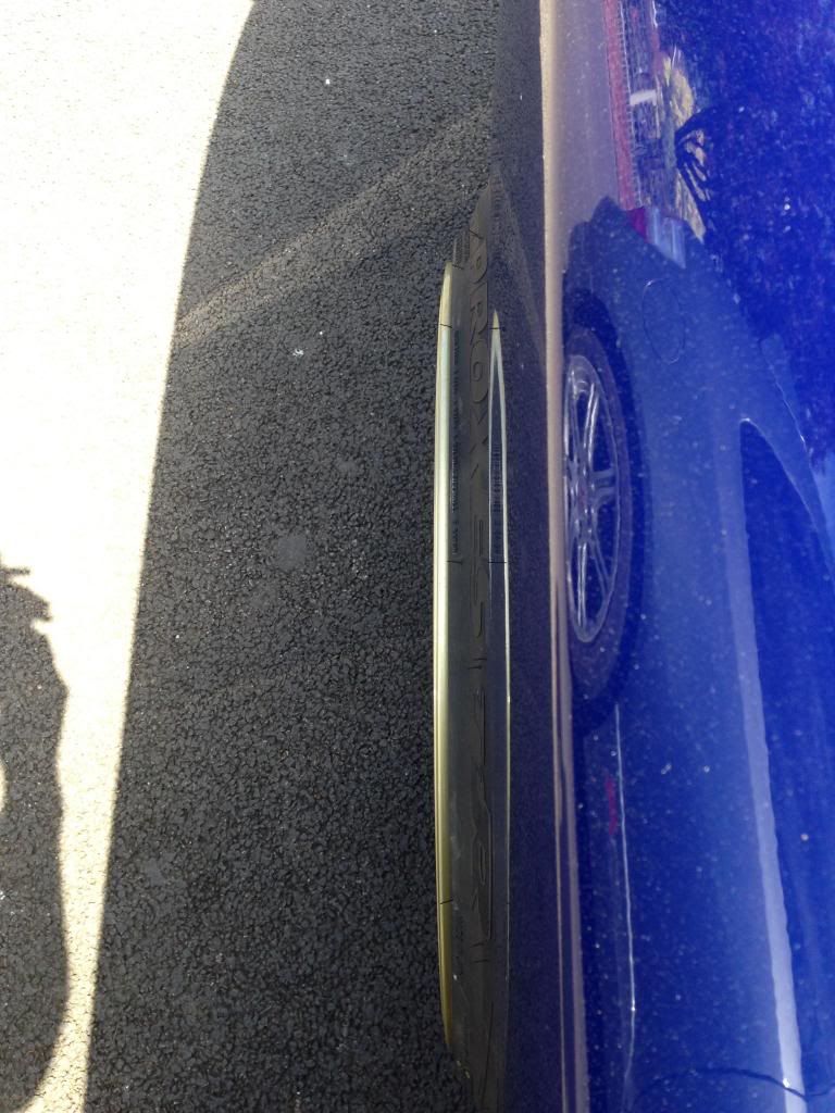

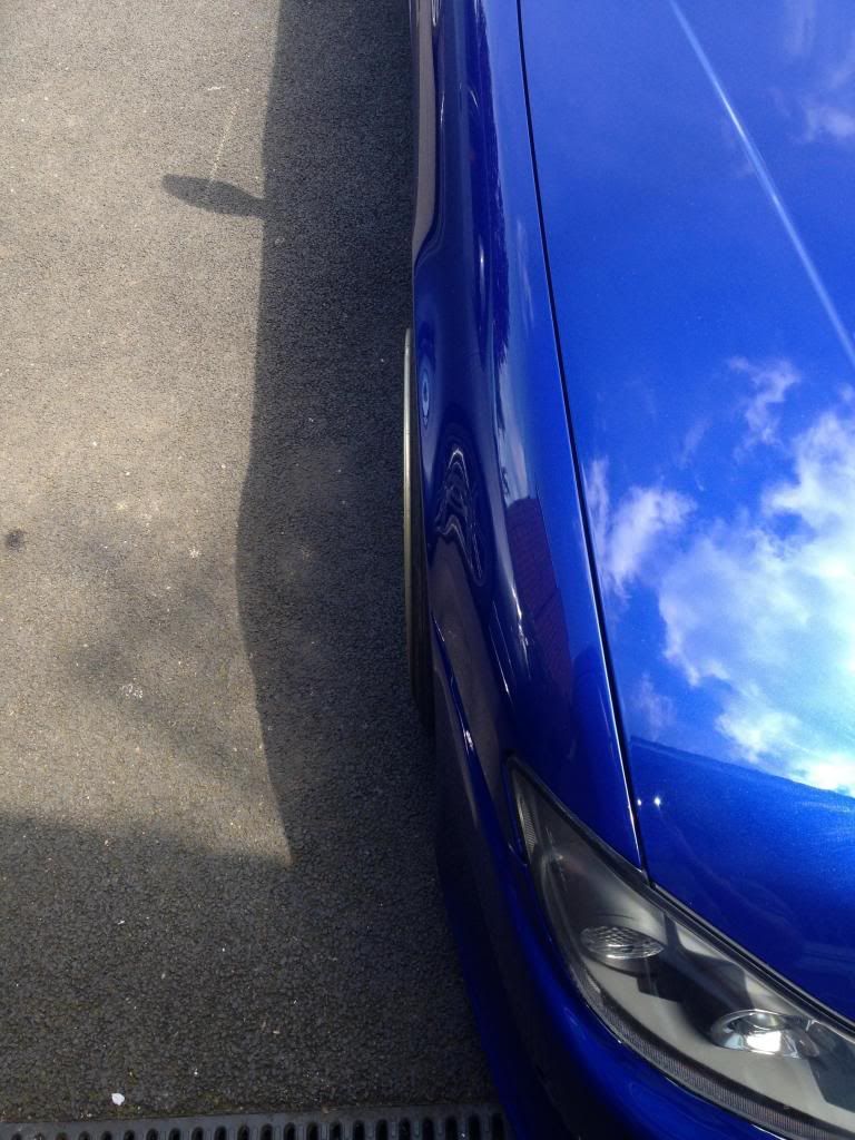

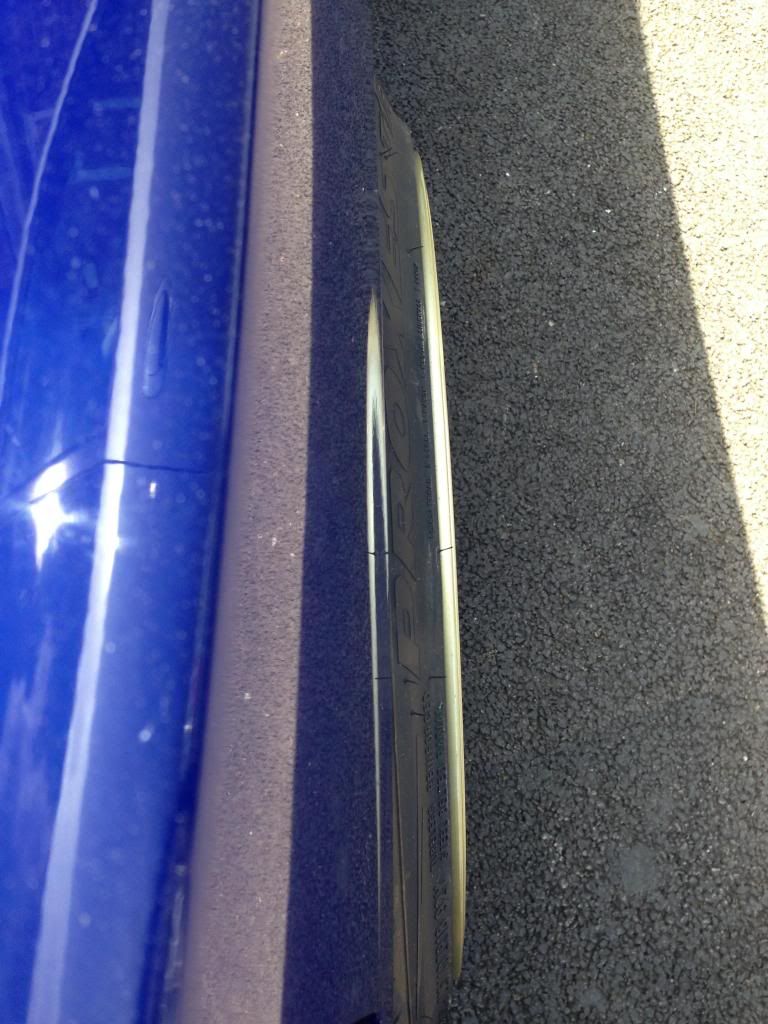

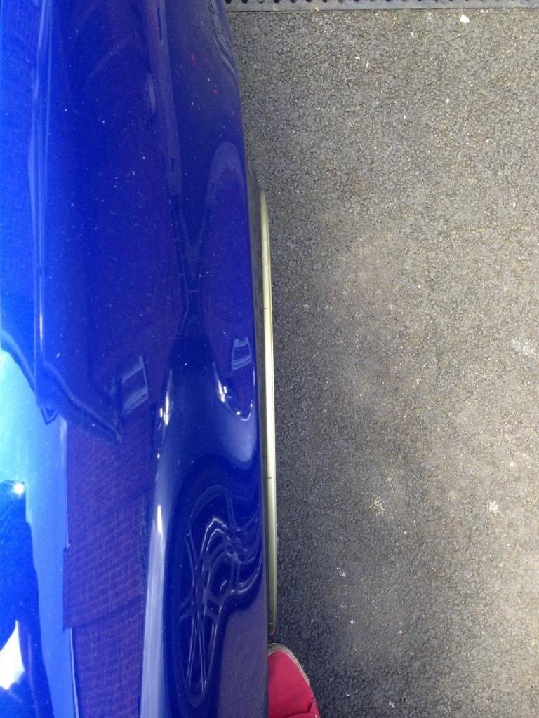

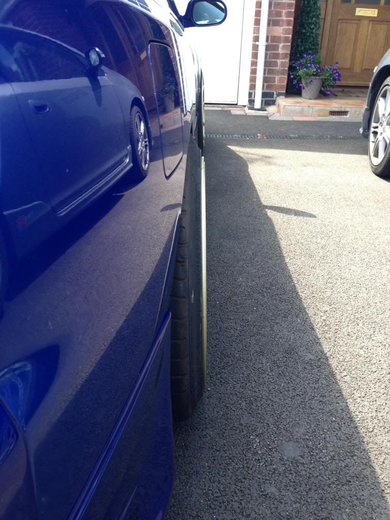

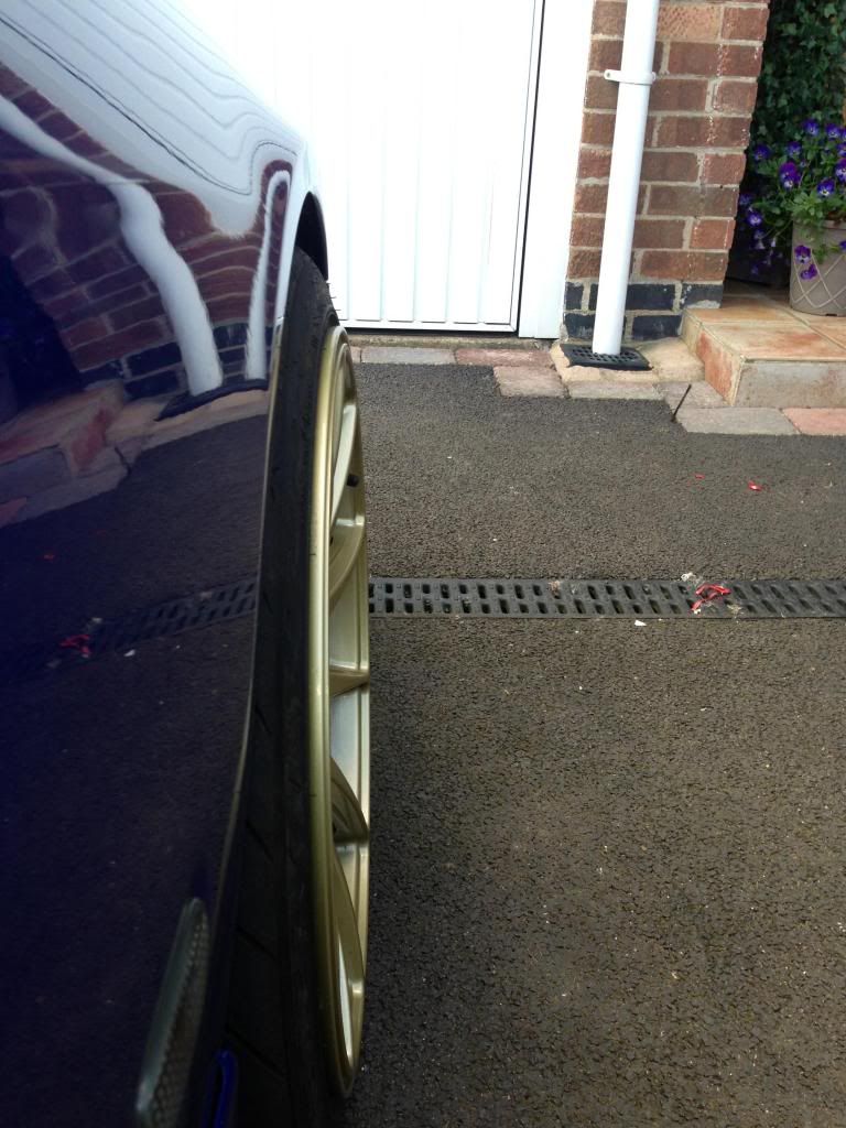

Hi mate, my wheels are xxr 527. (18s)
Front sizes are 8.75j +20 offset (tyres are 205/40/18 - Federal 595 evo's)
Rear sizes are 9.75j +20 offset (tyres are 225/40/18 - Toyo t1r's)
Camber settings -
Front - negative 1.59 degrees
Rear - negative 1.3 degrees
Fronts
Rears
Additional Info - i have HSD coilovers which the rears cover by a good 20mm, the fronts however are only around 10mm clear, no spacers required.
The maths (correct me if i'm wrong) -
My fronts
8.75j +20
From the hub the edge of the wheel is 8.75 x 25.4 = 222.25mm (width of the wheel in mm)
222.25 / 2 = 111.125mm (to the centre of the wheel)
111.125 - 20 = 91.125mm (the hub to the edge of the wheel)
Your Fronts
8.5j +15
8.5 x 25.4 = 215.9mm
215.9 / 2 = 107.95mm
107.95 - 15 = 92.95mm
My rears
9.75j +20
9.75 x 25.4 = 247.65mm
247.65 / 2 = 123.825mm
123.825 - 20 = 103.825mm
Your rears
9.5j +18
9.5 x 25.4 = 241.3mm
241.3 / 2 = 120.65mm
120.65 - 18 = 102.65
The result
Your fronts will stick out 1.825mm further than mine. (wouldn't be an issue with similar camber settings)
Your rears will stick out 1.2mm less than mine. (Better, but will still be outside the arch, unless your run at a guess 2-3 degrees neg camber on the rear.
I also have front and rear arch lips flattened back, no rubbing :)
Hope that all helps!!
