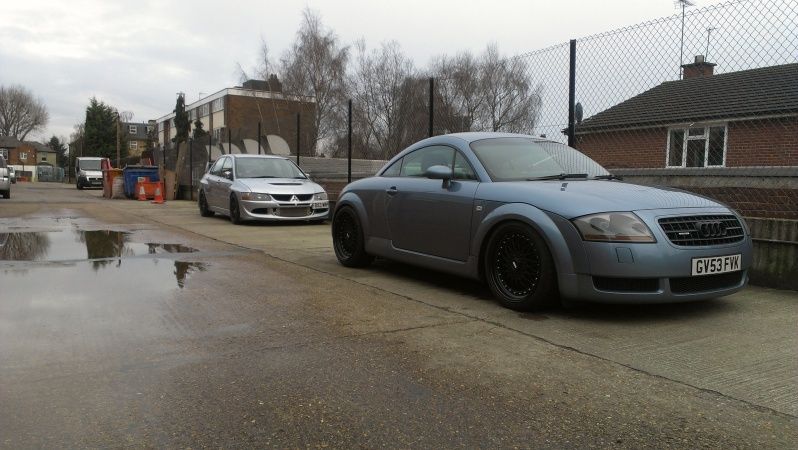

I think the car has been sat in bits for nearly 3 months, so nothing to update :D

Oh man , it looks so fierce sitting there!!
Any idea when it will be getting sorted??
Nice tt, what's that running??

The TT is standard, just had a remap and its on coilovers with BBS LM reps

Tt looks cool man all dubs and audi's should have bbs on lol

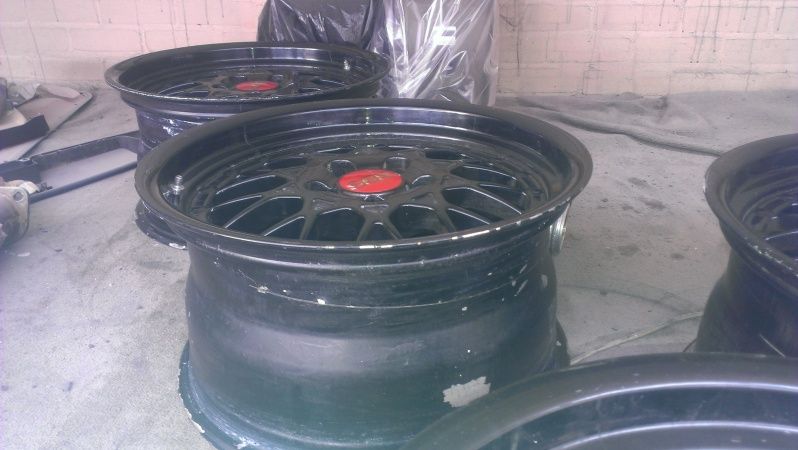

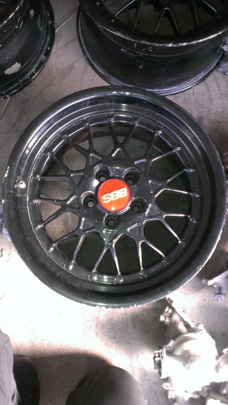

Anyway, I got bored... Bought some wheels, something a bit different this time...
BBS RSII/O splits, they're in desperate need of a refurd, thinking polished lips with black centres, not sure at thew moment though.

Nice rims man!!!!! I say black face body colour lip bit different! I don't know why I just have a problem with polished metal ha ha

I'm not a fan of polished metal either, I was just going to stick them in one colour, but I've seen quite a few "stanced" Evo's running BBS wheels recently with polished rims and they don't look too bad, although they have quite a bit more dish that what mine have...

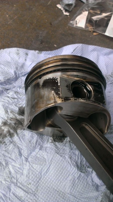

There's been some update on issues with Wiseco pistons, it seems they have changed their gudgeon pin design. For the mean time I can only presume I've got an earlier type. Somebody has updated a thread I started about Wiseco's with hairline cracks on the MLR. The pistons have actually deformed, as he had issues removing the pins, but had cracks on all four pistons, so it seems I caught mine early with just the one piston. There appears to be no bore damage on his analysis, so a straight forward piston swap may be all I need... I hope.
It's also become apparent that Wiseco have increased the size of the pins in thickness, photo's to show this, and increased wall thickness on the pistons.

Fingers crossed that it hasn't damaged anything else then buddy! Be nice if it was just a straight swap over. Bit easier to swallow!

Et voila... One cracked piston...
ive stripped the engine, finally. Everything is in pretty good condition, shells are unmarked, it's just the single piston that's failed, and it happened to be the one sitting right in front of the knock sensor so that would explain why we had abnormal knock readings while trying to map the car.

Ah so all in all not as bad as you thought? Case of a new set of pistons and away we go?
