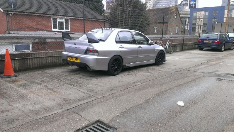

I've just noticed that the rear has the EVO 9 vortex generators and diffuser, i'm sure that wasn't available on the 8 only the 9, did you add these or where they on the car already. My mates FQ8 doesn't have these but i'm always bitching he should get them, lol.

The fq400 only came with the vortex generator and its had an Evo 9 with diffuser rear bumper fitted. I wasn't keen on the 9 rear bumper originally, it has started to grow on me slightly though, still undecided however. I've lowered the rear of the car aswell, it looks proper hard now :D

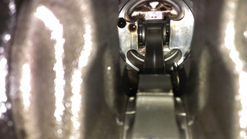

You may struggle to see this as I really had to give the bottoms of the pistons a serious good looking over as there's something not right going on with the engine. No2 piston has hairline cracks going through it, you can only just make out one of them if you squint hard enough. You'll need to look at the bottom left portion of the piston underside. Engine is coming apart this weekend to measure the bores and see if anything else is amiss.

I can't see the crack but don't really know what I'm looking for. Are they stock pistons?

The crack is on the skirt section of the piston, it goes through the wall and runs up the inside of the piston, there's at least 4 of them I found. It was hard enough me finding them with two torches, so I can't blame you for not being able to see it. If I had some way of drawing an arrow on the picture I would but I don't know how to on an iPad. I'm proper gutted as I've been able to laugh off the other problems but this is a step too far. I'm sick of working on the car, I've lost count of the times I've had to get the spanners out to fix something.
theyre not stock pistons, they're Wiseco forged pistons. We had slight scoring at the tops of the bores when I took the head off, which I was concerned about but ended up not being serious enough to go further with. Apparently the scoring is caused by ring gaps not being corrected for the bore size and the cracks are from incorrect piston size to bore width, so a poorly built engine possibly. I know how an engine works but I'm not an expert on particular failures so I'm getting people in the know to give me advice on what's what as I need to fix it and do the job properly.

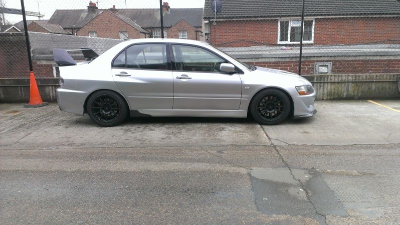

Yeah, chaps, I'm gutted. Checked the other three pistons at the weekend and they seem fine, but regardless it'll get a full set. I had to push it off the ramp for a new shutter we were having installed. This is how the cursed car sits at the moment...

I know it's not much consolation but it looks like its sitting really nice now! Looks lovely dude! Hope you can get it sorted soon mate, pita!!!!!

As said the car sits well! Bet it will go well too eventually!!
