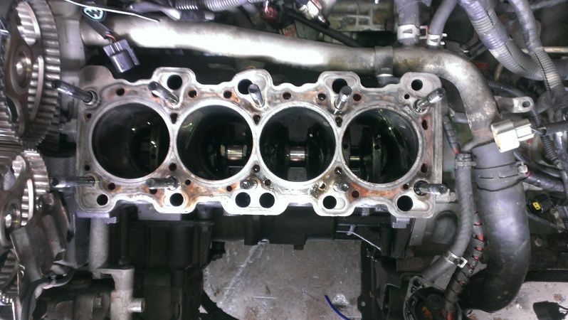

i always like to add a picture to make boring words look more interesting, so I took this last weekend of my empy block still sat in the car...

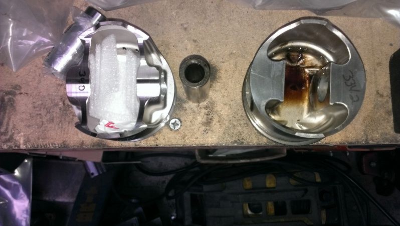

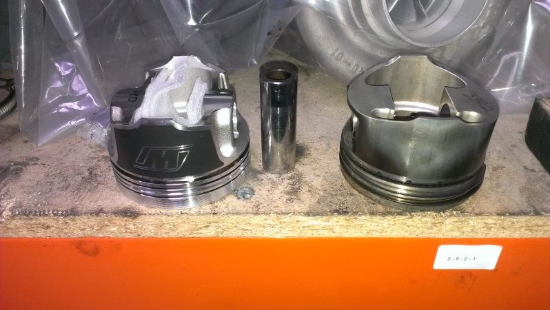

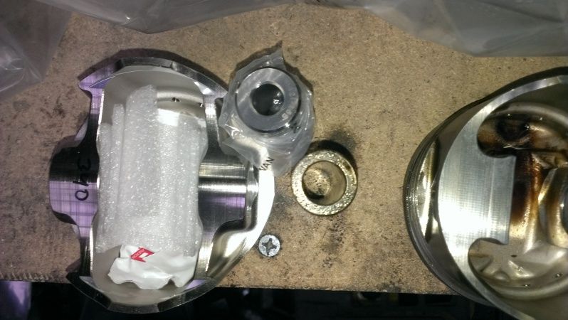

The correct pistons finally arrived today, but the ARP 2000 rod bolts didn't turn up with them for some reason. You can see the difference in the piston skirt design and the wrist pin, a much better design all round.
