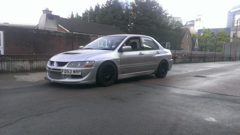

Cheers, chaps. I'm pretty chuffed this evening as a huge potential problem got sorted and I timed the whole engine up by myself somehow. These engines are not easy to do without two people. I devised my own locking tool for the cams while I timed the bottom end up, so that's all sorted. The engine has oil in it and I'm basically just waiting on the injector seals and I need to get the battery charger out. It may be sometime this week it finally fires up :D

Well, it runs, sweet as a bloody nut
i pulled it out of the unit and just did 20 miles in it and it runs faultlessly. 80 more miles to go then oil change and mapping.

Cheers Adam, I've practically changed everything in the engine since buying the car. I've got a good idea of what it'll make, power wise. I've heard back from the fella that's going to map it and it should be one evening next week. Ill upload a video of it at full power.

It was mapped last night, now running 2 bar dead. Gave it a bit of stick coming home and its pretty quick :D. Made something like 410hp at the wheels, works out to about 520bhp I think it was.
