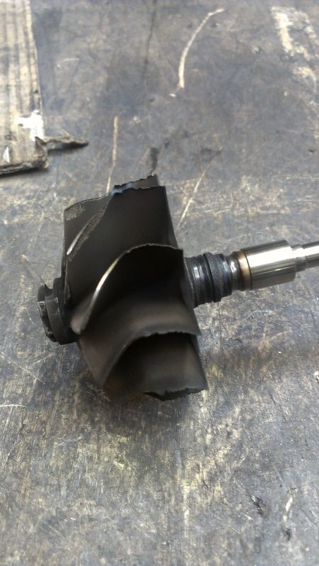

Well I finally got the turbo apart earlier, I was going to do it on Saturday but decided to stay in bed. It's clear what's happened but to be honest I'm unsure if this has happened while fitted to my car or the previous owners car, I'm a tad more inclined to think the exhaust wheel damage happened on the guy I got the turbo off car and the last little push while we mapped my car finished it off.
I don't think it was an oil related failure now, it just seems like the exhaust wheel damage has caused a huge imbalance in the shaft assembly and the rear cartridge has destroyed itself resulting in parts of the car quite possibly being in the sump, as there's a few bits that are unaccounted for. More work is to come yet but not much will happen for the next couple of weeks I reckon. Anyway, here's what I was left with once I took the turbo apart...

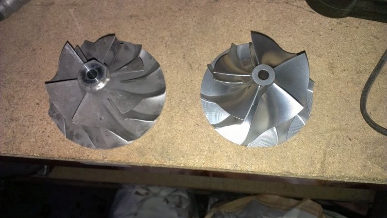

Cheers for the support, chaps. My new billet wheel arrived today in the mail, it looks like it'll flow well but it and the compressor housing need some machine work to go together well. I could of had the car running this weeki but I'm away with the other half and the cams haven't arrived yet so it'll have to wait another week.
This is the new wheel again the 35r 82mm wheel...

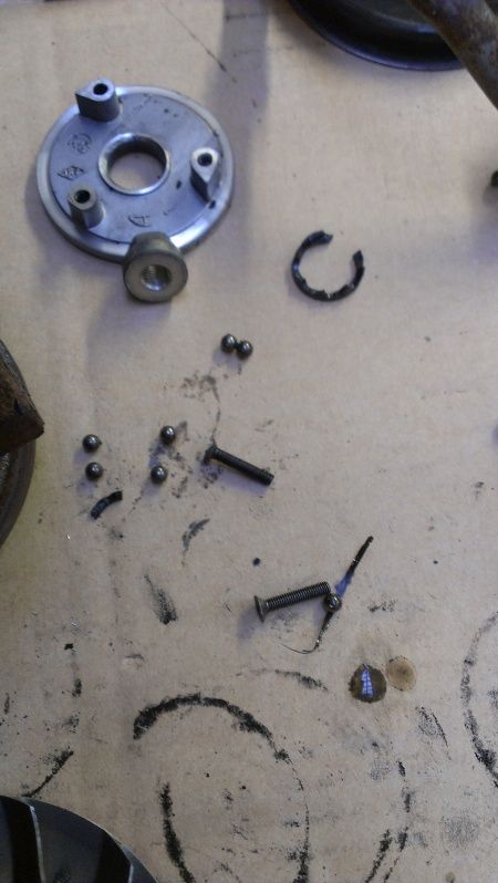

A little more has happened with this. I had some more time to strip the oil restrisctor out of the rollerbearing core and the main oil supply did indeed have a very small shard of swarf blocking it partially. So the turbo suffered from two faults... That doesn't really help me out, but it just lets me know exactly what's going on. The swarf was definatley not from my engine as I inspected the previous bearings and there was no contamination marks after the 3.5k miles it had done.
Anyway, engine work has started, I took the sump off a couple of days ago, the oil pick up was holding the rest of the turbo internals that were missing (no pictures though). The sump had so much sealer used on it it had a huge thick rim sitting on the inside edge:eek:, I'm actually suprised none of it broke away. That's not the best bit, half the sump screws were finger tight, only being held in with the sump sealer. It's a good job I work on my own cars, I'm very particular and always double check everything (shame I didn't check the last turbo though, serious rookie mistake:D).
