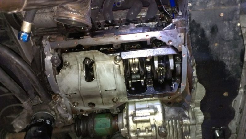

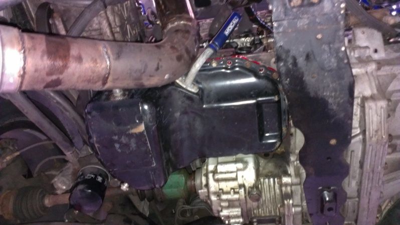

Well I got started a bit late today as I had a few drinks with some pals last night then had to do some running around this morning. I got the rest of the remaining sealer off the block and sump and got any crap out of the oil strainer to stop any possible contaminants getting drawn up to the top end
I literally just had enough engine sealer to get the sump back on too, so that's now all bolted into place

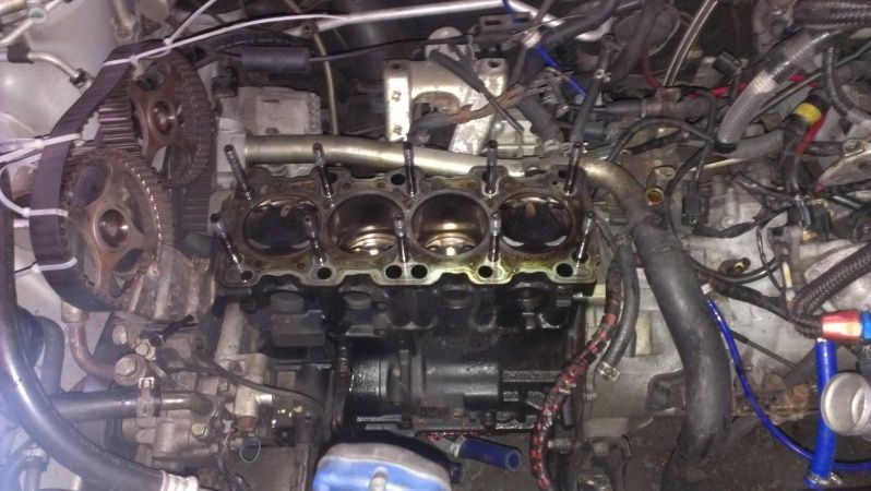

I've just had the rocker cover off to start removing the head and its got arp head studs, I've just bought a new set of them aswell, so they weren't really needed but I might aswell use the new ones regardless.

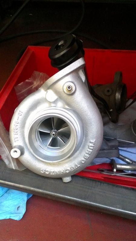

more important news though, the turbo is finally built up. It's a bit of a ****ed up spec, as everything was custom built. The compressor wheel was machined to a specific size, we had tot make all of the internals custom as nothing was a direct fit. There's nothing like this on the market, so I'll just have to see how it performs. It may say Turbo Technics on it but what's in it now has nothing to do with them. Comp wheel specs are... Billet 5 blade wheel with 56mm inducer and 78mm exducer, which is basically between gtx3071 and gtx3076 comp wheels. I'm really looking forward to see how it performs...
Cool, I love it when stuff turns out to be a bit of a one off... when it's back on the are you using it as a every day car?

Love a bit of kustom one off goodness!!! Hope it spools well and give you what your after!!

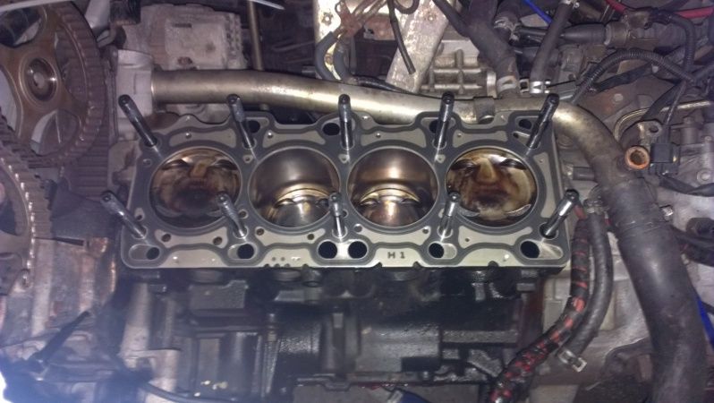

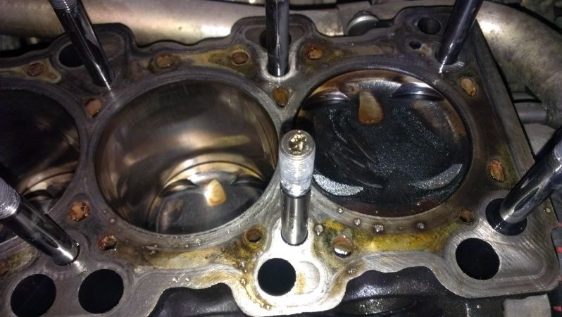

Well, I got the head off today, it only took about 30 minutes once I'd slackened the timing belt. I can't use my valve spring compressor on the Evo head though as its an odd design, so I'll either need to buy another one of make a tool to get the springs out. I finally found out what pistons are in the motor too, it's running Wiseco forged pistons, so it's got all the parts that I was told it did.
i did notice that whoever built the engine snapped their Allen key inside the top of one of the ARP head bolts and made a bit of a mess. I had to use mole grips to remove this stud in the end. It's a good job I'd already bought new studs for the head too...

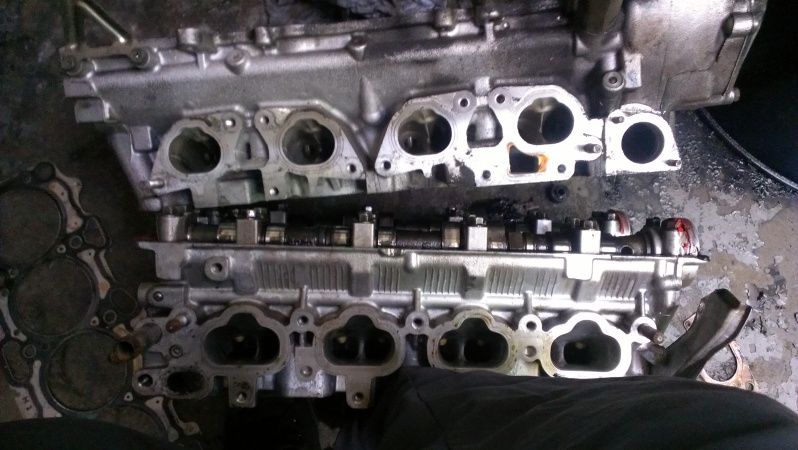

I have a spare SR20 head at work too so decided to put the Evo head next to it and show people how restrictive the SR20 is. That'll explain why Evo's can run up to 650bhp without and head work.

Wow major difference in the port sizes, the Evo ports look very similar to my VVL head. Glad the forged engine parts were found in, phew..

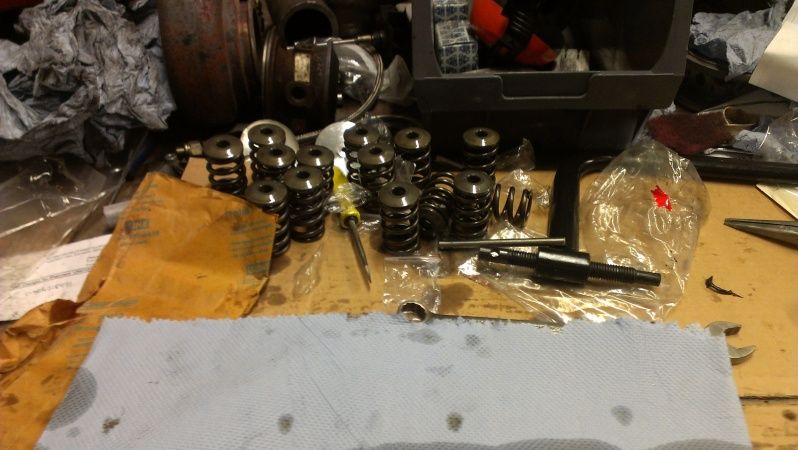

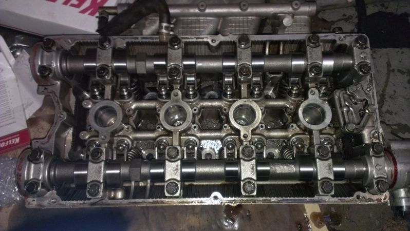

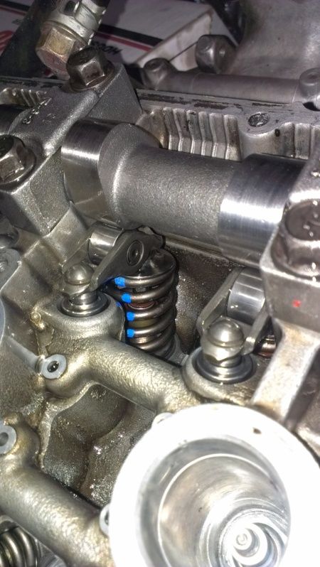

I spent about 6 hours on it today and got all the time consuming stuff finished. I stripped the head down and fitted Brian Crower valve springs, BC titanium retainers, Kelford 272 cams and brand new larger Mitsubishi lash adjusters to stop top end rattling afrom cold starts as they were a design fault from the factory. Here's a picture of some of the old parts removed...
New spring and retainers fitted...
the head all back together ready to be fitted...

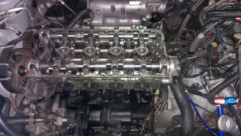

the head all bolted into place...
i forgot to take pictures after that. The cams all all timed up, cam belt and pullies are all back on, turbo, manifold, inlet and exhaust are all fitted. I literally just need to plumb in coolant pipes, vacuum lines and odd nuts and bolts to get it all back together and it's ready to fire up. Getting excited now :D
