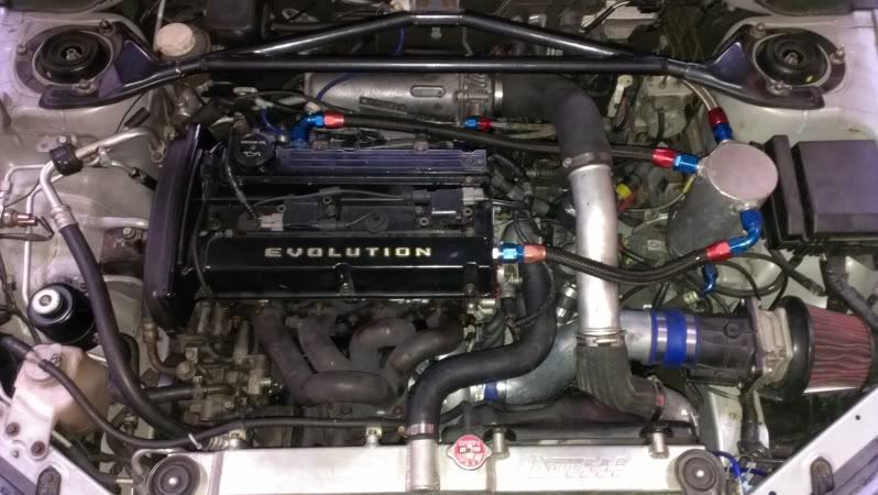

And its all back together..
It just needs oil and coolant then its time to turn the key... Getting nervous, lol.

I filled the engine up with the cam cover off as the cams looked almost bone dry from the weekend, coolant filled up and got as much air out as I could. Cranked engine by hand with oil in, then cranked it over with the key to prime the turbo....
It started first turn and runs lovely, it gets really lumpy once its warm and sounds awesome :D. Ran t up to run cams in for 20 minutes or so and check for leaks. No oil leaks but have a small water leak, so that's a small job for the weekend. Well chuffed its finally running and cheers for the pleasant comments from everyone :)

Yeah, I know where it's coming from, it's the thermostat housing on the side of the head. I did think it may not have sealed well as it was a **** to get on. It's not a big job, so I'm pleased that's all that appeared to be leaking, considering I stripped nearly the whole engine down.
