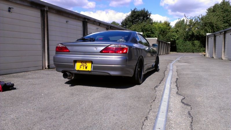

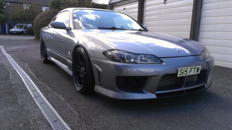

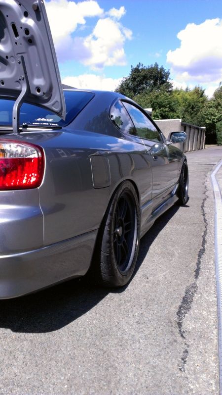

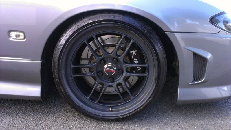

I've had some interest in the car and they asked for more photo's, so I took some earlier after getting the car washed. I didn't want to say the car was mint but I try to keep it in good nick. These are the best photo's, albeit not great quality, I've tried to take of the car in a long time.

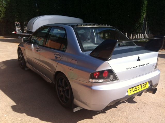

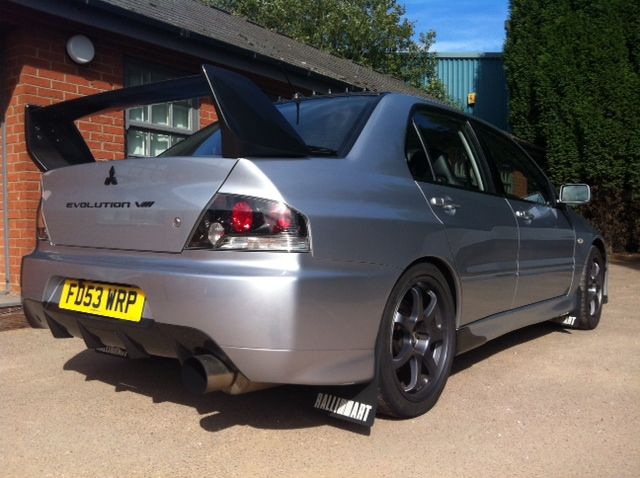

So, I picked this up today...
I hate the wheels and ride height but it can go round a corner so quickly it's stupid. I'm planning to change the wheels and lower it slightly. The speed this thing accelerates at though... ****! It's running about 500bhp and it's savage, I can't wait to get it on some track days, I'm already sorting a bigger turbo and maybe a set of cams. This car has had so much spent on it too, it's a street/track weapon.

Nice, what was it originally FQxxx..
My mate has a lovely Evo 8MR FQ that's running just under 400hp and you right they can go round corners stupid fast, just don't come off throttle once you've committed round the bend, not good, lol.
Top Car for sure... Have fun..

It was listed as a GSR, but it's got the MR interiour, plus it's an Import, not a UK model like the GSR's, so god know's what it actually is, lol. It's got a fully forged motor with a Turbo Technics S205 turbo (I may need to take this off the see if I can improve it:D), AP 6 pot brakes, ds3000 pads all round, Bilstein coilovers, Autronic stand alone, pace intercooler, 1000cc injectors, RS diff... It's so bad on fuel it's not even a joke but it's easily forgiven. The transmission is as close to bulletproof as you can get with Evo's, so I'm going to give it some serious abuse :D
I learnt a long time ago with 200's that you never take your foot off the throttle if the car starts to hang out. I pushed the car hard around a couple of bends earlier but I know deep down I was actually only tickling it's performance.

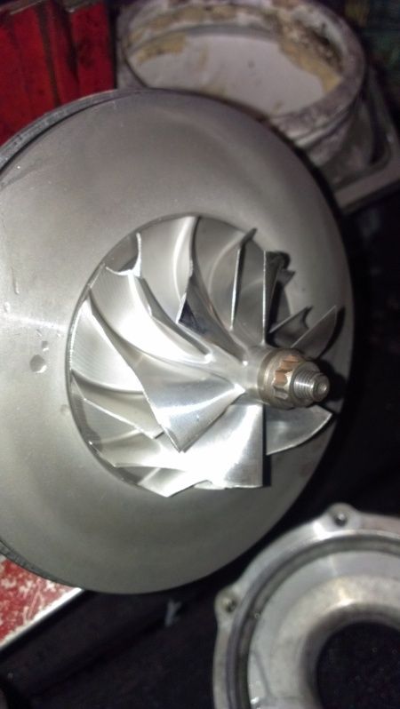

This happened after 1 day :(. I suppose 2 bar doesn't fare too well with the below mentioned wheel
billet wheel aswell, that's the whole point of being billet! that wheel is sold out worldwide unless you buy it from another turbo supplier and a huge markup. I've got a 2-3 week wait at the moment. I bought a GT35R but had second thoughts when it arrived as I don't want to deal with the lag... 600bhp easy though, at 2 bar...

After 1 day, damn...
is that a billet wheel from a GTX? And yep keep your Evo posts coming, my two best mates have Evos (4+8FQ)

Ichigo, its not a GTX series turbo, its a weird Garrett version of a Mitsubishi turbo, it runs anti clockwise wheels which makes it a right pain sorting parts as everything has to be ordered from overseas. It's running a 73mm billet compressor wheel which has been said to flow around 53lbs, all of the rolling road graphs I've seen with the turbo are producing between 500-540bhp.

Bad news!
What do you think caused it? Did it just simply fail or do you think something got in there and did that damage?

It's a metal fatigue failure, I see it a lot but its generally much worse than what's happened here. It's the first time I've ever seen it happen on a billet wheel though, must be poor quality material or it had balancing marks at that point weakening the wheel. Billet wheels were designed to stop these failures from.occurring, so its a little worrying to see. I did find the missing parts too, they were sat in the intercooler.
