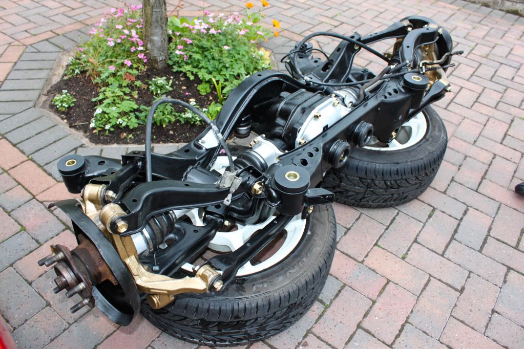

Right time for an update!

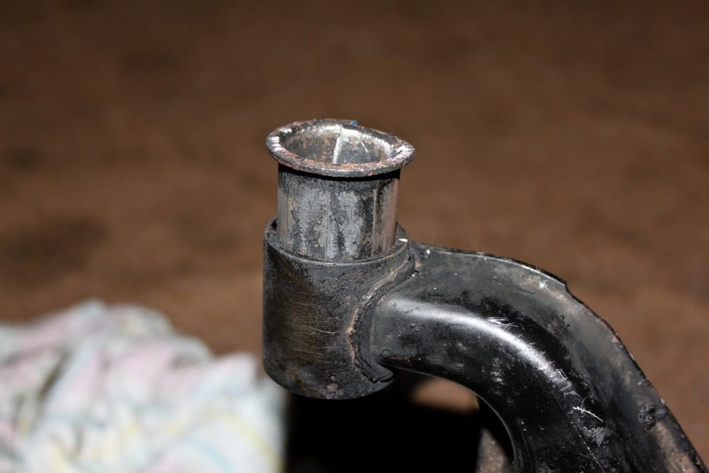

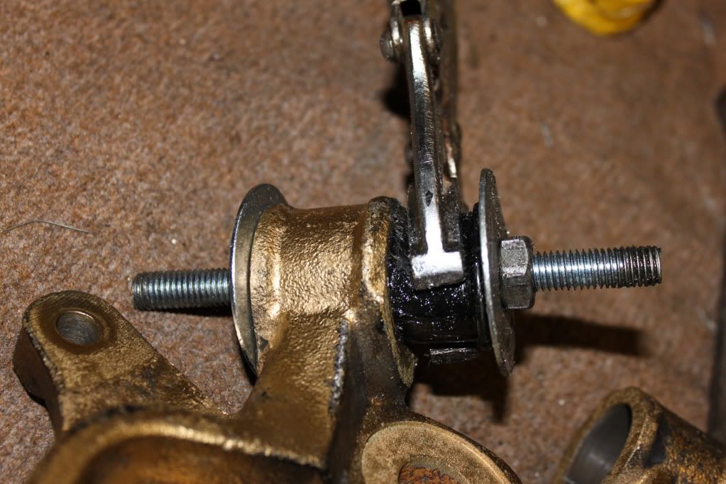

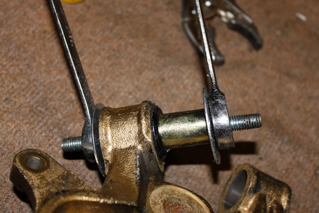

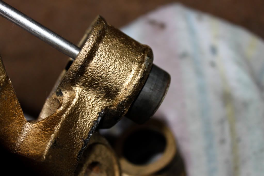

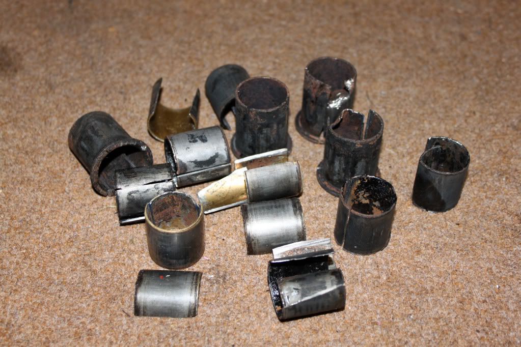

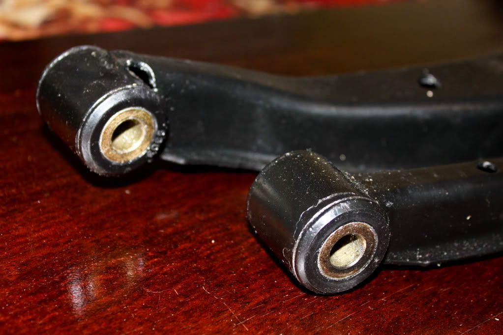

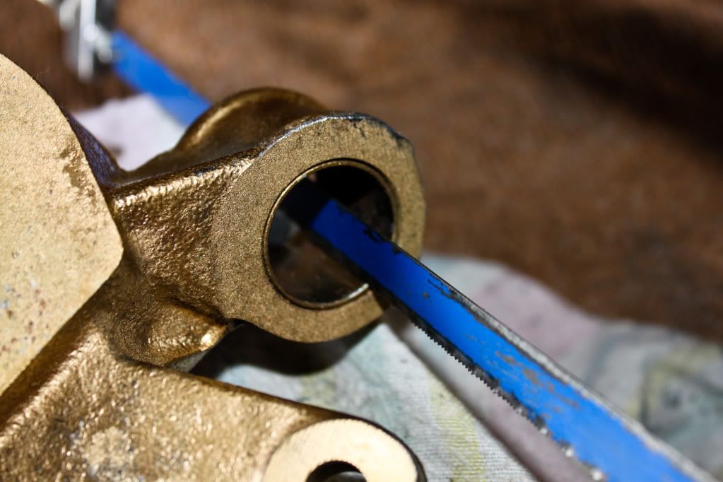

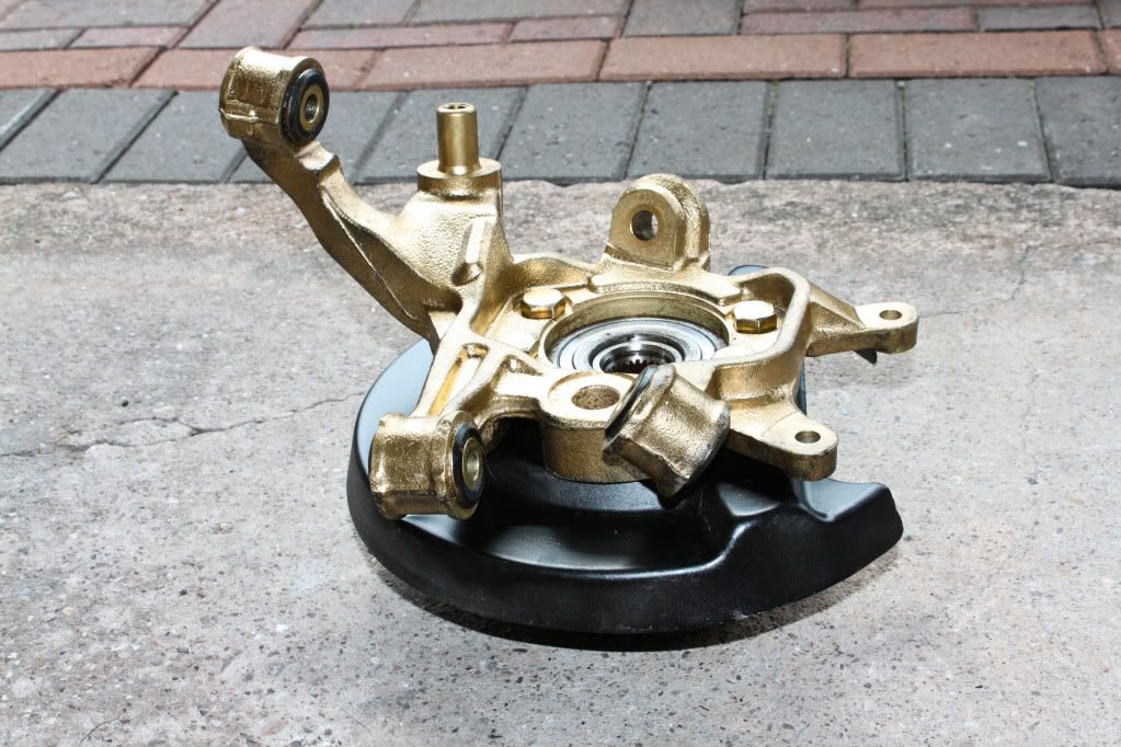

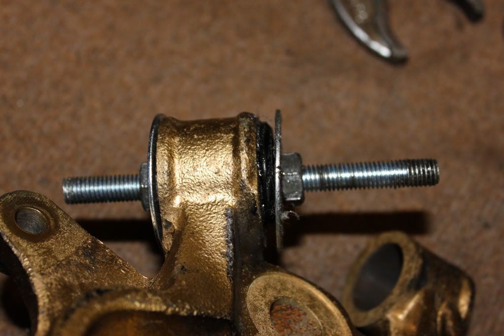

Its been a good 3-4 weeks since I had problems with the bushes, they were a right P.I.T.A! Turns out though I'd left the metal sleeves inside which was making it too tight to fit the bushes.
Cut the sleeves in 2 places to take the pre-load off -
Pop them out -
Ba*tards! :D

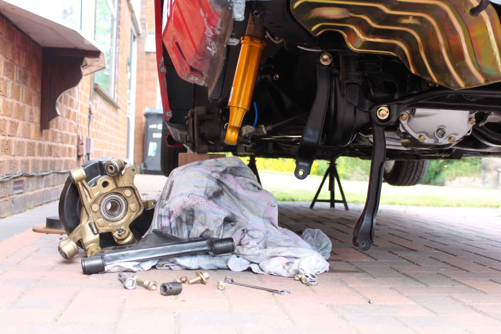

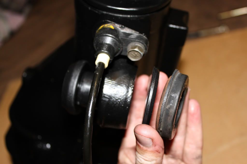

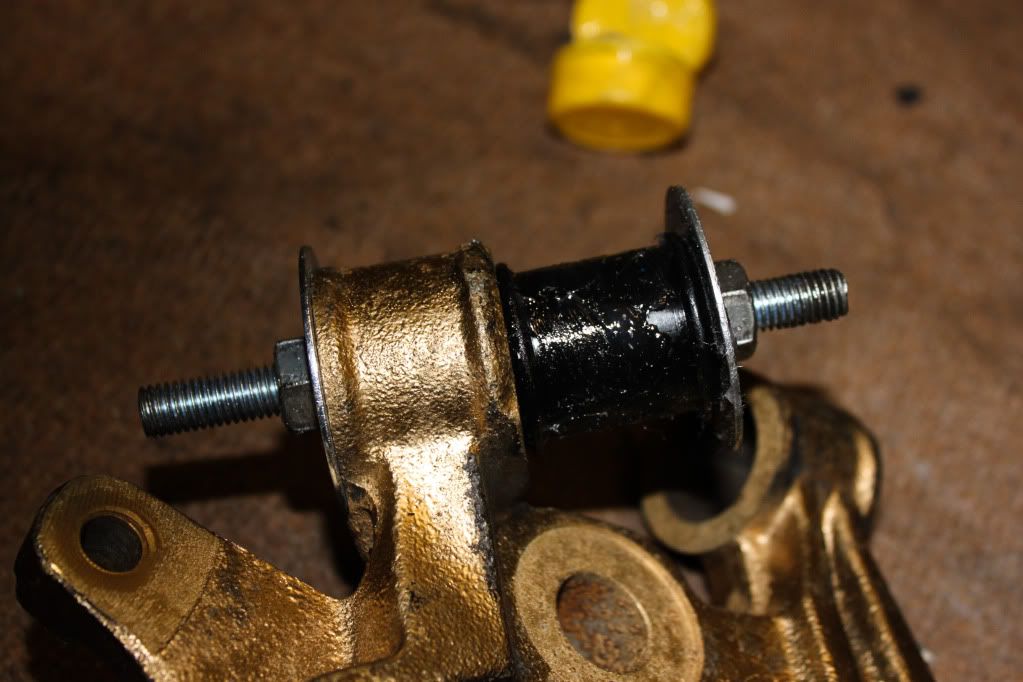

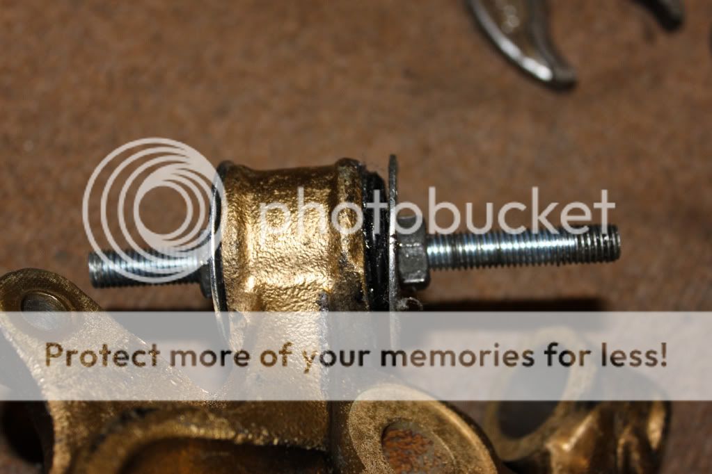

New ones went in very easy using a technique shown to me by Craig -
As you can see they are a perfect fit when fitted properly!
Excuse the chipped powder coat :(

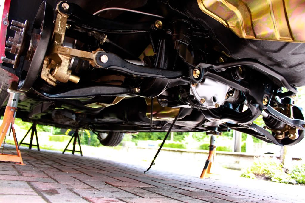

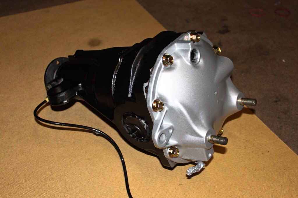

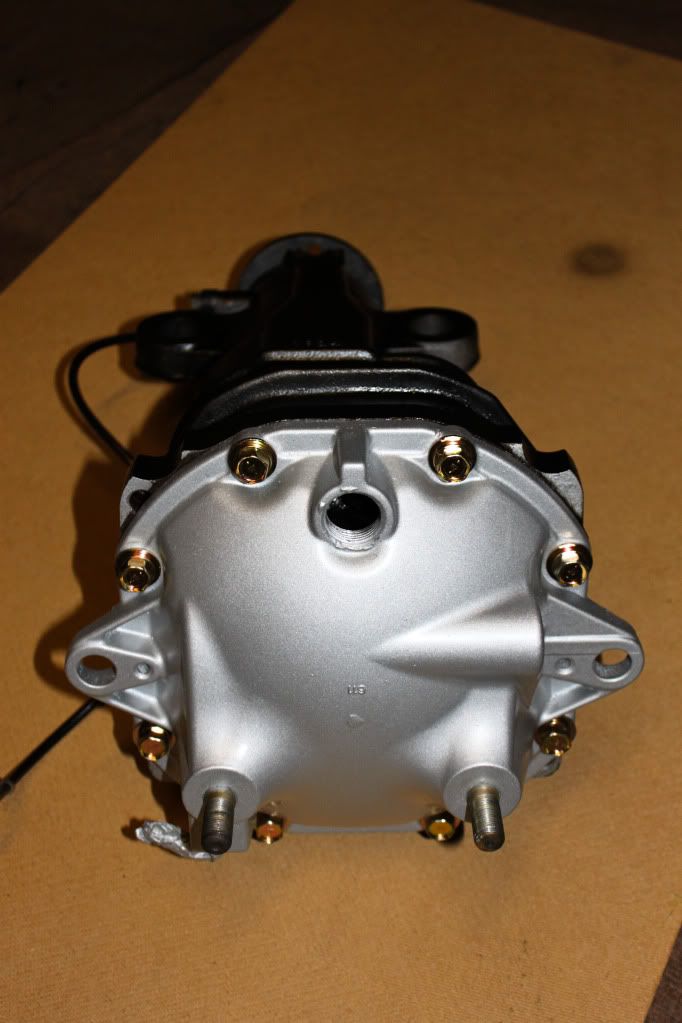

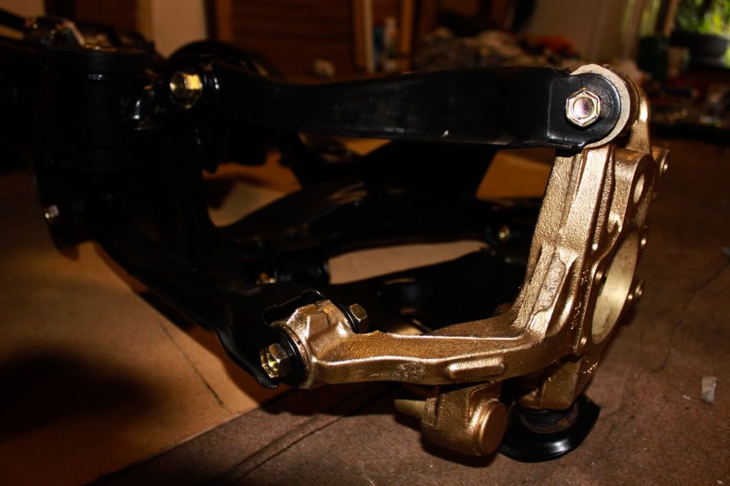

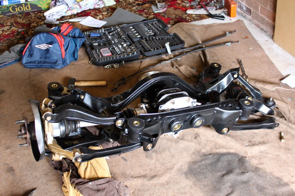

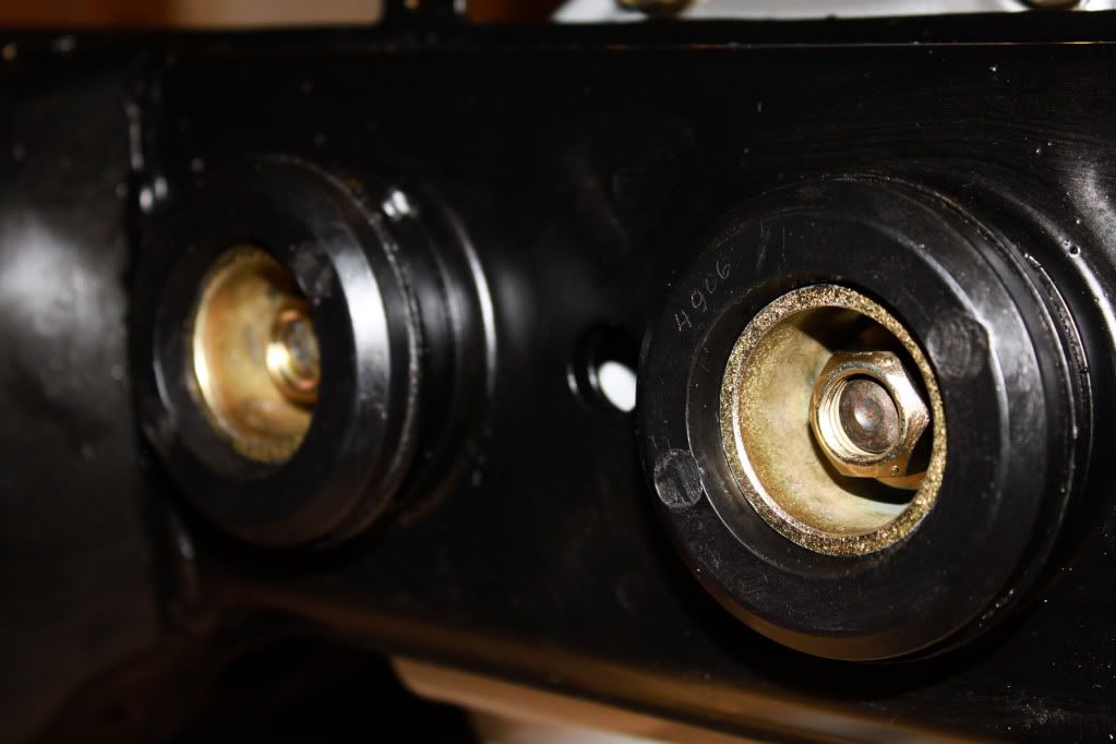

Diff painted with 3-4 coats of No Nonsense Zinc followed by satin black -
Fitted diff bushes -
Think i got them the wrong way round at first but soon realised when I tightened them up..

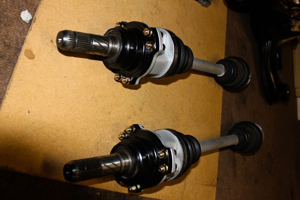

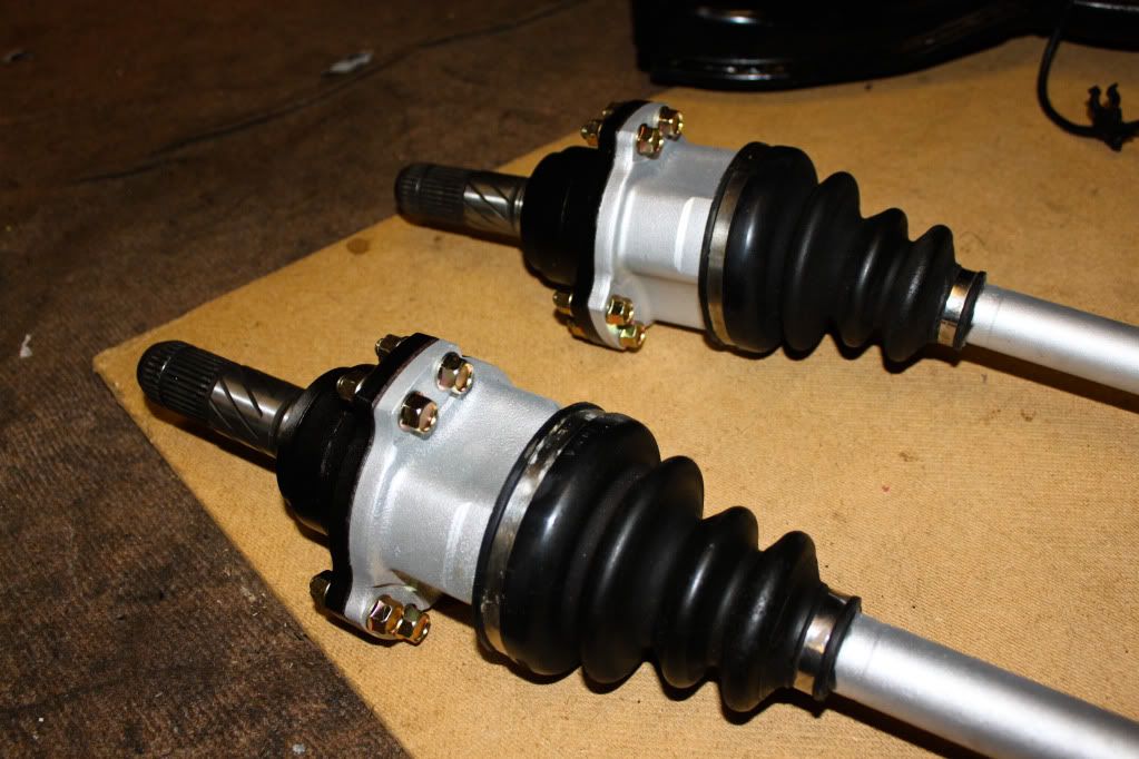

Shafts -

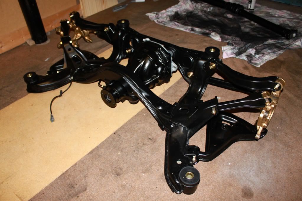

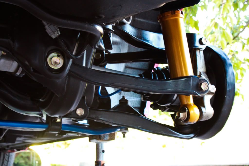

Started building the sub frame back up -
Ready to go back on :)
On!
Took a lot of effort to get it back on lol, its much harder than taking it off :nod:

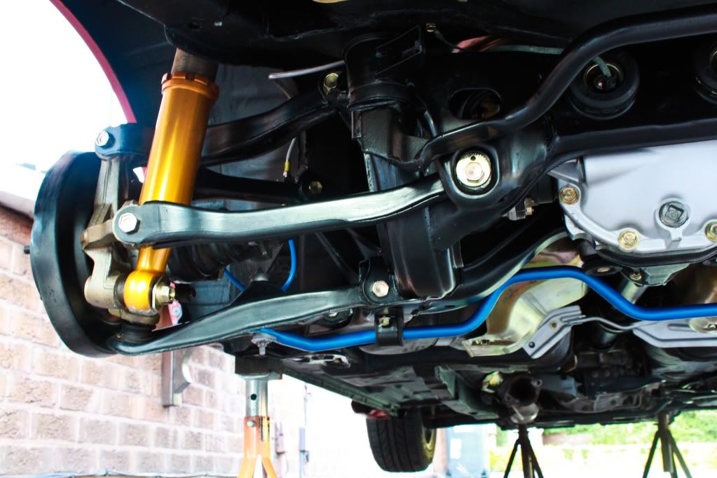

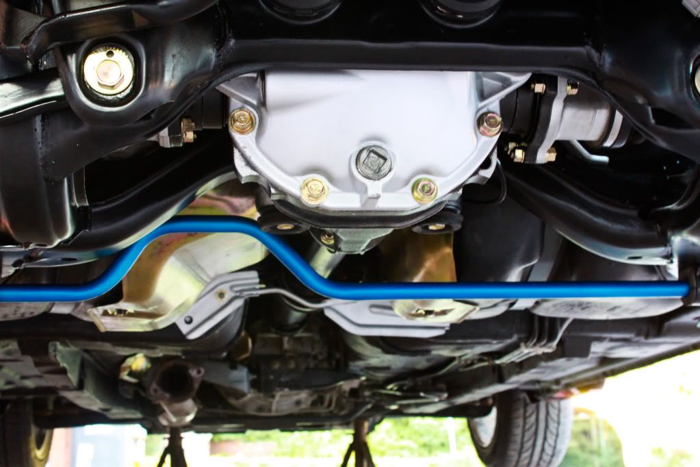

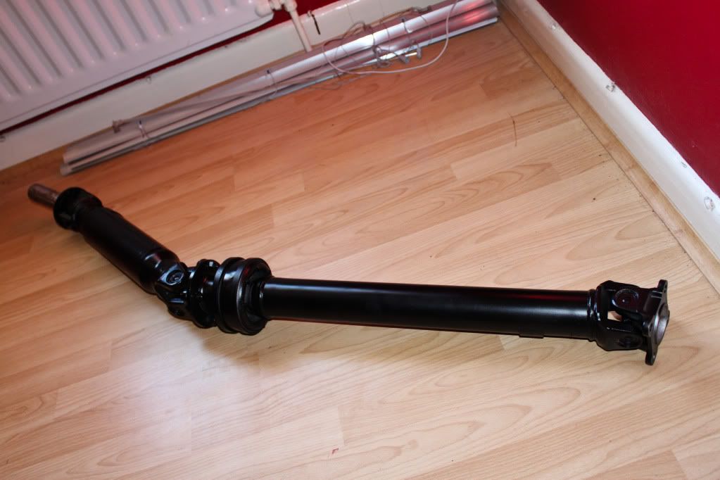

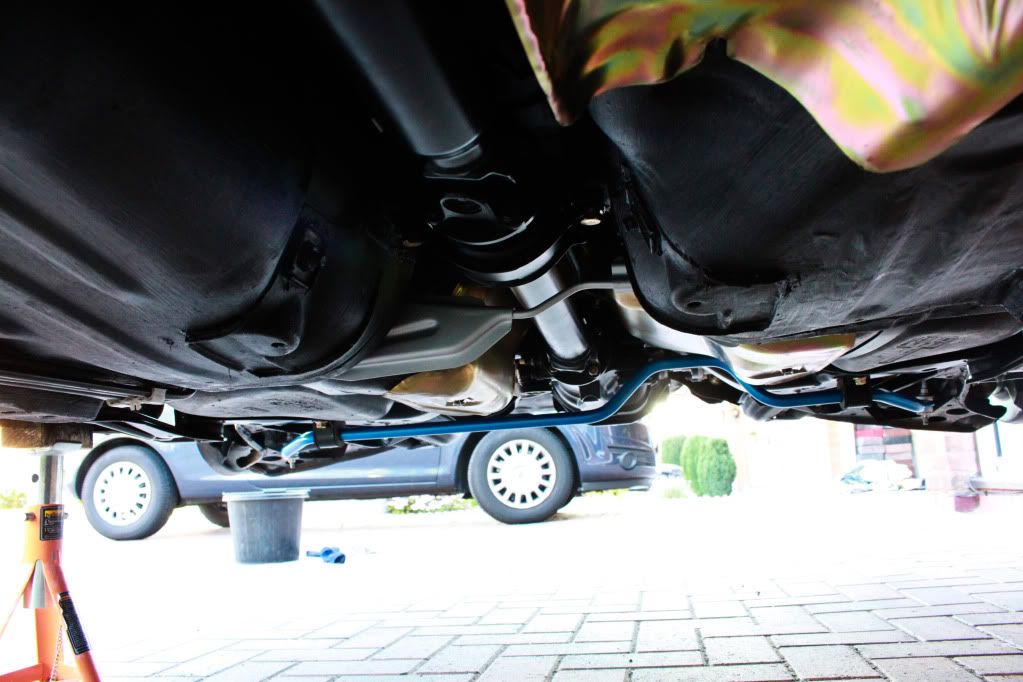

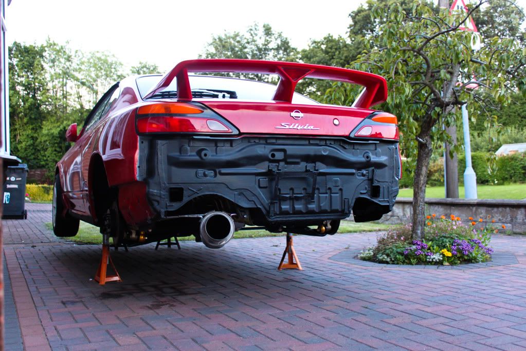

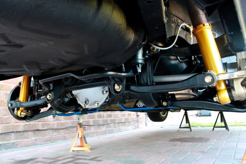

Prop painted with 4 coats of no nonsense zinc followed by satin black

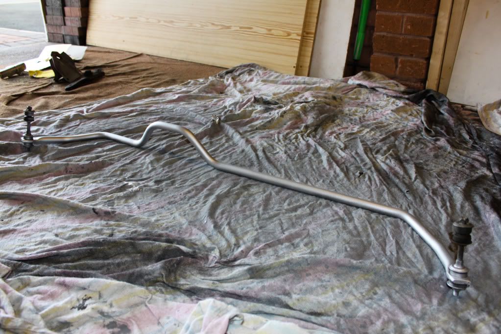

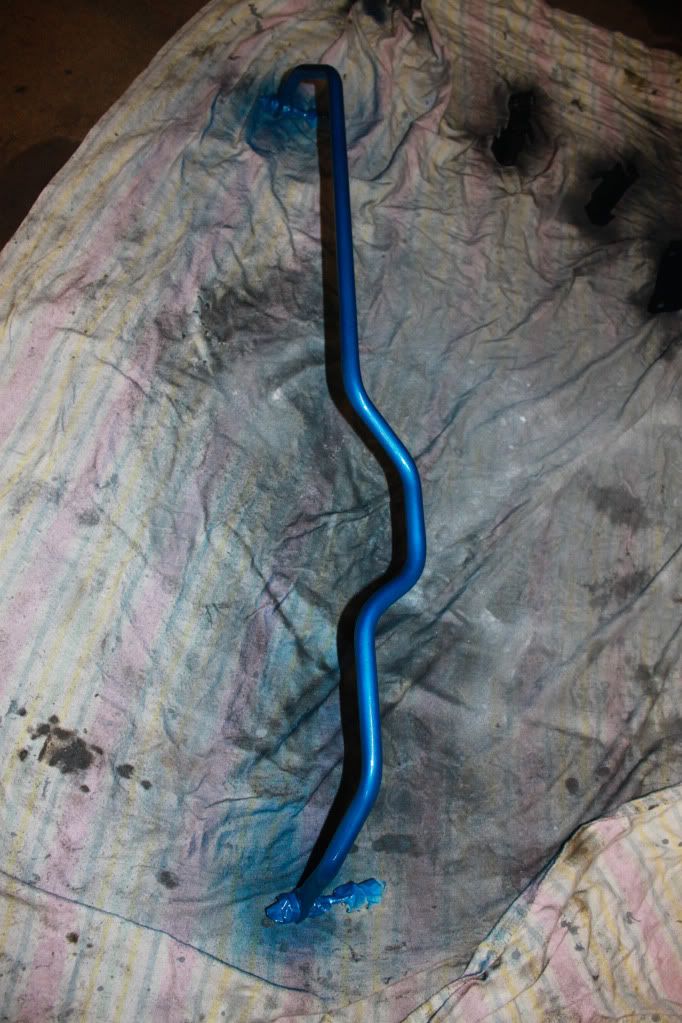

ARB painted with zinc followed by some left over blue I had :cool:

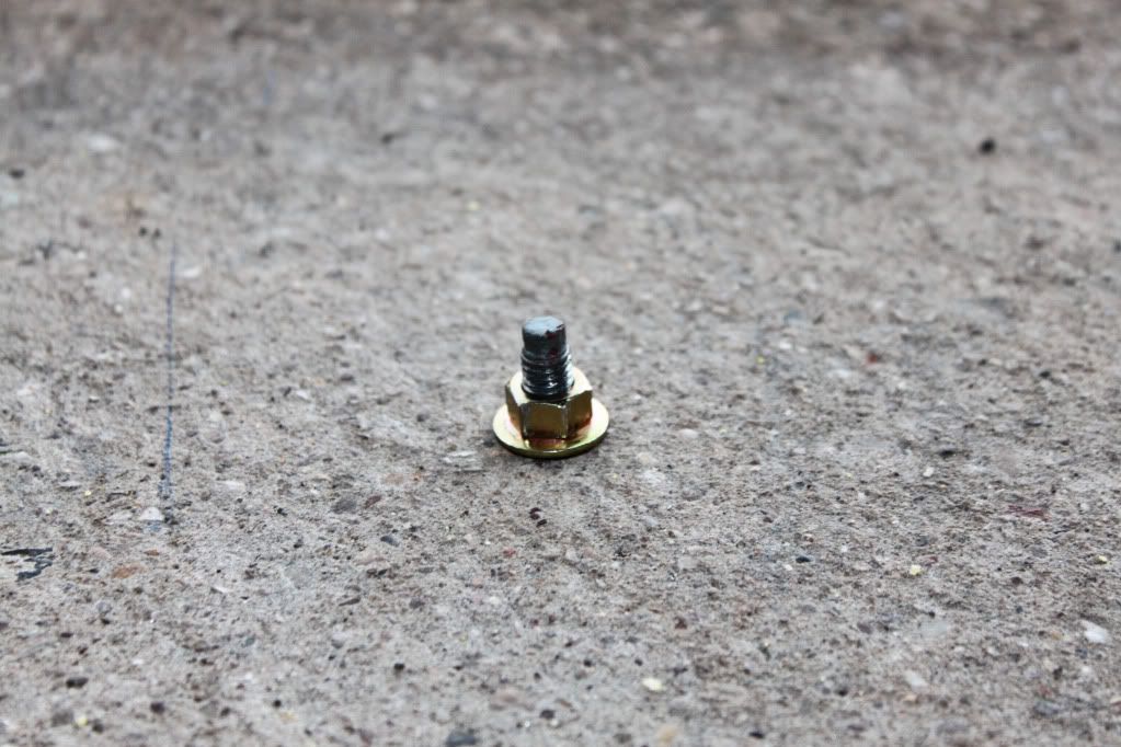

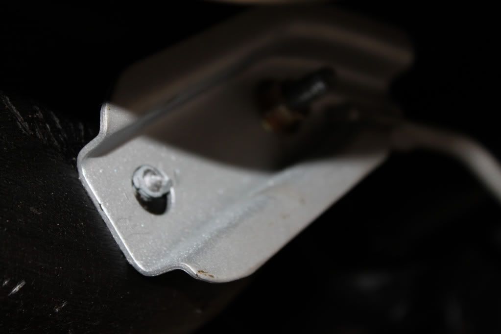

I managed to shear a bolt from this -
I managed to still secure it but its still annoying! No idea what its for..think its just there case the prop comes loose and falls down? Or to protect the prop in some way...

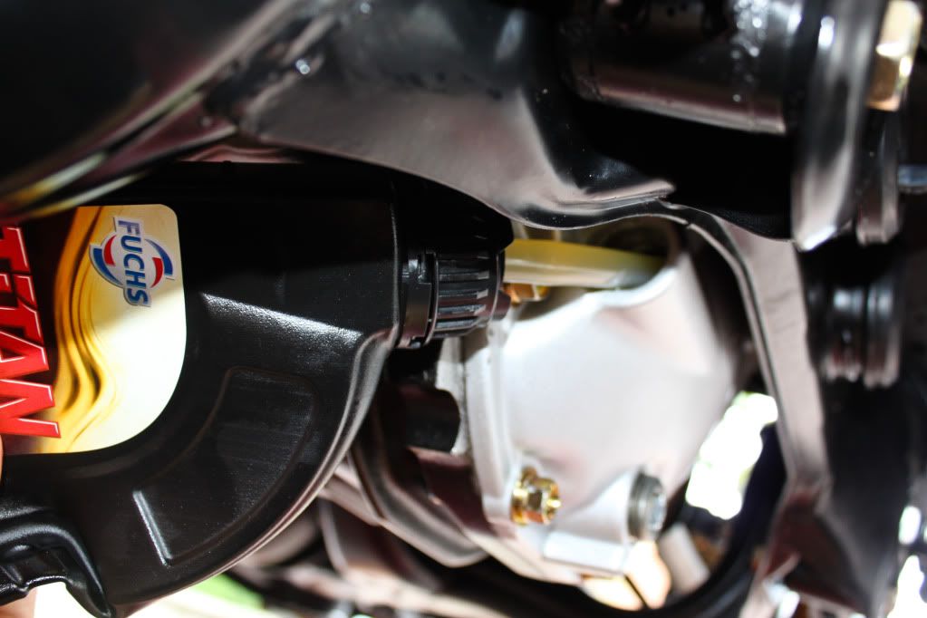

Filled the diff with Fuchs Titan Race SYN 5

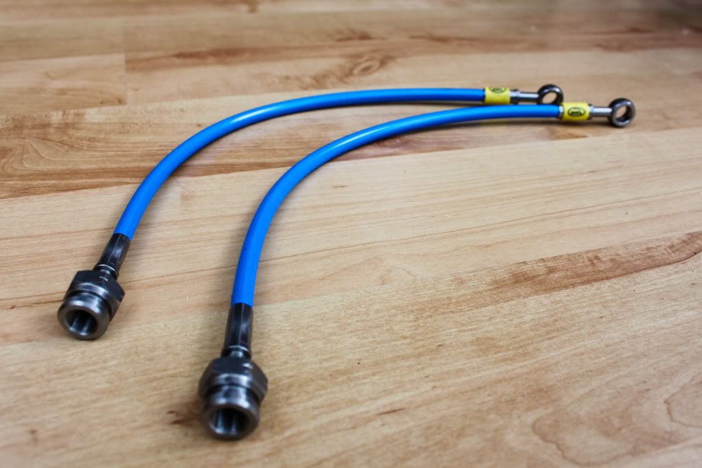

New rear brake hoses as I got sent the wrong ones..

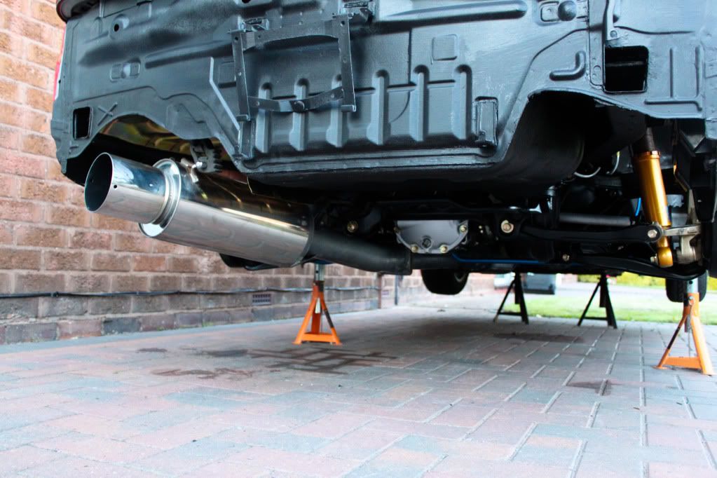

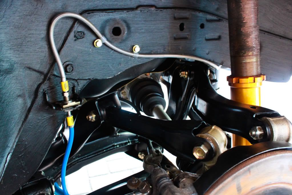

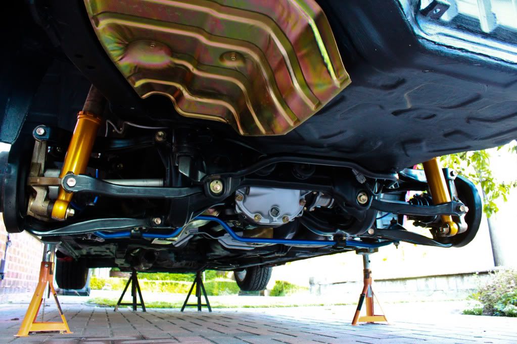

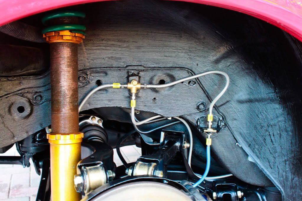

Done!

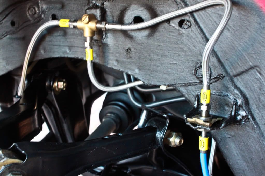

Not sure if they will pick me up on the lines for MOT? Mabi ned to secure them better?
Exhaust cleaned up with Autosol and fitted
Thats as far as I am atm, I need 2 new gaskets for exhaust as its blowing like a bitch where I fitted a CAT (fot MOT) as the old gaskets were almost falling apart anyway..
Also the breaks feel spongy as hell so im hoping the settle down after a drive but if they dont its either down to air still in the system, I didnt bleed the fronts only the rear as its a seperate system although the mc did run quite low so mabi air got to the fronts? Also mabi the abs module needs bleeding?...or its down the the lines not being secure and the are moving which would increase pedal travel...who knows weel soon see :|

how did you get the half shafts so nice? thats been boggling my mind for ages now

I just cleaned them up for ages using wire brushes and the drill attachment..also used some deox gel on it which helped :)
The thing that worked the best was a brand new wire brush tbh..
Then just painted everything with the no nonsense zinc and then black on top for the bits that connect to the diff.

Fancy leaving the old bush casings in the hubs :annoyed:
You silly bugger! Lol

Make sure you spend time to check all the brake connections! Get someone to stamp on the brakes constantly while you properly check every connection!
I will yeh, I did them up fairly tight with an 11mm flare spanner so im pretty sure they are all okay..cant be too safe though :nod:
