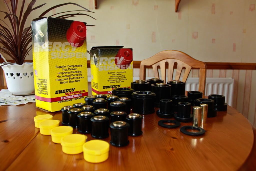

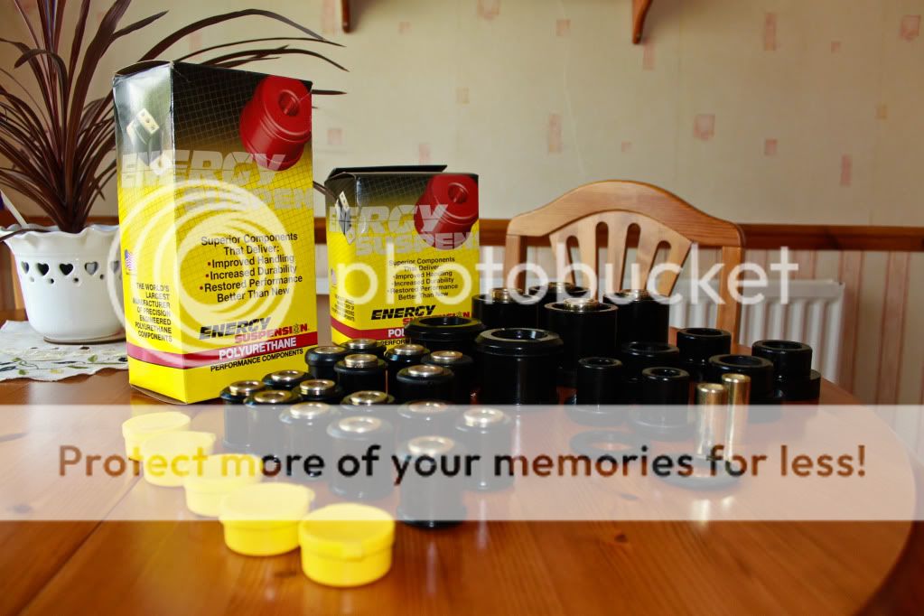

	Cheers yeh Im going to try something like this, will use washers instead of wood though.you need the old threaded rod and block of wood trick mate, put the rod through the wood, then the bush, then the housing and then another block of wood the other side. tighten a nut on the rod and it will pull through![]()
	Yeh this is due an update but I still need to sort loads of photos out first...How's the work getting on now then? I guess you've had more luck with the bushes since the last update![]()
