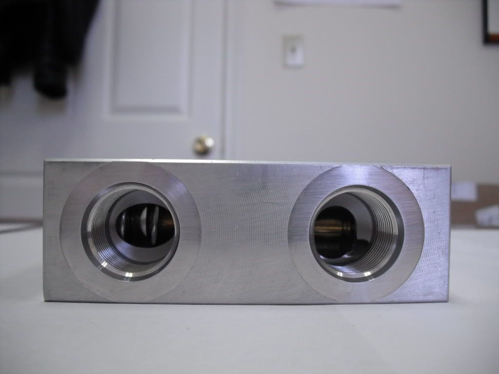

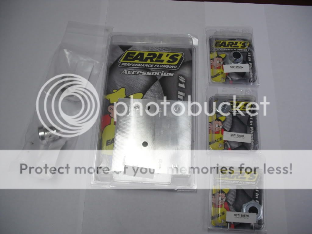

Greddy Breather Tank - Earls Oil Cooler and other bits

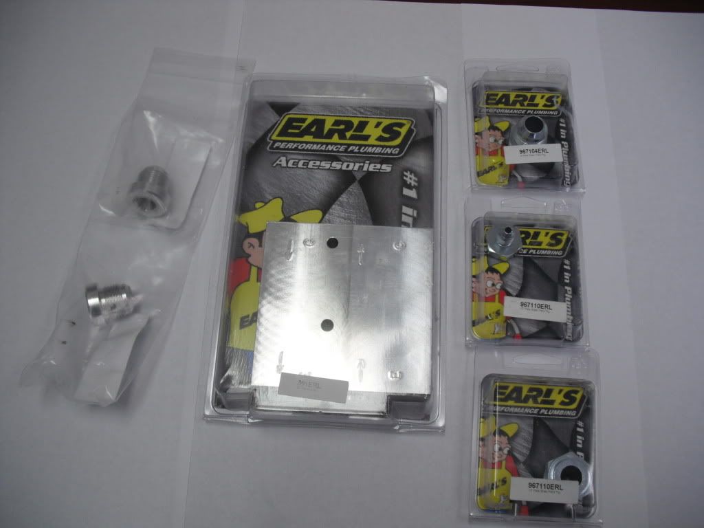

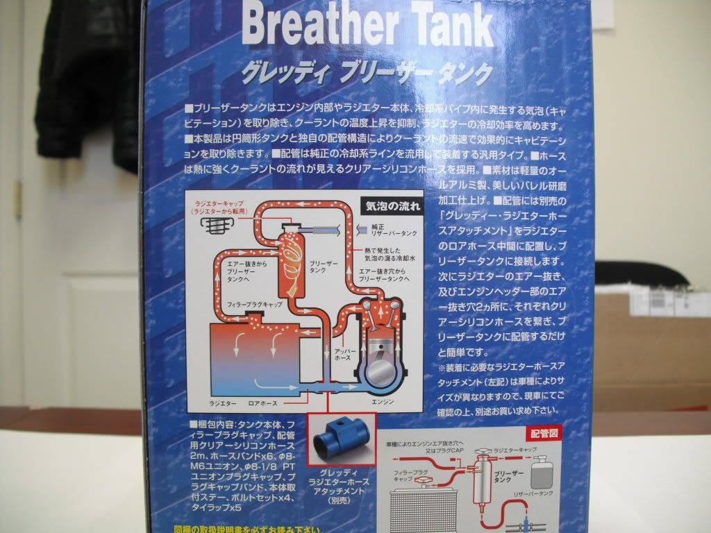

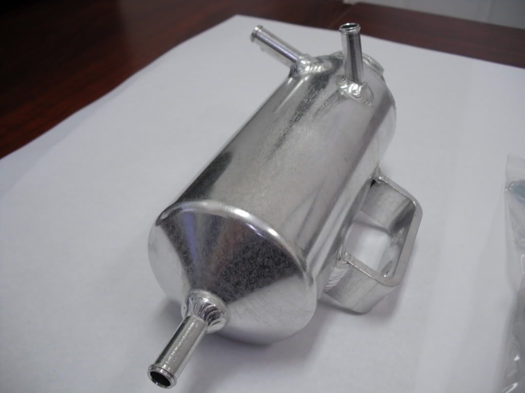

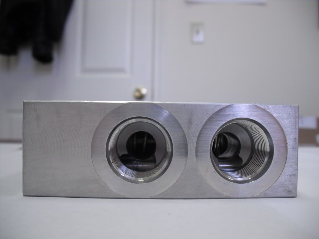

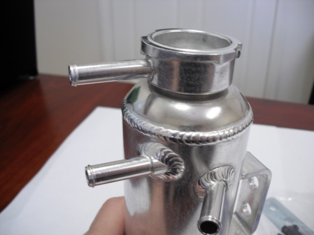

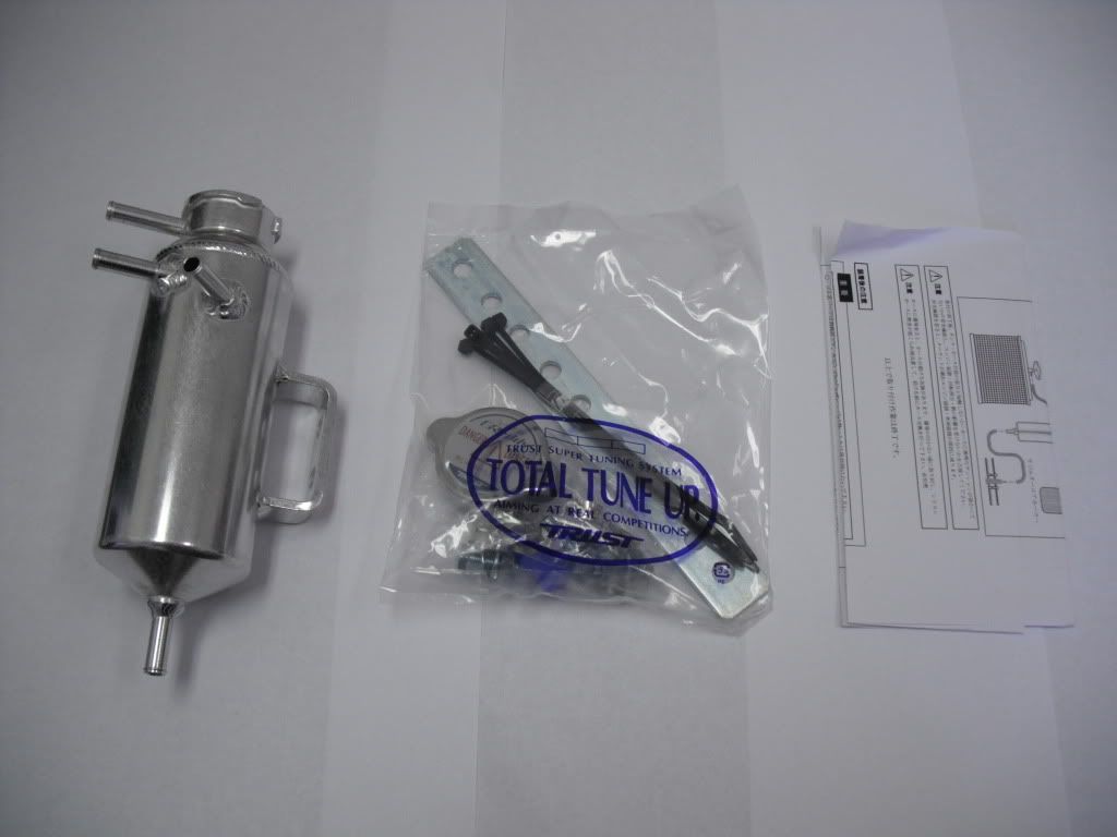

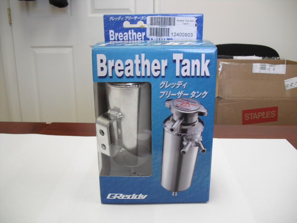

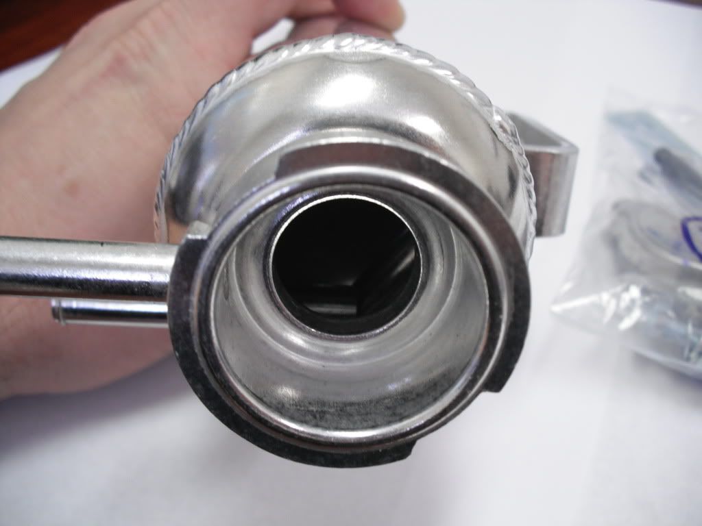

Just a little update - Greddy Breather Tank and Early Oil Cooler
Ordered some AN fitting to mod this but when I got the breather tank it was way smaller than I thought and basically my -10AN weld stubs ain't gonna work... So some -6AN on order and also a change to -8AN for the bottom connection, the -4AN for the top port is the right size though (1 out of 4 is bad, haha).

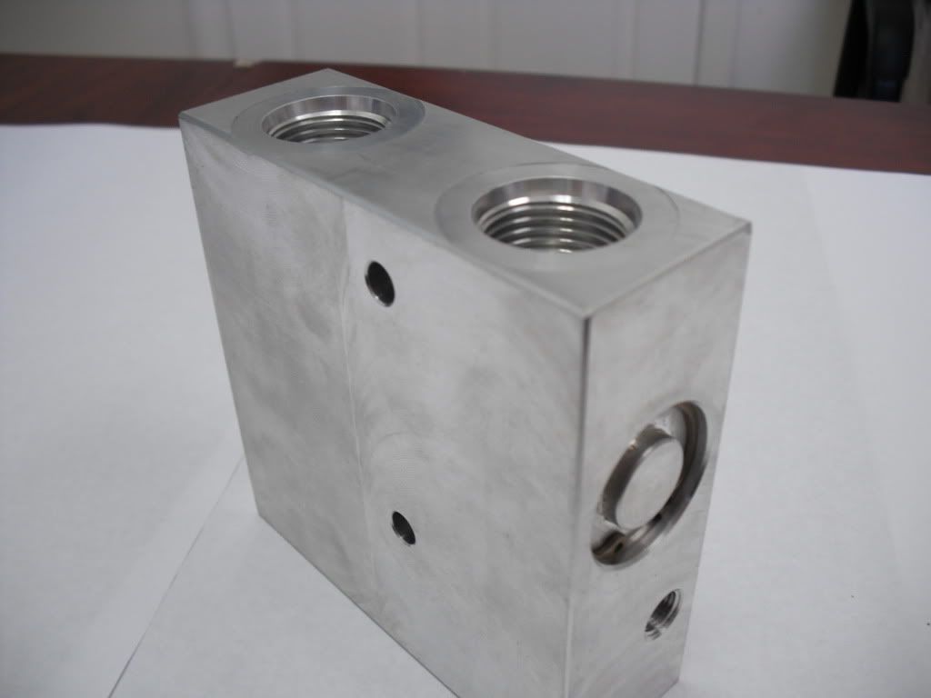

Oil Cooler - using this rather than a sandwich plate with the thermostat included

is it necessary to have a breather tank?
13 July 2010
567
12
Brighton-UK
It's not necessary to have the breather tank for a mild tuned car, but it won't hurt either.
The breather tank is there to help remove any air that's in the water system, any air in the water system reduces the surface area of water in contact with the radiator and also has a significantly lower heat capacity than water, meaning that the water flowing through the radiator isn't acheiving 'best case' cooling.
Additives like Red line 'Water Wetter' also help by reducing the surface tension of the cooling water to provide a greater surface area for the water flowing through the radiator to be cooled, more surface area of water in contract with the radiator surfaces provides the most efficient cooling of that water.
By using a breather tank you are venting this trapped air and therefore increasing the surface area of water in contact with the radiator surfaces and increasing the heat capacity of the fluid flowing through the radiator, i.e. increasing the cooling efficiency of the radiator.
This is more important in a track car where the cars on the limit for extended times, rather than fast road which isn't long duration or require maximum cooling performance.

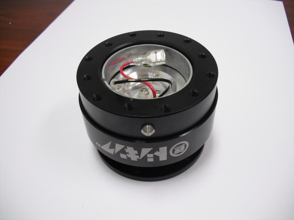

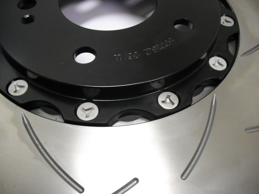

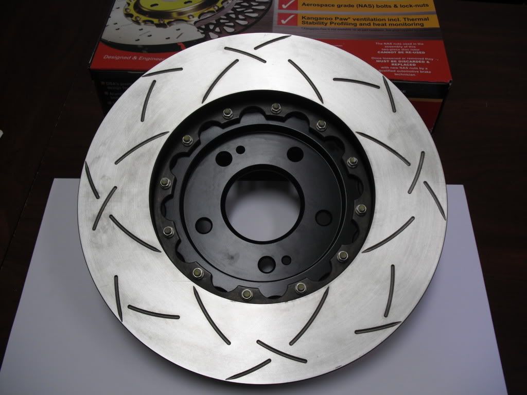

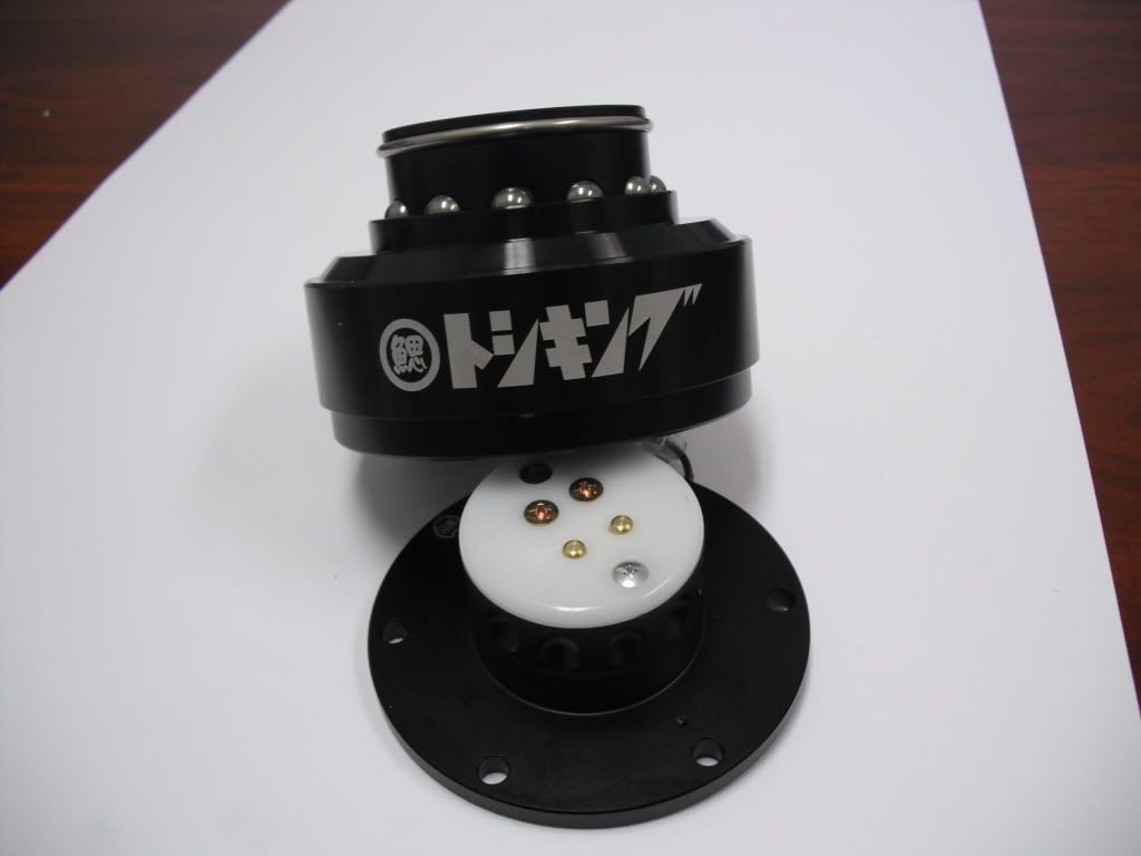

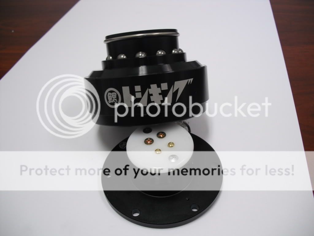

New Disks/Pads and Quick Release
Small update again, only added a few parts recently.
Works Bell Rapfix II - Yoshioka Special Edition
To be connected to a Nardi Semi-Corn Suede Wheel :)

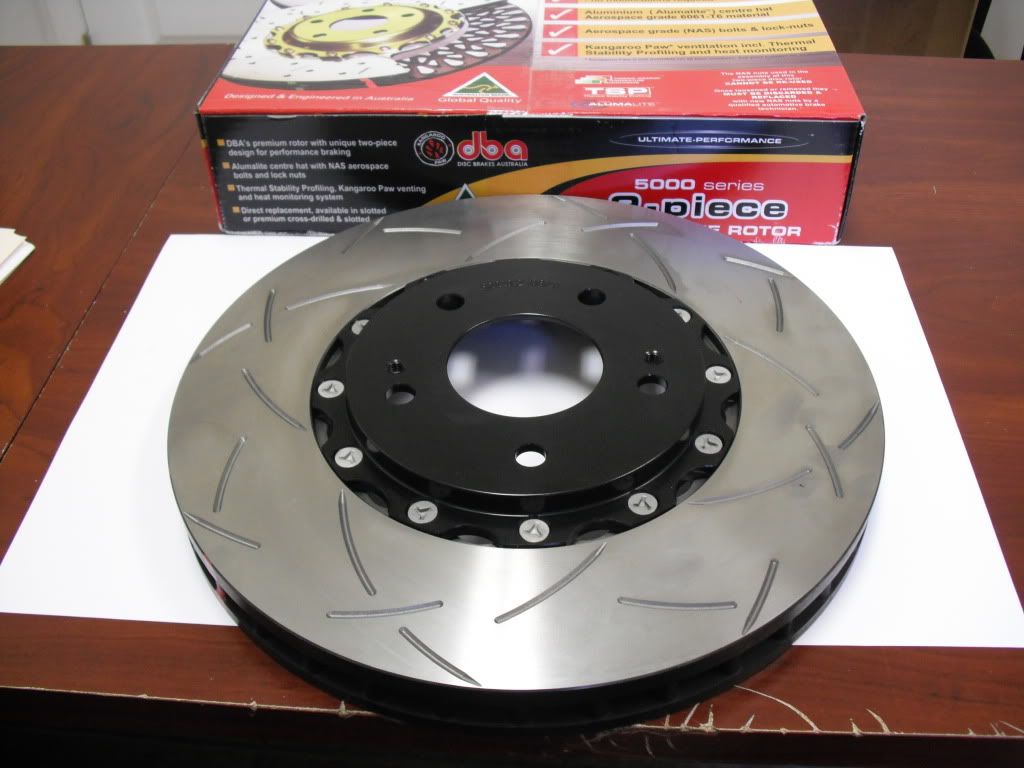

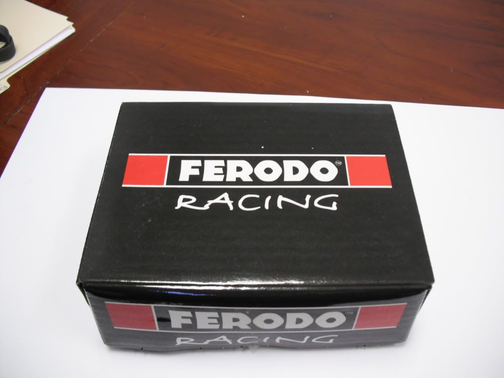

My mate who looks after my 15 has an EVO and bought off me the DBA4000/DS2500 kit i'd bought for mine to be used with my Brembo's, ultimately I will be going to a race spec brake set up, but for now I just want to get the Brembos on as the brakes on mine have a lot to be desired.
So I've bought a set of new DBA5000 T3 2Piece Disks and another set of Ferrodo DS2500.
That's it for now. Hope to send these home soon so they can get fitted...
Love the works bell snap off, totally jap! :) I am looking at a few different wheel and boss setups and that sounds nice, with the Nardi. (something I will be going with but not sure to snap off or not...)

woot! always wanted DBAs! nice.
Cheers... This is my second set now and I never did fit the first ones, lol. If I can get the bells off without damaging them i'm going to powder coat them red to match the Brembo's. :)
With so many parts non-JDM for this build, when I get the chance to have one, it's gotta be done. Wheel wise i'm still deciding between a Sparco Lap 5 and the Nardi. The Nardi is a bit more expensive but will likely go that route. IMHO you gotta go quick release :)

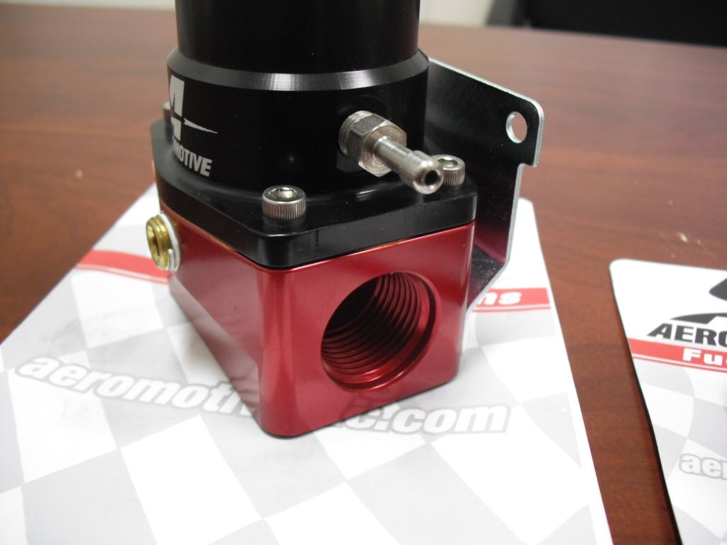

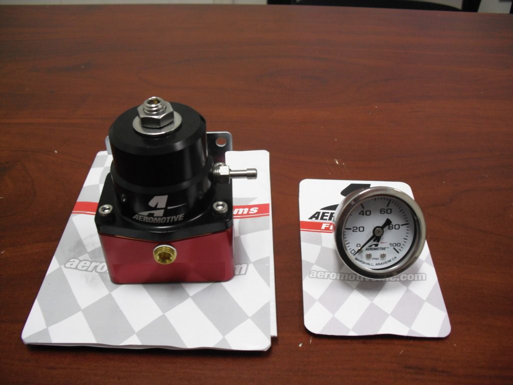

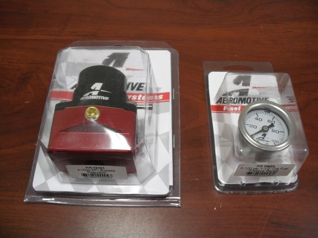

Just a little update.

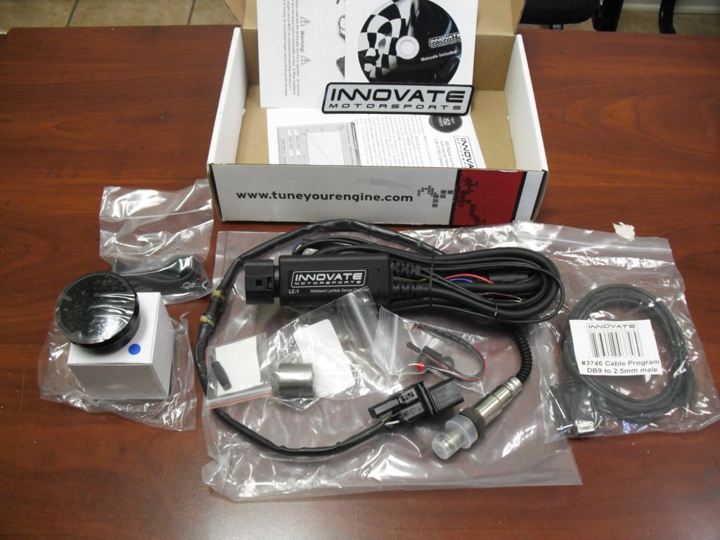

Innovate LC-1 Wideband Kit with DB digital meter

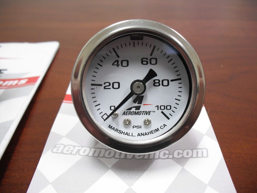

Aeromotive AN-10 Fuel Regulator and Fuel Pressure Gauge
Will have some parts for the VE head arriving soon :)
