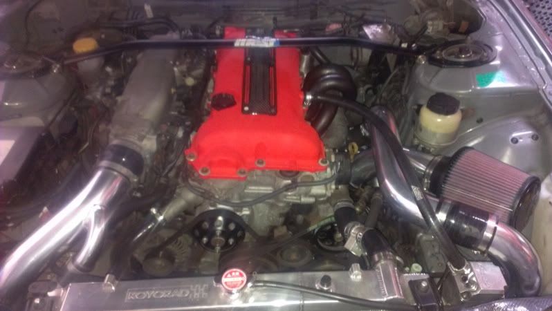

I did red crinkle finish on my rocker cover for the S15, it looks very cool. Have a look a few pages back.in my thread for pictures
Edit: I found a picture to save you searching

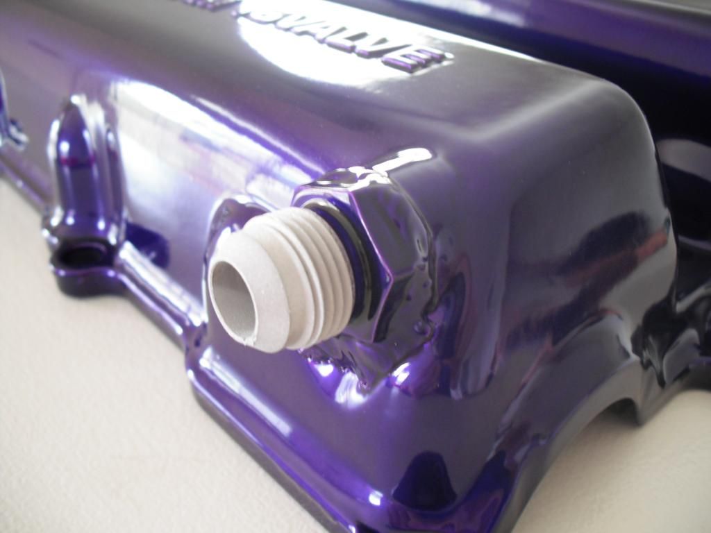

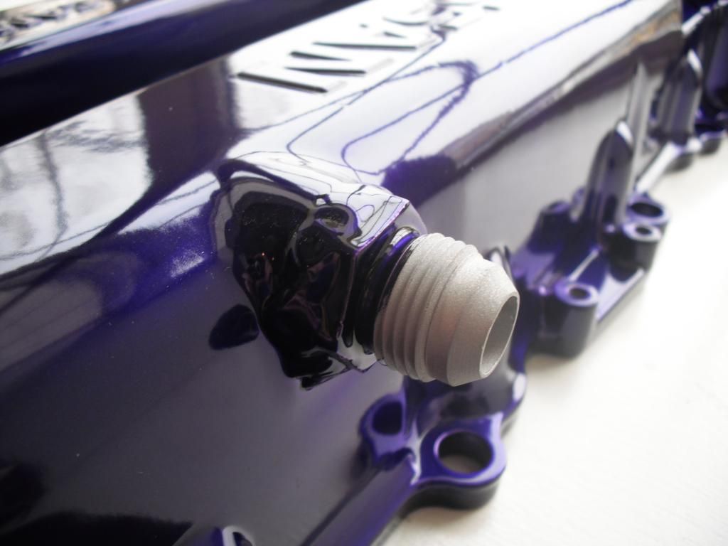

Had a look on their site and it looks like a proper quality finish, previously i'd only thought of having a flat finish but it's turning me around now. Maxworks always do the red crinkle on the motors they build so they must have a powder coater that does this, and you're very right in that I want it to be perfect so little things like this will bug me, i'm not over the moon with the welding on the rocker as it is, so looks like i will have a spare rocker in the end. (shame as it's cost me over $200 for the welding and Earls AN fittings already :( )

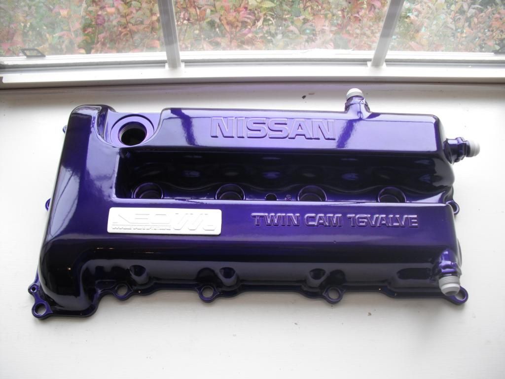

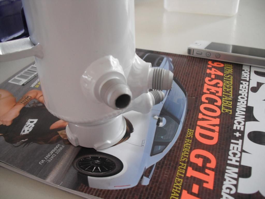

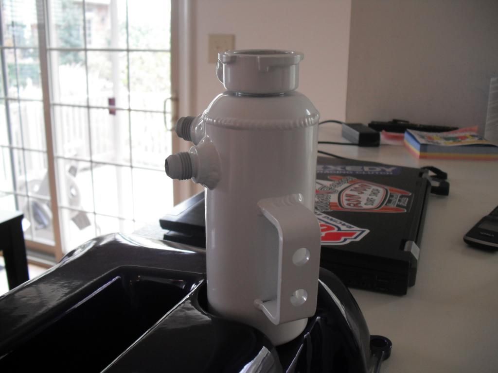

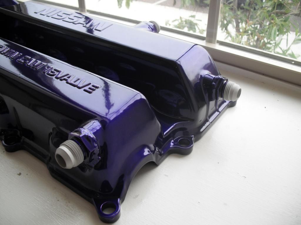

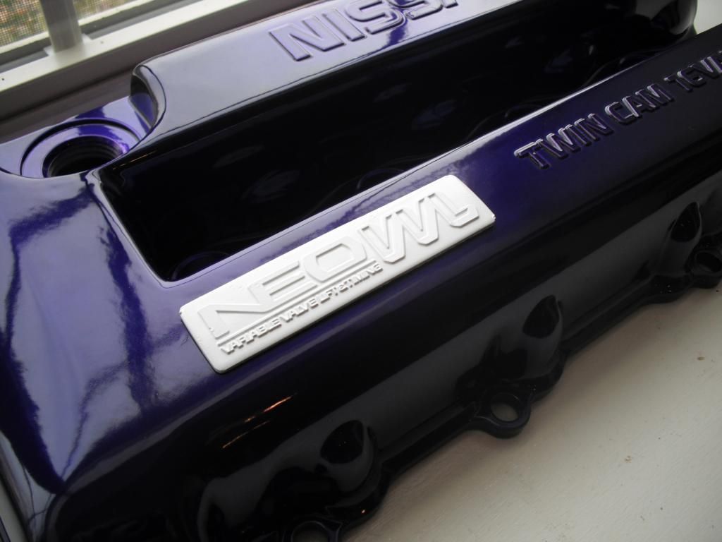

VVL Rocker Cover and Water Swirl Pot (Powder Coat)
Got my parts back from the coaters, they've done a good job to be honest.

Cheers mate, the lightings pretty rubish in my house so the photos haven't come out well, but i'm happy with it. My little helper has run off with the Greddy cap for the swirl pot, don't know if i'll see that again :(
The VVL plaque is off as it was removed for the coating, they coating the plaque in the end which was a bonus as I though i'd have to paint it. Need to glue it back on.

Ha ha gotta love kids!! Can still see the colour well in the pics though on the corners etc you can see the depth of it, looks really nice!

I really like that, looks better than I was expecting.

Cheers, I think it's come out well, plus it hides the dubious welds the shop did :)
Still might go to a P12 cover but this will do for now.

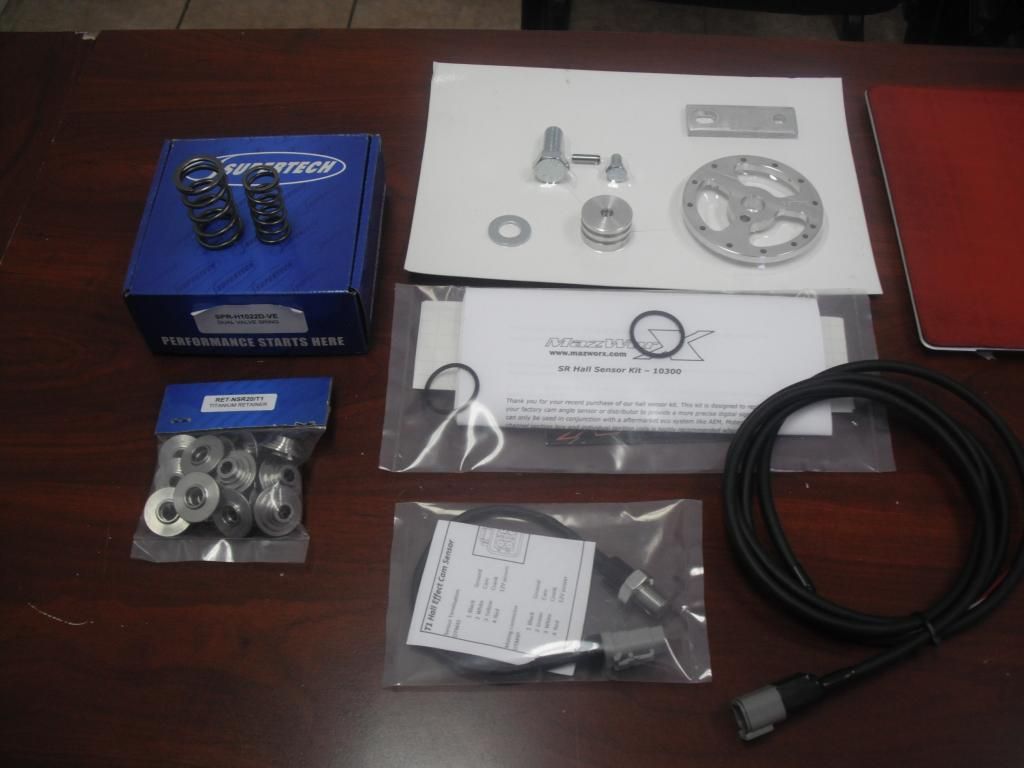

Hall effect cam sensor - and double valve springs
Now for some new parts.
As the VVL head is normally fitted to traverse engine layouts and ours are longitudinal, the CAS is fitted on the right hand side (traverse) but now longitudinal it's at the back of the engine bay hitting the bulk head.
Some people still fit the CAS there but typically fab is required. So the other option is to fit a Hall Effect Sensor Kit on the cam itself, this is the route i've gone.
Still working on the final parts for the head, I just got the Supertech Double Valve Springs and Titanium Retainers :)
All this lot from the wife for my Birthday, game on !!!
