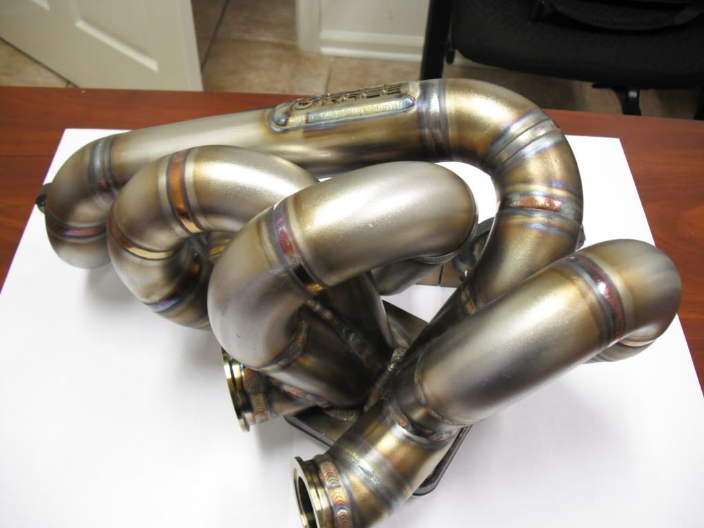

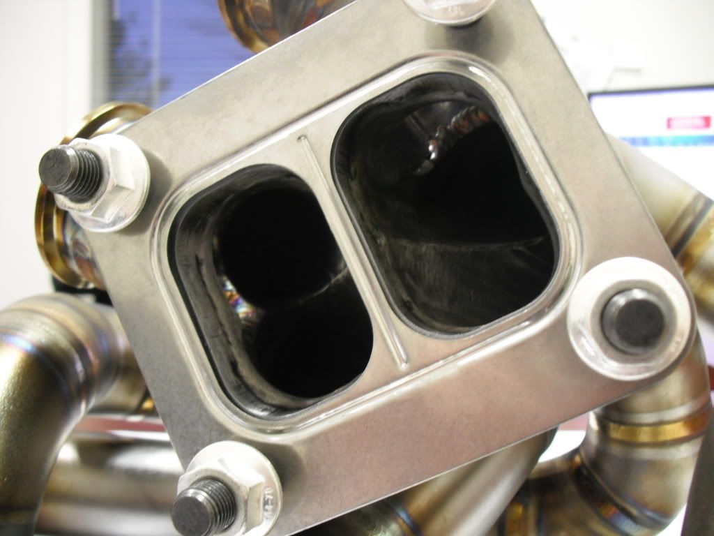

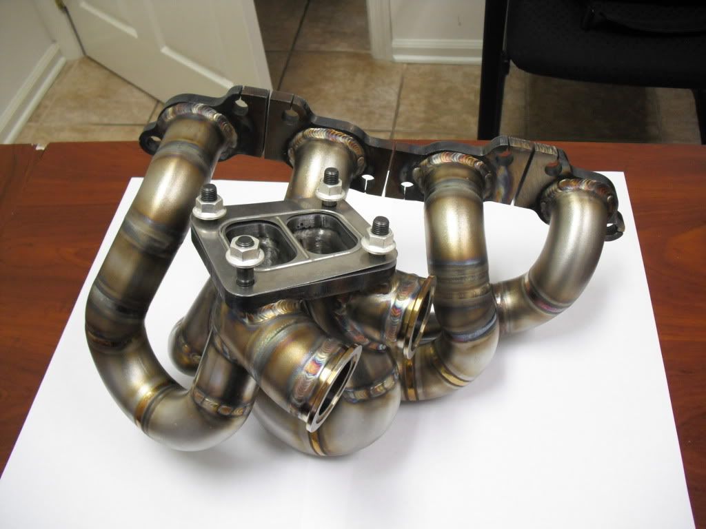

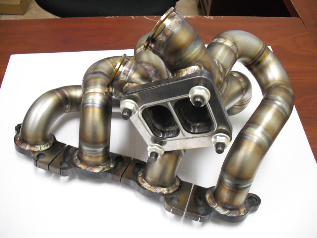

FULL RACE SR20 Twin Scroll, Dual Wastegate with VE Flange.

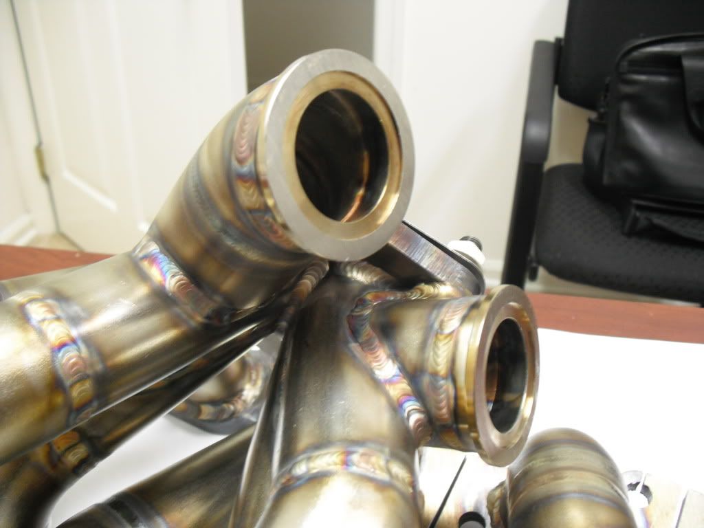

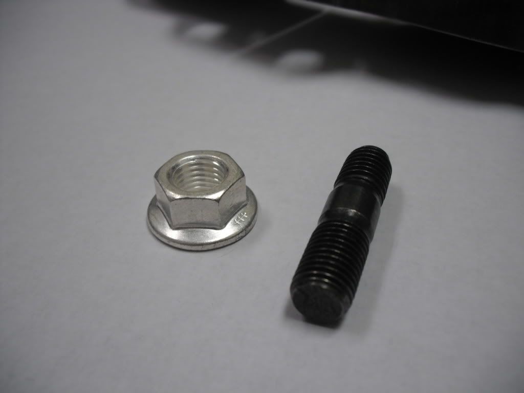

These are the Inconel and Silver Plated nuts for the Turbo connection, these apparently don't need wiring and are guarenteed to secure the Turbo apparently.

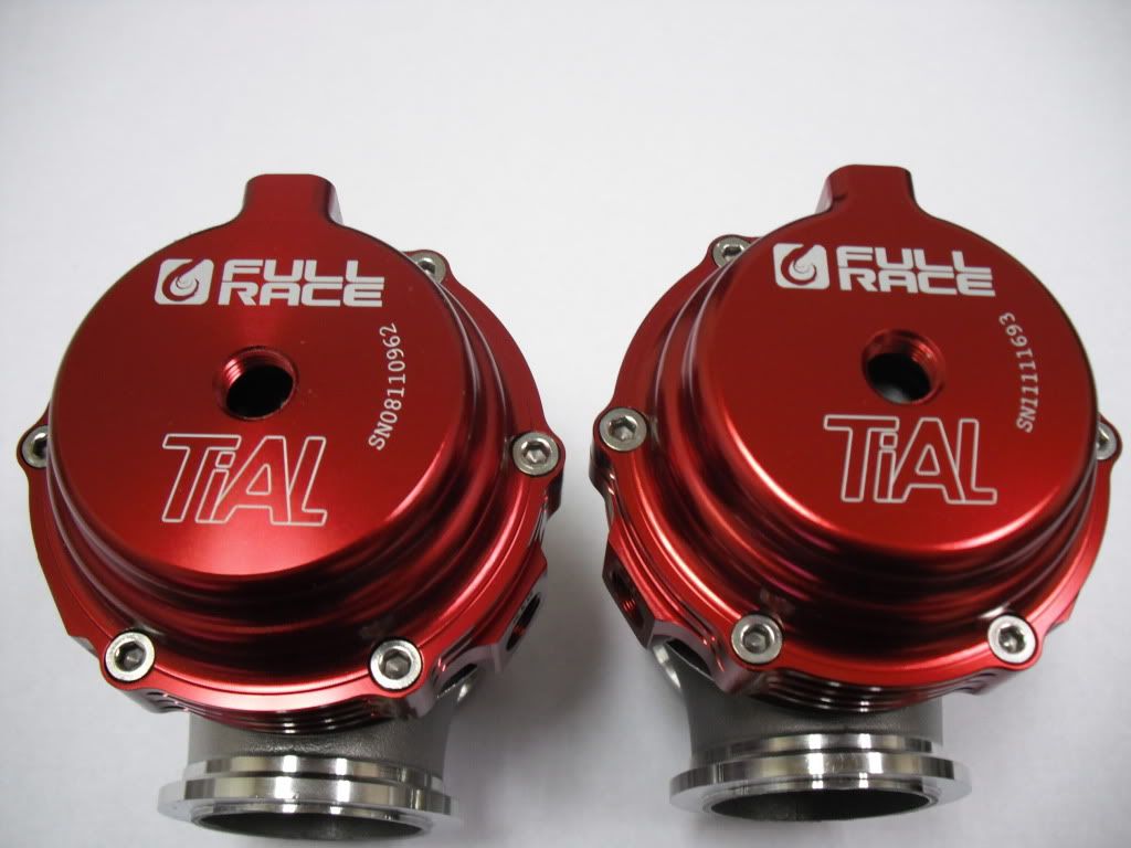

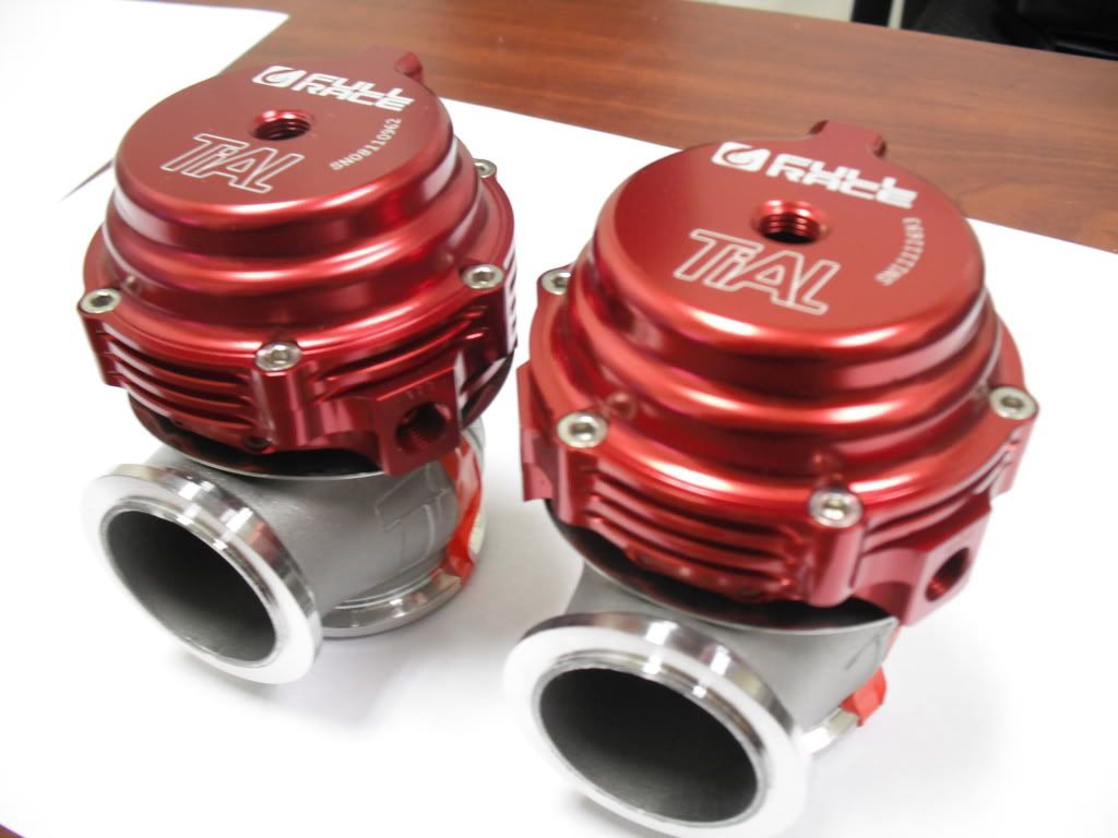

Twin Tial 38mm MV-S Wastegates with the nice Full Race logo laser etched, me like...

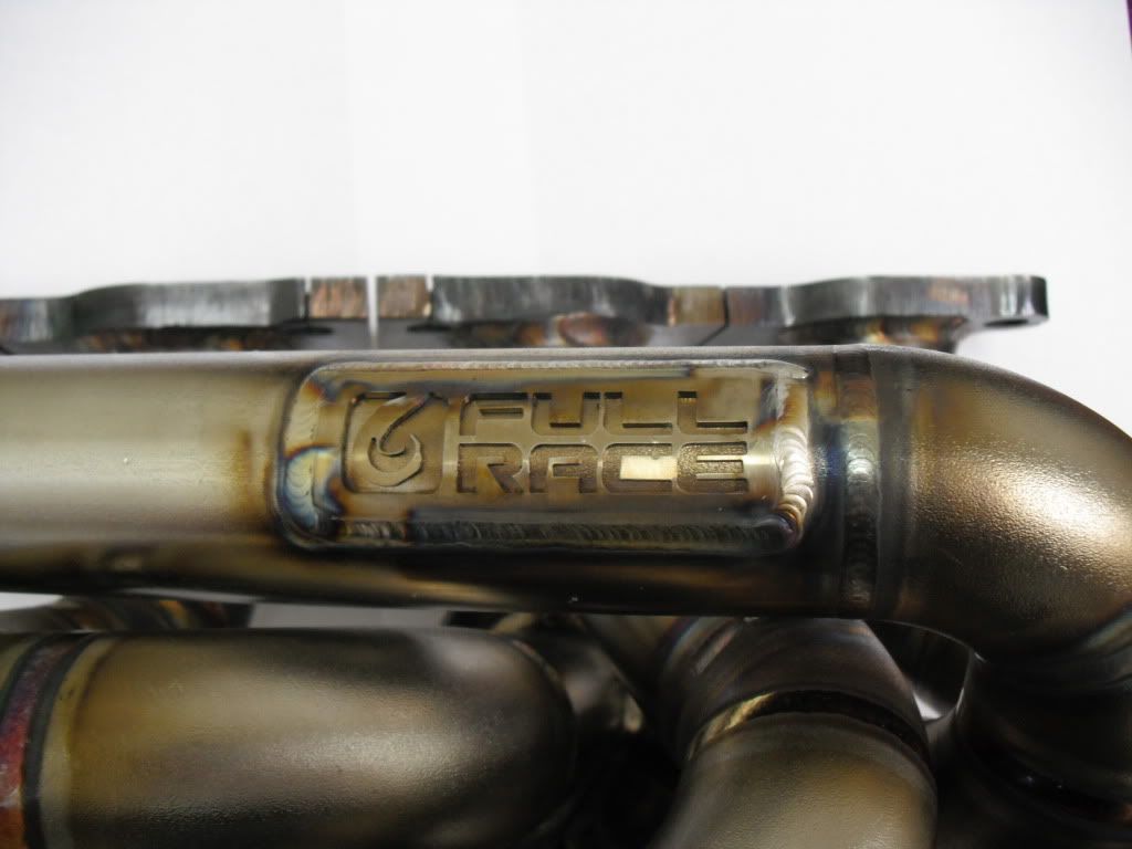

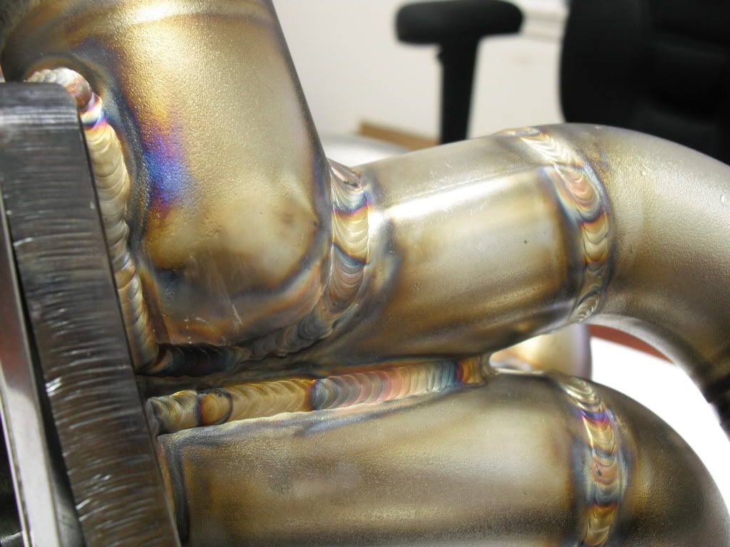

This Full Race stuff really does look the part, well impressed.

Work of art that manifold!

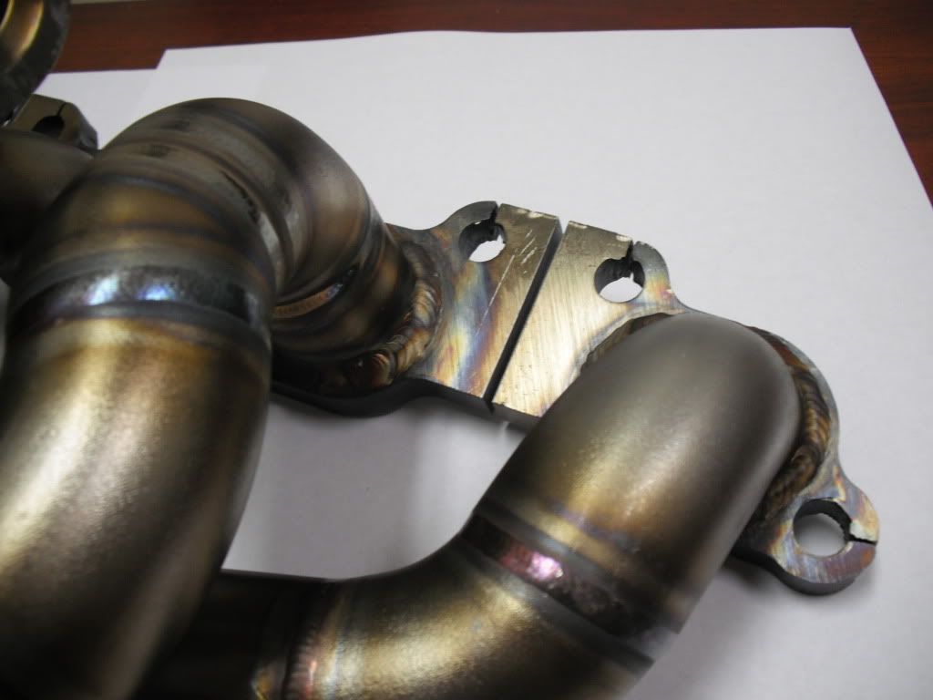

Never seen one where the back plate is split like that, its usually just one piece...spose when its done up tight it wont make a difference?
Woah, that looks expensive, and cool :)
Just a question, why would you need two wastegates?

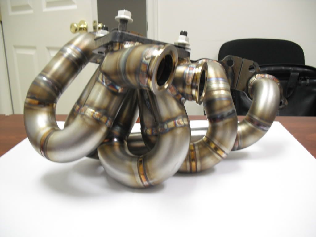

Wasn't cheap that's for sure, but it's a long term build so taking my time to get the parts I want.I'm getting a twin scroll Turbo, so it's a twin scroll manifold and each scrol gets its own wastegate. For a single scroll set up would have gone for the usual 44mm wastegate, but as there's two went for the 38mm versions.

I've got a Full Race manifold too, they're awesome quality. They're worth the money personally.
The head flange is split into sections from a few custom exhaust manifold manucaturers. Powertune in Oz do it too, as my twin scroll one had it from them, it appears to give a better sealing face to the cylinder head flange.
