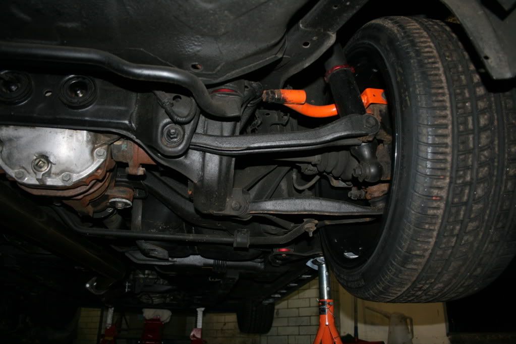

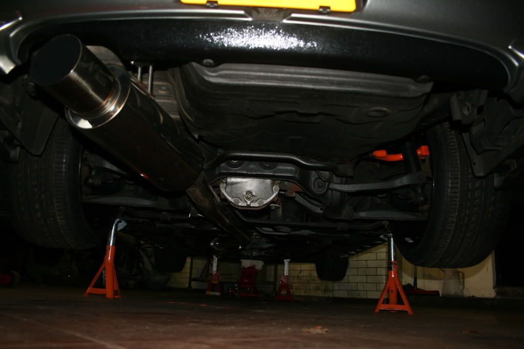

Where did you support it on the rear, its just that in this photo -
It looks like youve done it on the triangle bracket thats attached to the subframe..but you cant drop the subframe when its here?
My stands are on this bracket now as that was the only option as the chassis rails are to far forward and not strong enough and I dont have any blocks for the stands...and the box section around that bracket isnt strong enough even if the stands were flat?
So any help would be great as I dont know hows best to support it and be able to drop the subframe!
Thanks and im looking forward to more photos of yours now its done :D
I supported it on the sill jacking point but you have to cut bits of wood up so it supports the weight of the car on the actual sill plate rather than the lip as it would just be crushed. there is a strong point on the inner side of this. Funnily enough, I asked Dean this exact question and he gave me this info which originated from 'Petrol' on SXOC IIRC. I supported the front on the inner wishbone mounting points with jacks and foam pads.

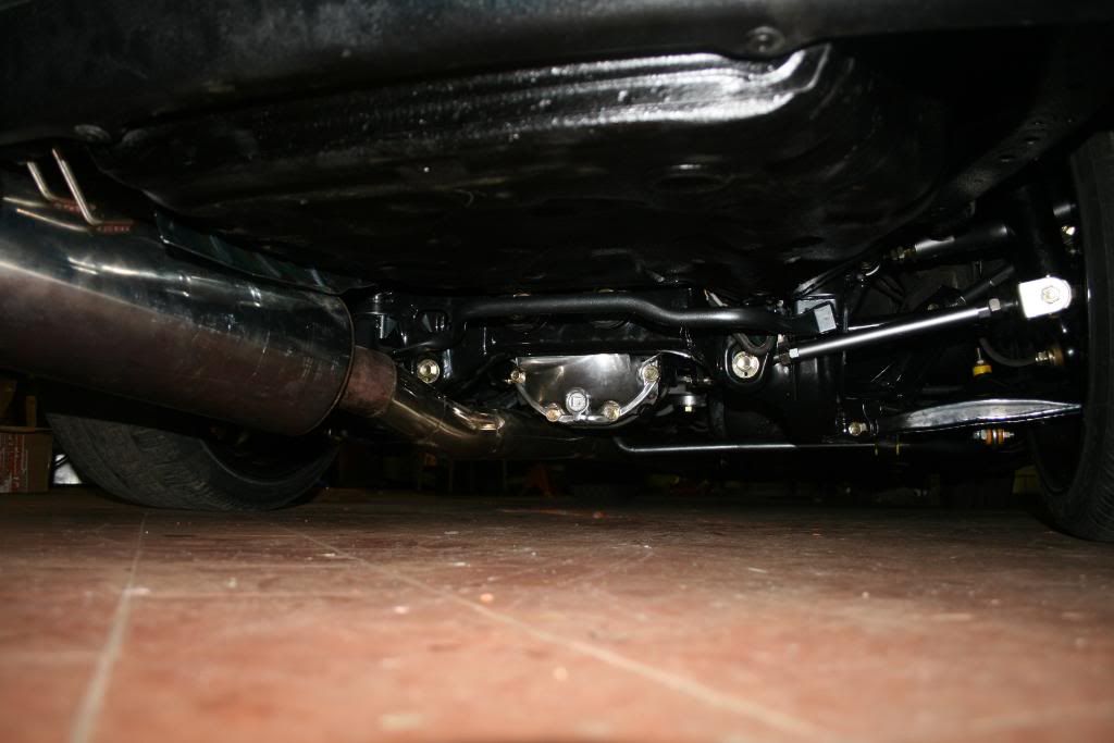

Here are the photos at last. It is really difficult to get a decent pic of it as an assembly because of the dark colours but here is what I have so far..

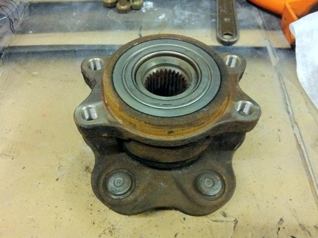

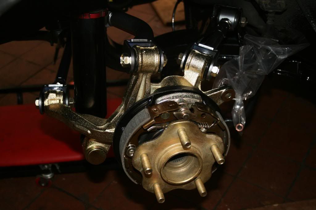

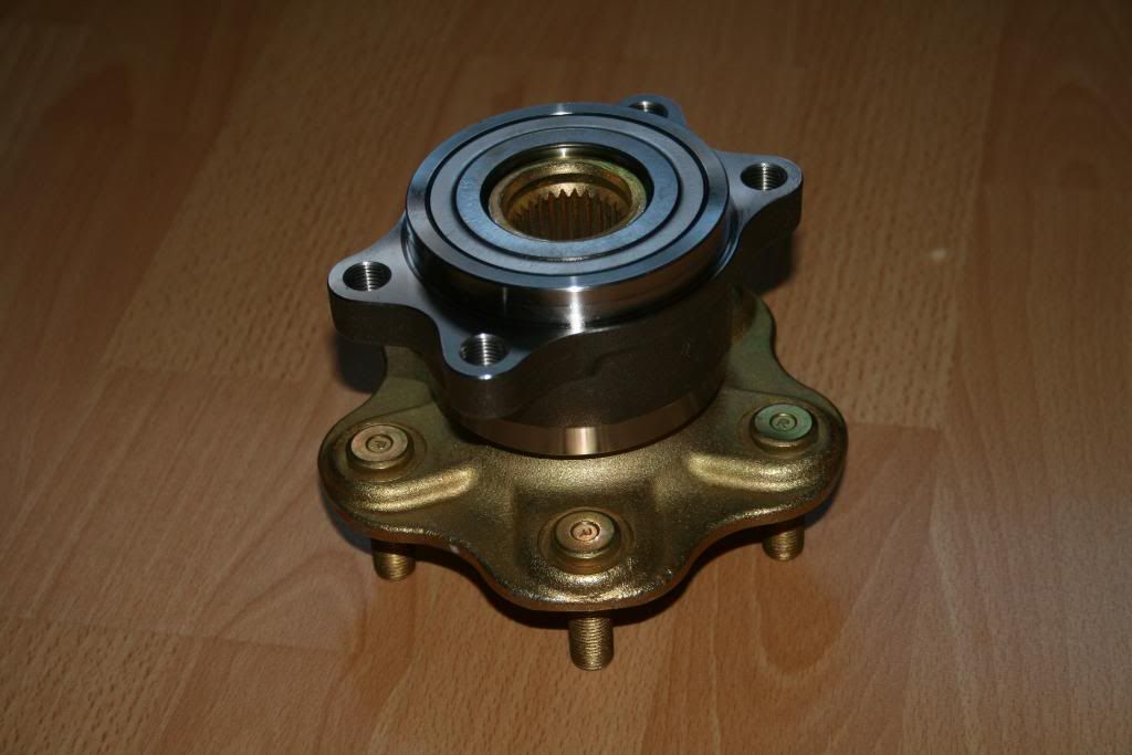

Wheel bearing and hub assembly was a bit crusty so I plated the hub and fitted new bearings. They went from this..
to this..

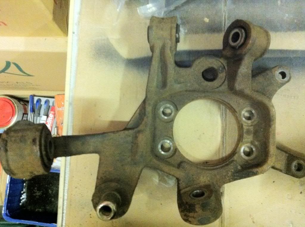

The hub carriers were stripped and replated to their original condition. The main reason for doing this was because they were originally like this from the factiory and the thickness of the plating would not compromise the fitment of the bushes. Before..
And after..

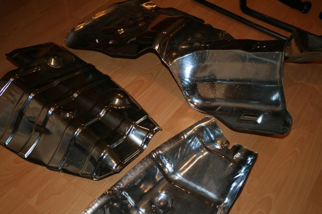

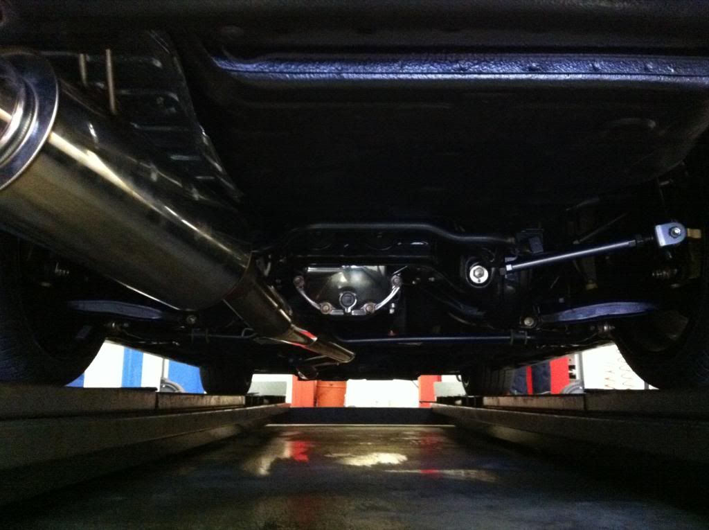

Exhaust heat shields had a couple of rusty spots and were quite dull so I had these replated too. I decided to stick with the silver finish on these because this is how they were originally, although the yellow finish does have better corrosion resistance.

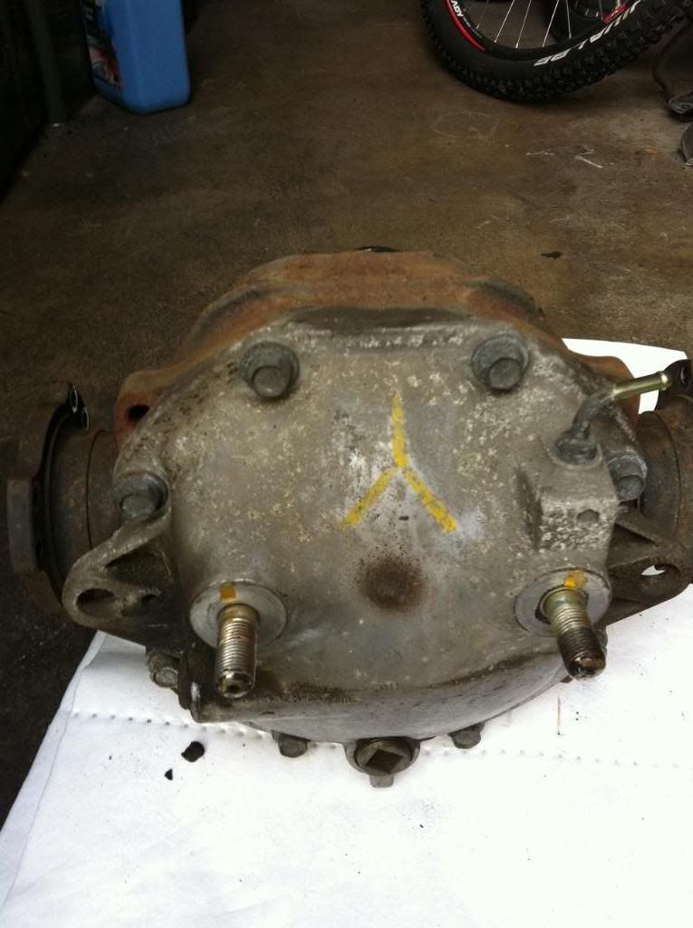

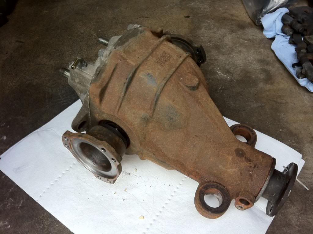

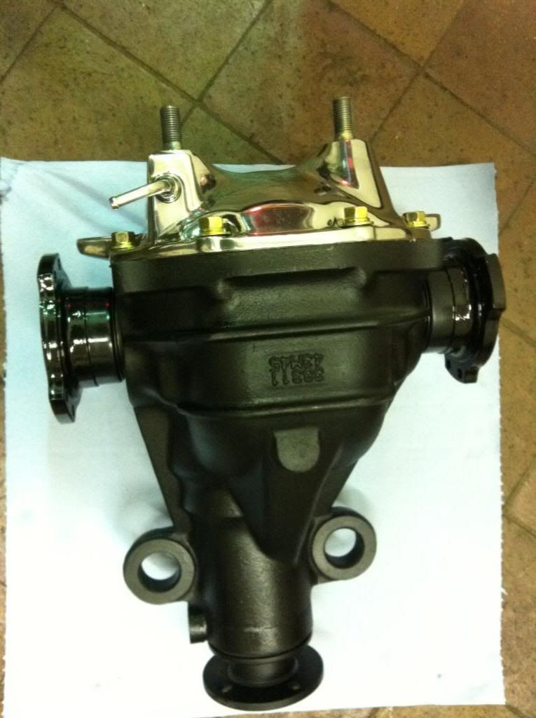

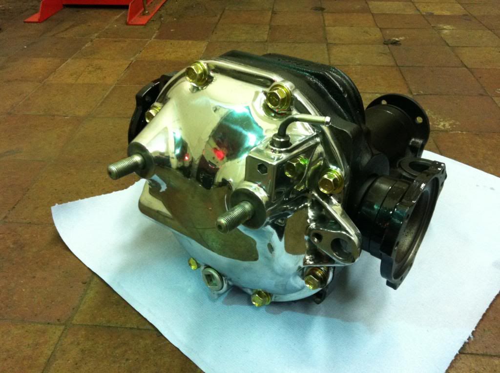

The diff cover looked ok before hand, but when I removed the diff it had clearly seen better days. The diff cover was polished, diff case was wire brushed, zinc primed and painted matt black. Bolts were re-plated and half shafts were finished in gloss black to match the driveshafts.
Before..
And after..

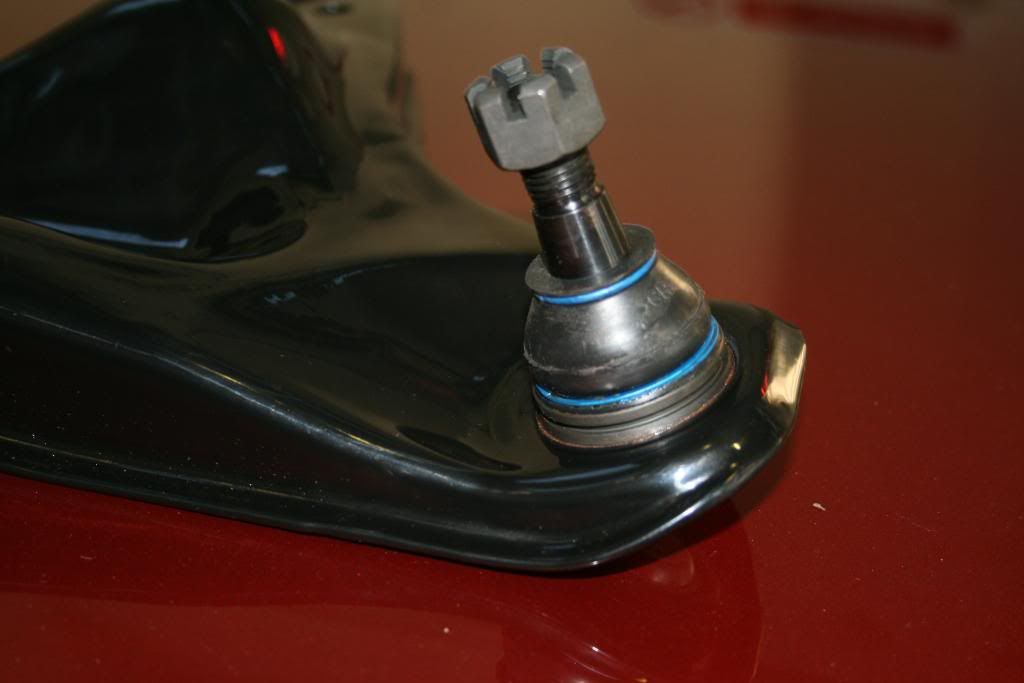

New ball joints fitted to the rear lower arms..

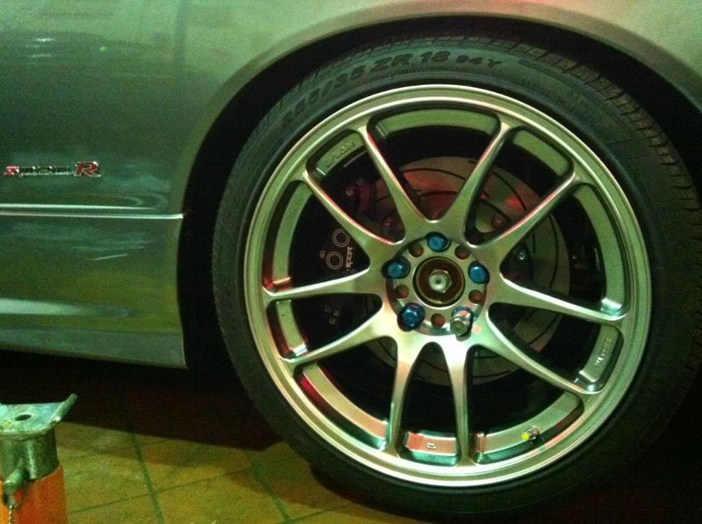

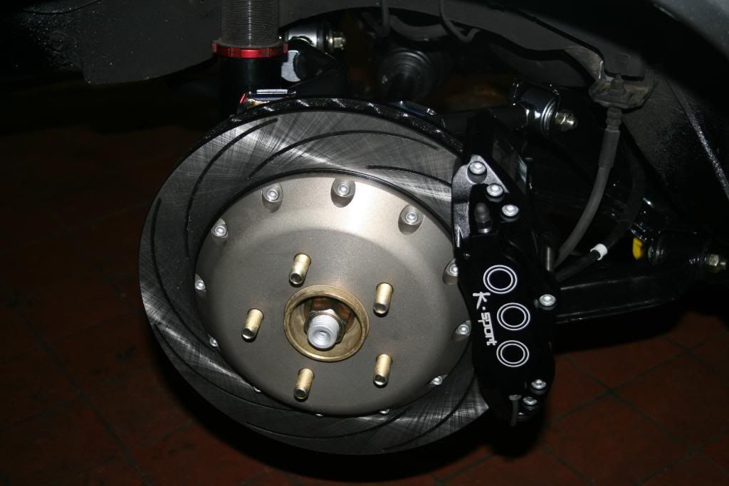

Brakes - the main reason why all of this took place! Then one thing lead to another :rolleyes:
General before..
And after..

The ball joints were really easy to fit. Don't try pressing them in as they really don't need it - the circlip holds them in place once fitted, not the pressing force. I found this out when I took them to get pressed out and my mate put them in the vice and one knock with a hammer and they were out!
Make sure you clean off all of the new powdercoat or they won't go in and it'll probably chip off. Smear a bit of copper slip around the edge and then line the ball joint up as well as you can by hand. Then, support the arm on some wood/cloths and hammer it home with a socket over the end. It's obvious when it's in properly, then fit the circlip. :)
