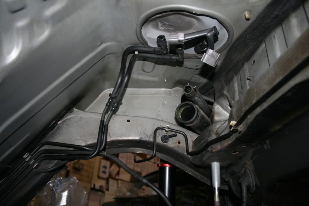

I removed the tank now and given the whole area a degrease. Going back tomorrow with the wire brush to remve a couple of rust blobs that I found, which will be followed up by some zinc primer and this..

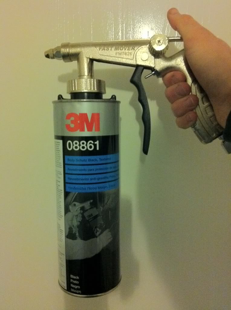

I sell that at work the 3m 8861, its id say the best schutz on the market, doesnt seem to crack, holds weathering well and is the 'right' shade of black lol.
You can get this in aerosol form aswell dean!

Yeah, I'd had the 3M recommended to me by a few people so thought I'd give it a go :)
I went to apply it today but ended up spending more time working on other peoples cars, so only had chance to degrease the underside again! TBH, once it is all prepped and masked, undersealing will probably only take 10-15 mins. Most of the time has to be spent on the prep, as always.

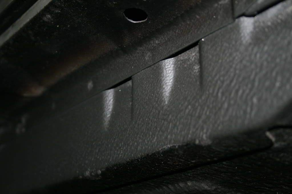

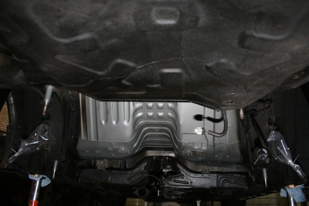

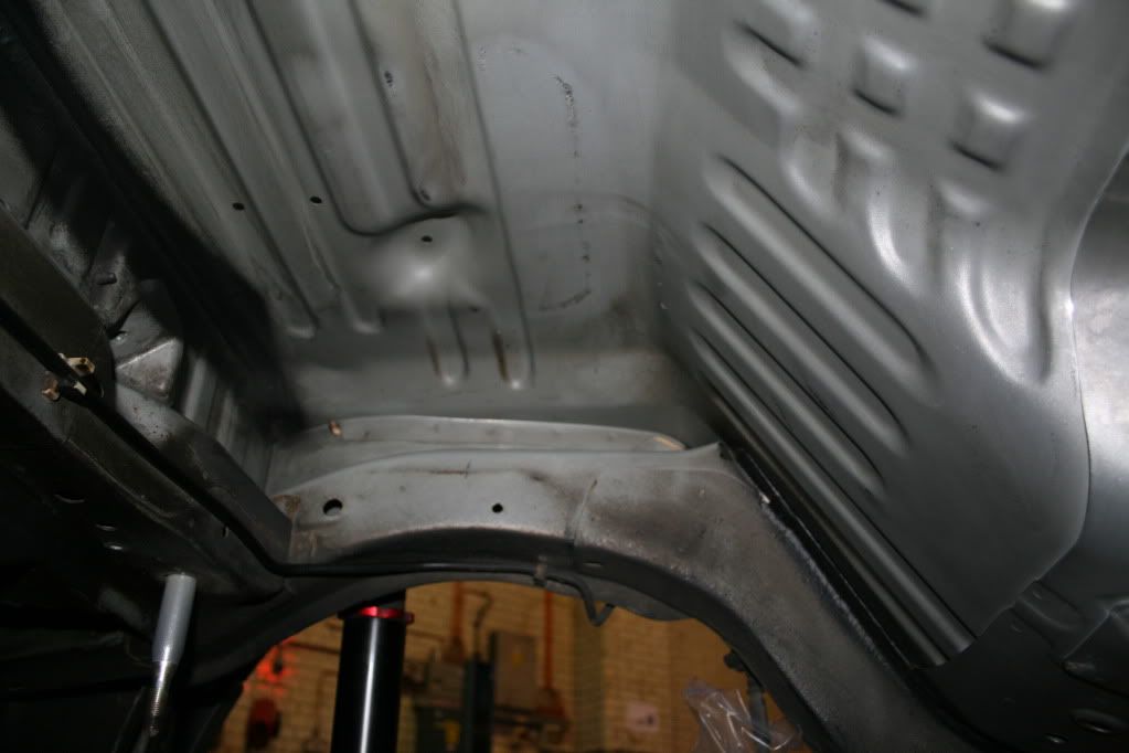

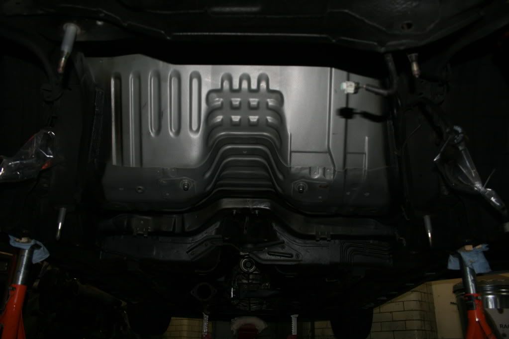

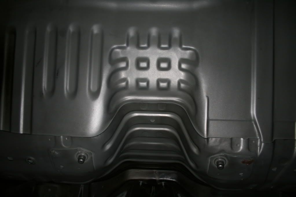

Here are some photos of the underside that I took today after cleaning it up a bit. You can see how well the underseal has protected the underside from the elements. If your S15 is not undersealed and you use it every day then get it done ASAP, preferably on import like mine was.
1 May 2010
830
Wolverhampton
Underneath isn't bad at all!
Wire brushes and drill attachments will clean it up nice along with the Deox gel if needed!
Quick question - Are you checking torque measurements before you remove everything so you can torque it all back up to the required tolerance when it goes back together?
I haven't got a torque wrench you see and was just planning on removing things and then putting them back on tight but it occurred to me that things like prop bolts, and sub frame bolts may well need to be torqued up... More money too spend! :down:
In the end there was only 3 patches I had to grind back, 2 of which were where the fuel tank rubbed. Theres no proper way of checking the torque before removing the bolts. I might get the torque wrench out on a few of the bigger ones but most will be done by feel - which may sound bad but it isn't :)

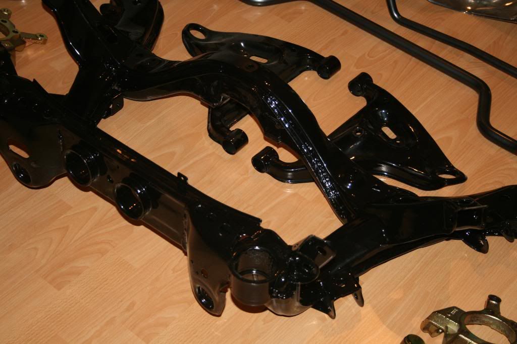

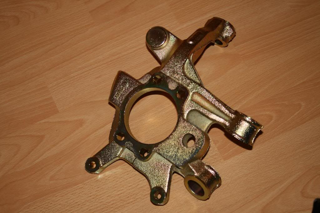

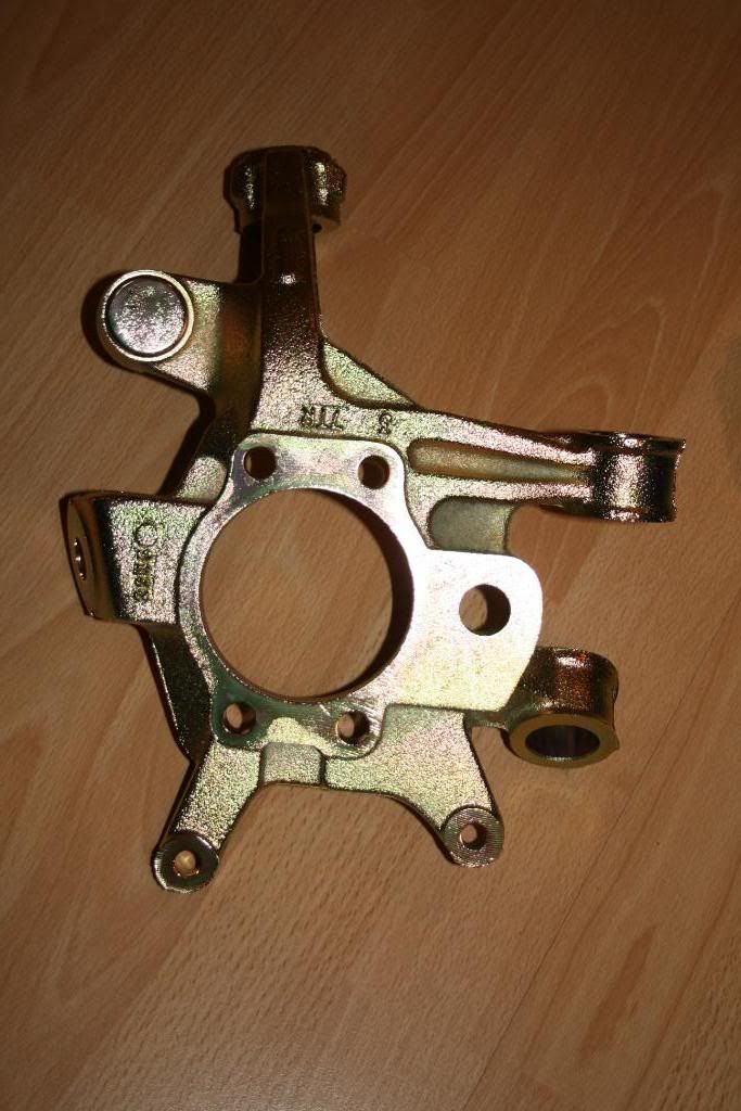

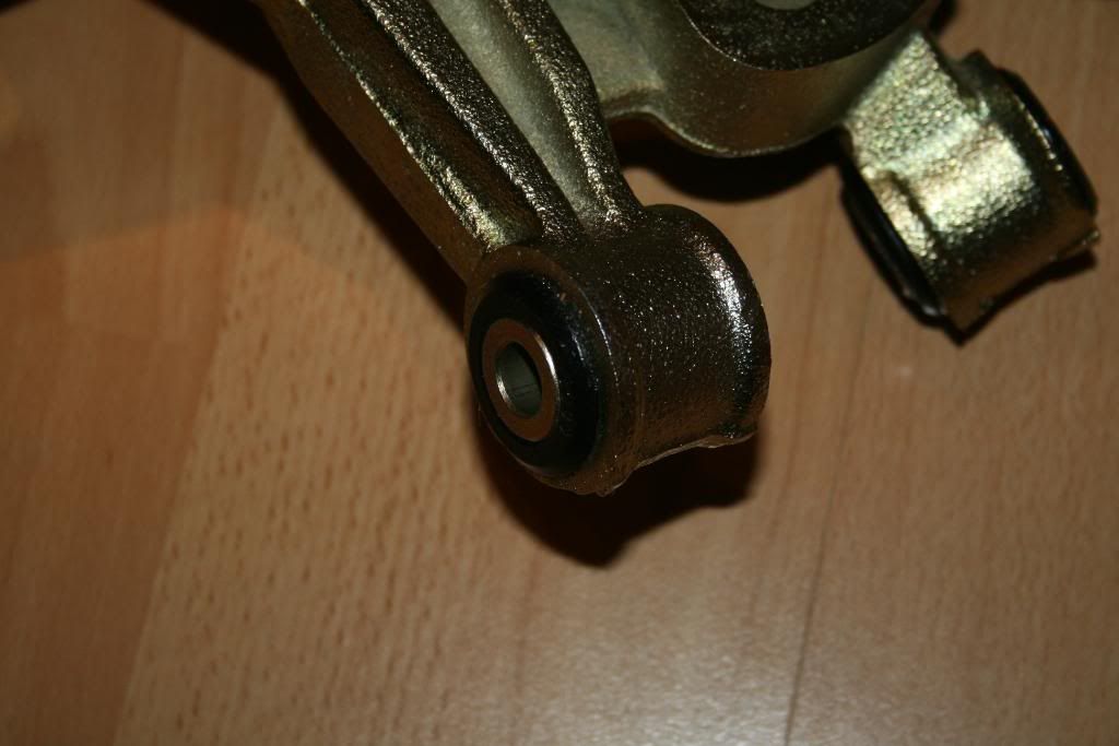

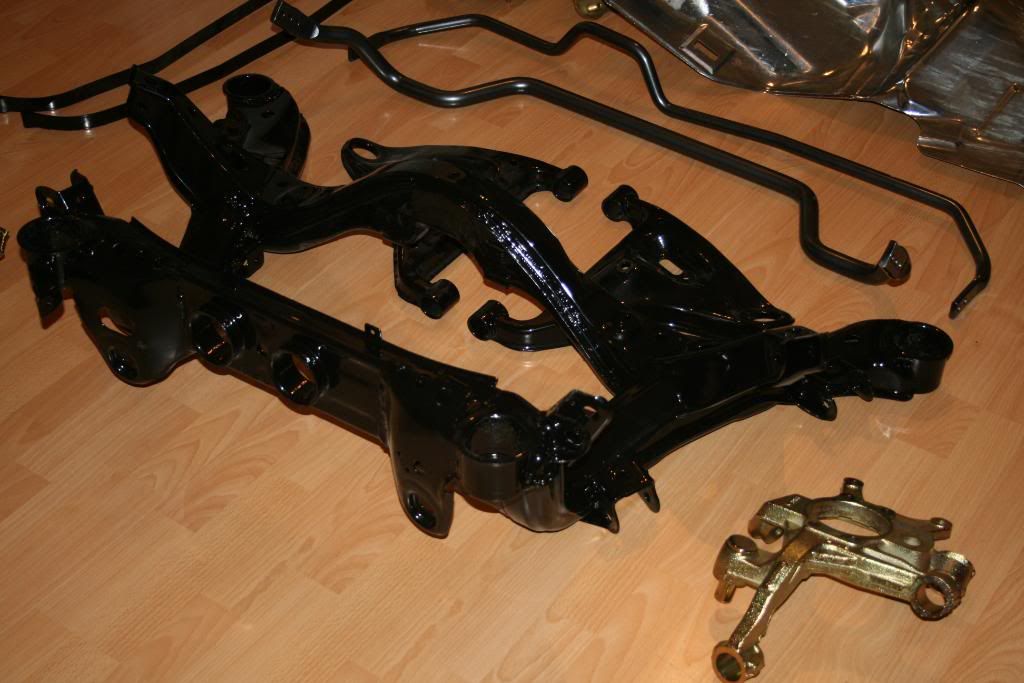

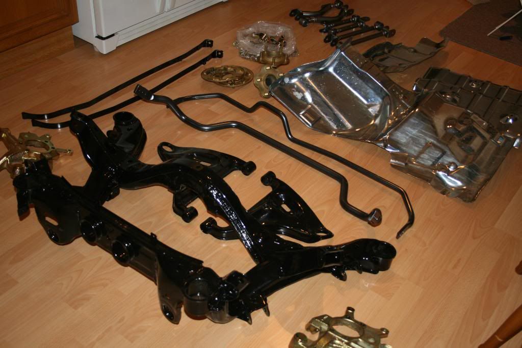

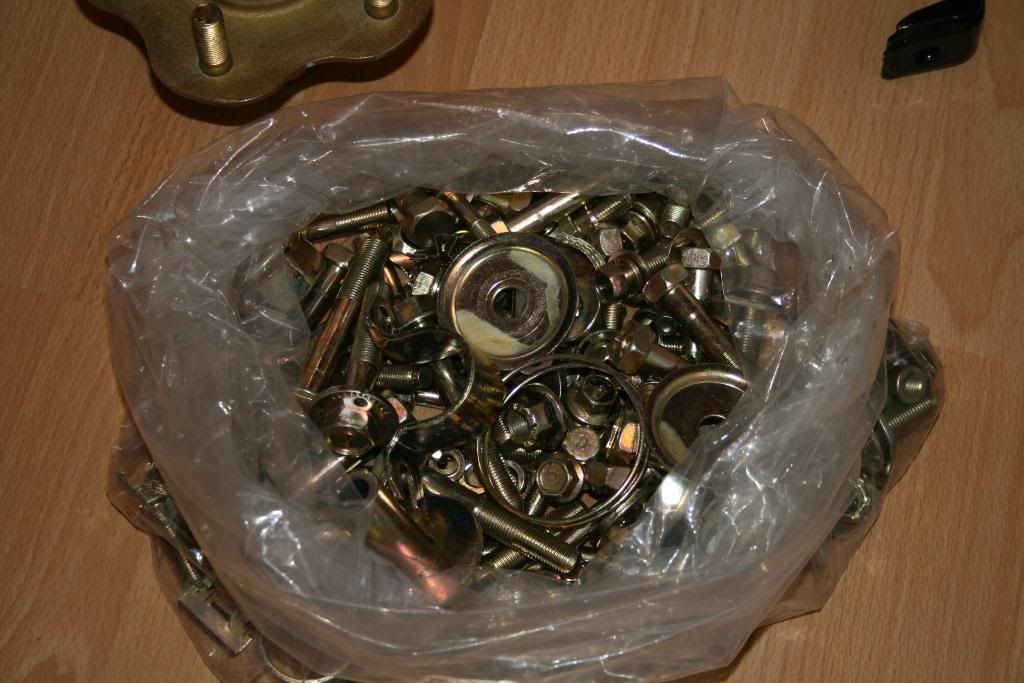

I've been a busy bee today. Firstly went to Apex's office to pick up an alignment kit, then came back and took a load of parts to the powder coaters, metal platers and metal polishers - (stealing Dean's idea for the diff cover)! Theres nothing much to see at the moment until I pick it all up on Friday morning but I did manage to underseal it the other night. Time to go and package some cooling panels now! :wack:
Time for the next update. I collected all of the parts today that were being powder coated and plated. The guy who's polishing my diff cover is a massive knob and wasn't there so I couldn't get the diff cover back, which means I can't fit my diff until I get it back :(

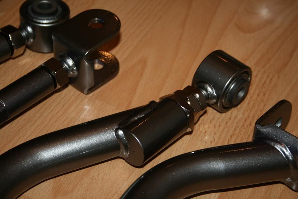

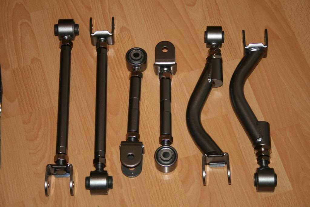

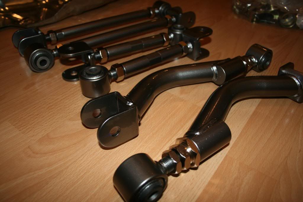

I bought a set of Apex/Hardrace adjustable bushed control arms this week too. I didn't like the colour of them at all so decided to do something about it. Powder coating wasn't an option as the heat would kill the rubber bushes, so I took them to LittleKnocks yesterday and Martin very kindly stayed 3 hours after work and painted them for me, so they are now a nice shade of WV2 - Nissan Sparkling Silver - aka Pewter :D

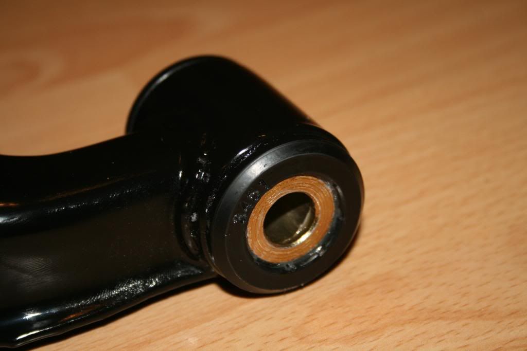

The subframe, lower arms, fuel tank straps, and subframe mount plates are black. The Whiteline ARB's and the strengthning bar that goes between the 2 rear subframe mounts are a metallic graphite grey to break up the black and blend the body coloured adjustable arms. All rear bushes will be Energy Suspension polybushes in black, which are supposedly inpregnated with graphite for self lubrication. Hub carriers and hubs have been re-plated, as have the exhaust system heat shields. It may sound daft but a lot of thought has gone into the colour scheme underneath!

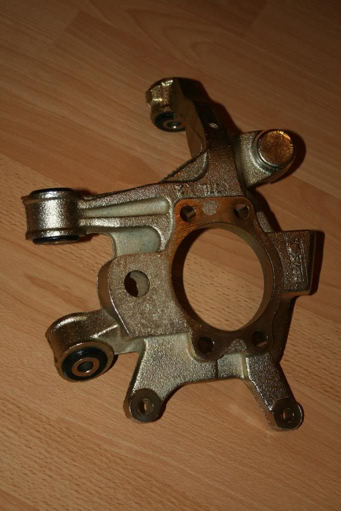

Tonight has been spent inserting the Energy bushes into the hub carriers and lower arms. They were a bit of a faff to fit as they are 1-peice bushes but it was worth it as they fit like a glove :)
