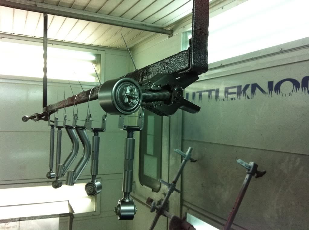

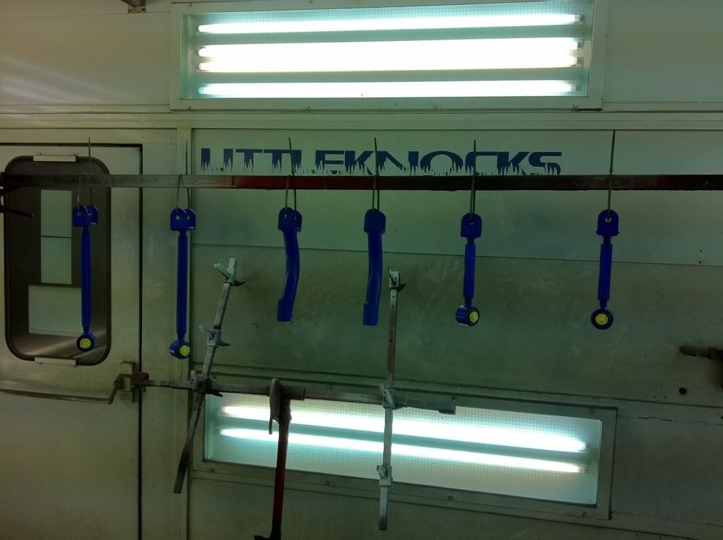

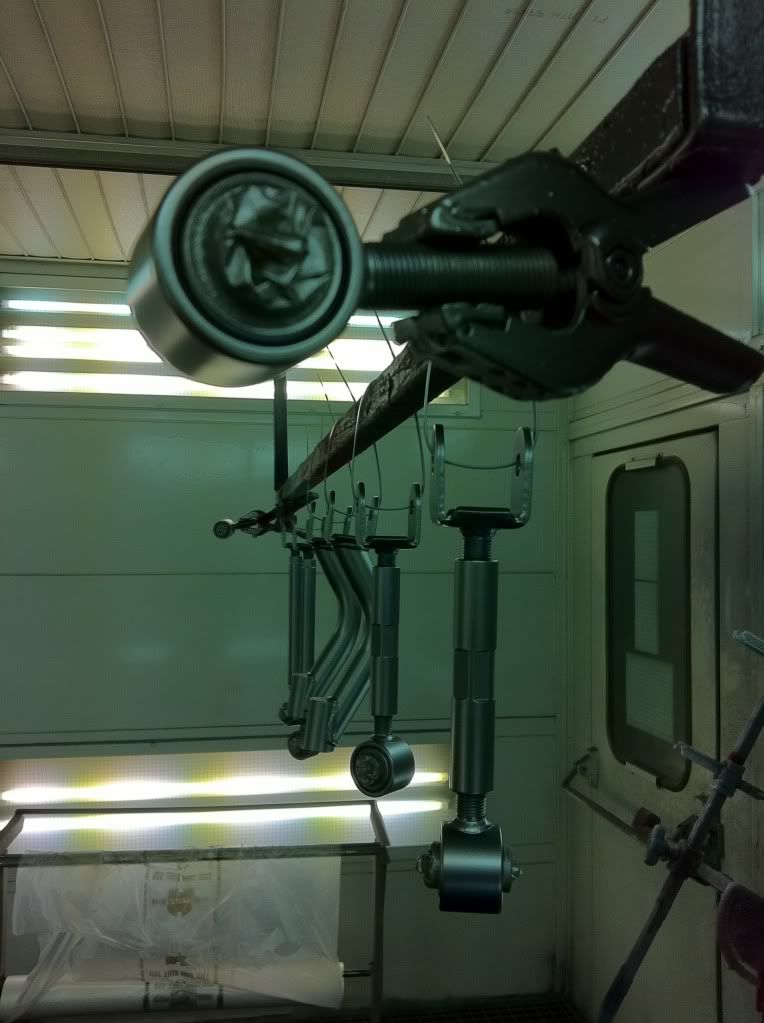

Adjustable arms went from this...
To this...

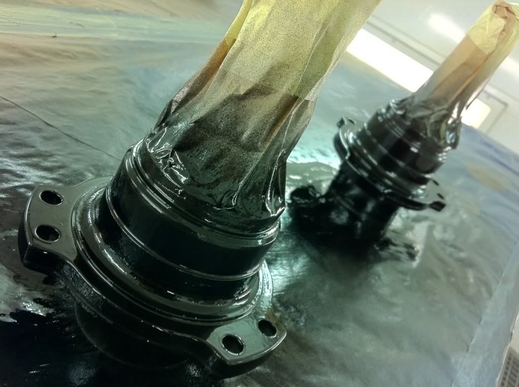

And the diff half shafts..

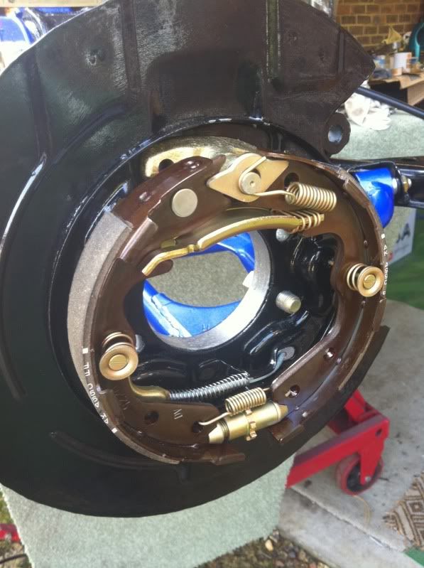

The biggest problem though is the Z32 handbrake conversion. Does anyone have a picture of what it is supposed to look like as I can't work out what spring goes where..? I tried to go by the FAST parts catalogue diagram but it's not very clear at all.

does this help mate? taken from a project over on sxoc ;)
Yeah, that is helpful, but too late! :p Thanks anyway though :)
The spring at the top is stupid! It hooks into the hole but not like a spring normally would. The hook goes the wrong way. I've checked loads of pics and it is the way Nissan designed it - hard to explain until you do it. Also, the block thing at the top with the 27mm nut on the rear isn't designed for our hubs so it still spins when done up to the end of the thread. You will need a 3-5mm spacer (washer) with an internal hole of 20mm to shim it and hold it tight ;) Thanks to Mitch for that advice. Next top tip is to re-use the handbrake cable support from your original cables as the R33 ones don't really fit.
