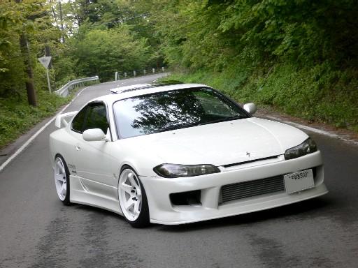

Wheels: Volk Racing TE37 White
Size: 18''; Front 8.5; Rear 9.5
Offset: Front +40; Rear +40
Tires: Front 235/40R18; Rear 265/35R18
Spacers: Front +5mm; Rear n/a
Suspension: TEIN Super Drift
Comments: The front side requires 5mm spacer since the inner part of the tire is very close with the suspension ( < 5mm).
