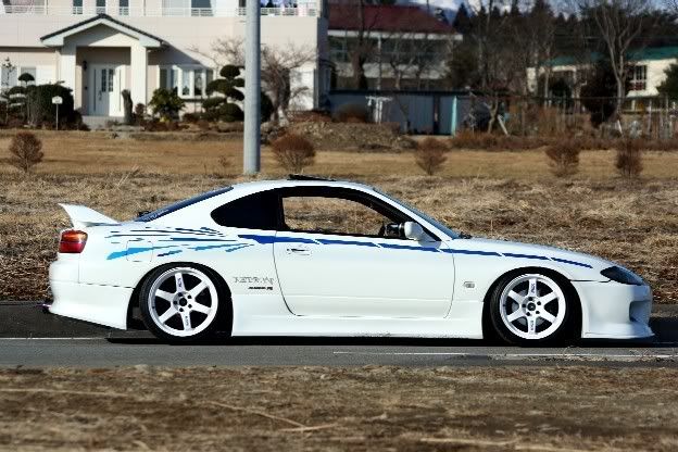

Im considering Volk TE37 for my car how good will these sizes fit?
I want them to fill the wheelhousings pretty good.
Should i go for another offset?
And what tire dim should i use?
18 7.5 +30 Front Recommended by Rays
18 8.5 +40 Rear Recommended by Rays
