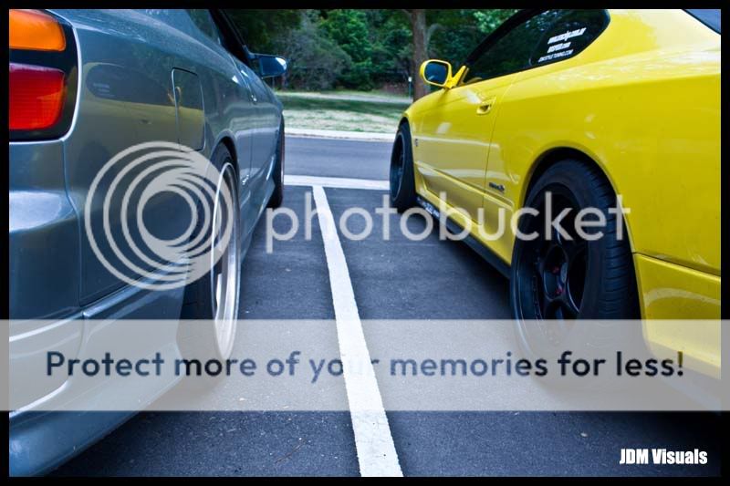

JDM 20T
My S15 on the right
Wheels: Enkei Peaks Racing
Front
Offset: +22
Tyres: 215/45/17
Spacers: None
Rear
Offset: +35
Tyres: 235/45/17
Spacers: None
Suspension: GAB SS Series
Comments: Didnt need to roll any of the guards to make them fit does not scrub on full lock on the front and does not bottom out in the rear
Friends pewter S15 on the left
Wheels: SSR Proffesors SP1
Front
Offset: +30
Spacers: None
Rear
Offset: +45
Spacers: Unknown

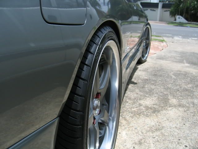

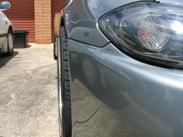

Here is mine
Wheels: Volks GTS
Front:
Size: Disc A (high disc) 19x8.5 +24
Tyre: 235/35/19 Kumho KU31
Camber:-1.65
Rear:
Size: Disc C (Low disc) 19x9.5 +37
Tyre: 265/30/19 Kumho KU31
Camber:-2.3
Also ... the rear guards are rolled and slightly pulled and they are on stock suspension (still got no cash for coils yet :p)
I could fit +21 at the rear but have to use stretched tyres
