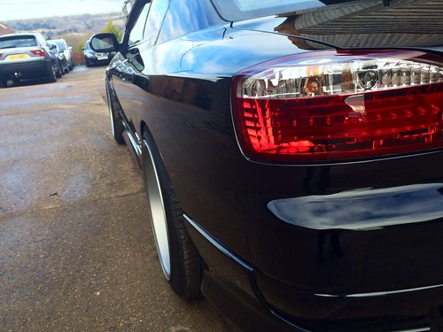

I'm still yet to get proper pictures (said i'd get them for my build thread), but with the car being under a cover in the garage its an effort ;) ha. These are the only pictures i've got:
18x9.5 et10
-3 camber
Arch Roll and roughly 5mm flare
