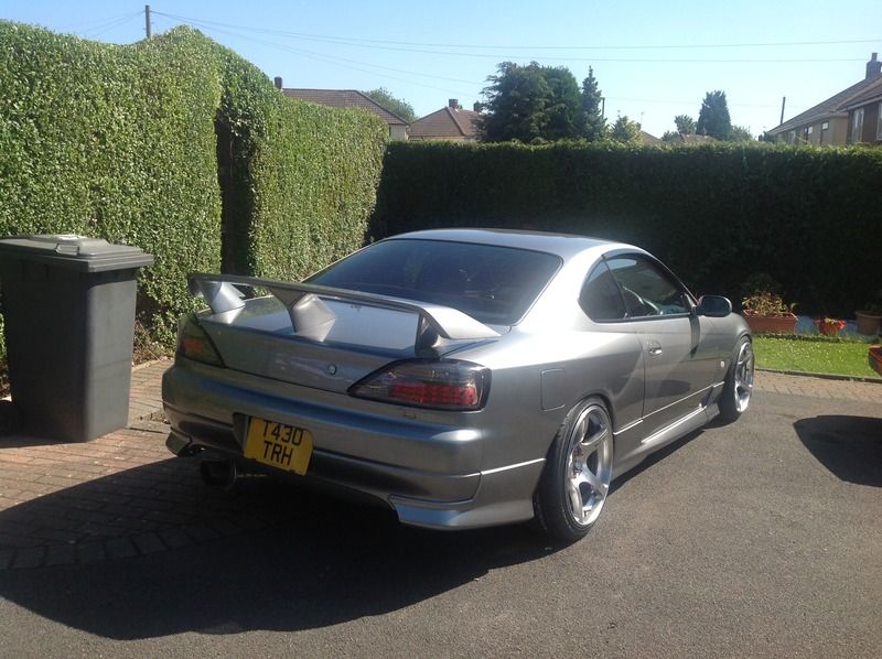

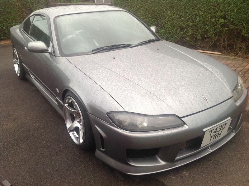

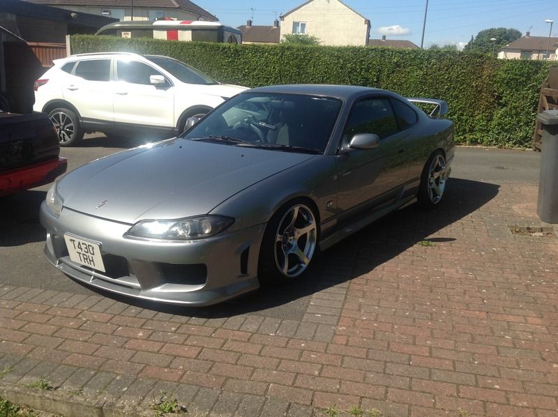

hi all, did a little test fit today as I am looking at purchasing new wheels within the next month. My arches are standard and have no roll. hsd monopro coilovers, I was able to get 18s. 9j et30 on the front and 10j et30 on the back with 4deg camber. (225/40/18tyres) what I am looking at now are 9j but et25 all round. I dont no if the et25 would work on the rear..... :/
here are some pics anyway
4,643
46
If it helps I ran 9et20 front and 10 et38 rear on stock arches with not a lot of camber at all. Et 25 on a 9 will sit pretty much identical to that with regards to tyre /arch clearance . Think it works out to something like half a mm further out on the rear

@S15_wot
^ was that without a roll aswell? I think for my set up to fit, il be needind 225/40 tyres
