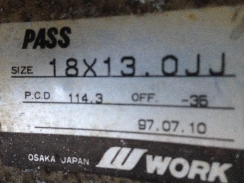

How much wider does this make the car, just wondering cause of the 13J rim....

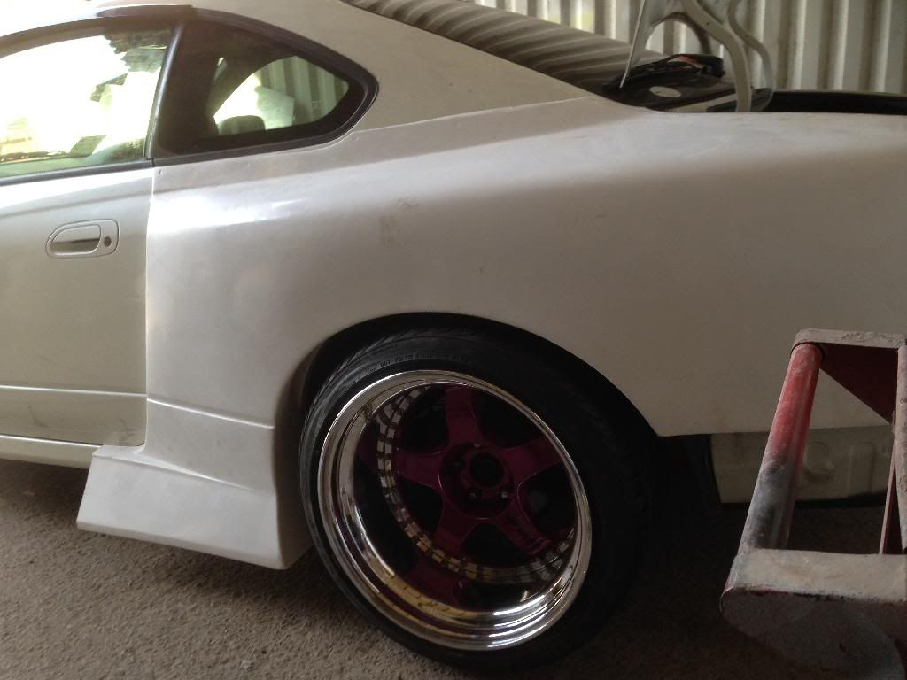

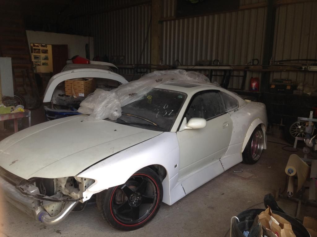

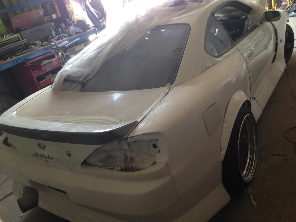

Finally got the wheel covered, going to blend the arch in with the overfender then 0 the camber and then low as poss
in the end the arches had to be 150mm wider each side

Not sure I like the arch extensions yet. But I have poor vision so will no doubt look great when blended and painted

Literally had no choice they were too far out the arches lol

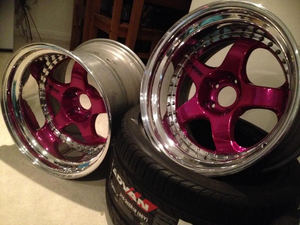

I can't see you having a problem but worse case as said dial in a bit of camber. I had to max the camber on my last silvia when I put the professors on it they were 9.5j et12 I was getting through tyres soooooooo fast running on the side wall. My new Meisters are 10j et -23 on the front and 13j et -35 on the rear but I'm running a lot wider arches
