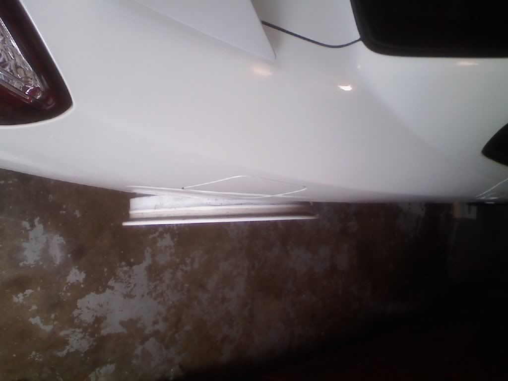

Wheels: 350Z Track wheels
Offset: +30
Tyres: Front 225/40/18 Rear 245/40/18
Spacers: No
Suspension: Stock
Comments: Fronts clear eazy,Rears Scrape on bumps heeps!!!!!!!! But looks sick

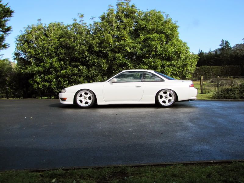

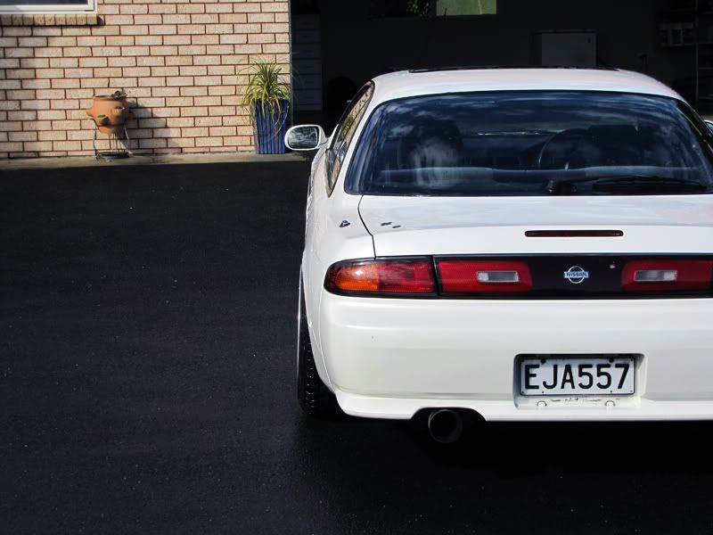

Vehicle: Nissan S14
Wheels: Work Meister S1 2P
Offset: +20
Tyres: Archilles 18/225/40
Spacers: 13mm slip on up front to clear strut
Suspension: BC Gold Maxed front, Rear 10mm away from lowest.
Comments: Front guards rolled, rear rolled and pulled 15 - 20mm.. Rear can run nearly 0 degrees camber , front is at -2.5, -3 would be ideal for to clear guards.. Front requires less castor in the front left to stop rubbing and maybe higher preload and damper setting to stop it bottoming out.

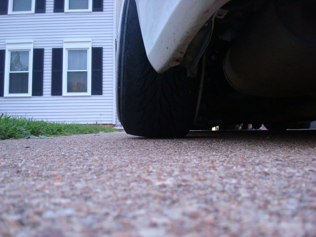

Wheels: Sparco racing NSII
Ofsett: +22
Tyres: Falken FK452 225/45/17
Suspension: Driftworks CS2 coilovers, standard arms. -2 front camber, -3 rear camber (stock arms maxed out)
Comments: Rears had the lip rolled flat, and have got about 8-10mm space when the wheel is tucked up into the arch, but will be less when I get rear camber arms to correct it. Front is standard. No scrapes :) Car is moderatley low, pictures to follow

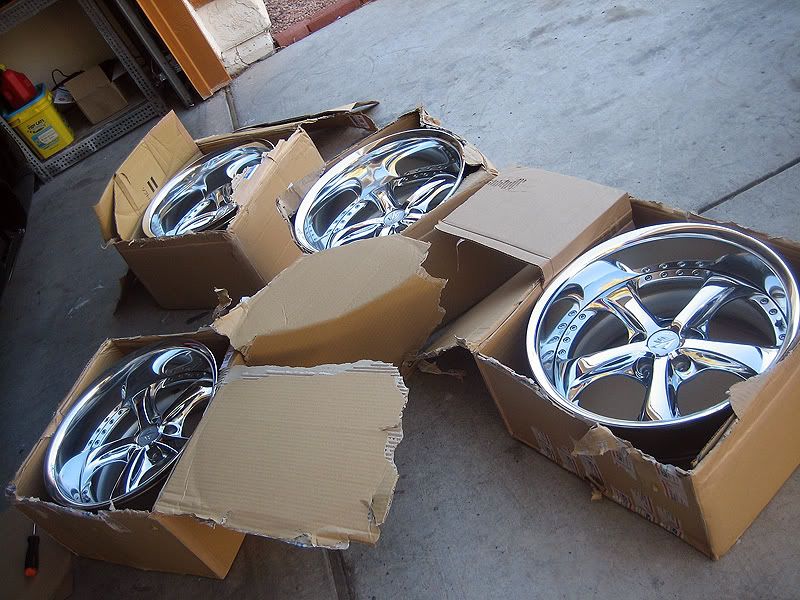

Hi guys,have found some wheels I really like just not sure if they will fit.they are 18 x 9.5 ET35 all round,I have full set of adjustable arms on the car and tein super streets with pilLo ball top mount,do you reckon these will fit????
They are wheels only so will need tyres too any suggestions on size?
Any info will be grately received
