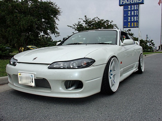

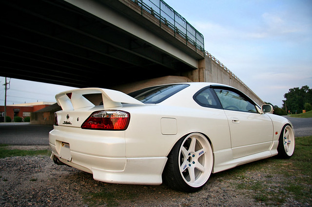

Wheels: Rota Grid Drift
Size: Front 18x8.5 / Rear 18x10
Offset: Front +35 (with 3mm spacer) effective offset is +32 / Rear +35
Tyres: Toyo Proxes T1-R - Front 215/40 / Rear 255/35
Suspension: Jic Magic coilovers
Camber: Front 0deg. / Rear -1deg.
Comments: No rolled/pulled arches, Sometimes rubs to rear arch inner lip (you know what I mean :D), Front doesn't rub even at full lock.
Rear
Front
Next summer whole set will be totally different :cool:
Looking very nice indeed. So clean and lovely looking wheels too. White on white is spot on :)
Rolling your rear arches would easily prevent the rubbing too.
Yeah! I have thought that alot but now, with new plans for wheels its going to happen at winter...
I think white on white is great, but new plans with gold on white is getting over me :D

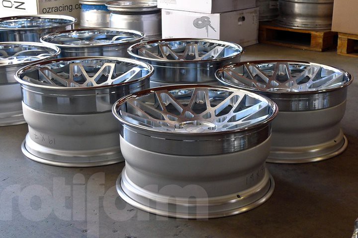

the new wheels
19x9.5 +12
19x10.5 +12
they are unfinished in the picture
