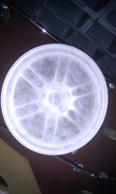

I e just received my wheels from the States, well excited :D. I wast expecting them till the end of February.

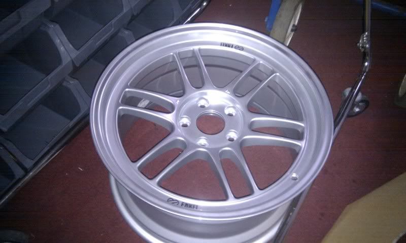

They're now a 9j for the front to get the dish effect that the 8 1/2j's currently on the car lack.

I've only bought the two as I've already got a full set on the car, I just wanted a wider pair for the front, they were £650 delivered for two 18x9j wheels without tyres. I bought them from Performance Alloys, who were bloody great.
Just checked for carriage, it's not listed. I'm guessing it's included in the price, as when I spoke to them on the phone they said they ordered them from Enkei U.S

I'm going to have to run some additional camber to get them to fit under the front I reckon, not too much I hope as they're only 1/2 an inch wider than the current fronts.

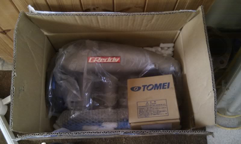

I don't think I've added a picture of something else I've bought too. I got the GReddy short port plenum and GReddy billet fuel rail off AllanOrr a few weeks back too.
Im skint after spending so much on parts this months, plus just forked out for road tax and a flight to France to see the folks later this month. Just need to order the ID1000 injectors now and the fuel pressure regulator and the car should be ready to see some higher boost levels.

Quality gear and looks like a Tomei Cam Gear in the box as well. Cool....
ID injectors are definately the way to go, what's the plan for the TB?

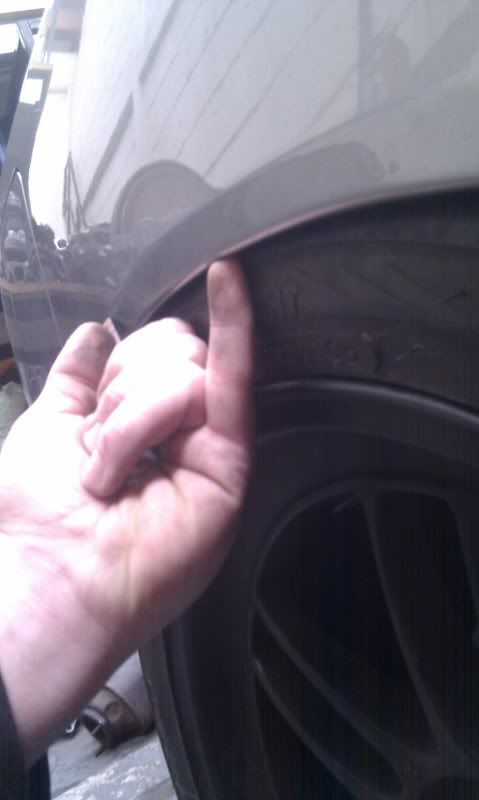

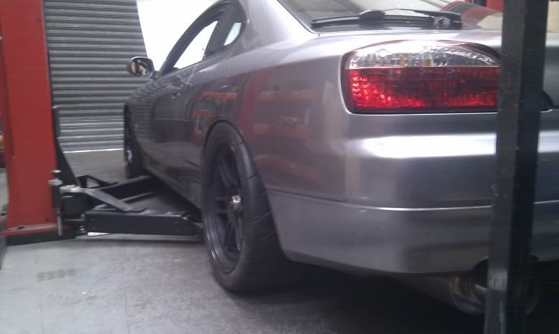

I got my new tyres fitted today, I'm now running 265/35 R888's on the rear. I had to remove the 5mm slip on spacer I was using because the side wall was catching on the arch as I came to lower the car onto the floor. The arch gap is so small it's silly :D
I wasn't sure if I'd notice an obvious difference between the RSR's and R888's but I found the 888's far more grippy and they only just start to break a bit of traction in 2nd gear now, where the RSR'S where spinning through all of 2nd gear, but they were a narrower tyre too at a 255.

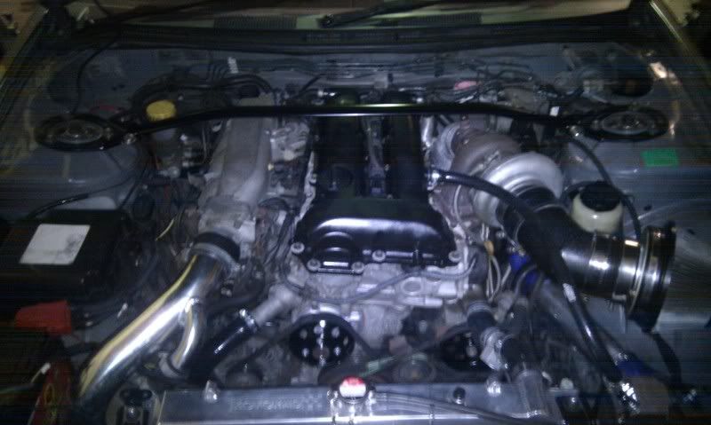

I also painted a few more bits black, for an attempt at a stealthy engine bay, I've got a few more of the black silicone intercooler pipes I've got to fit yet. I can't seem to get enough light for a decent photo when I take a snap of the engine bay, if I had a chance to work on the car during the day that might help though.
4,643
Good stuff mate! Very stealthy indeed looks nice,those tyres look awesome ! Heard a lot of good reviews for the toyo ,I used to love my toyo I had t1s and t1r back in the day and they were awesome!
Nice... Do you get any grip in the wet? They look like semi slicks!

They are semi slicks, Adam. I haven't driven the car with them on in the wet, but I've read the RSR's are better than the 888's in wet or damp conditions.

Arch gap, awesome :)

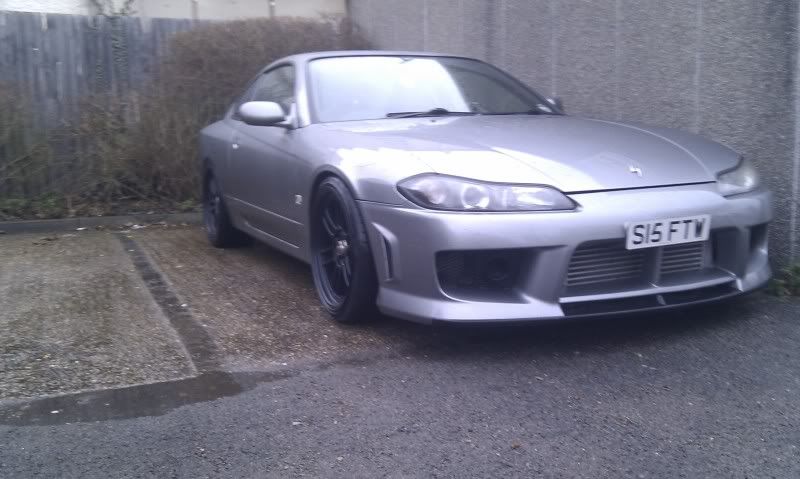

The new wheels are fitted but I hate the tyre fitment on the car. There's a blocky look on the rear from the R888's and a super stretch on the front from the 225/35 tyre on the 9j. I want to go back to the 255/35rsr as it looked better on the rear. My only conflict is the R888 is awesome in the dry but truly shocking in wet/damp conditions as I'll spin the rear wheels at high speed on boost with them, but had grip in 3rd occasionally with the RSR's.
