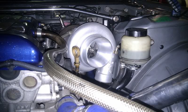

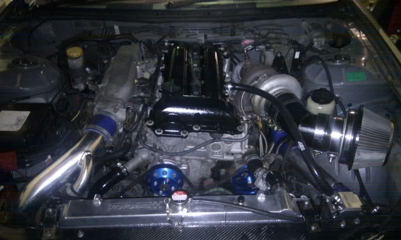

Well, I got the injectors cleaned. They were sent off to APT and flow well. I've bought a 19 row oil cooler and the rest of the S15 Aero body kit, which I've been after for over a year.
I had to do a couple of jobs on the car, so just got stuck in toight. I had to remove the turbo elbow because it's making the downpipe sit too low and it's taking a beating off the London roads.

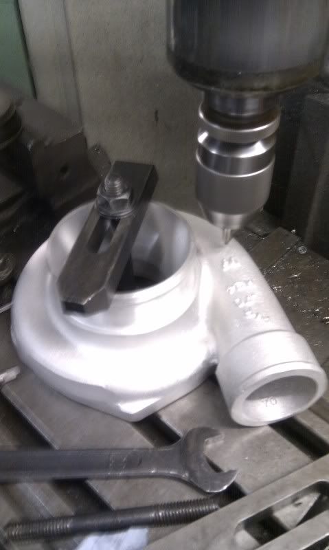

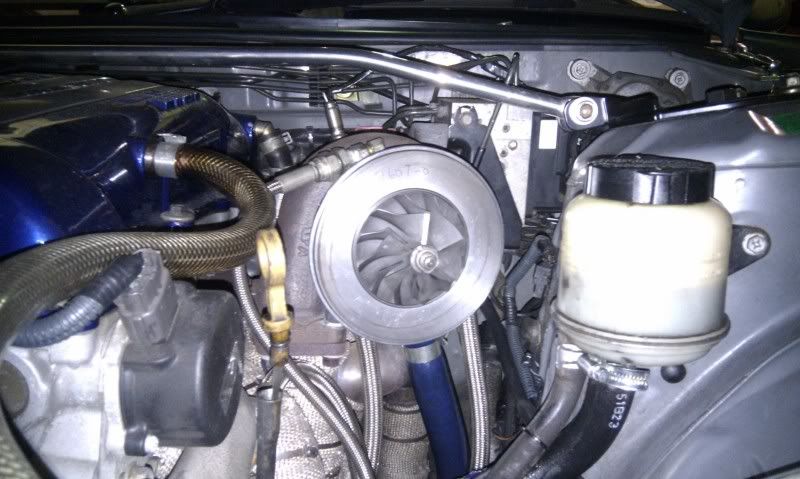

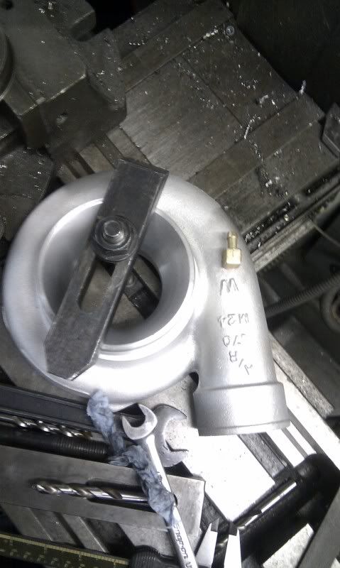

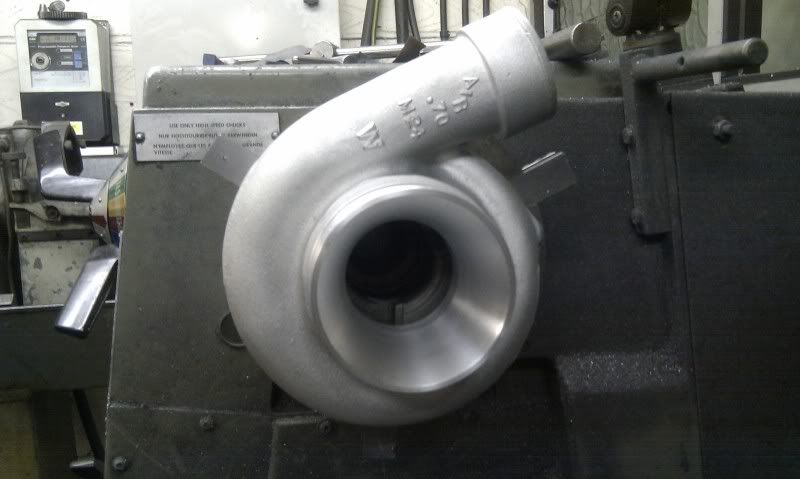

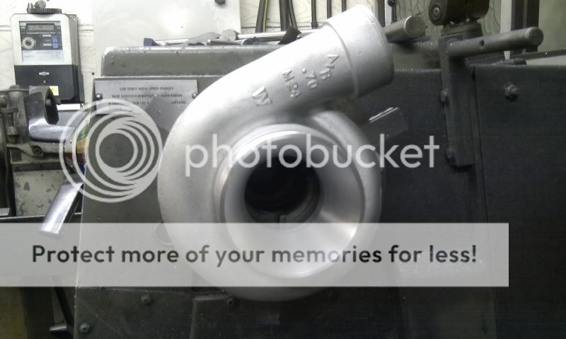

I've been meaning to sort out a boost take off for the external gate since I fitted the kit and I finally did it tonight. I removed the compressor housing off the turbo
It looked a bit dirty and had a few marks on it so I cleaned it and stuck it in or glass bead machine to give it a new shine and then put it on the laithe to polish the intake and insides
I then had to dig out a fitting and the correct tap for the thread I was going to use on the comp housing. I bolted it down on the mill and within a 5 minutes I had a brass nipple fitted in the comp housing
I got rid of any burrs and gave it another clean before re-fitting the housing to the turbo.

Looking good!
Your very brave lol and have got some skills! I'd never take a drill to such a lovely turbo :cool:

It's fine if you do it properly :D.
I've got it running a solid bar of boost now so I can actually give it some full throttle, my afr's are well in too. It's so laggy it's comical but it's still brutal at such a low boost level.

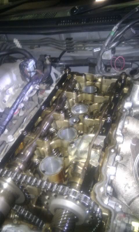

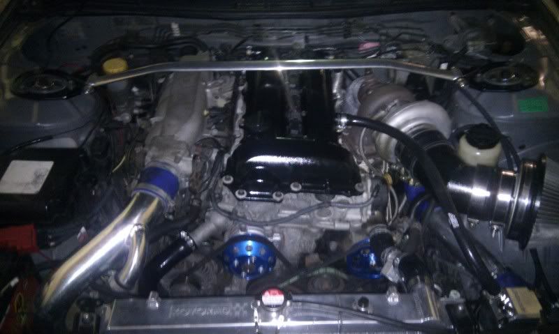

I spend today with a mate messing around with the car. I fitted the GReddy rocker arm stoppers I've had for about two years
Youve got to modify the inside of the rocker cover for it to fit, so I stuck the rocker cover of the mill at work and machined the parts required, no pictures though.
I also ground all the lettering off the rocker cover and did it black along with the intake pipe but didn't have time to do the other bits I wanted to do, so more to come I suppose
The pictures are terrible, it makes the paint look really bad but its actually done quite well.

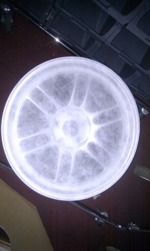

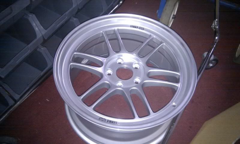

I e just received my wheels from the States, well excited :D. I wast expecting them till the end of February.
They're now a 9j for the front to get the dish effect that the 8 1/2j's currently on the car lack.
I've got some new 265/35 R888 tyres for the rear but I.may need to sort a flare on the arches to get them to fit as the 255's are knat's pubic hair away from the arch.
