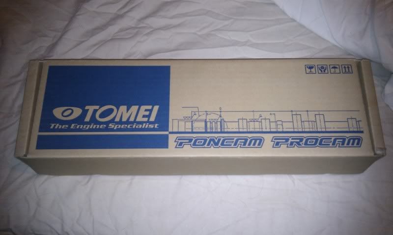

I've also just had the letter through from Parcel Force that my cams are here, so going to pick them up from the depot later. Not a bad price either, I paid £355 delivered from the States and got to pay £55 in tax/duty.

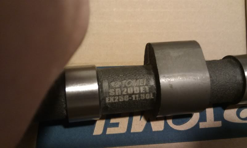

I picked my cams up on Friday, everyone says they have no markings on them for 256 cams, but they do. However it's only inked onto them, so it probably wears off once hot oil runs over them. I also paid £200 less than the places I checked in the UK for these, brand new. I've been buying parts from FR Sport for a good 3 years now and they're prices are bloody good, even when the carriage and duty is added on. £400 for the cams and £213 for the genuine Tial mvs gate (my boss actually paid the £35 duty for the gate as a weekly bonus, so it was a bargain for me).

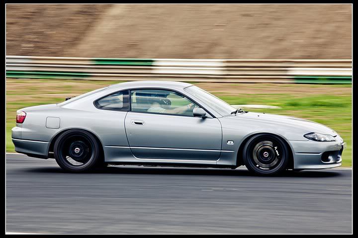

I went to Mallory Park again yesterday but didn't actually get as much track time as I wanted. I've never really driven the car in anger properly before so decided to use the rear wheel drive and power for a bit of sideways fun. I basically just powered out of the slower corners, so nothing spectacular. I did push my luck after the 5th lap though and span it :D. No damage to the car though, but a lot of people saw it and came up to me after taking the piss :wack:. I had some of the spectators come up to me asking what the car was and saying it was definatley shifting, along with a few other drivers out on track. Apparenly the car loves to spit flames aswell, I didn't think it would do it with the quiet and fairly restrictive HKS silent hi power cat back. I bought some shots that were taken by a proffesional photographer.

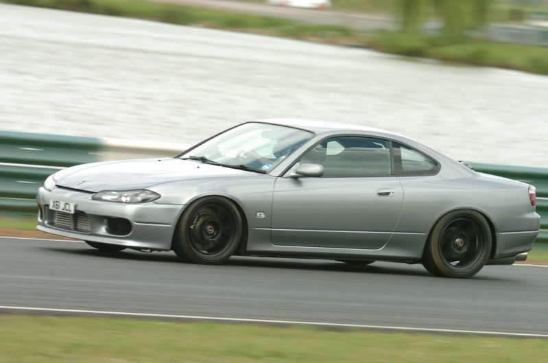

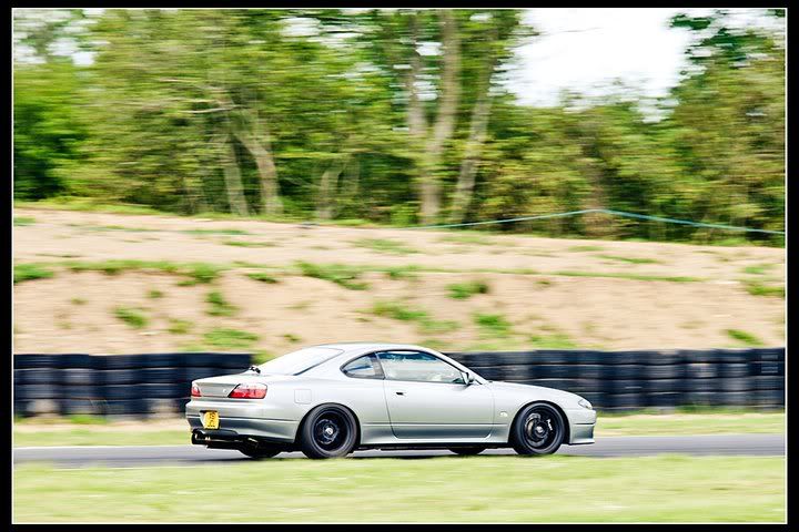

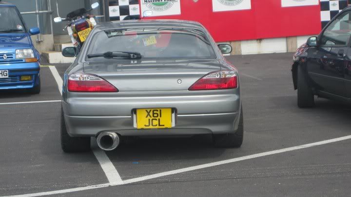

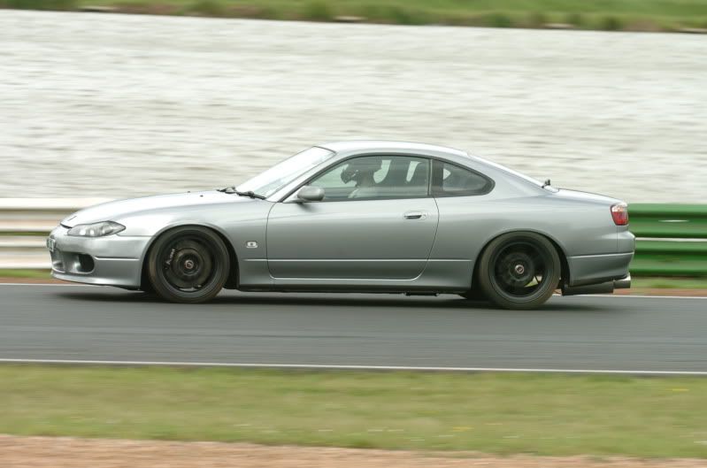

I don't mean to picture whore but I just got shown these pcitures which I think look bloody great, the two on track. The others are of the car sat parked in the paddock.

I just had this sent to me aswell, probably my favourite :D
Wicked... ace pics!! haha definitely lol'd at the one of you sleeping in your seat :D

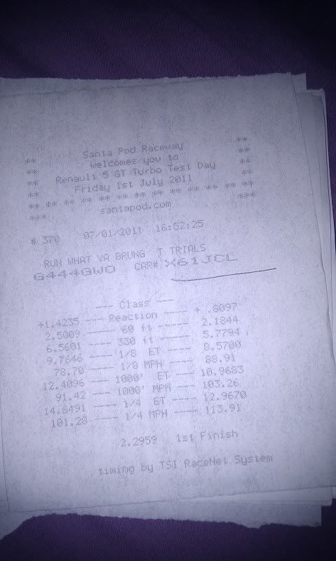

I've had no real progress with the car yet as I can't get it remapped until early August, however I did go to Santa Pod again and managed pretty much the same time I did as last time but a slightly higher terminal speed. I'm actually quite confident the car would hit 115mph across the line if it wasn't so hot everytime I decided to go.
