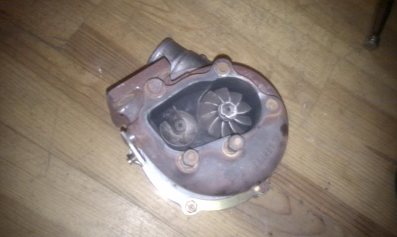

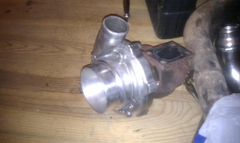

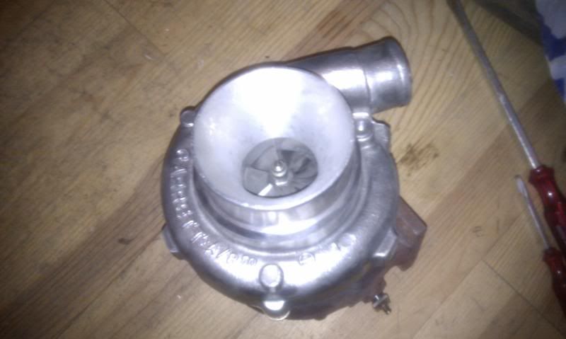

I picked something new up today, I drove all the way to Bristol for it aswell:D. Well, it's kind of new...
It's the largest GT3071R available, with the 56 trim comp wheel and 90 trim turbine wheel, so it's ready to flow alot of power. I was still toying with the idea of usuin my twin scroll manifold and HX35 until I saw this come up, so they'll be getting sold now.
I've taken the car off the road for winter now, so I saw it as a good oppertunity to take the old turbo off and get something a bit bigger for next year. I didn't go to Santa Pod either, which I was gutted about, i'd been planning it for weeks with a few mates and they all let me down 2 days before.

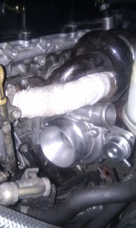

Very little has happened recently because I went on holiday to Morocco, which was good fun :D and it's too cold to bother with much else. I needed an actuator and bracket for the GT30 but because the Compressor housing is so big on it, I wasn't sure the big style Garrett -31's would fit, so I didn't bother atall. I ordered a new GT series actuator from the States, as suprisingly I couldn't get hold of one from any of the UK suppliers, the part number wasn't even listed.
Anyway, fitted the actuator ad set a preload of 13psi. I've read loads of threads where people have had problems fitting GT30's on bottom mount manifolds with the big .50 a/r comp housing, but when I fitted mine it cleared the engine mount by miles, which was a common complaint.
That only being a trial fit as it was pitch black after getting home from work.
So, all i've got to do now is fit the turbo, get it remapped and then sort the road legal slicks and i'm ready for Spring next year when the car will be allowed back on the road :D

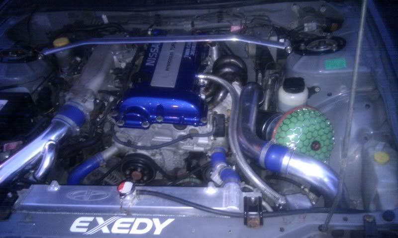

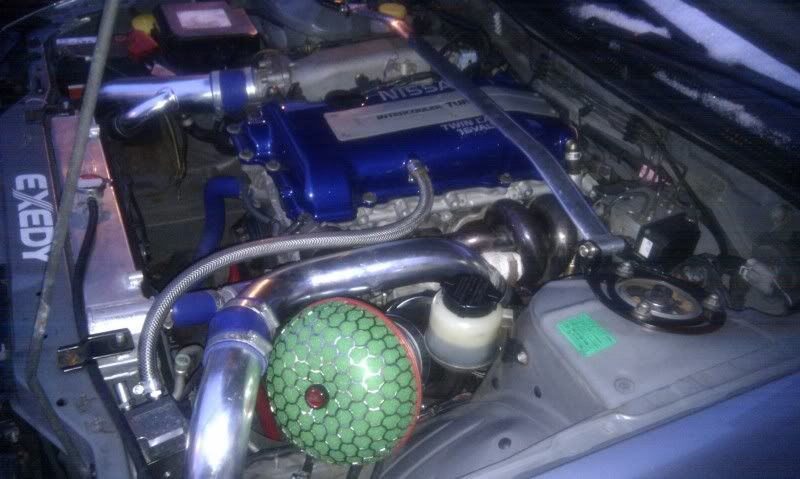

I finished fitting the turbo a couple of weeks ago with all new pipework. The intake pipe took A LOT of fiddling about with as when you've got a 4'' intake there's not alot of room to play with. I sorted it in the end though at everything is snug as a bug.
I also saw Mart's rocker cover, from Little Knocks, for sale last week and quite liked it so got in contact and picked it up the same evening. The rocker cover on the car let the engine bay down massivley as the paint had cracked and was peeling. I fitted it earlier as the guv let us all go home early today, so I had some day light to work with.
Just as a quick note, Mart from Little Knocks came down to meet me in his Stagea R35 and that car simply looks the bollocks!!
A much fresher looking engine bay, in my opinion...

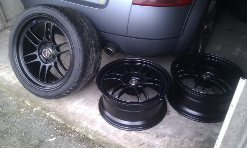

I've got nothing to show yet but I just went to look at some new wheels tonight and I think they'll look awesome on the car. I've been after an cool staggered set of JDM wheels for ages and then a mate gets hold of a set of Enkei RPF1's (Apparently they're off a Time Attack Evo in Japan) in very good nick. I'm going to try and get them on the car asap. I was also going to get them sprayed black but because they're in such good condition I don't think I can bring myself to do it.
Anyway, this is what I'm picking up at the weekend.

I took the Enkei wheels to a well recommended refurb shop in Swindon today, they're being done flat black. I've also ordered 15mm spacers all round for them.
I fitted the spacers to my wheels a couple of weeks back, they look good (but i'm selling them when the Enkei's come back:rolleyes:). I also discovered i'd literally destroyed the tyres on the back after 2.5k miles. You can tell the diff has been working hard with the power as one tyre is literally bald, bar the outer tread, and the other is very low. After seeing that, it didn't suprise me I was having problems with grip in 3rd gear.
To solve the traction issues I had before I bought some Federal 595 RS-R's just over a week ago, which are now waiting to go on the new Enkei's

Well I picked up the wheels yesterday, I had a full refurb done on the whole set and done in flat black, I think they look awesome. Even the company I took them to liked the wheels, I had the owner asking me what model they were. I've not had a chance to fit them to the car yet as I moved house this weekend and I was lucky to have the time to collect the wheels, so just a quick picture of what they now look like until I get them fitted.
