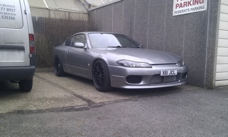

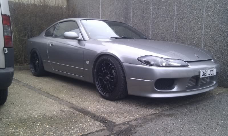

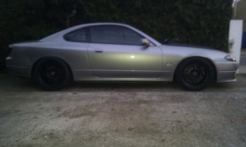

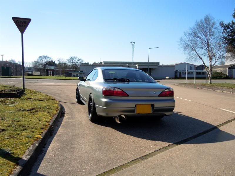

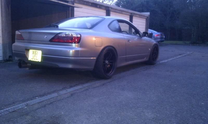

Well, I finally got the wheels fitted this week, and I didnt have to space them out as far is originally thought, which confused me a bit. the rears have a bit of dish so I guess that affects the et.
These aren't the best pictures as two were taken just as it was getting dark last night and the other one is this morning
The stance looks awesome, might get the fronts to poke out a bit more, but I'm happy with it for now.
looks spot on pal :) I wasn't sure about them when I first saw them in Silver, but they really suit it, well done..
what spec are the wheels? I'm in the process of setting my stance up (new coilovers) but I'm struggling to get a nice stance. Think my wheels are too wide really..
23 July 2010
877
SW London
Cheers, mate :). I'm glad I chose to get them done in black.
The wheels are 9.5j rear with et 45 and I've used a 5mm slip on spacer to get them out of the arches.
The fronts are 8.5j with et 40 and yhey have a 10mm spacer, but I may try a 15mm on the front at some point.

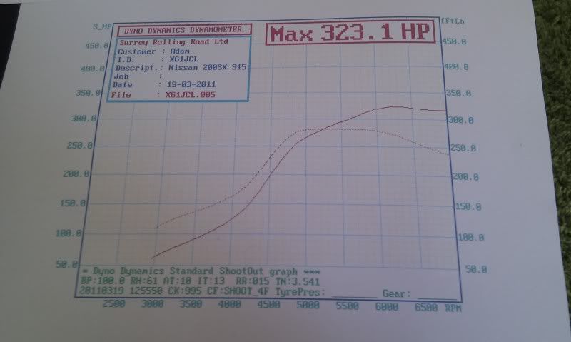

Well had the car on the rollers earlier and it made 323 bhp at 1 bar, the car wouldn't make the 1.4 bar it was mapped for on the rollers. However I was warned that would happen when I had Martin mapping it on Thursday as rolling roads don't provide the same kind loads road mapping does. Charlie from Surrey rolling road was impressed with the power at 1 bar though and so was I, considering the car was previously running 337 bhp at 1.4 bar on the 2871.
I'm going to take the car to pod next to get a more accurate reading from the terminal speed.
yeah looks good for only 1bar, and a nice power curve :)

It is a shame it didn't make the boost as, Charlie, the guy who runs Surrey rr said it would have made over 400 on the rollers. I'm thinking about taking it to Santa pod tomorrow to see what terminals I get, but that's permitting I get up early enough,as I've had a few beers with the lads after the rugby. I'll need a helmet and mine is in storage. Most of my mates have one but they ride bikes and need them, so I'll have to see how things go.
Looking good Adam!! :thumbs:
Wow - that power curve doesn't tail off... looks very strong and torque stays max between 4800 to 6000 which must be a good thing lol :D

The rolling road shows how the turbo comes on boost on my other graph, which I haven't uploaded, but it responds very differently on the road. For instance i'm getting a bar at 3.5k rpm, on the road, and on the rollers it was delayed until 4k rpm. I very nearly ordered a 38mm Tial external gate last night along with Tomei 256 Poncams, but think i'll wait till all my bills are paid this week :D

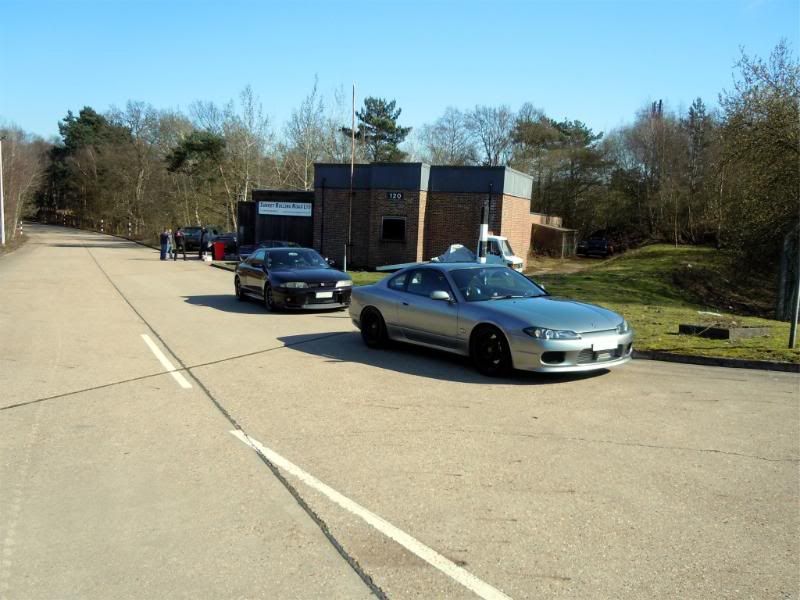

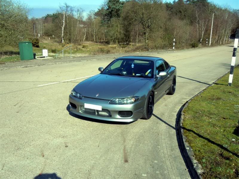

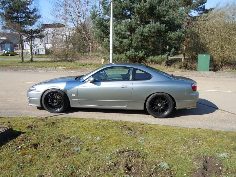

One of the lads off the sxoc took a couple of pictures, the car was actually clean for once as I haven't had a chance to wash it for a while because of either the **** weather or I just don't have the time. It looked quite spanking...
Awesome!! Very aggessive looking and those black Enkei's do suit the pewter 15 well :)

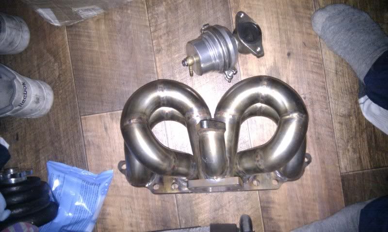

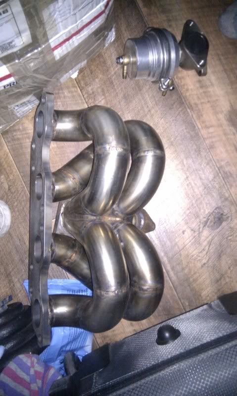

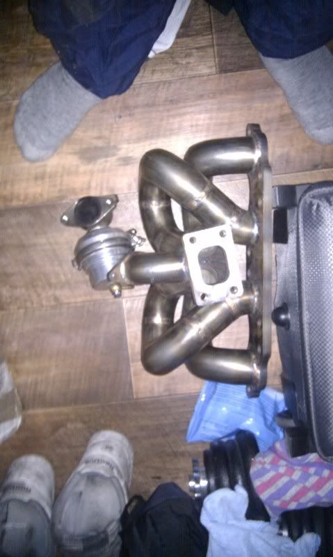

Well, I was planning on leaving the car as It Is for a while as it's a bit of an animal but I just couldn't resist... a custom top mount manifold arrived today and external wastegate. The ecu is getting replaced with a Link G4 stand alone soon aswell. My gearbox seems to be coping with the 380-390bhp its running at the moment but I'm just getting a lot of traction problems now even with the new tyres but they have made a huge difference. Just a quick couple of pics of the new parts
Manifold looks good, where did you get it from? as I fancy changing mine some time down the line (currently got a top mount japspeed).

I can't actually remember the make of manifold, I bought it off a fella on sxoc who'd had it made but never used it, I've asked him who did it for him. It was actually very reasonably priced for the quality, around £450 from memory.

thats quite a good price for the mani looks decent quality aswell :) I got my hks one for around the same money the thing is a work of art!
