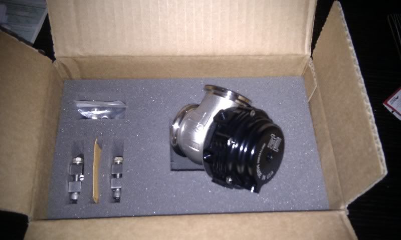

I've bought a new Tial 38mm mvs wastegate from FR Sport as the one I got with the manifold was a brandless cheap external gate, which I never trust as everyone I've had through work is leaking. Suprise suprise, when I checked it it was leaking aswell.

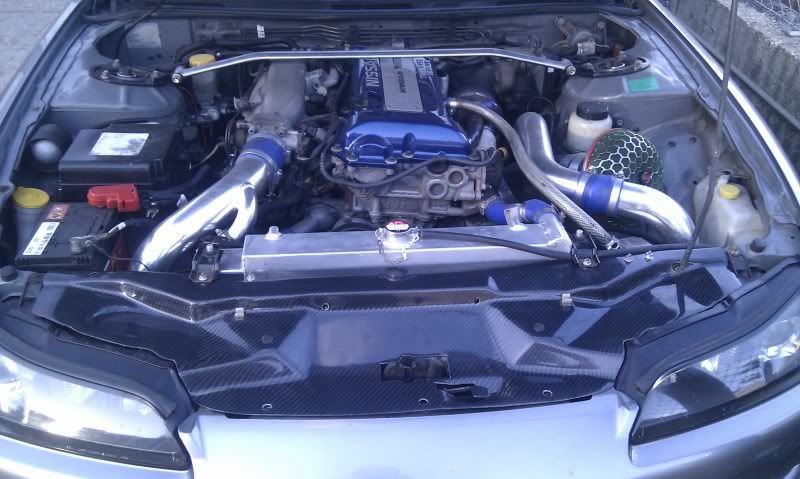

I recieved this from Craig today and fitted it after work, but I need some longer clips for the front bar as the standard ones won't reach through the carbon

Looking good mate. Glad you like the panel!! :D

My new Tial mvs wastegate arrived today, bloody good quality!

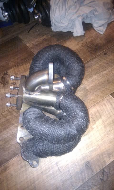

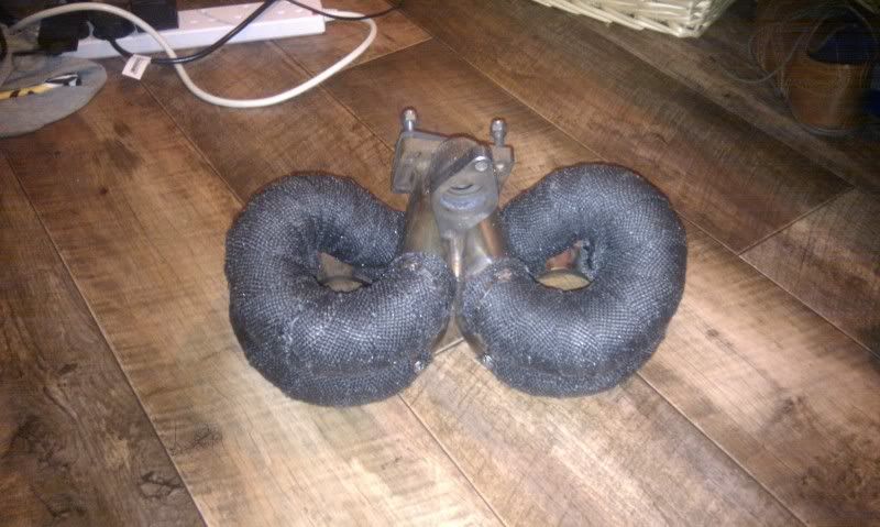

I bought some heat wrap for my manifold, I've never actually used the stuff before and I don't really want to ever again! :D
What a labourious task, constantly trying to keep is as tight as possible, while manouvering it through the extremely narrowly spaced collectors. Still it's done, and I prefer the dark look of the material.
