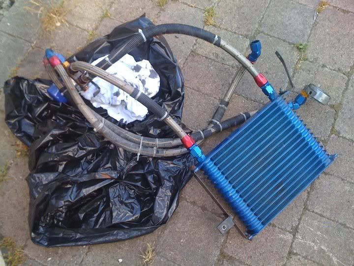

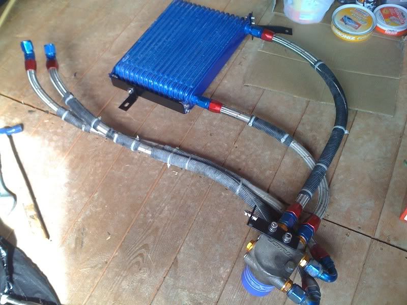

will i was waiting i picked this up :)

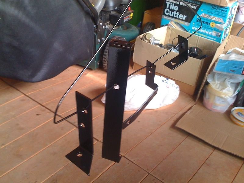

nice 16 row Greddy cooler with relocation ....:D

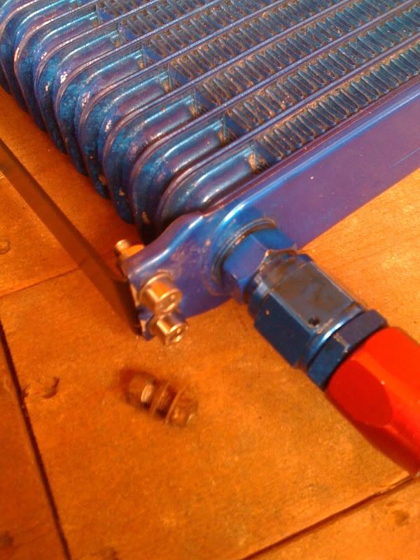

removed the brackets and sprayed them as there was so surface rust showing
replaced rust bolts with some SS ones :)
Allready tofit on my next oil change...

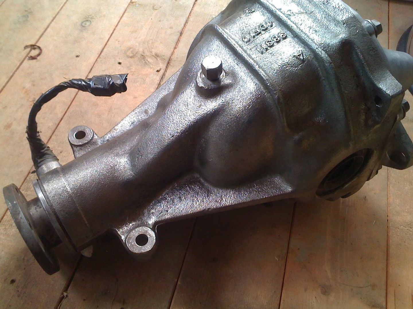

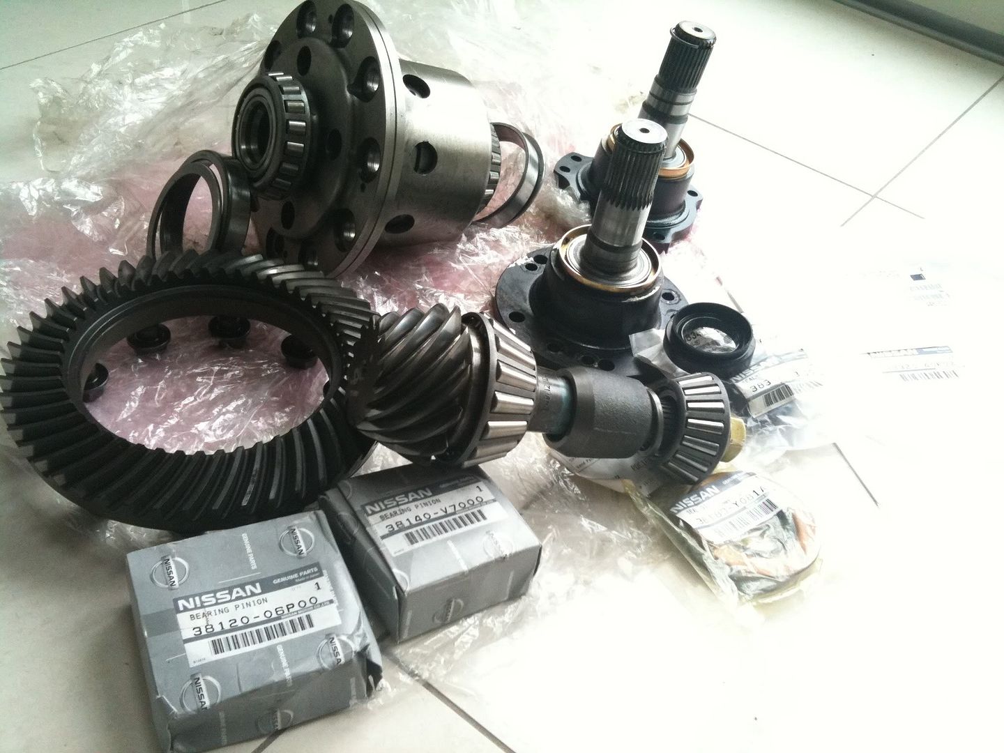

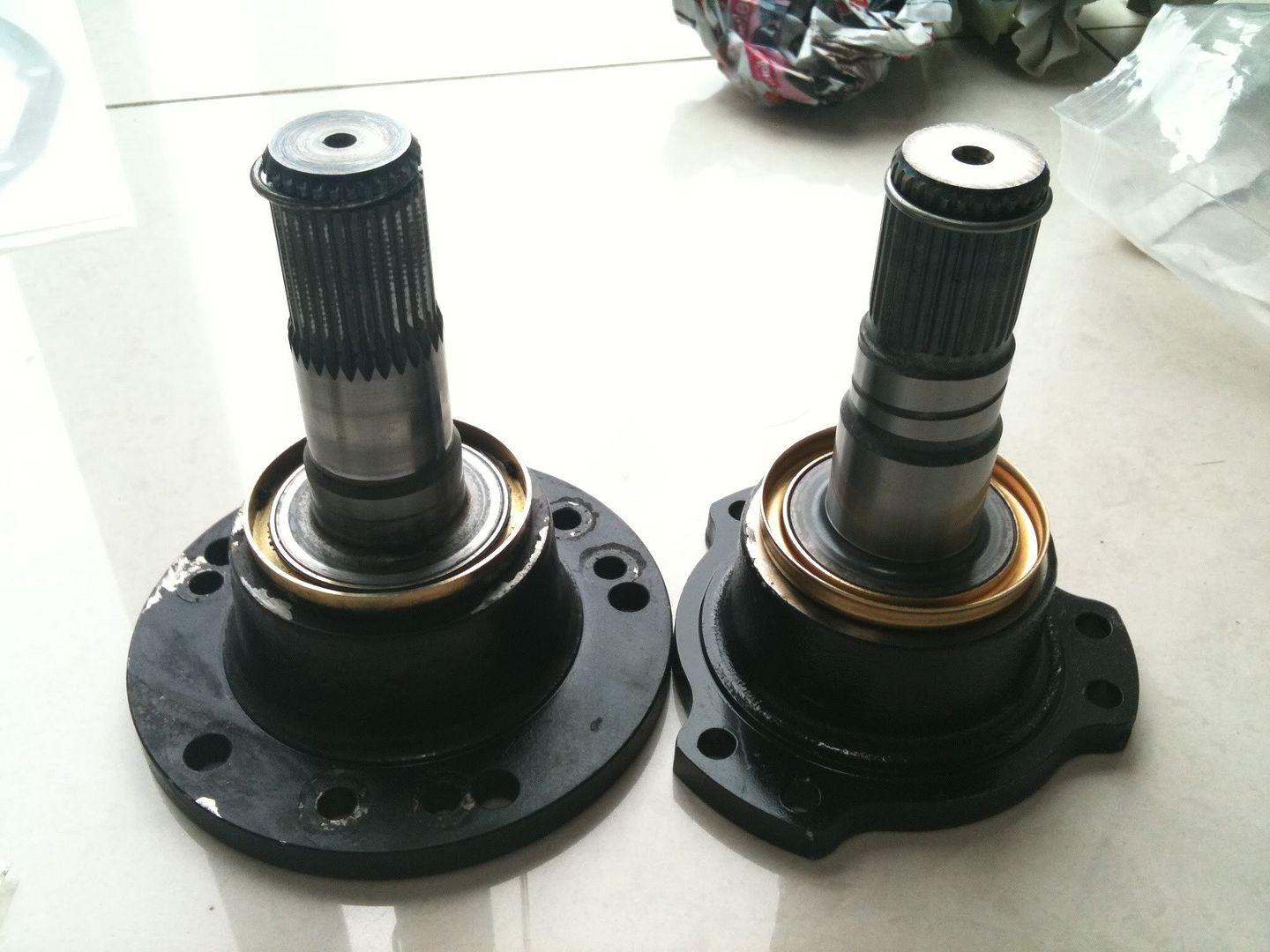

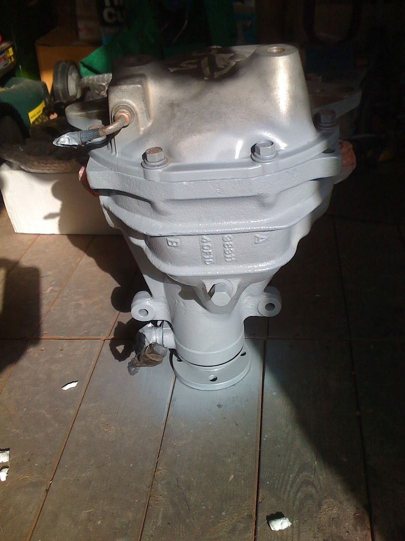

Parts have finally arrived to fit my ATS 2 way diff.
had to order the correct output shafts as one that came with diff where only 5 bolt pattern.
Also had to source a diff housing that has ABS, need to get the speedo working on s15.
Hausing is just after been sand blasted as it was pretty rusty on the out side.
Abit of Primer to keep it rust free.

How come you had to order different output shaft? And how come you can't fit this into S15 housing?
8 May 2006
874
Dublin , Ireland
bit of a long story.
bought a secound hand one which was ment to be straight swap but it was far from it. so had to order the extra bit for it to work.
Ah makes sense!! Hate it when something turns out different that it's meant to be grrrrr :wack:

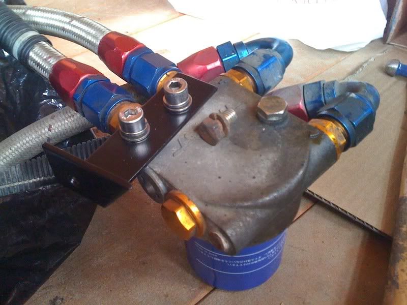

oki

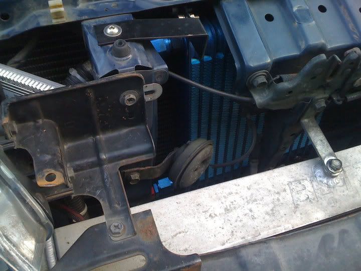

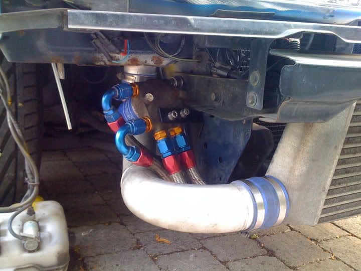

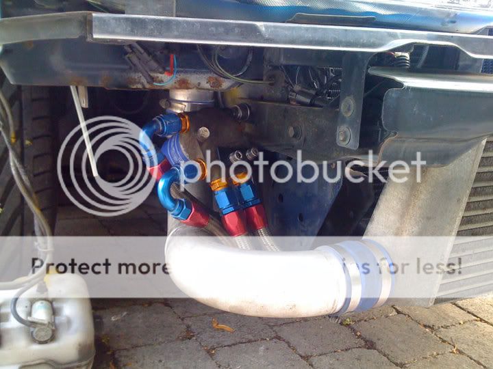

have a RR'd day coming up so oil change was in order.
as i was doing that i might as well put the greddy oil cooler on.
so here it is installed.
filter relocation was ment to be installed below the pipe but my Blitz intercooler pipes where too low so after a long looking and fiddling, i final got it on above the pipes.
kit comes in earl's fitting which mated up to my Tomei N2 block nicely. :cool:
the kit keeps engine running alot cooler at 80ish as to the 90ish it was running with out.
