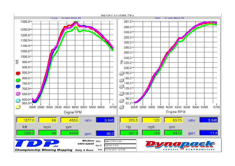

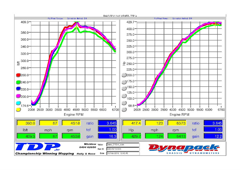

Fresh New Readings of the dyno.

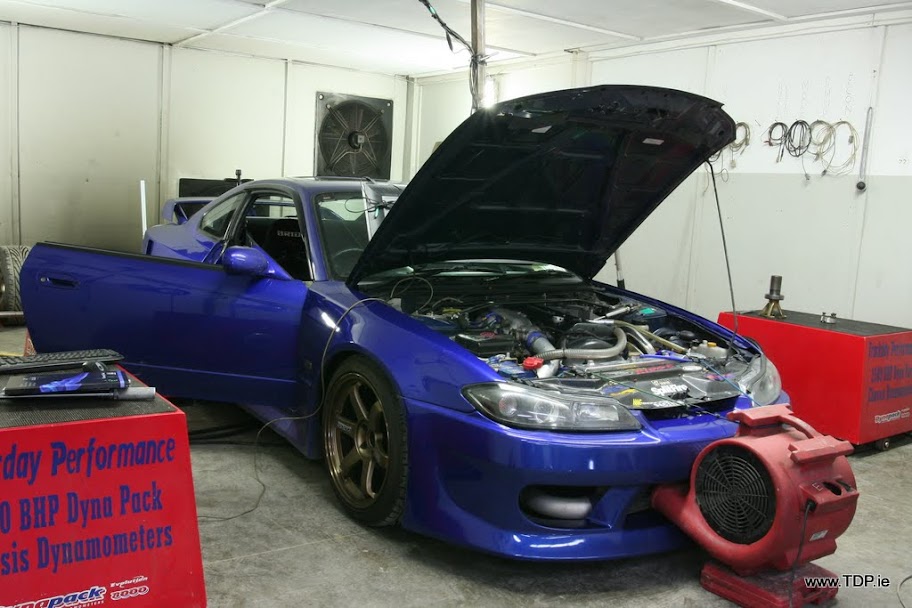

was in a RR'day today, was on the Dyno Pack Hub Dynos. down in TDP.
got some nice fiqures.
381.9hp @ Hub
429.7hp @ Fly
409.3lbft @ fly

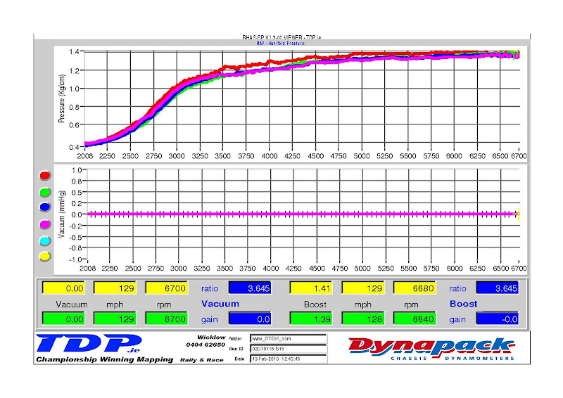

running 1.2bar boost
but it was creeping near 1.4 bar at redline. AFR was safe as it was map for it.
Well happy with the result. first dyno reading since the 850cc injectors went in and remapped.

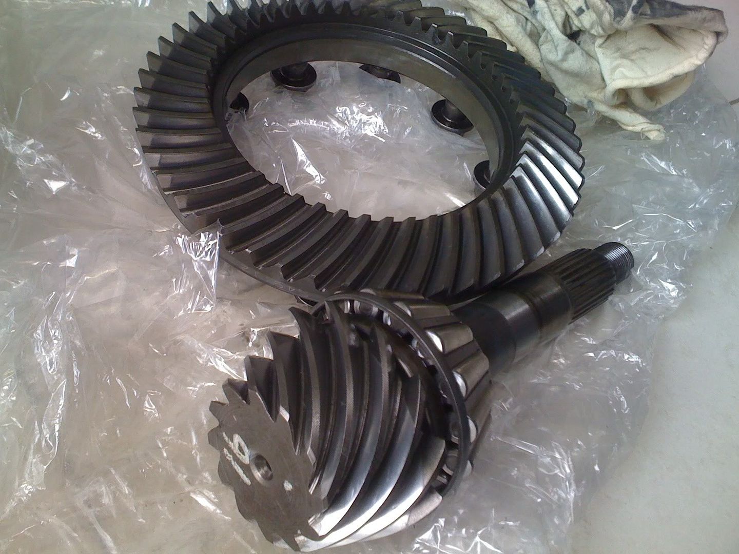

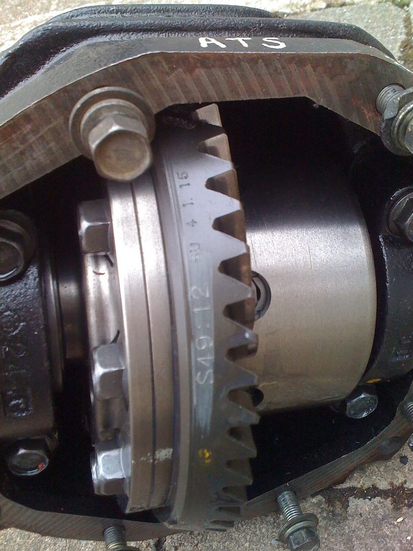

havent been doing a whole lot on the car but here is next plan...
4.1:1 final drive
2 way diff (ATS Metal)
Just have to order some new bearing oil seals and some fresh diff oil...
8 May 2006
874
Dublin , Ireland
just did the maths it actually a 4.08:1 final drift much better then the 3.6:1 standard s15 ratios.... more torque and acceleration here i come..
