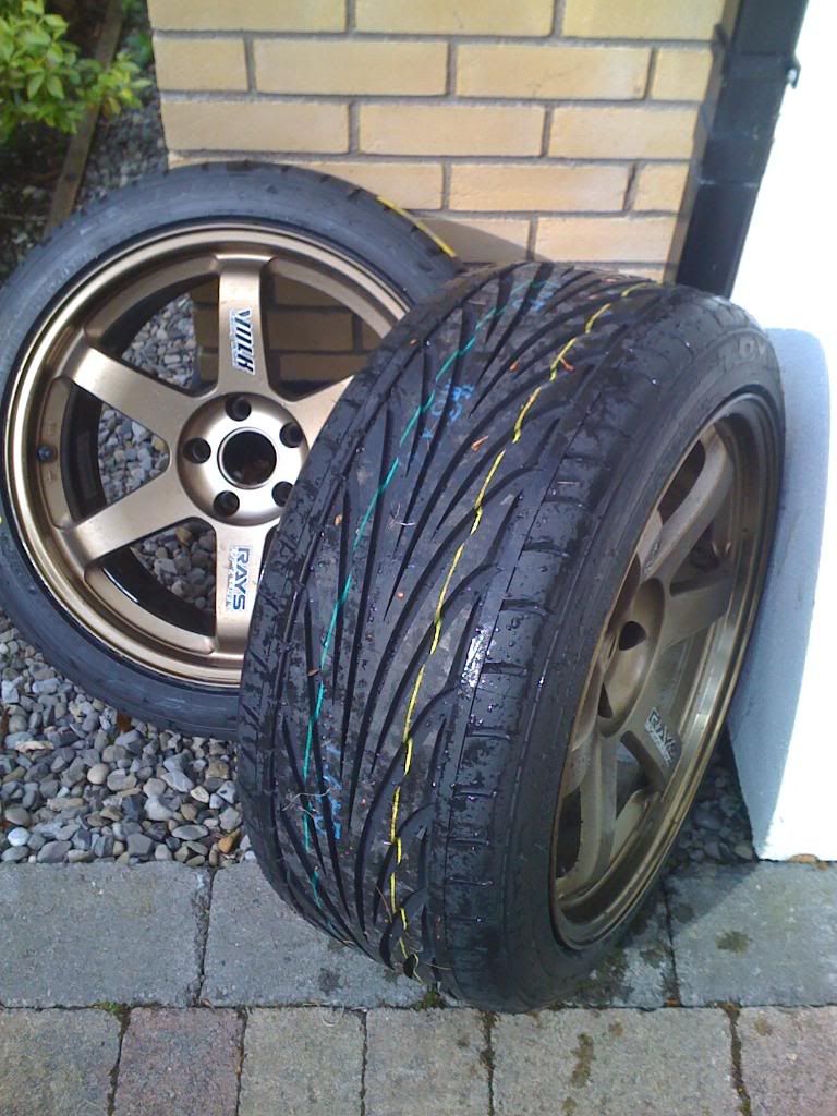

Well got the tire on the rims,fronts only
weight them
19.5kg
the break down
rim 18x9.5 = 8.4kg
tire 245 40 r18 = 11kg
so the missing .1kg must be compressed air:wack:

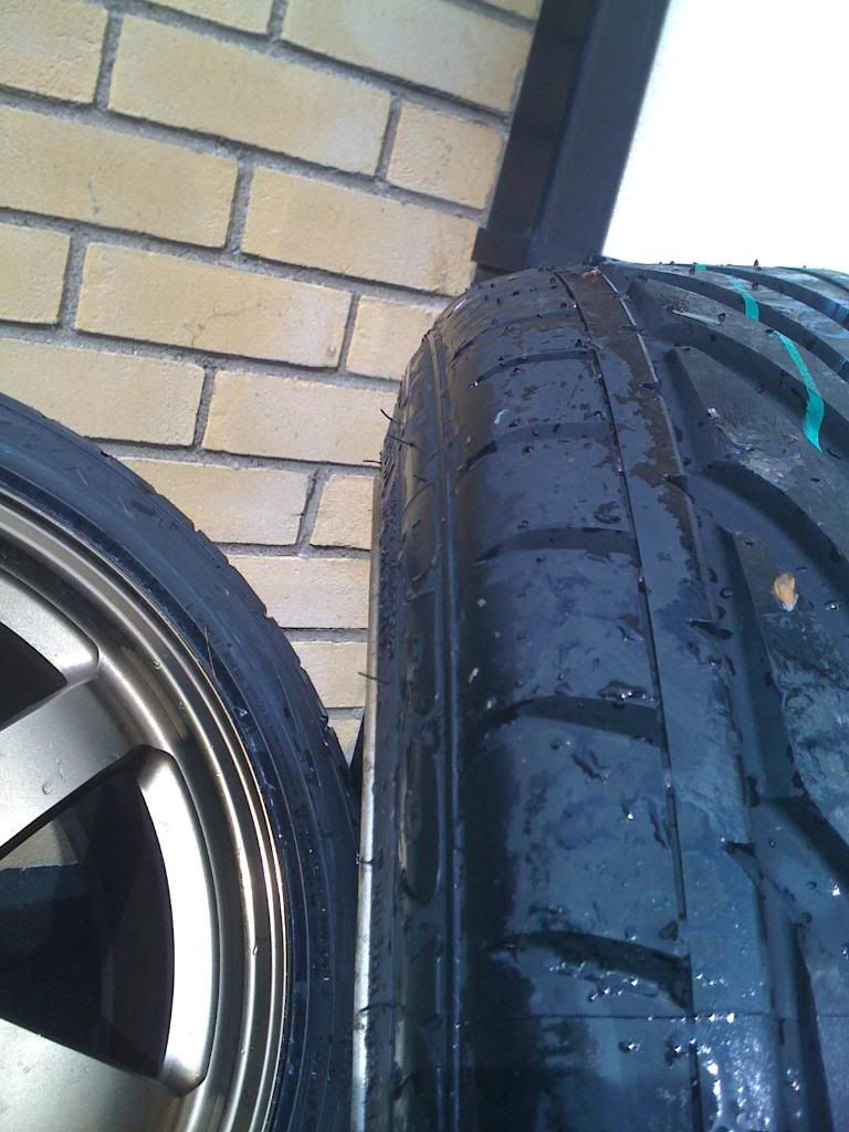

Slight stretched tire on front rim

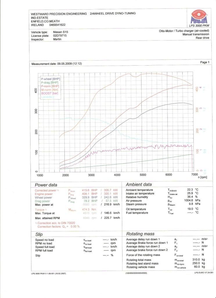

fresh result from today's RR'd with SXOC ireland.
was dyno'd in Westward Eng.
415.6bhp Fly
329.9Bhp wheel
474.3Nm Fly
@1.2bar-1.3bar boost creep:rolleyes:
Well Chuffed :D
Especially when the car has no internal mods at all.:thumbs:
pics and video to follow later.
PS videos gonna be interesting:wack: ( not that interesting actually)

how the hell are you making that power at 1.2-1.3 bar:eek:
that's some good power. very nice.
EDIT: love the water barrels in the boot. :rotfl:

As i said yesterday ray, very impressed with the power you made, if i get anywhere near that ill be very happy
8 May 2006
874
Dublin , Ireland
I was realistically hoping for about 370-380bhp. but was well chuffed with the results.
last dyno'd at 362.6bhp and that was in a different roller. (which was know to be 10% less then most dyno's in the country)
only things i changed since then was a oil block, new clutch and tires. these changes should not effect the power of the car at all. and my clutch was not slipping on the previous rollers.

dude, thats savage power, what exactly have you added to achieve this ?? obviously the bigger turbo , does the e85 conversion play a major part ??

awesome power delivery, 300Nm before 3000 rpm that's nearly a grand sooner than stock t28r. nice progressive bhp curve pulling hard all the way. sweet

and im hitting just abit over 400Nm at 3.5krpm :D
puts the power down nicely in the dry.
but in the wet im able to spin the wheels going up a hill @ 3rd gear:wack:
and i would of though going up a hill, there be more grip as i've more weight on the rear wheels.
