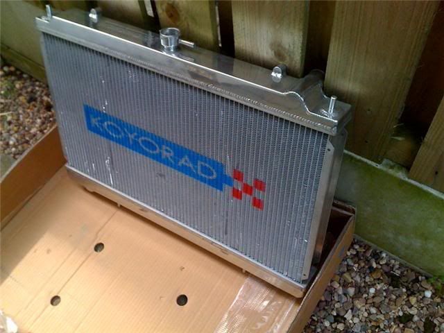

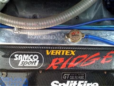

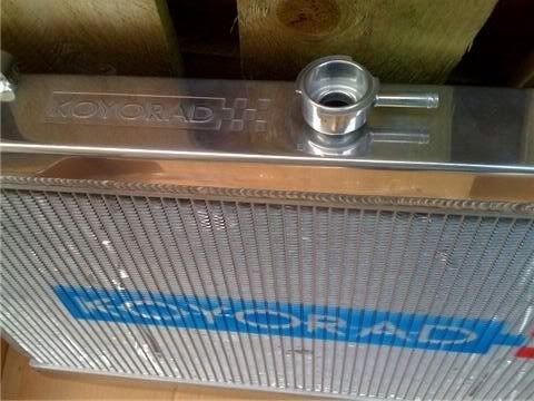

Koyo Rad 53mm alu rad.

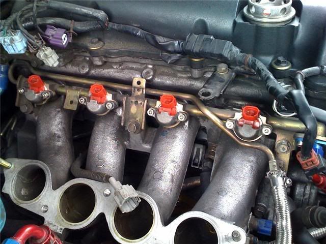

Fitted some SARD 850cc injectors as my 740cc where maxing out to 99.2% duty cause of running E85.

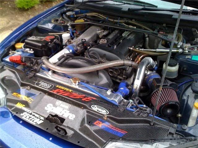

Car has now been mapped with 850cc sard side feed injectors, as I was maxing out nismo 750cc. Now I should be able to rev the car right out with out worry.
That is what I thought until I was road mapping it, now I was near maxing out my Z32 AFM, was hitting 4.8v at redline. Found that couple of the fmic claps where loose so probably loosing boost at turbo was spining harder to compensate so sucking in more air through afm.
With that sorted I decided to remove the carbon canister fit my oil catch can in place of it, also decided to recirc the catch can as When I had it to atmosphere it was sucking in dirt and probably putting in some in the engine.
It all looks alot neater in the engine bay now.
Roll on the next RR'day!!

I'm gonna go for a Koyo rad soon - been quoted £325 IIRC... take it even with stock cowling fan it all just bolts on ok and replaces the skinny OEM rad easily??
8 May 2006
874
Dublin , Ireland

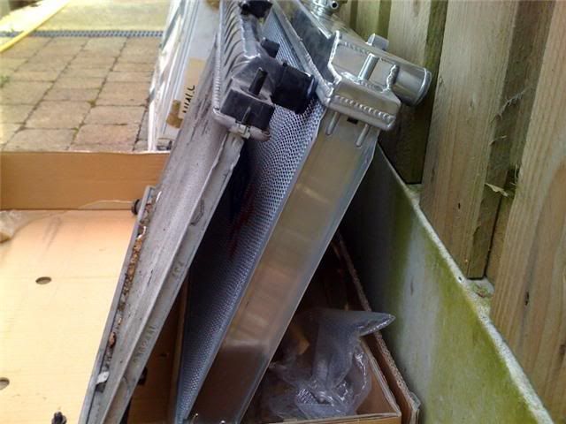

Rad bolted on ok but cowling was a bit of a fit. had to trim off bits and peices of the cowling as it was hitting of the aircon bits in the engine bay.
but it was easy enough. i recommend replacing the orginal hose clips with jublee clips.. as mine was leaking coolent from the pipes.
Thanks for the tip mate :)
Will get Jubilee clips and perfect time for more blue silicone hosing lol ;) Although I'm gonna get fed up of draining and changing that damn coolant - done it twice in about a month cos kept having to take turbo and coolant lines out to sort out gasket problems?!

330HP=242KW on wheels, couple of silvias around with GTRS and Z32 and 740cc injectors are doing 250KW+ on wheels with 1.3Bar of boost on stock engine, also have seem forged internal s15 with GTRS boosting nearly 1.5Bar achieving 280KW on a dyno run. so neither the AFM nor the injectors should be maxed out IMO. maybe ECU mapping isnt appropriate?
