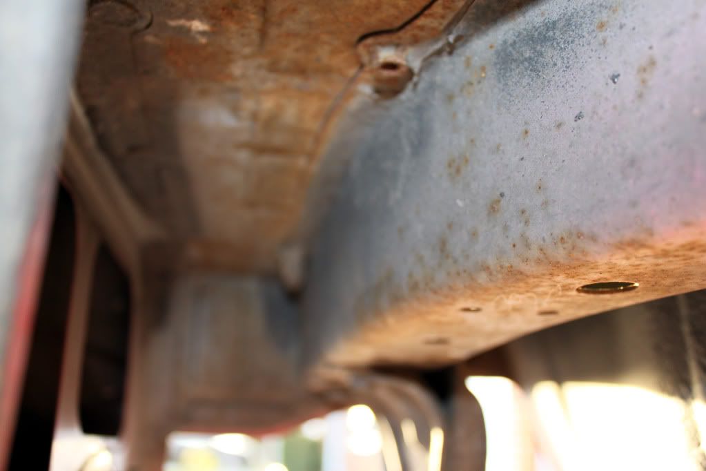

More progress -

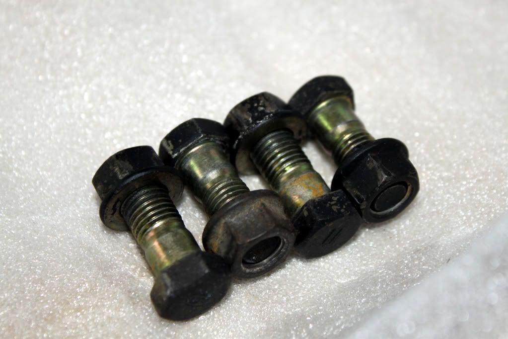

Got myself some more prop to diff bolts from japperformanceparts :)

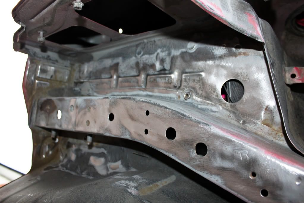

Started the prep work now, which I thought is the easy bit...but tbh rubbing down for a few hours starts to ache your arms after a bit :D

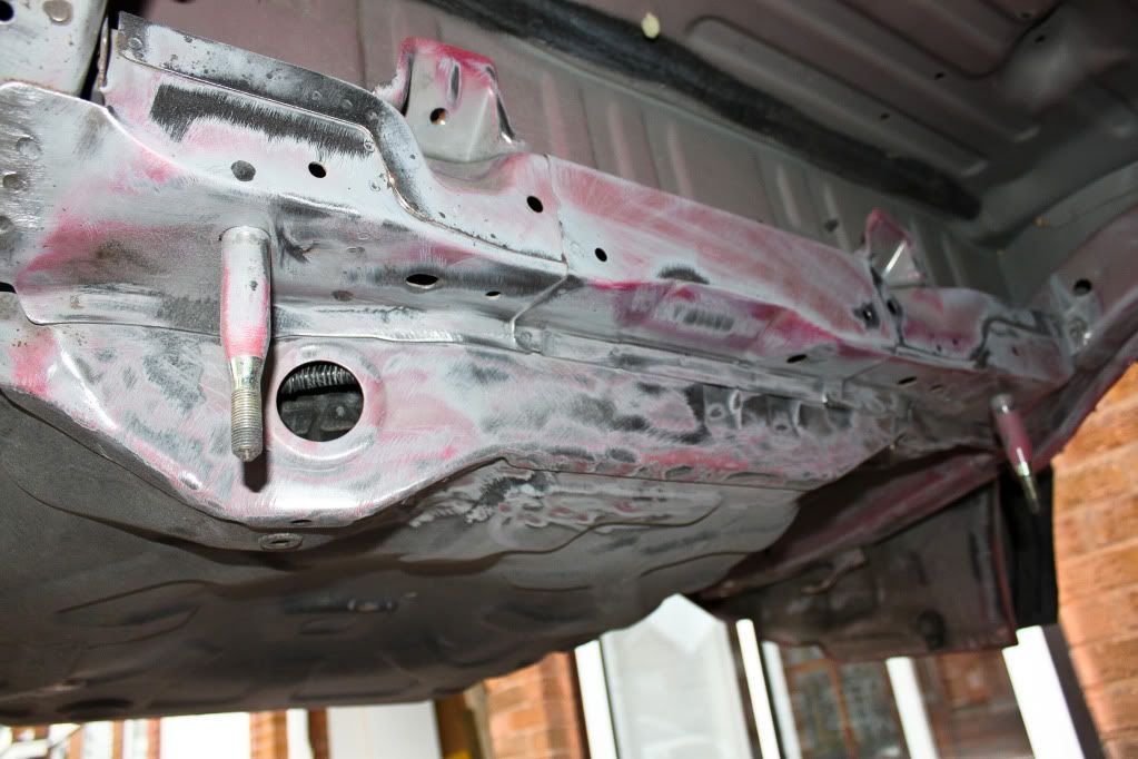

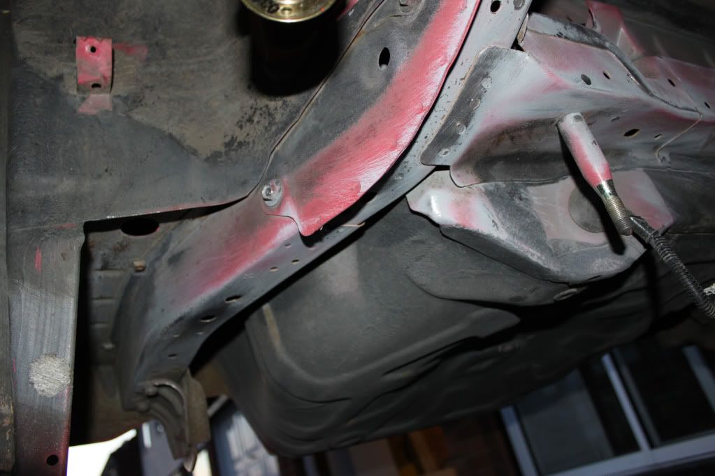

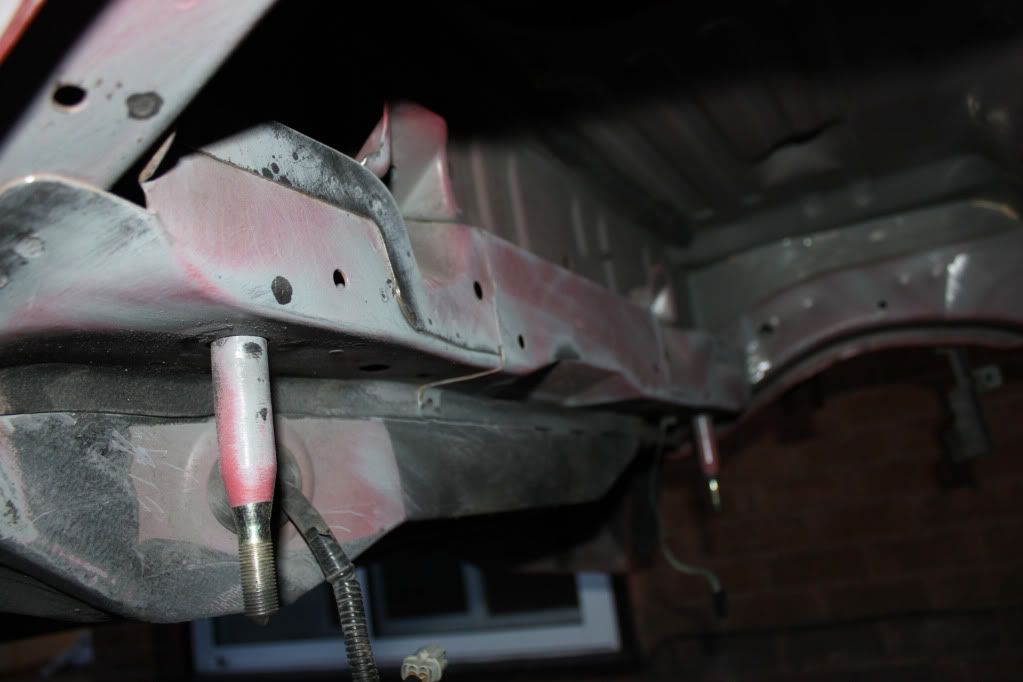

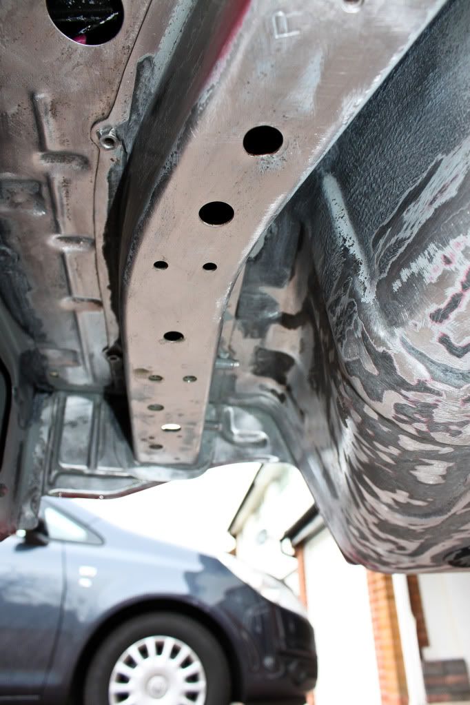

The whole underside needs treating but there are a few main areas like so -

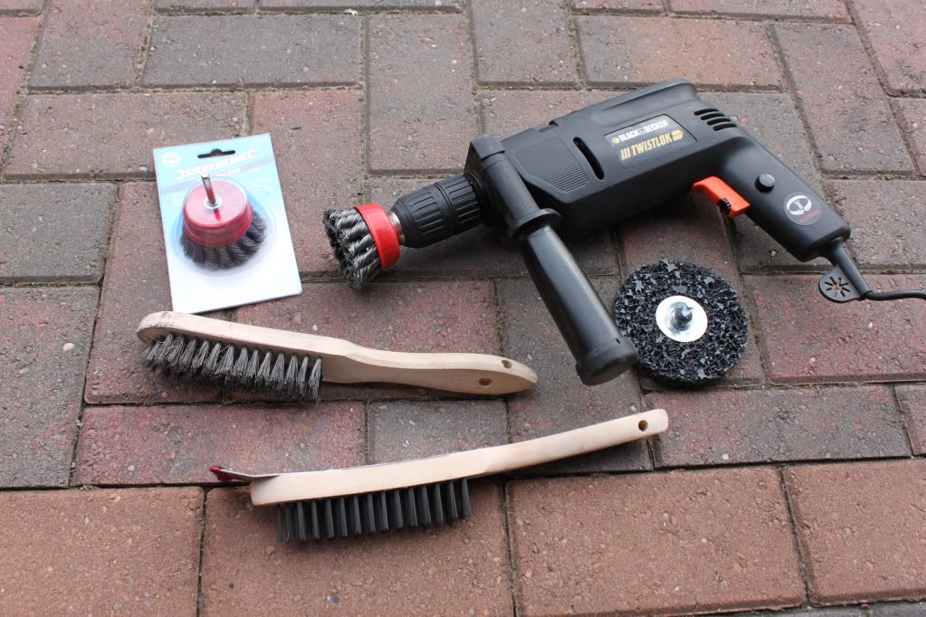

I began to rub down using a wire brush and made a good start -

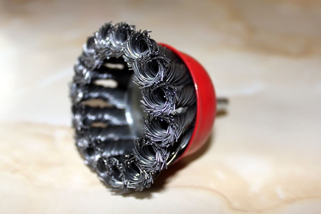

Then I decided to switch to electric for a bit :cool:
This baby looks like it could do some damage on a high power drill :nod:
and so it did...
I need to pay a few more visits to the car and continue rubbing down..get most of it off I can then I will wash it down with Surfex HD from Bilt Hamber and then apply the Deox Gel to the hard to get / stubborn places. After that and im satisfied with the results I will move on to priming with Electrox.

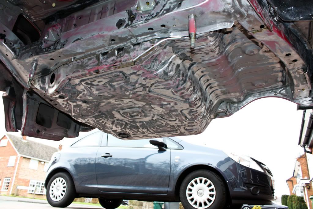

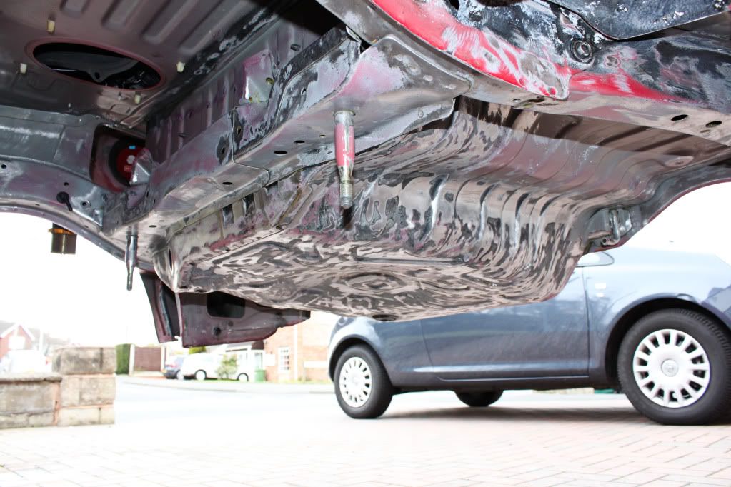

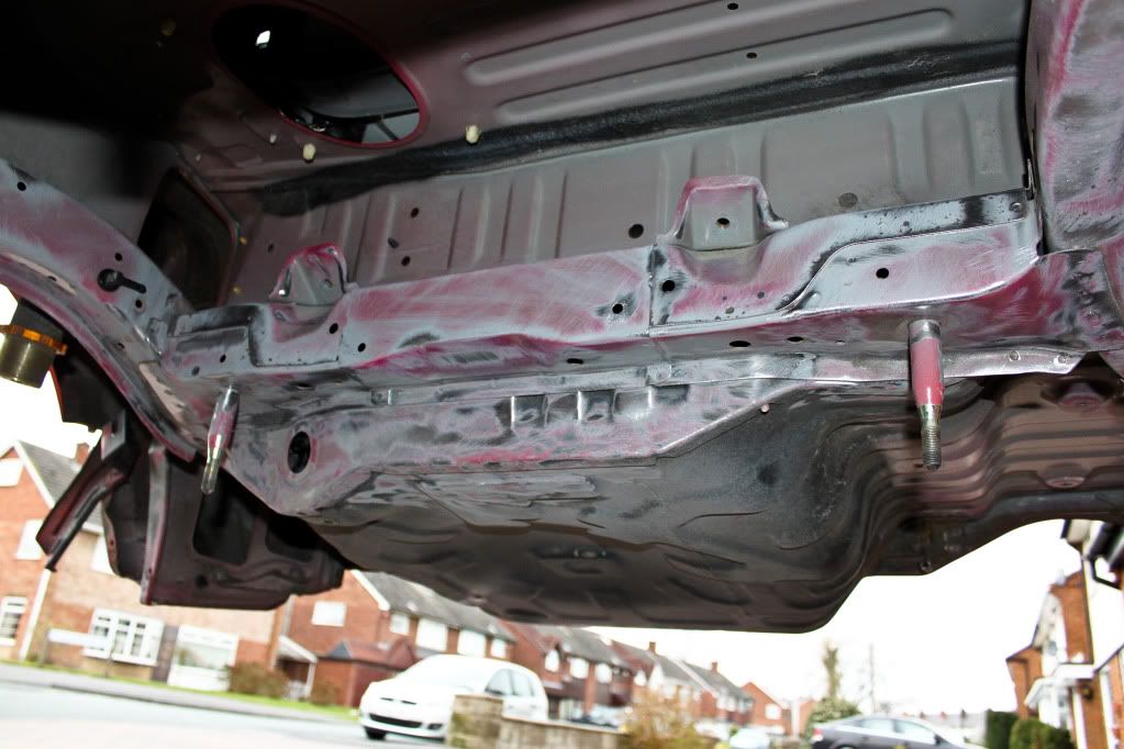

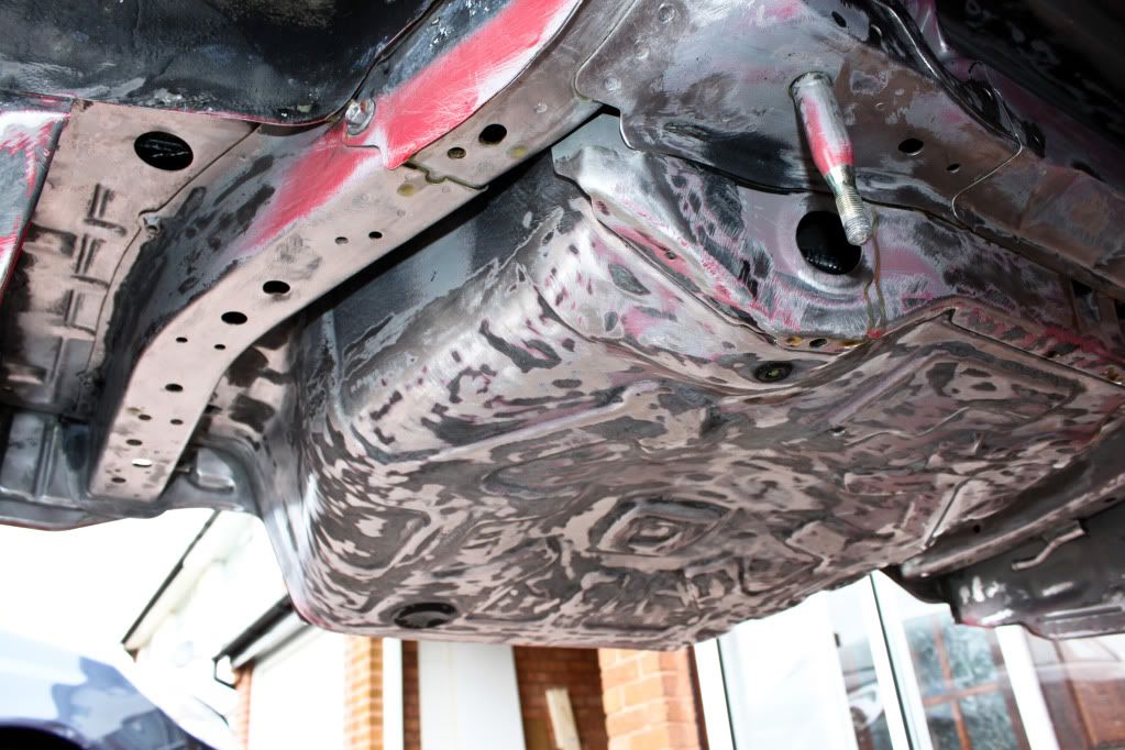

More progress over the last few days -

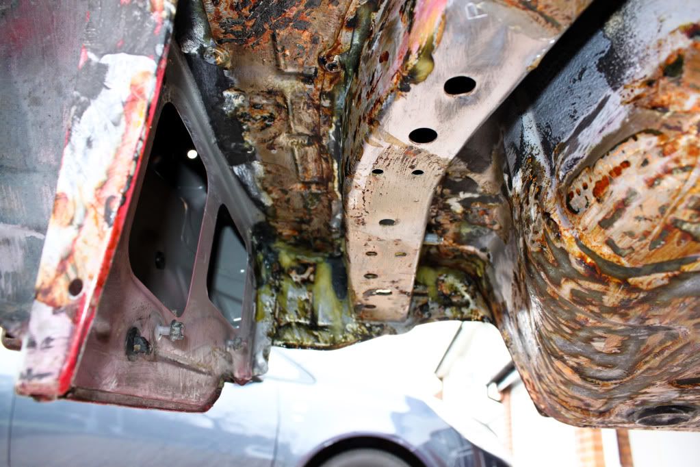

Got rid off all the underseal that was on the wheel well -
Andeep you were very right about bare metal rusting quickly! I went back the day after doing some work and washing it off (I also dried it the best I could too) and there was loads more rust starting to form! I was like :mad: omg its a never ending battle!
So i got rid off all the new bits and begin getting rid of more and more...

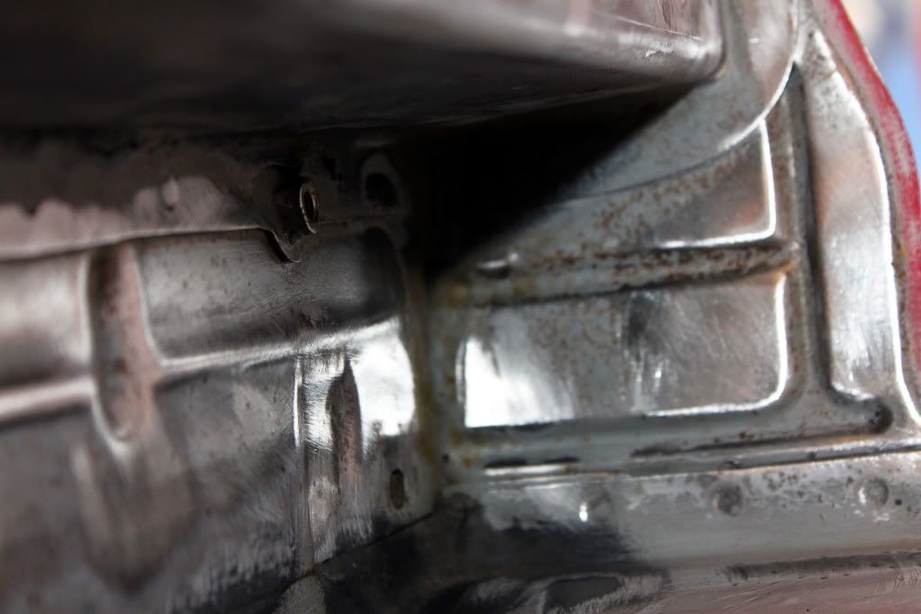

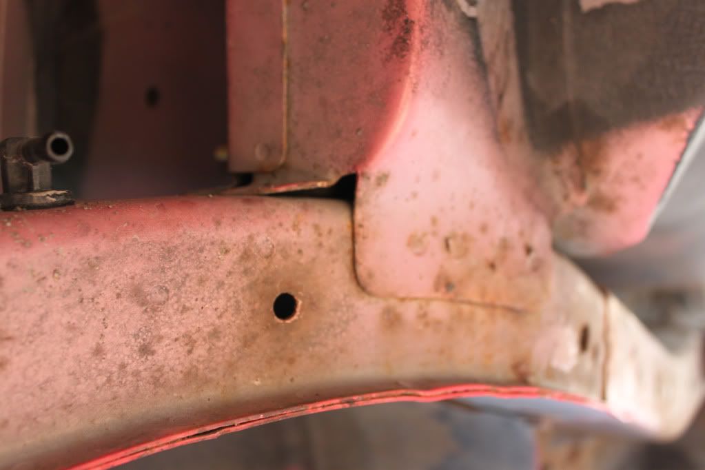

After what seemed like forever grinding etc I was left with bits that just couldnt be removed due to the complete awkwardness of where it is -
Such as

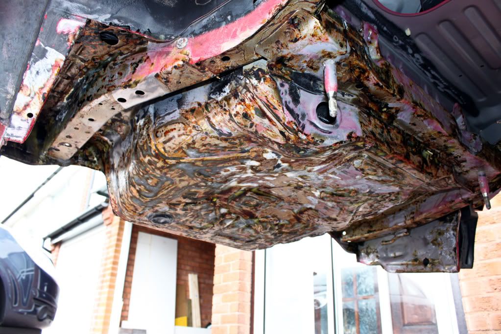

So I thought it was time to use the Deox Gel :nod:

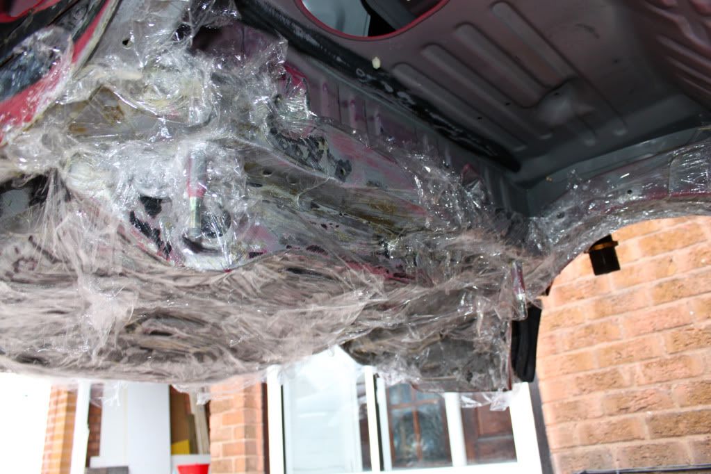

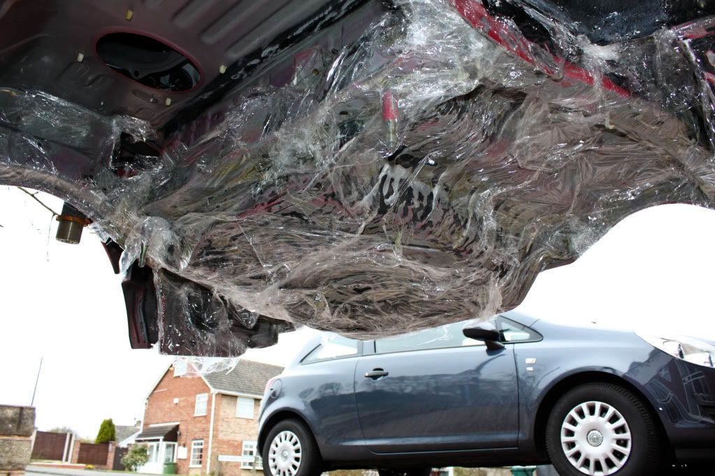

I put it on pretty much all of the back end for 2 reasons -
1. So the bits I would be painting first would be 99% rust free
2. To try and stop it rusting before the next time I go back! :|

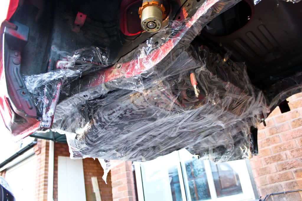

I then wrapped it in cling film so it doesnt dry out as much.

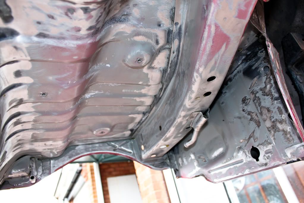

This is what I was left with after removing the cling film this morning, this is after 30 odd hours
My first reaction was :eek: It looks like its got worse...
But I began scrubbing and it came off with a little work :nod:

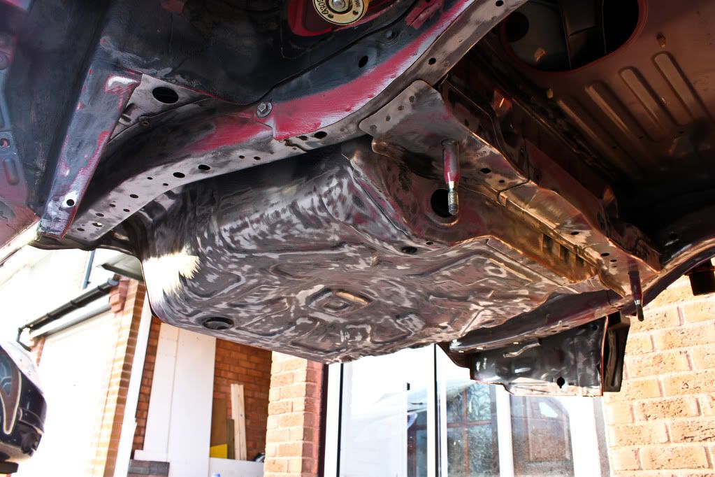

After scrubbing for a few hours with brillo pads, a wire brush and a decent mixture of hot water and Surfex HD it was left looking fab!

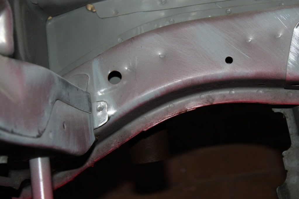

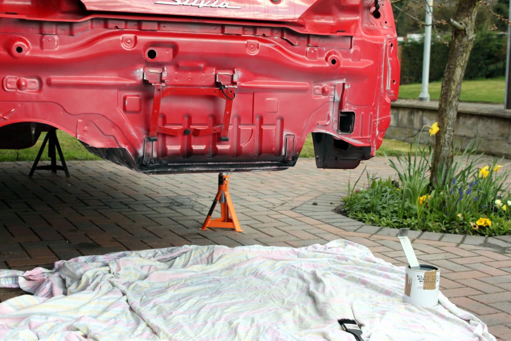

Yesterday’s work -
I first cleaned all the Deox gel off and gave it a good wash, this took the best part 3-4 hours surprisingly! Made sure it was as good as I could get, then I dried it all off using a drying towel and a heat gun.
I was then ready to de-grease the area that was going to get painted.

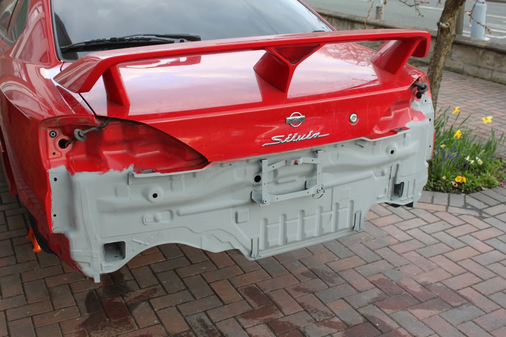

The rear of the car behind the bumper was in near perfect condition so I just cleaned it and grinded a few areas that look like a potential risk -

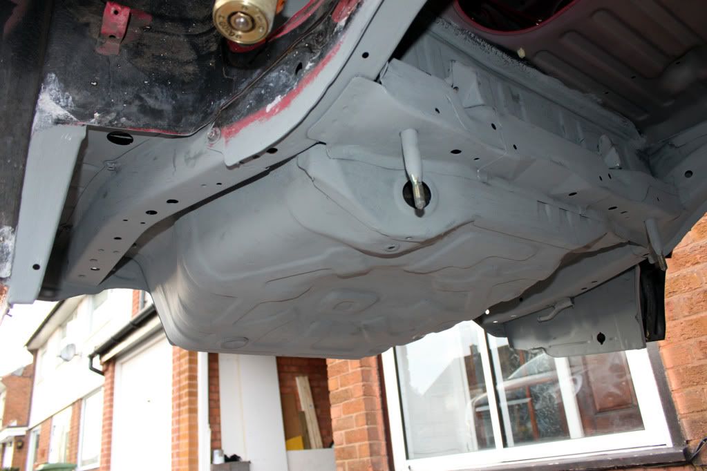

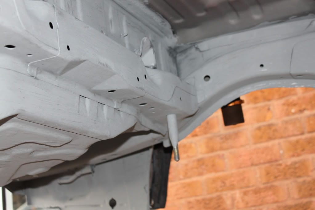

I was then ready to paint -

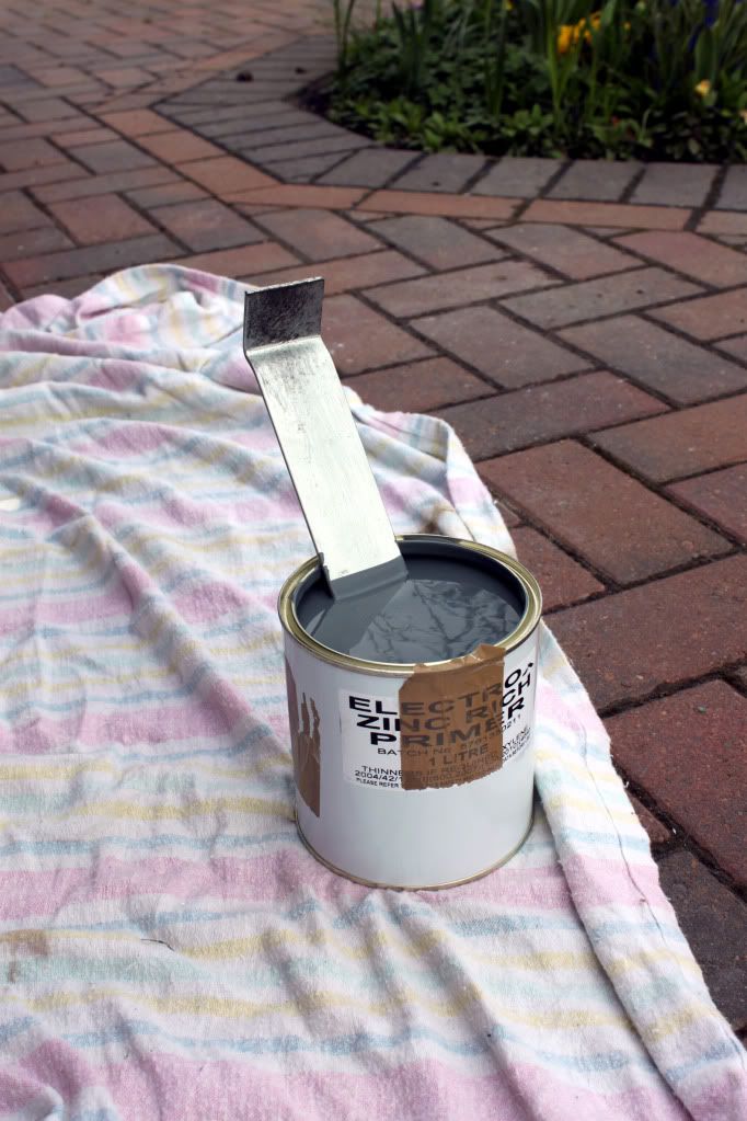

It says you have to stir the primer well before and during use!

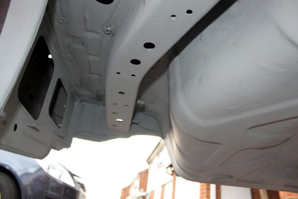

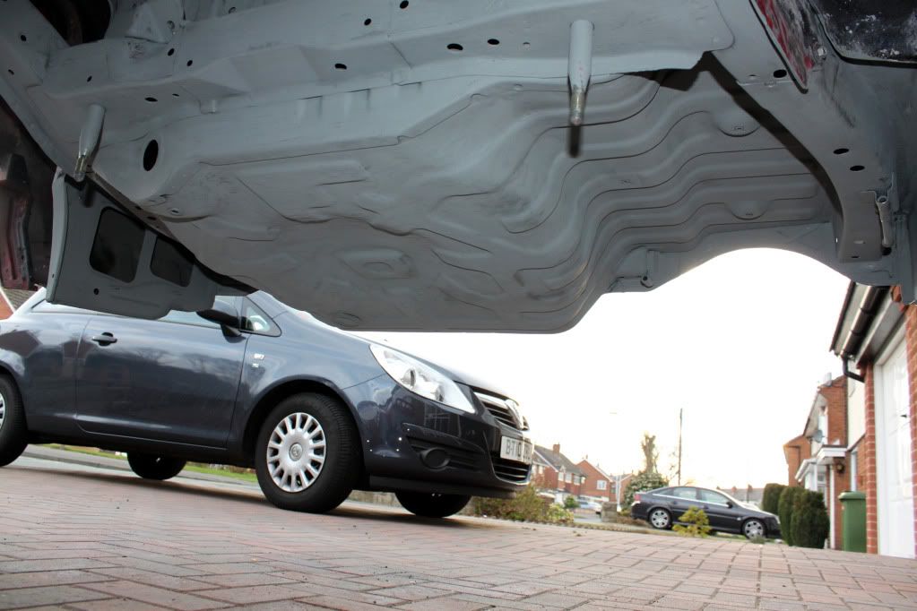

Done -
I thought the Electrox was going to be much different to how it was, I thought it was going to be super thick...it took more than 1 coat in a few places to cover the area as I was getting a lot of brush strokes in the paint so you could see bare metal...I made sure I was constantly mixing it during use as well.
It will probably need another full coat tbh but at least it’s done now and I don’t have to worry about it rusting anytime soon :D
