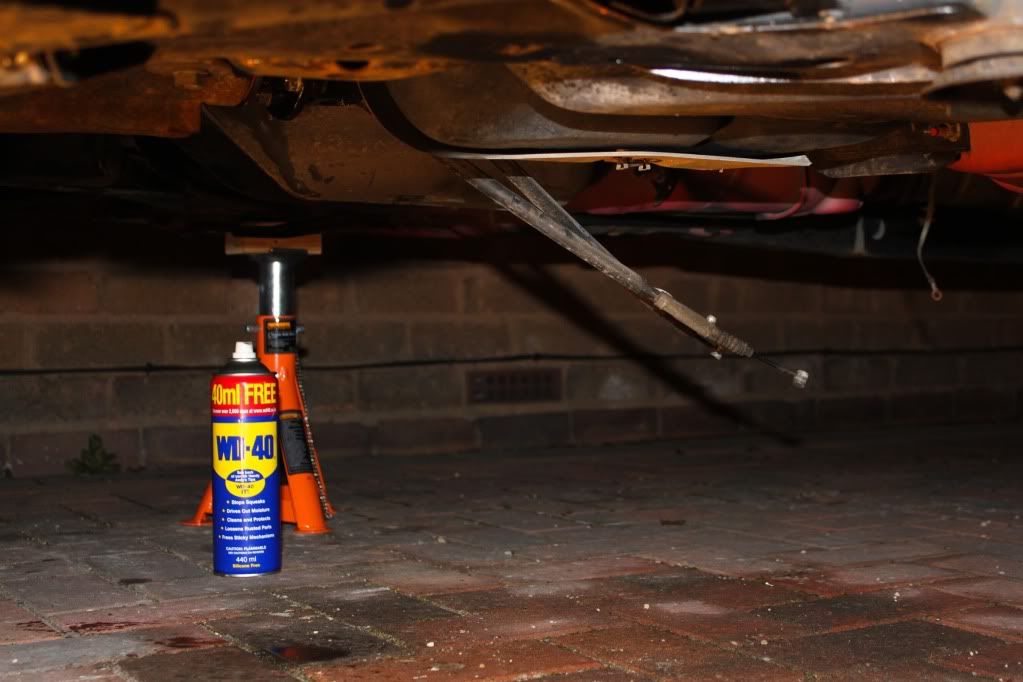

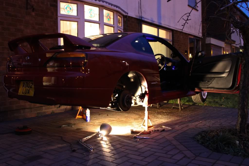

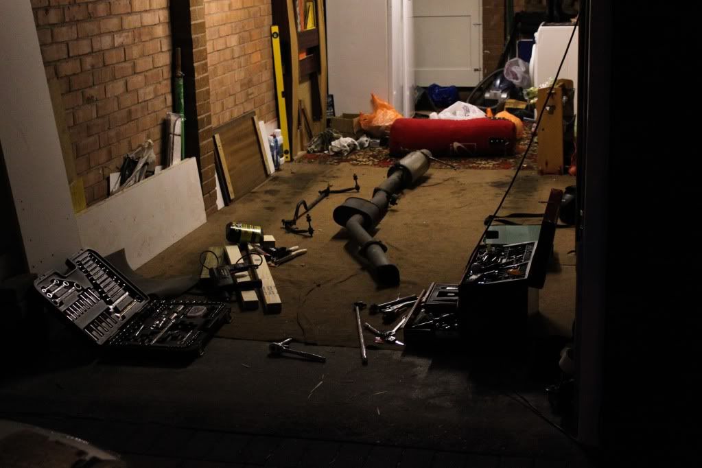

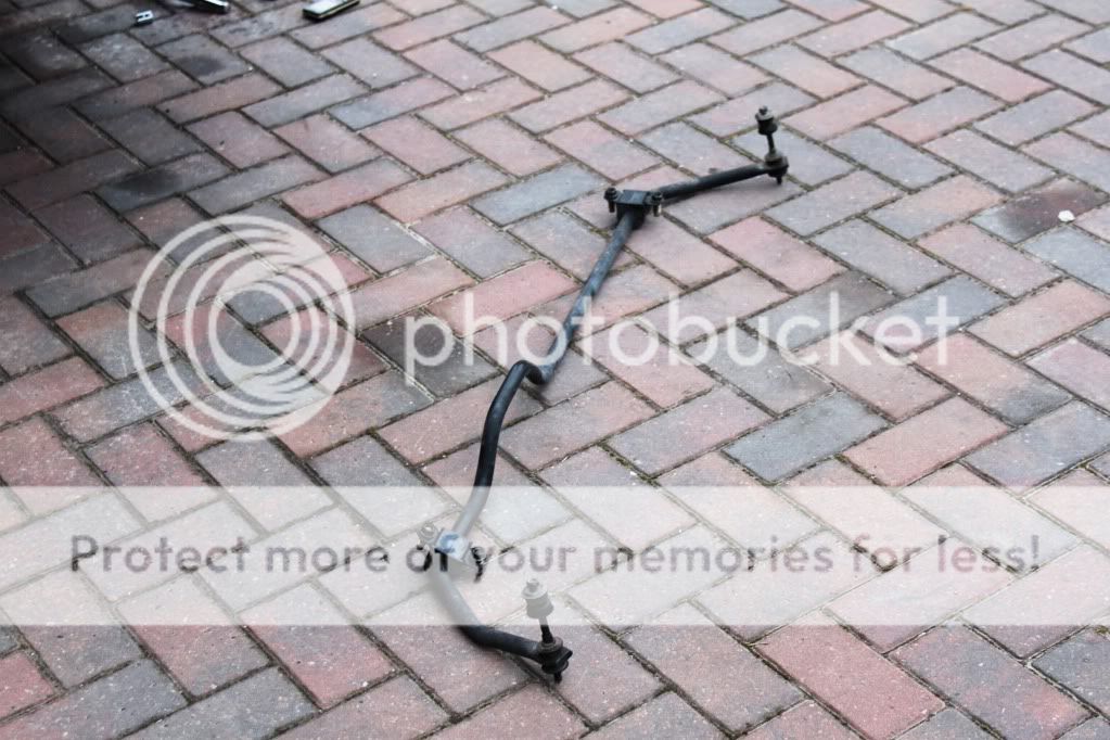

Okay ive finaly made a start on removing the subframe ready to treat the underneath and protect it from rust.
Tax ran out end of December so thought id SORN it and do this for a few months and try and get it ready for the summer.

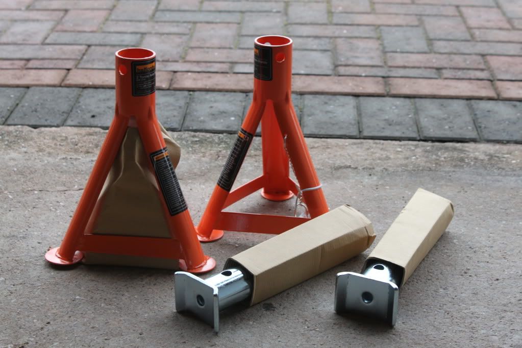

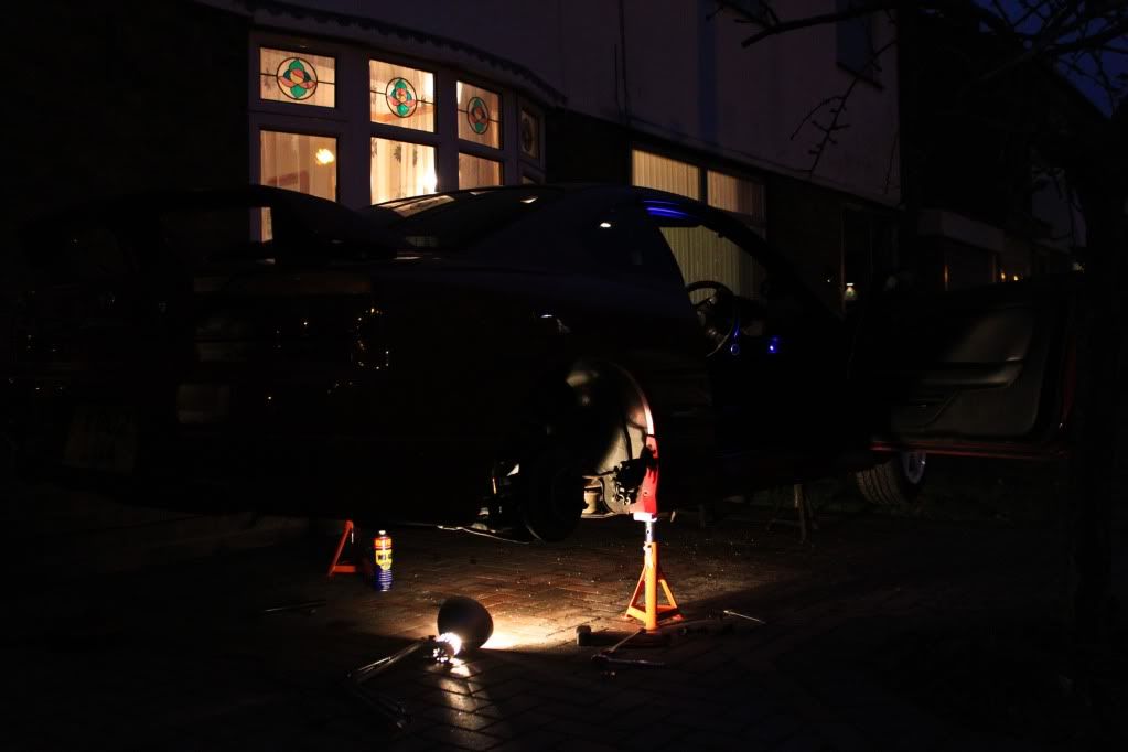

Had to buy some new stands as I didnt trust my old ones, so got some ones from Halfords which will do the job.
Started by getting it on stands supported at the rear by wooden blocks that I made so it can be supported on the sill.

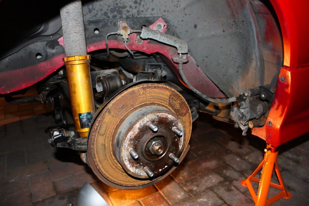

I then loosened the hub nuts so I can remove the discs much easier when the subframe is off.

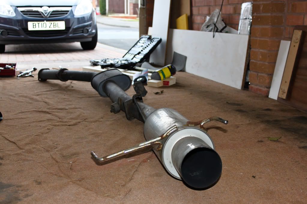

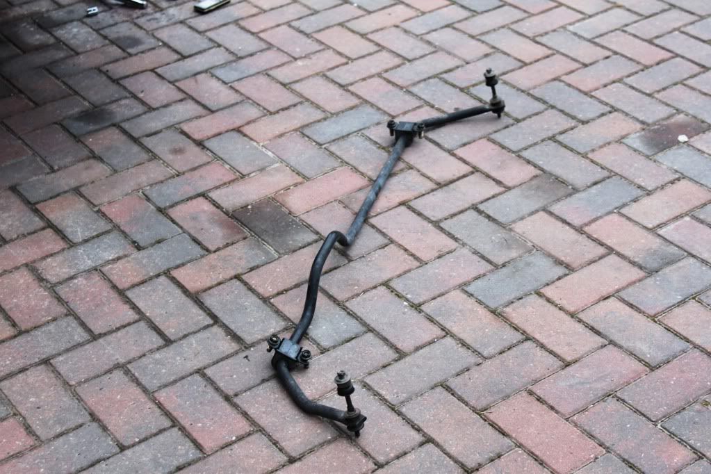

I then removed the exhaust and rear arb, I was supprised how heavy the exhaust was tbh, for some reason I was expecting it to be really light but I spose 3" bore and a massive rear box adds up..

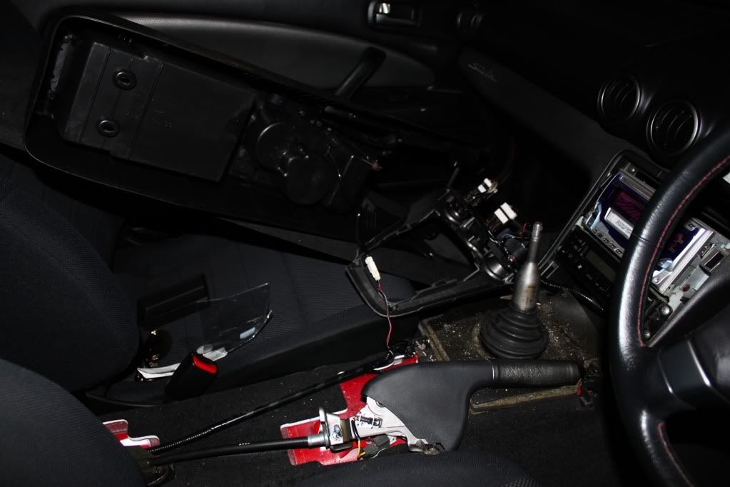

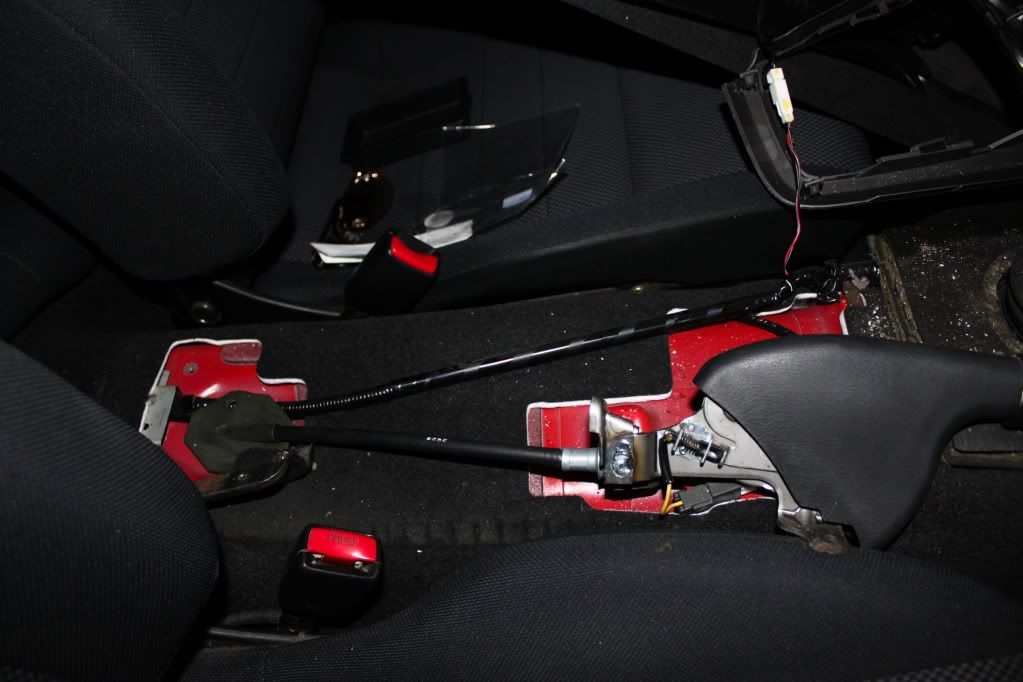

I then removed the handbrake, starting at the calipers and working my way under the car to where it goes inside. I was a bit of an idiot here as I thought to remove it completley you had to dissconnect it from inside..but later realised you could do it from underneath :annoyed:

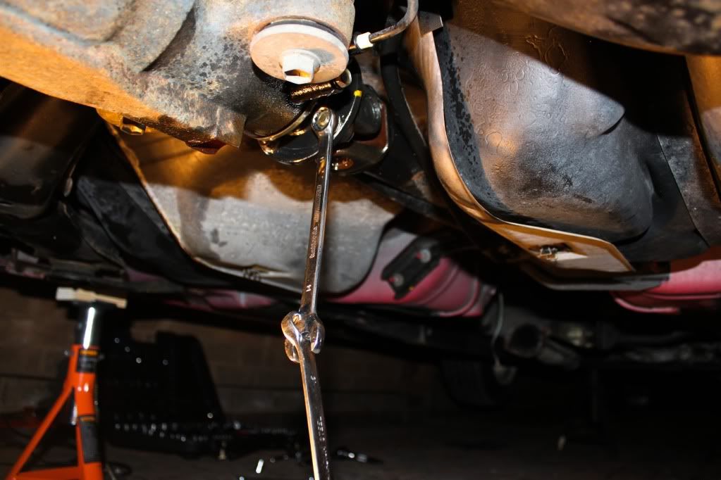

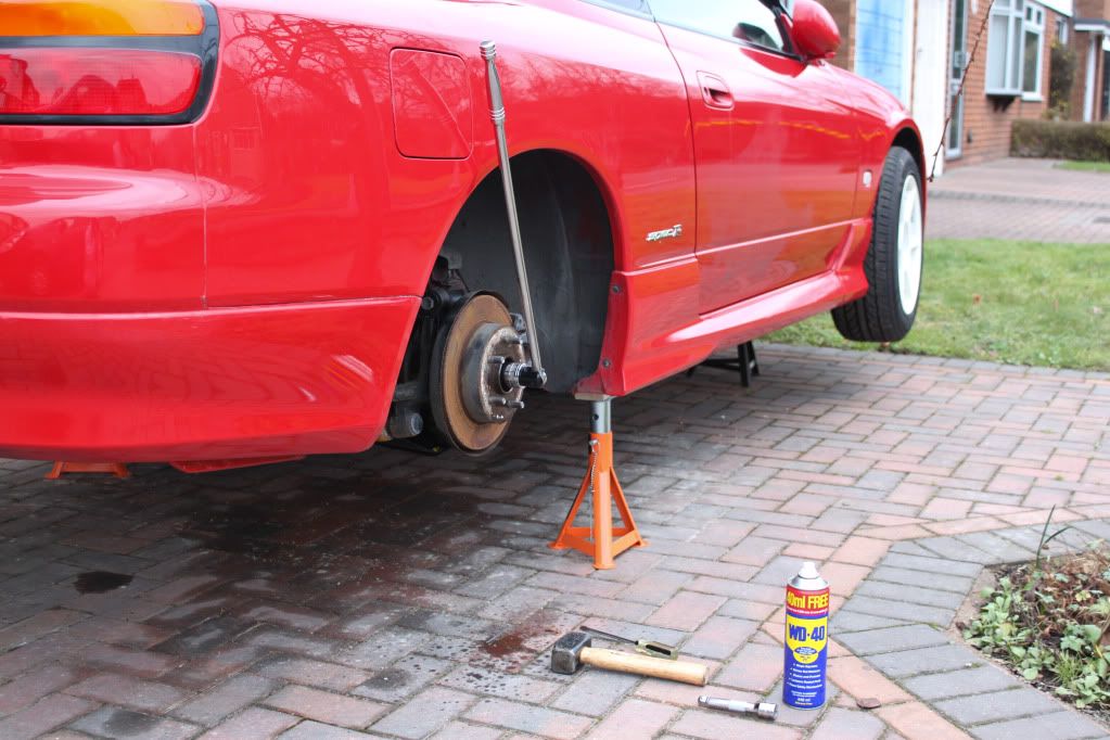

Thats really as far as ive got atm, I tried yesterday and again tonight to try and remove the prop shaft but the stupid bolts wont come out! There so so tights its unreal!
Few random piks -
Once ive managed to get the bolts out and remove the prop I should be almost ready to drop the subframe, think theres a few connectors to unclip etc

Good process pics mate, shame bout the handbrake thing. U could of left the calipers hanging from the cables with the subframe off..

Im annoyed now though as I need to re-fit the bloody handbrake so I can try and loosen the prob bolts! :annoyed:
