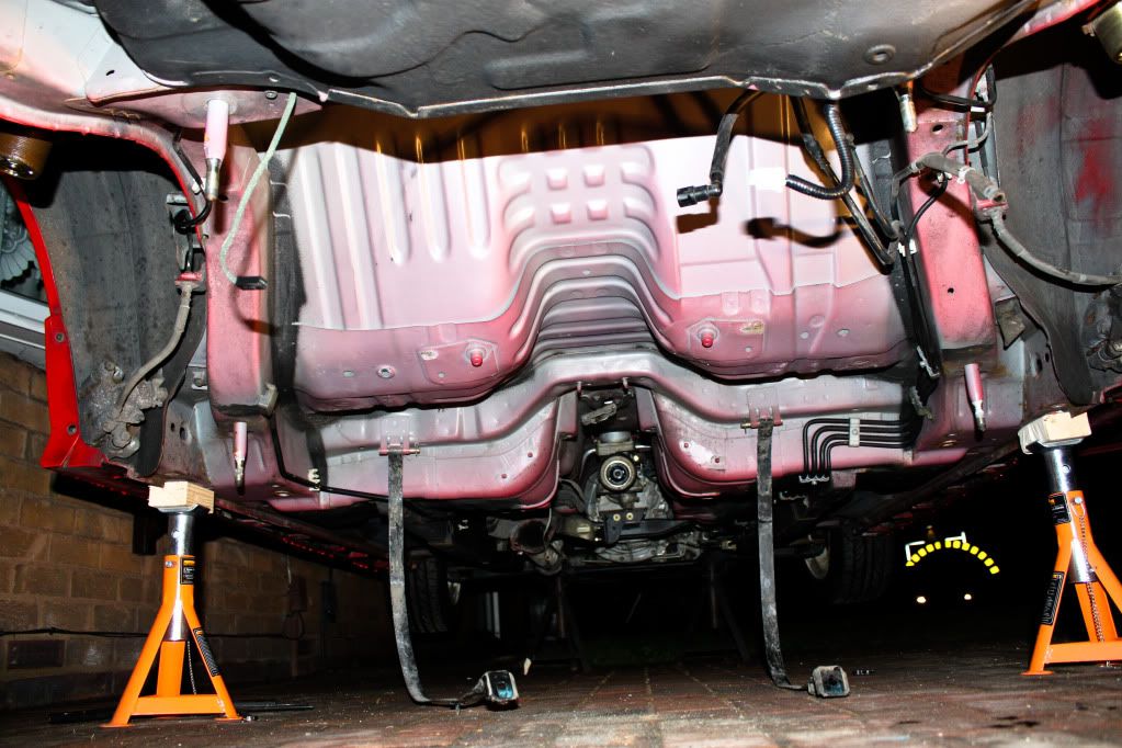

Did some more on the car Wednesday, there was still a few things left to remove before I can prep the underside.

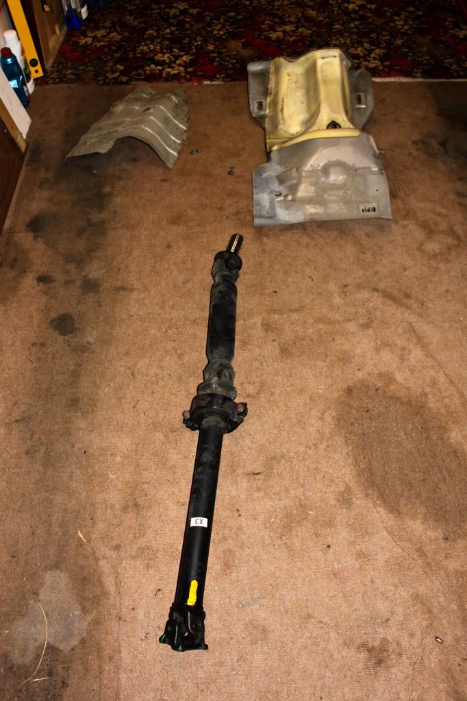

I removed the weird shaped brace that goes under the prop, removed the prop and all the heat shields -
I was still debating weather or not to go the extra mile and drop the tank...:rolleyes:
In the end I thought why not! Do the job properly :D

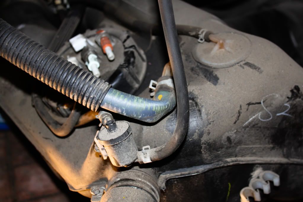

Started by removing cover followed by the hose clamps and brackets on the filler neck -
I thought it would be best to detach the hoses from the filler neck and then pull them down with the tank as you cant get to the clip at the tank side -

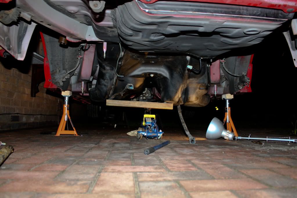

I then supported the tank so it could be lowered down easier, I wasn't sure how heavy it was going to be as its still got about 1/4 of a tank of super! so thought this would be best.

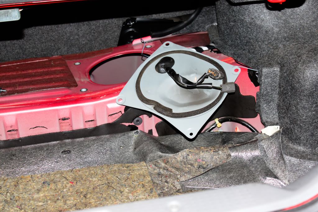

I then removed the tank strap bolts and the tank began to lower...it got to a point and then wouldn't drop any more, I thought great its going to be the bloody fuel pump wires isn't it... I thought that you could unclip them from underneath but you couldn't so I removed the back seats hoping to gain access to the top of the pump....nothing! Its in the bloody boot lol! :annoyed:

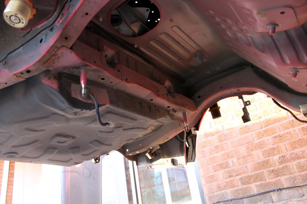

So I removed the plugs and dropped the tank!

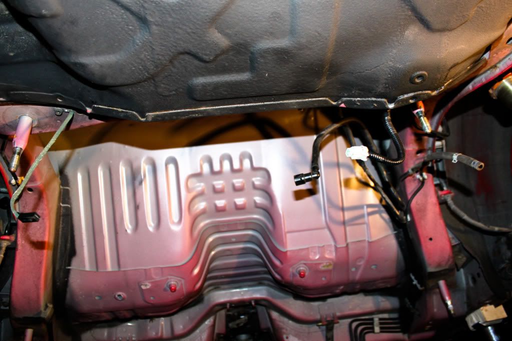

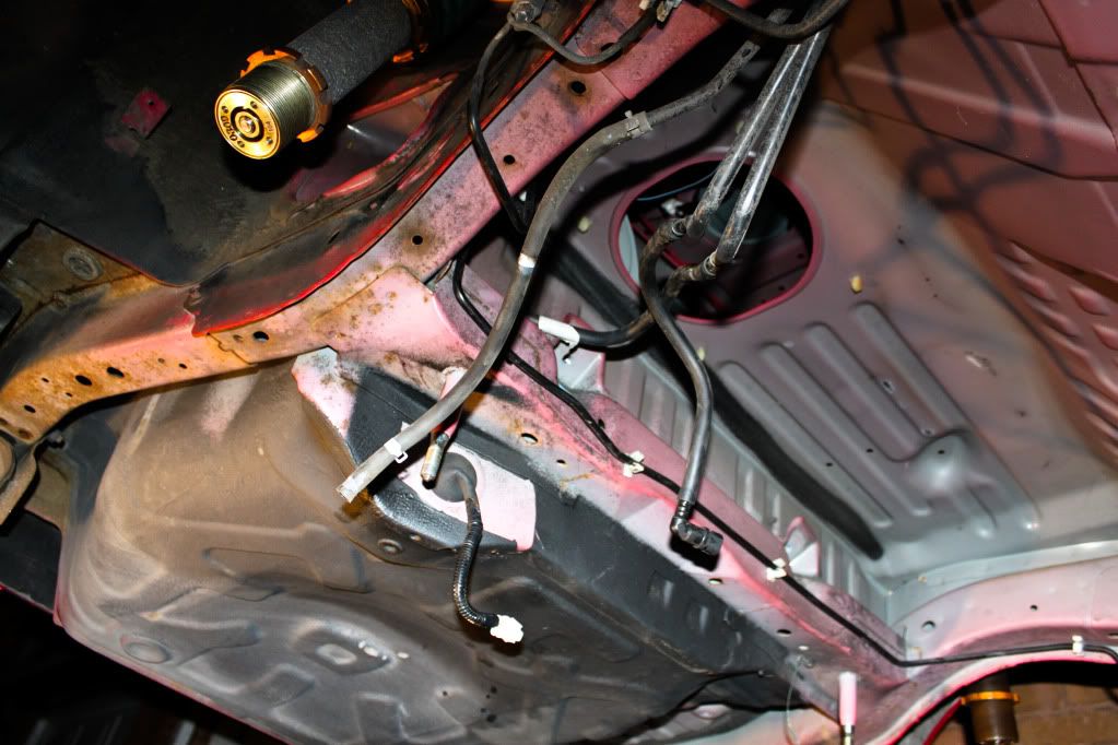

Fuel lines off - (Must remember which ones goes where, but they are positioned in a way that makes it obvious, still I put some tape around the red one)

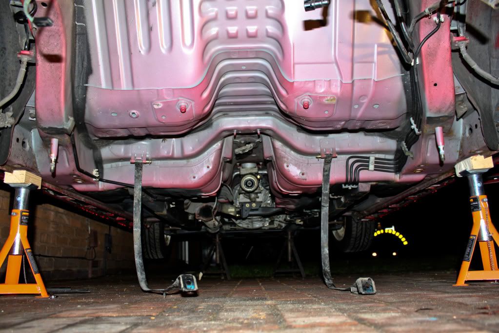

Its starting to look less like a car now :D

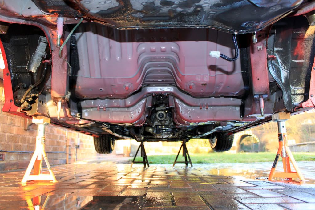

Its exactly how I was hoping...nice and spotless under the tank :nod:

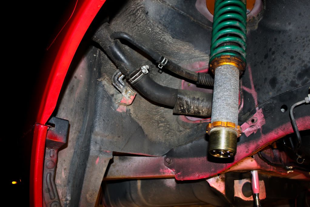

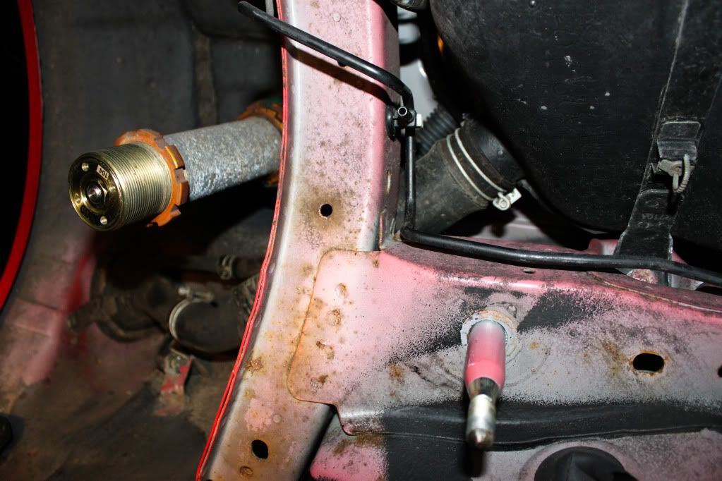

As you can see in the piks, the area that needs the most work is the box sections of the chassis and up by the wheel arch.

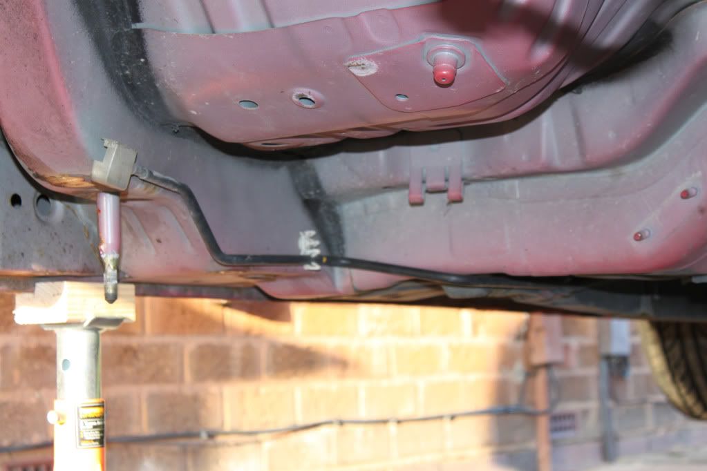

looks good mate - you wont want to drive it in crap weather when you're done - its too much hard work to put in.... all s15's seem to rust where the fuel tank rubs against the body as you can see where those little lugs are for the tank to locate - when i re-fit the tank i used some self adhesive foam rubber on the marked areas on the tank so that it doesnt happen again :)

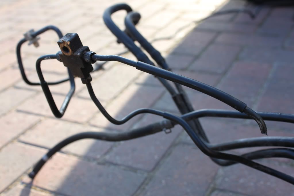

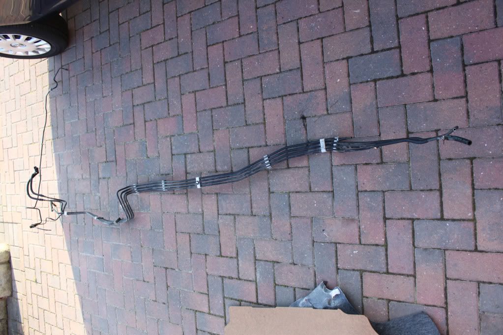

Okay so ive had the worst day working on the S15 ever!

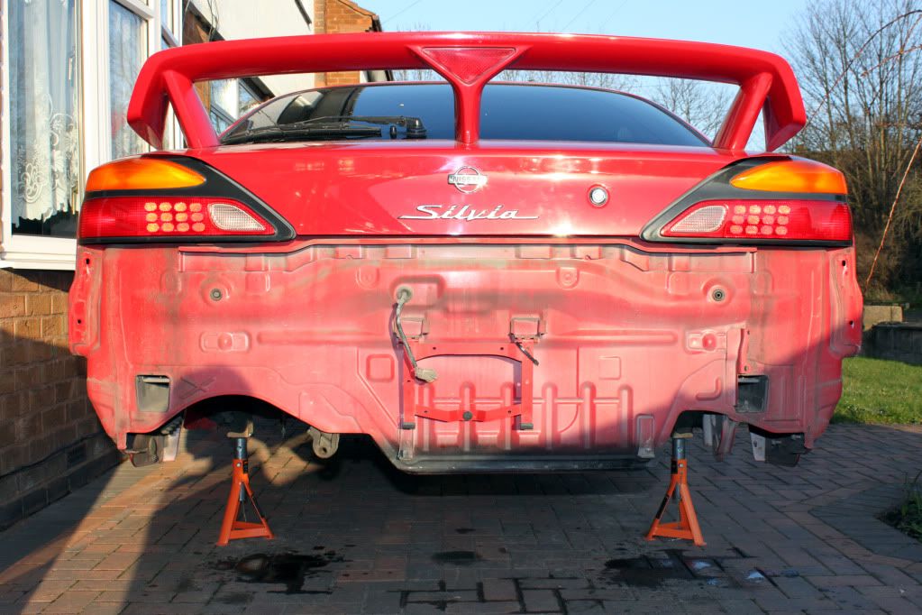

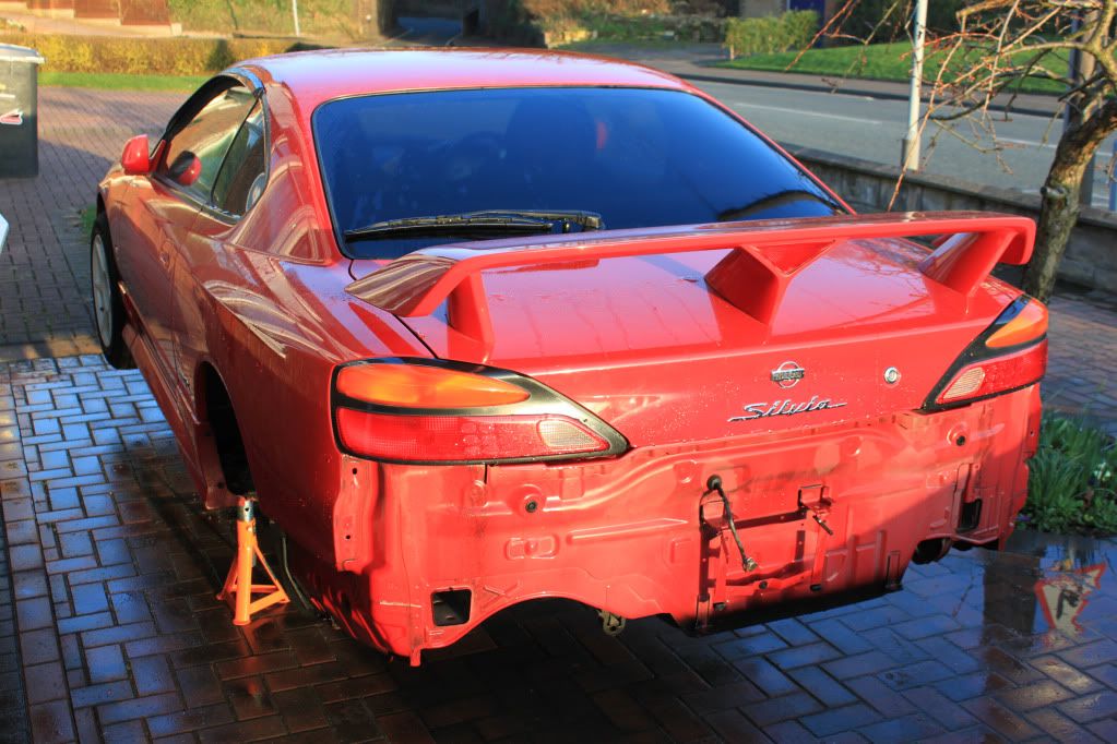

Started off by removing the rear bumper, this took the piss as the stupid japanese clips at the top and bottom dont seem to want to come out?
Next job was to remove the brake and fuel lines...
This is where it all went to piss!

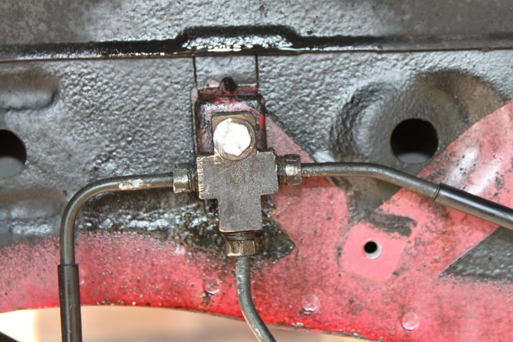

The screw which holts this t piece got rounded off fairly quickly...and so did all the other connections
This was due to using a normal 10mm as apposed to a 10mm flared spanner I think...
But yeh anyway I thought everything was messed up then and there was no way of removing any of the connections, I managed to undoo the passenger side connection so I just cut the brake line on the driver side so they could drop and used a saw to get the rounded screw off!

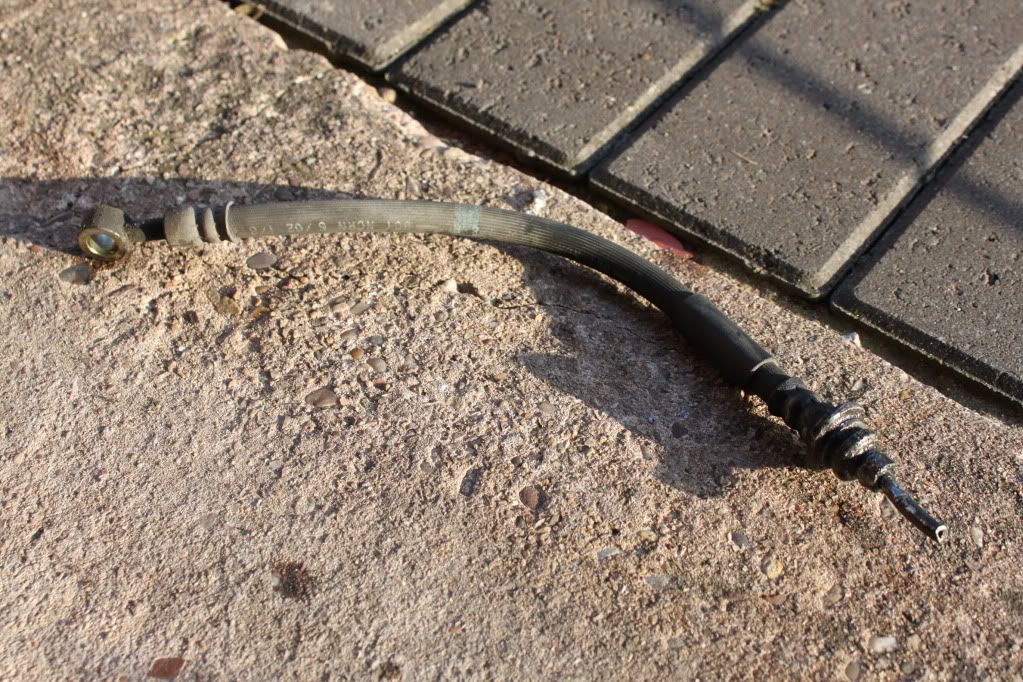

Much later I managed to remove the other end of the lines...I really didnt know how to go about this easily and the only way I could see possible was to remove the lines from filter and then seperate the hose next to it?
Got them off -
But im left with this now...
1 May 2010
830
Wolverhampton
I need to make up a new brake line for the rear with new t piece and all new connections...im going to make a help thread about this so if you have any advice please let me know.

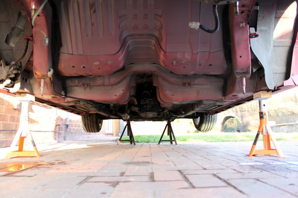

Its all clear now and ready for prep work.

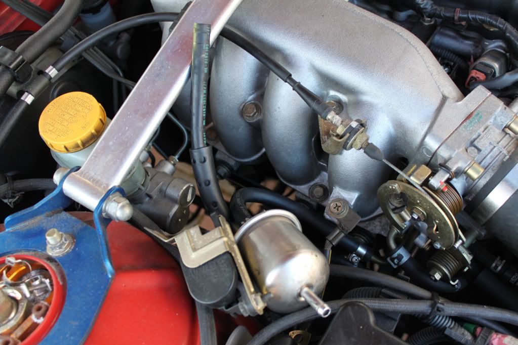

Does anyone know what this line is for?
Cant remember now and cant figure out where it connects to?

might be a vent line
^^^ isn't this the line that vents to atmos but comes from the carbon canister setup? Where does it run to assuming it goes back to engine bay area? My money's on the carbon canister which you can ditch and just ensure the hard pipes (underneath the black canister and connected together ;)
Looking good Jay - stick with it... will be worth it I'm sure!! :thumbs:
1 May 2010
830
Wolverhampton
Yeh I checked the other day and it does go to the canister :nod:
Whats the purpose of the canister then does it just get rid of some fumes? If I removed it could that mess with emissions as ive got my MOT int he summer :(
Jap emissions thing... The way I look at it it's like a complete friggin' mystery and probably cost Nissan sh*t loads to implement but WTF was the benefit lol??? :wack:
No way will that interfere with your UK exhaust emissions so don't worry about it dude :)
i've done away with the canister, but left the vent line in as no-one could explain the consequence of doing away with it......
