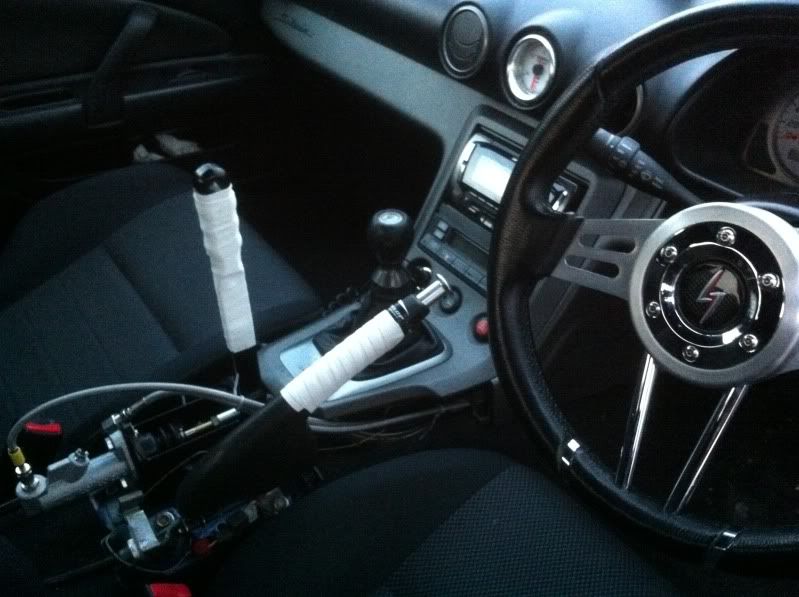

Like it dude!! You need some tennis racquet handle grip on the wand... feels soooo much nicer pulling on that than the bare Nissan plastic lol :p :wack:

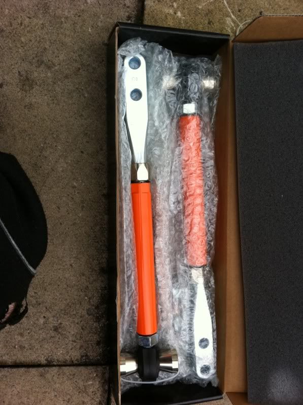

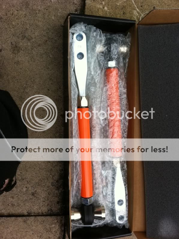

Ha ha. Go for one thing, and end up coming away with something completely different.

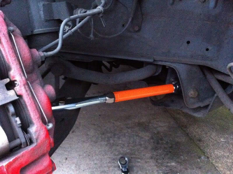

Look tidy mate. What's the quality like?
lol I got those :) Decent mod... deffo better steering feel I found. The rubber bits around the rose joint falls apart tho as Craig and I have discovered recently but the joint still seems strong and ok :thumbs:
Yeah, the rose joint itself looks alright but I wouldn't like to guess how long it will last being where it is with no protection.. Might be worth smearing some grease around it to stop water geting at it.
lol. Hate that.... definately grease them up. My rose jointed arms have survived for quite some time, but I wish I has some rubber boots to go over them (= just haven't bought them yet)

you can buy new rubber grommets from rally design for about £1 so just change them when they go.
as for quallity they look wicked.
and yea lu you can feel alot more of that the car is doing! braking is beter also since the bust dosent let the hub move.
Yep it's one of those 'real world' mods where you can feel the difference immediately dude :thumbs:
andeep - I had exactly the same problem as you... my stock tension rods were so bad on one side when you heavy braked at low speed to a stop you can see the car going forwards and backwards within the front wheel arch as if it was like a rocking horse?! Well and truly fooooked haha :wack:

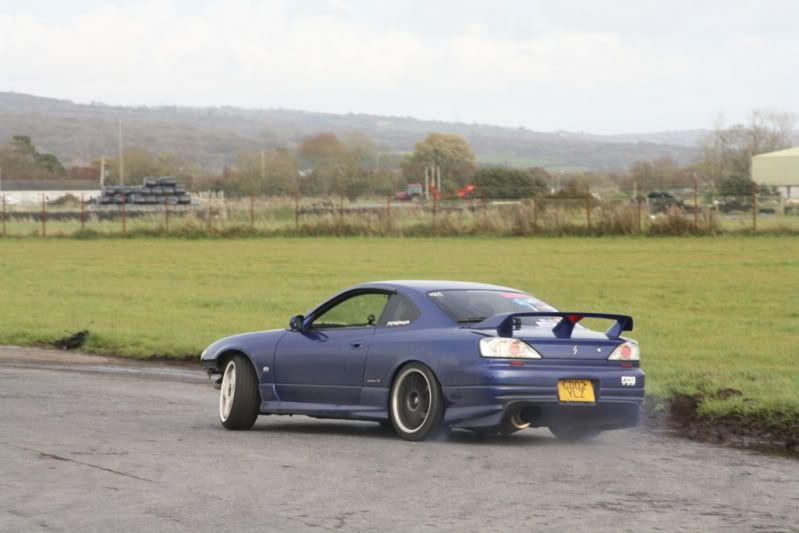

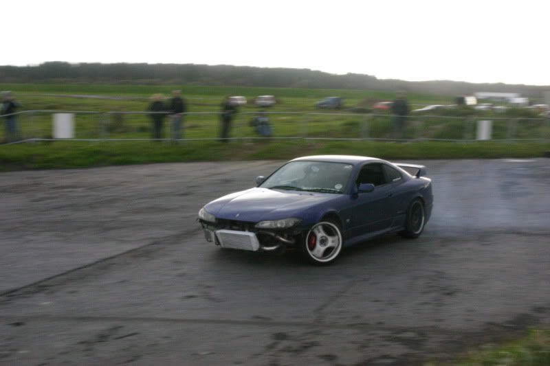

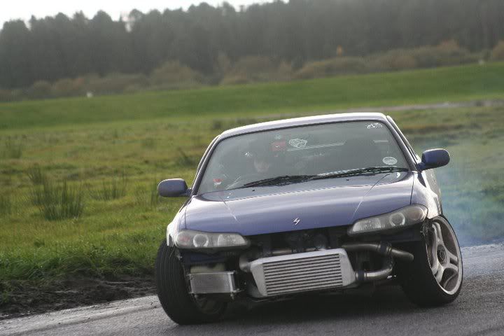

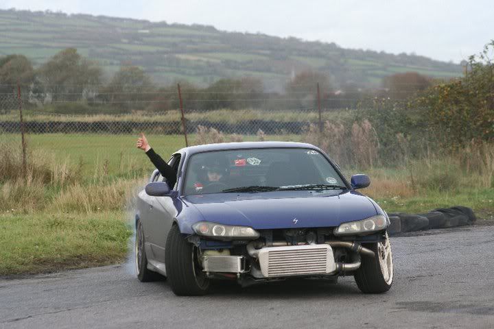

As always gutted I missed this... should have know but the pics look like from completely different angle/position compared to last time you went lol :wack:
Lookin' sweet with the sideways skillz :thumbs:

Finished my hydro install, bleed it last night works well tbh despite all the stories iv herd. Will have to move it next month no doubt when i fit the bucket seats as i doubt my arm will go back that far etc.
19 January 2009
488
UK
Fit the hydro to the seat rail like i have done mate, that way you can retain your centre console also :)
Just get greg to weld up a bracket and weld it to your seat frame. I bet you cant wait to test the wand out at pod :)
