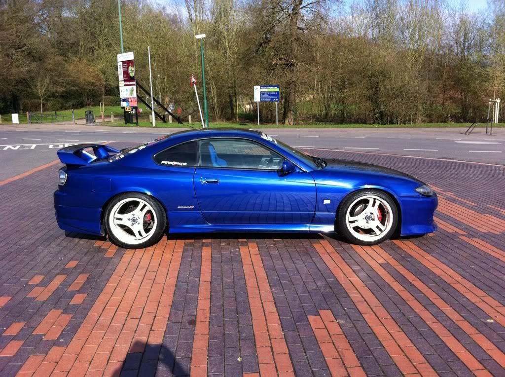

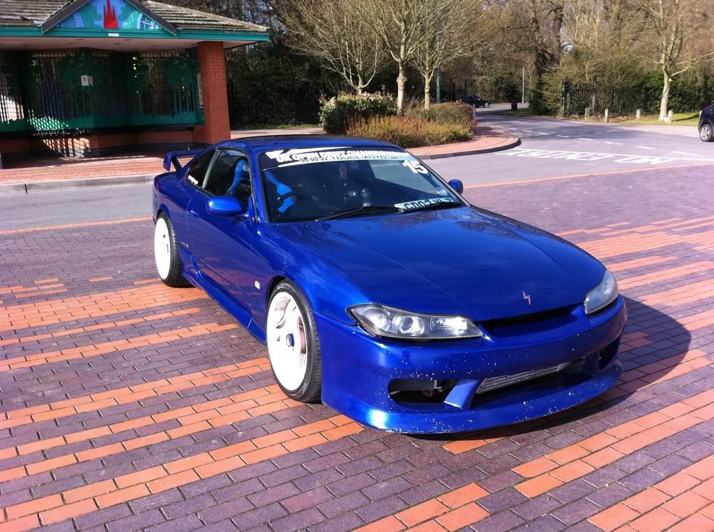

Spent today adjusting/checking my suspension settings ready gor ODC next weekend thought I'd take some pics

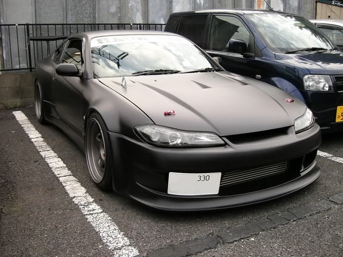

I am determined to get my car looking like the welt s15!!! The search for the parts starts now

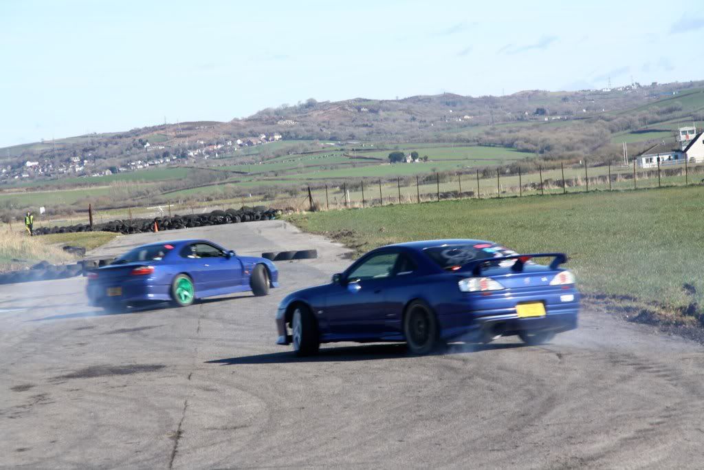

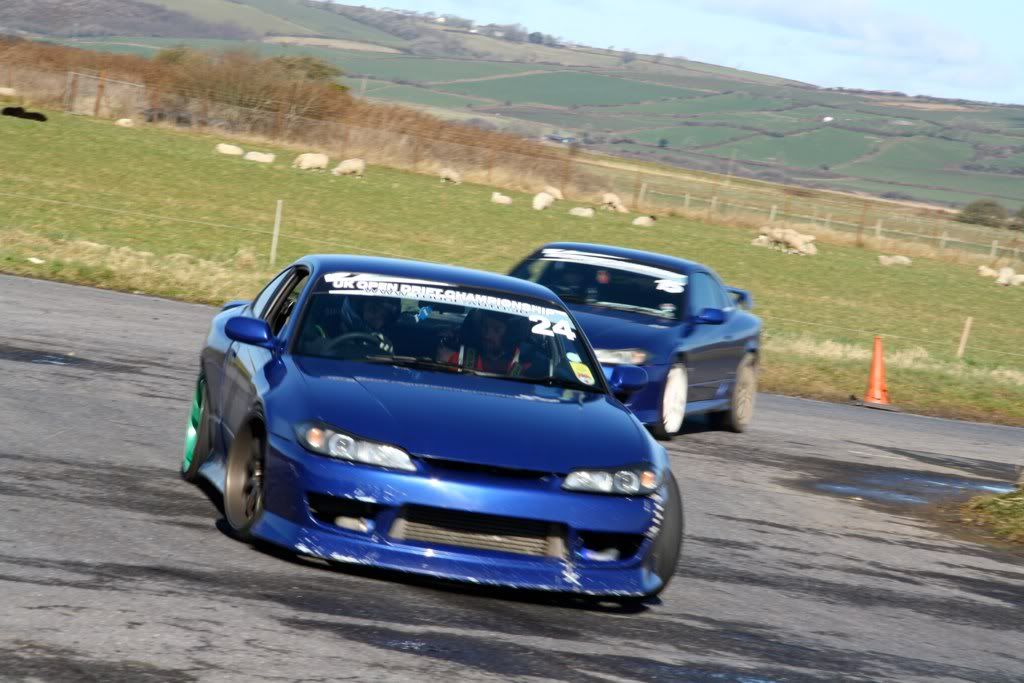

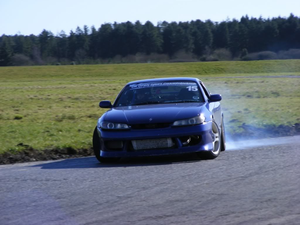

Some pics from the ODC round 1
Team blue!
I had abit of car trouble that day! I had set the car up way to stiff, Had massive understeer in the morning which i solved by lowering the front tyre pressures, adjusting the camber and the damper settings. However my spring choice for the rear coilovers was an uber fail! way to stiff. The car was lifting the back near side wheel on entries.
to top that off i pulled my hydro out of the mounts so it didnt work ......... doh!
Richy came 1st he drove awesomely all day. I came 15th which was worse than last year! o well next month new car settings more lock = win :D

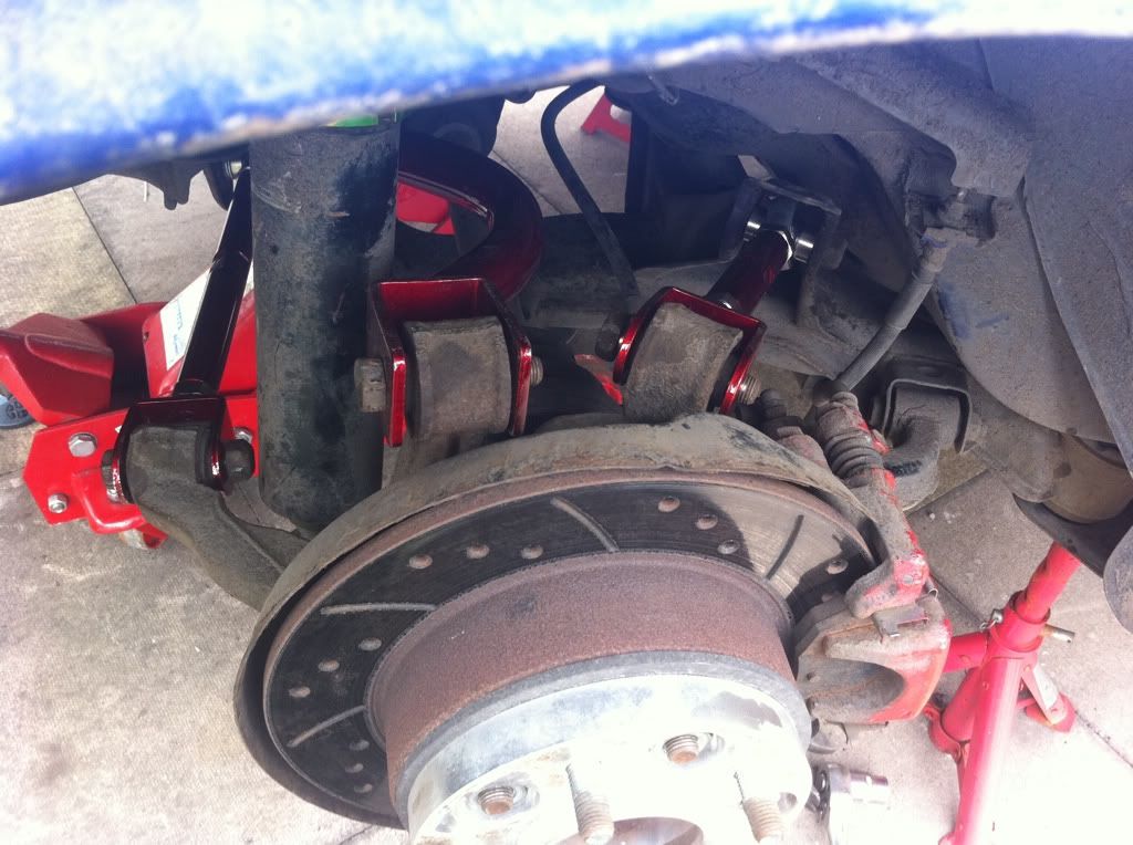

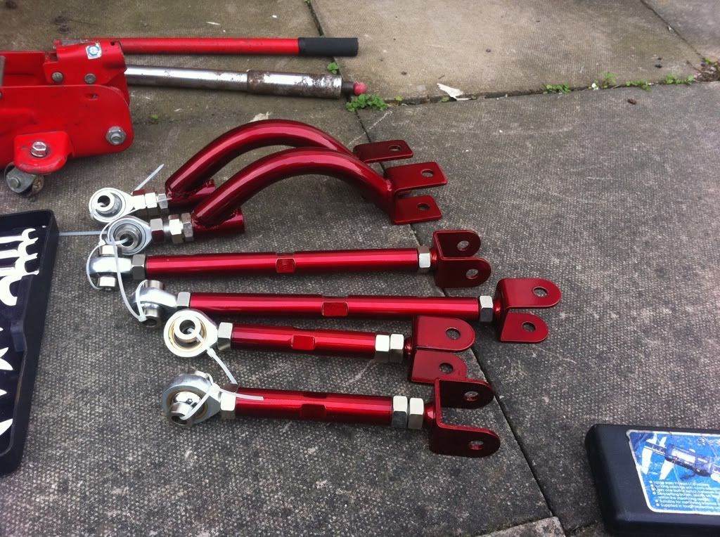

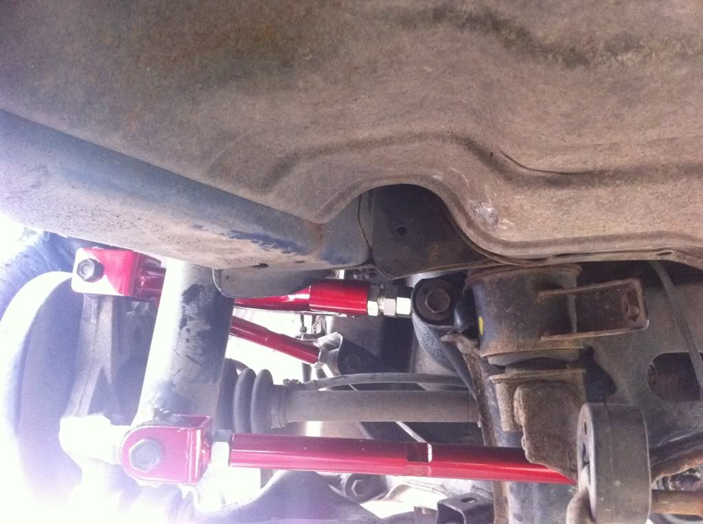

Fitted my adjustable arms and red stuff pads.
Used mr Mitto's settings
Front camber -2.5
Front toe 0
Rear camber -1.5
Rear toe 0
Car handles amazingly now !!!

Drift set up mate try some toe in for fast road/ daily as all 4 of my wheels slightly point out. My 15 is not my daily any more. Plus you don't want -2.5 front camber on a daily you will be chewing tyres!

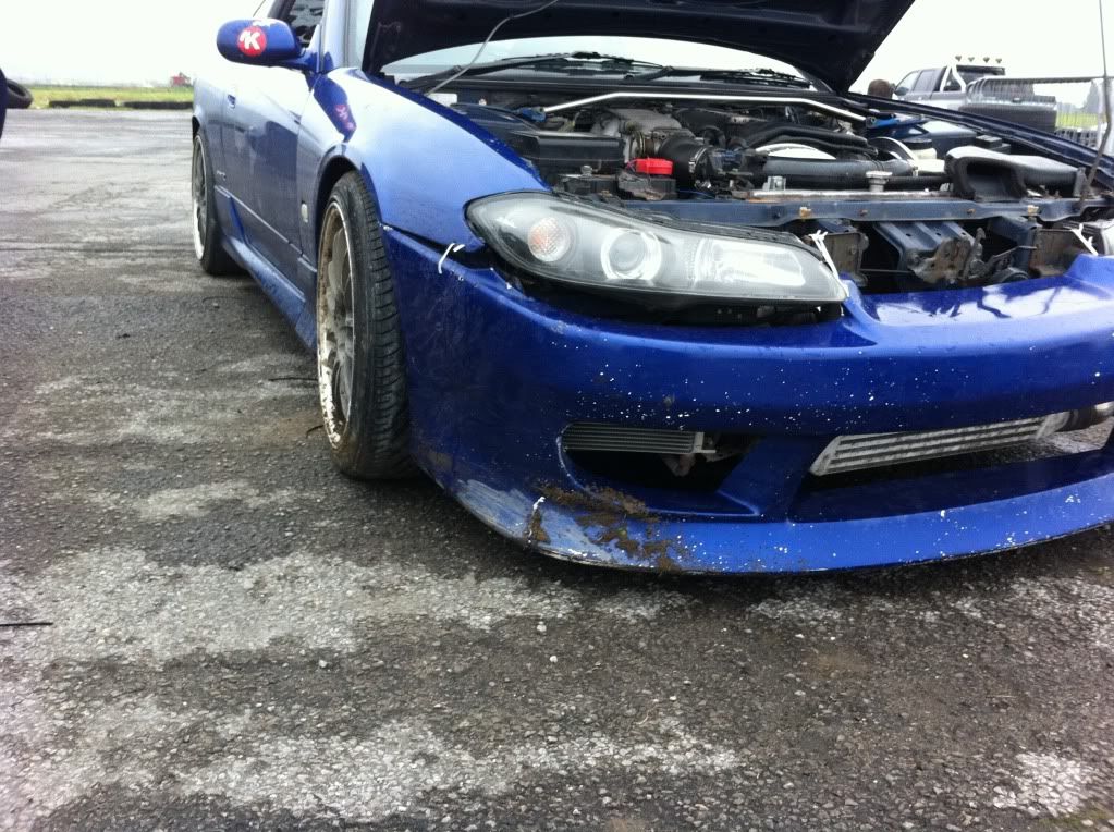

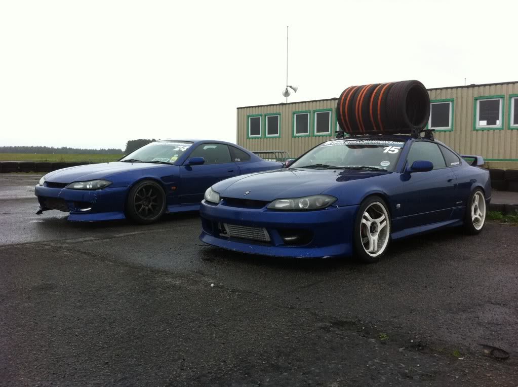

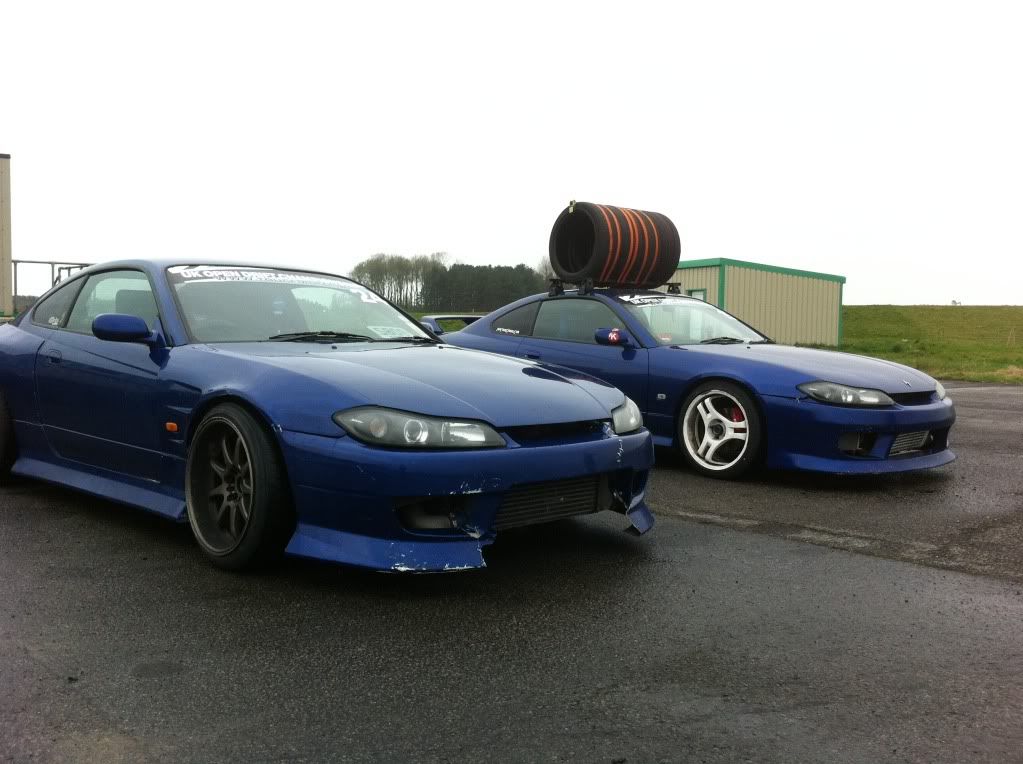

4 cars 1 track 9-5... epic seat time!
oops
Me and Greco twinning
Had to change tyres with no tyre van.....
Was an awesome day! more vids to come!

Sweet dude!! :D Handles nice with the new alignment then? Jealous! :)

Just an american make i think got them from 800BHP via sxoc. Seem sturdy enough. Ordering some dust boots for them aswell.
