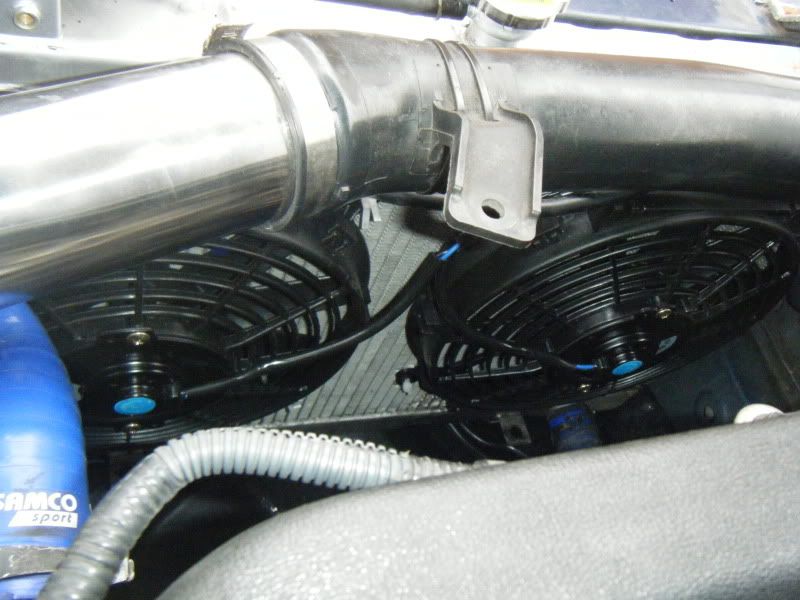

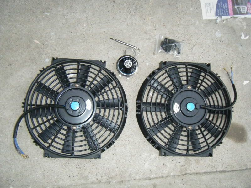

Fans fitted,
Thermostat was **** so i hardwired it to a switch, anyone use a good thermostat?

Chhers craig, well i have put the viscous back in because it was overheating more, However i have wired the fans to a switch in the dash so when i push it on the track it dosent overheat. Worked brilliantly on sat.
so i have the viscous and the twin elec.

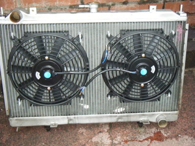

Thats strange. Are your twin elecs definatly both pulling the air through the rad towards the engine rather than pushing it the wrong way? Mine pull so much air through they are only on for about 30secs and they've cooled the water temp by 10C.
contary to popular belief, the viscous fan is very efficient at cooling the car. I believe even more than an electric fan setup, but that may be due to the shroud that goes with it.
Yeah, if you take the shroud off then it would be like p***ing into the wind! The air would just recirculate around the fan and it would do a terrible job. If you have the viscous you NEED the shroud for sure.

My fans are pulling air through the right way, what make are yous? how much do they cost??
Im quite happy with this setup now tbh its best of both. i have extra cooling for when its needed.
Mine are the Apex ones with the alloy shroud. Theres a GB on at the moment on SXOC but you have to buy a rad at the same time to qualify for the cheaper ancillary prices. They were £79 IIRC - thats for both fans, and the alloy shroud.
I paid just over £100 for my twin leccy fans from Japspeed. Got x2 12" fans which fit perfectly within the 50mm Japspeed rad using cable ties (cheers Craig lol) to tie them on. Will replace plastic cable ties for metal ones soon as heard they'll go brittle over time with heat etc.
Yep the viscous is out now, so is shroud and as Craig tested for me, when it hits 90 deg using stock thermostat, the coolant temp is reduced back down to 85 deg within a minute easy so it's obviously working well. And that's when she's stood still idling!! :thumbs:
