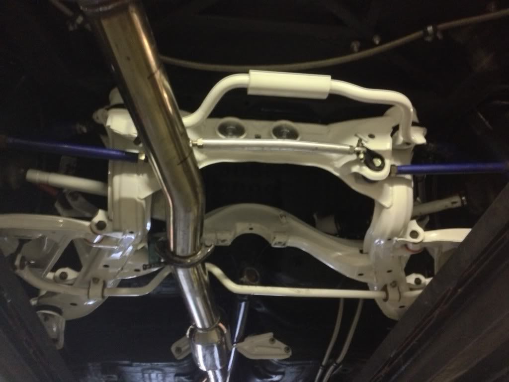

Some updates, went to fit the rear brakes the other day:
Those with sharp eyes will spot the difference:
(The top left hand bleed nipple on the right hand side caliper is missing) spoke to the company and they will hopefully be getting one sent out too me, honestly no affence to any companies on here... But all the ones I seem to deal with I have nothing but problems! It's always two steps forward one step back!

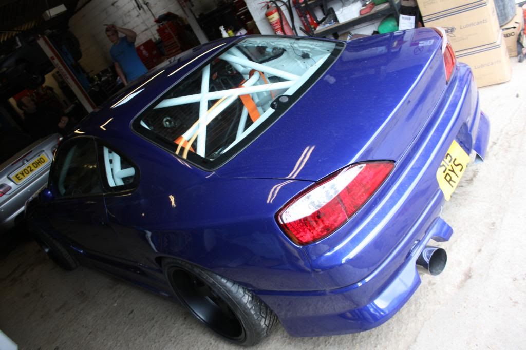

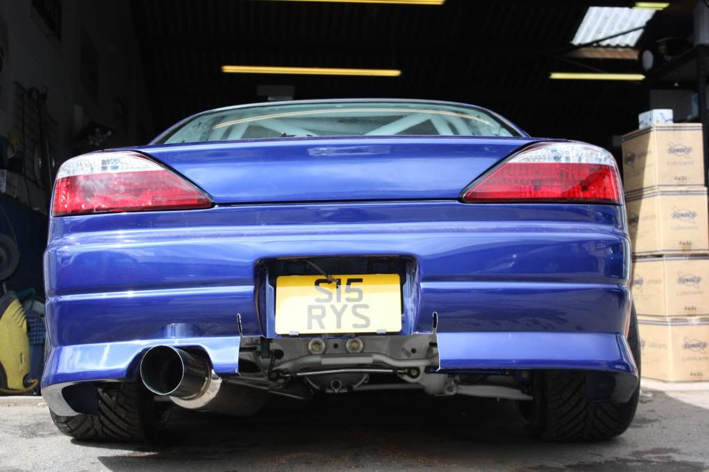

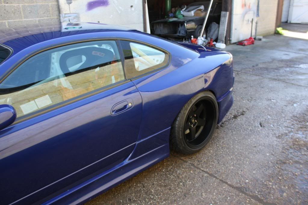

got the car out the workshop today as we where having a move around so took it as an opertunity to take a few pictures of how the cars sitting:
enjoy
23 July 2010
877
SW London
I've never been a fan of kits on the S15 but that does look pretty good. Those are pretty much the only Rota's that look good in those particular sizes too.

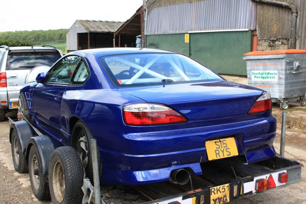

Been a pretty hectic week last week had to get the car ready Togo to dyno tuner, as he rest of the work is now being carried out there, wist I'm n holiday in Greece the wiring will be taken care of, and hopefully the ne forged engine will be ready for when I return so I can go down and swap them over, I have order'd a link G4 Ecu which will take two weeks to come and a AIM strada digi dash board, so cars now finished minus the engine swap wiring and mapping, it won't be coming back to me till its running,but I will be up there doing some of the work myself, dropped the car off last Saturday, here's some photos of the outside basically complete minus rear diffuser:
We cut the tank apart, added two baffle plates and a sloping floor to the pickup point! No pictures of this, but also added a ATL fuel probe etc, pictures of the boot almost finished awaiting a lift pump and filter:
Propshaft arrived and fitted:

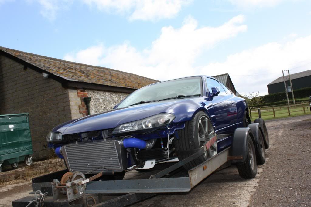

Pictures from the drive, was a pig to get the car on the trailer as the wheel setup I run made the car a lot wider then the trailer, so spent a good few others finding wheels that would clear the big brakes, the coilovers etc took a few slip on spacers and various wheels but it went on in the end!

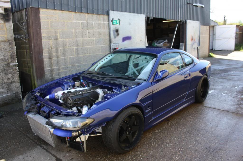

Right looks like I've been slacking with the updates again! Got the car back from mappers last Thursdays around midnight after what was a very long day!
Limped it down to Farnham for full alignment.. Then have spent the last four days clocking up 400 miles and I've now dropped the car off for further mapping on high boost and an oil change last night, hopefully to get it back end of the week.
Car was running around 447bhp and felt AWSOME, handling was also spot in after alignment.. I really can't described just how well this car grips.. Only gear it really spins up is 1st.
Will hopefully be coming back around 500+ next week with similar torque.

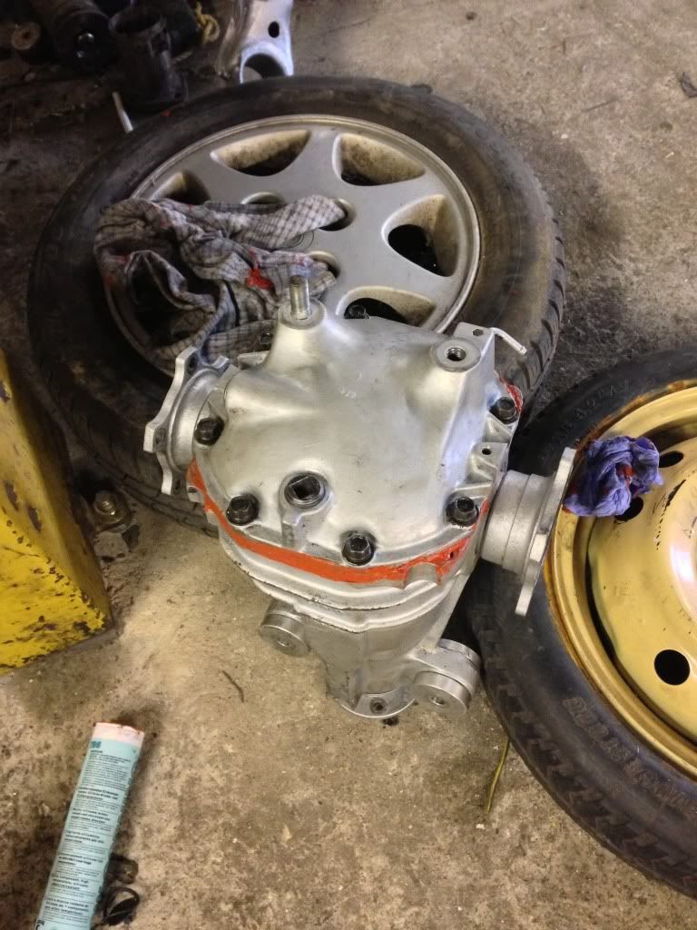

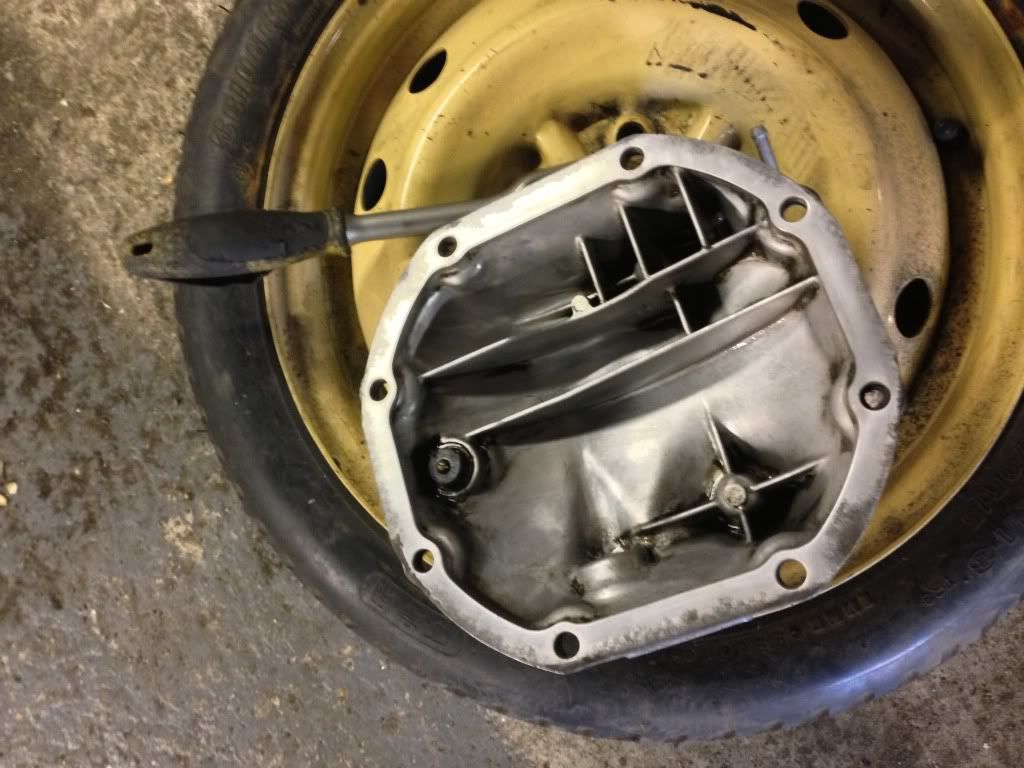

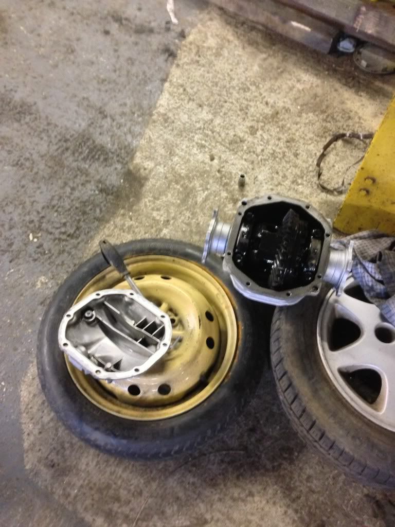

Removed the rear diff:
Checked it all, cleaned the seal surfaces, checked the level and topped it up:
All sealed up, went abit mental on sealant:

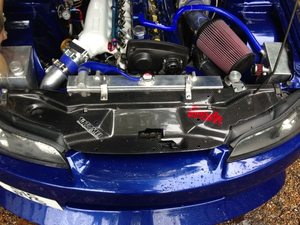

Picture of the carbon cooling panel:

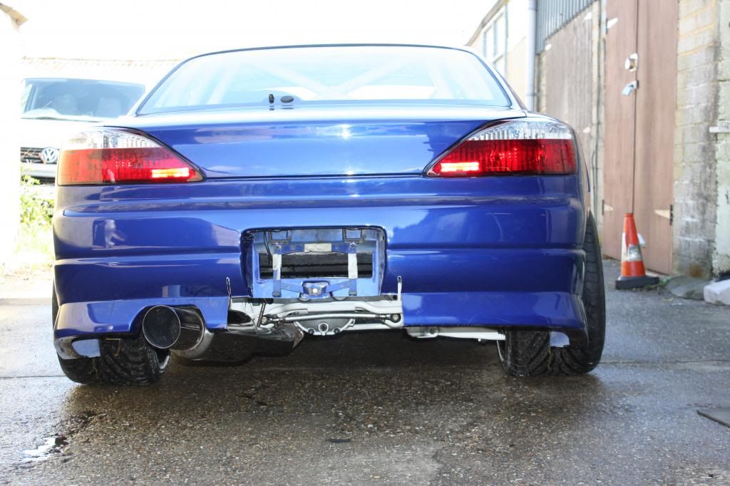

Couple of pictures others took of my car on the day:

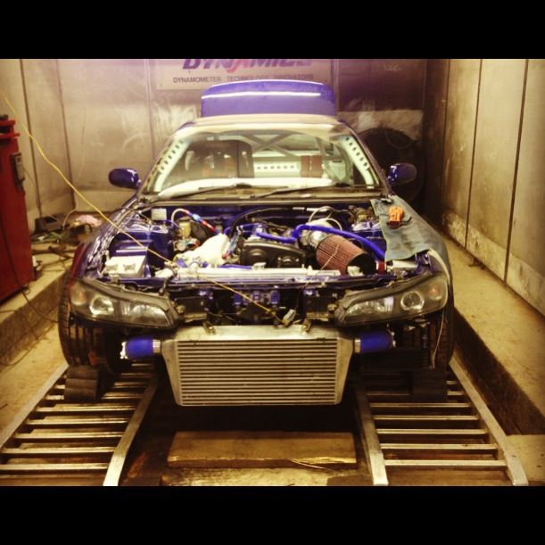

Picture if it on the dyno last week:

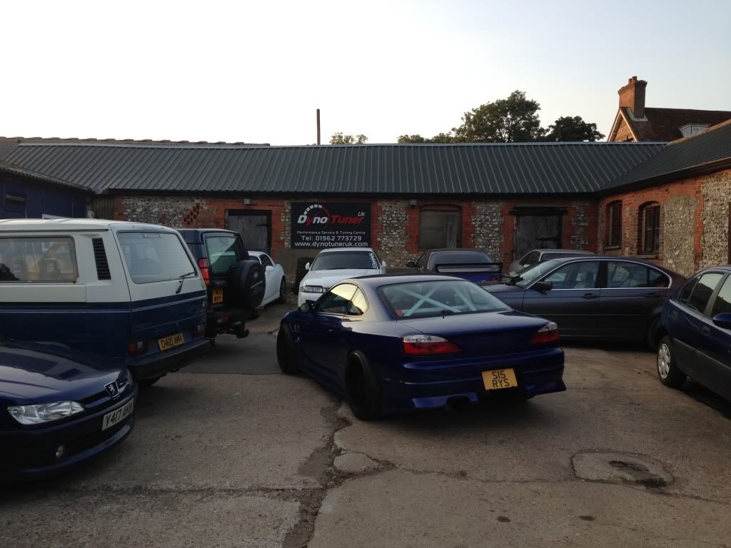

And lastly a picture of it now left at dyno tuner:
Really didnt want to take it back! Has been such a good past 4 days of finally driving the car after almost two years worth of building! And the car was absolutely faultless, not one thing needed changing was very impressed by every aspect of it, and the grip round corners from the roll correction knuckles truly are something else!

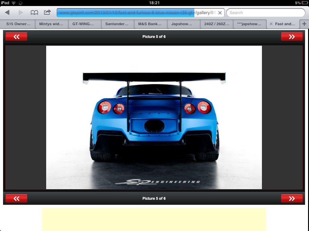

Thanks guys, yeah needs the rear diffuser fitting still and a custom spoiler I'm thinking of making something along the lines of the Ben sopra ones as show on their 180sx and r35 skyline:
Ill make it easy to remove whilst leaving the rear bumper on and hopefully curve the spoiler legs enough to still be able to open and close the boot :)

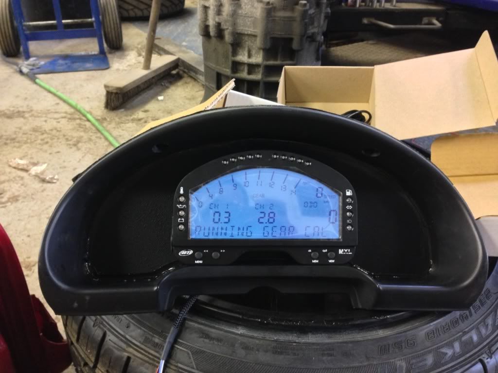

Picture of the digi dash I bought.. Then made it fit, very impressed with this dash... There's not alot it can't so and means no need for any gauges at all!
Picture of it turned on:

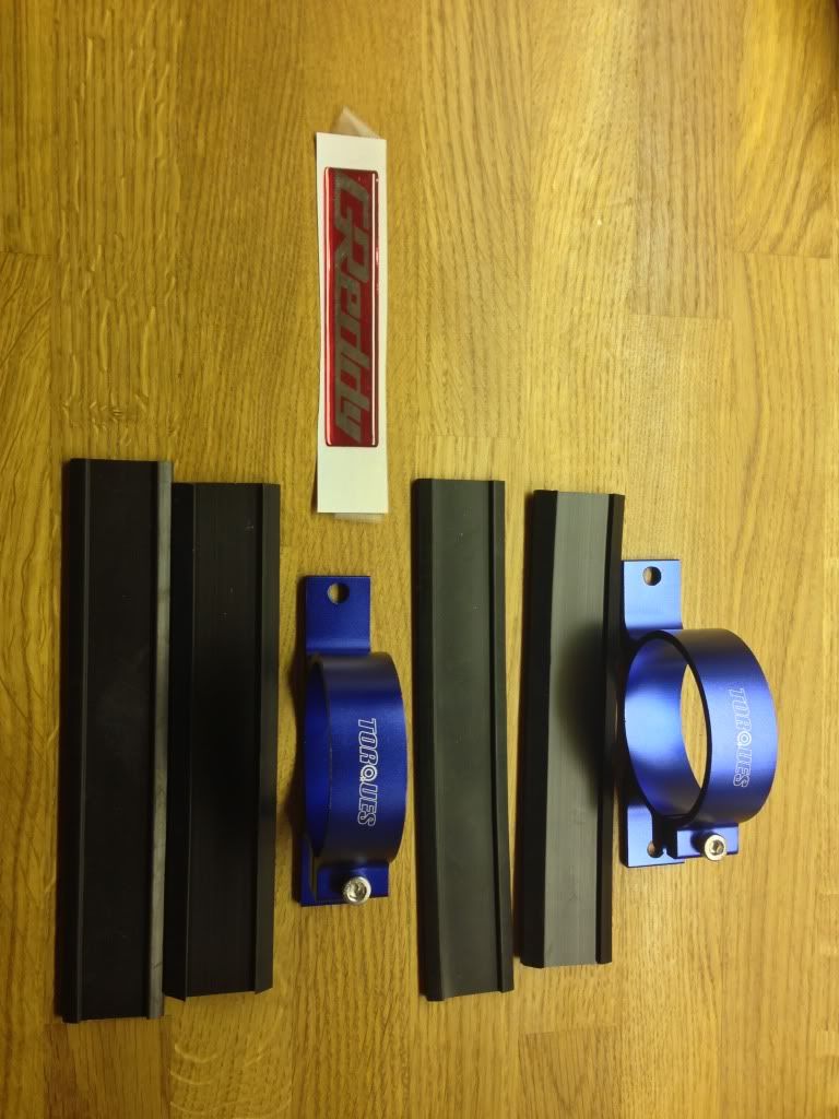

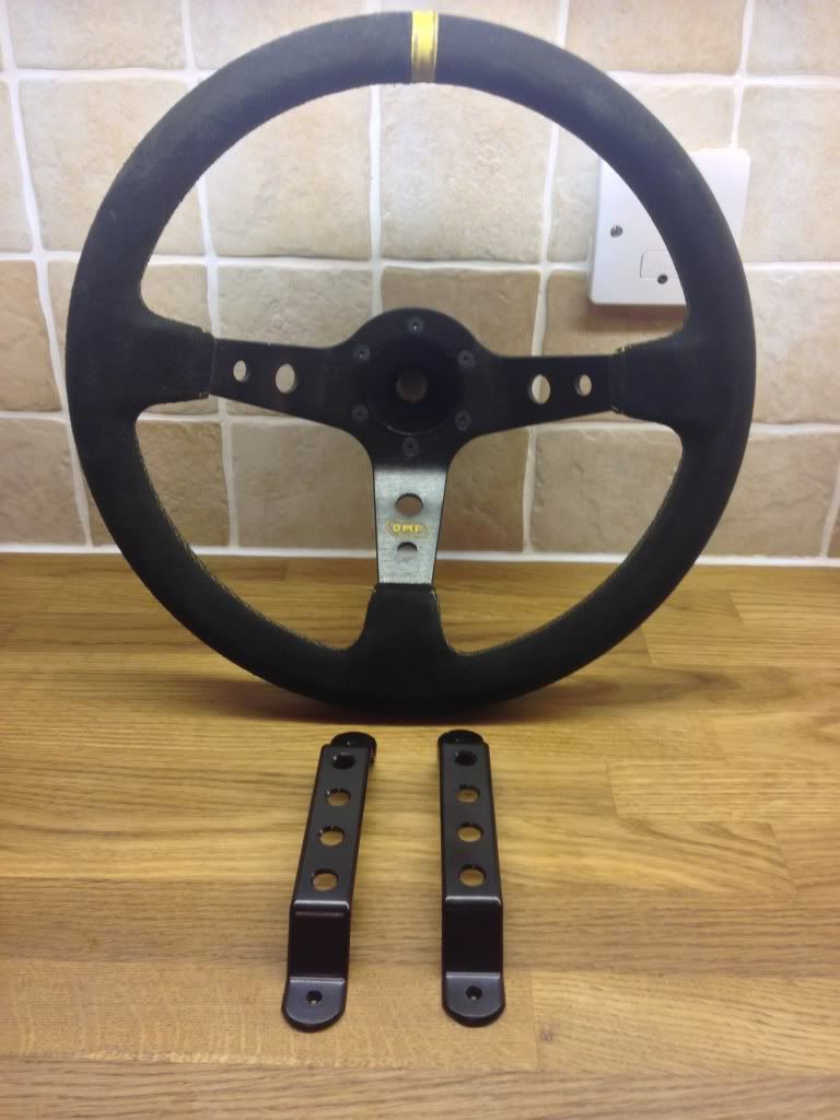

Low pressure fuel pump brackets turned up today (as I've been running the car without them at present) and also a greddy badge for my inlet manifold:
Will fit once cars back from mappers
