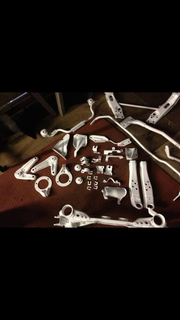

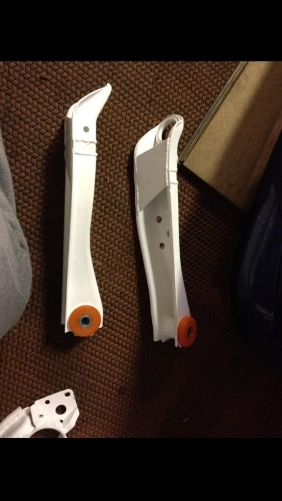

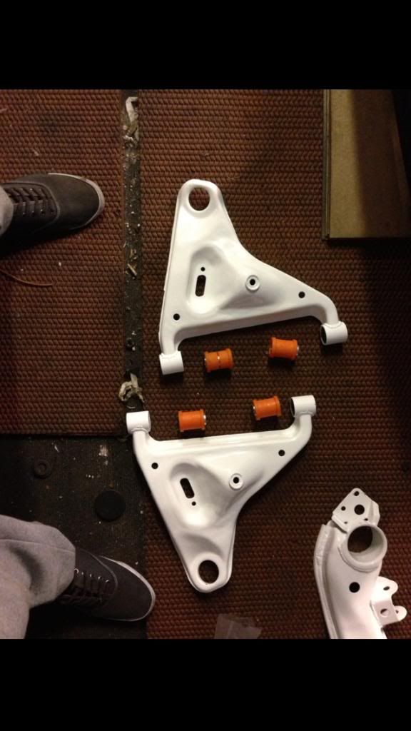

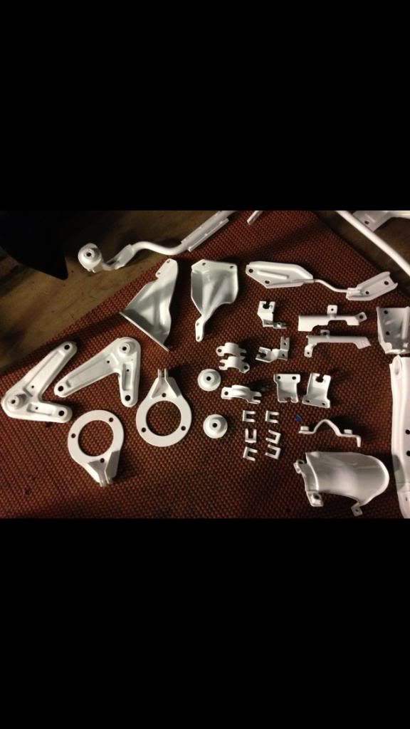

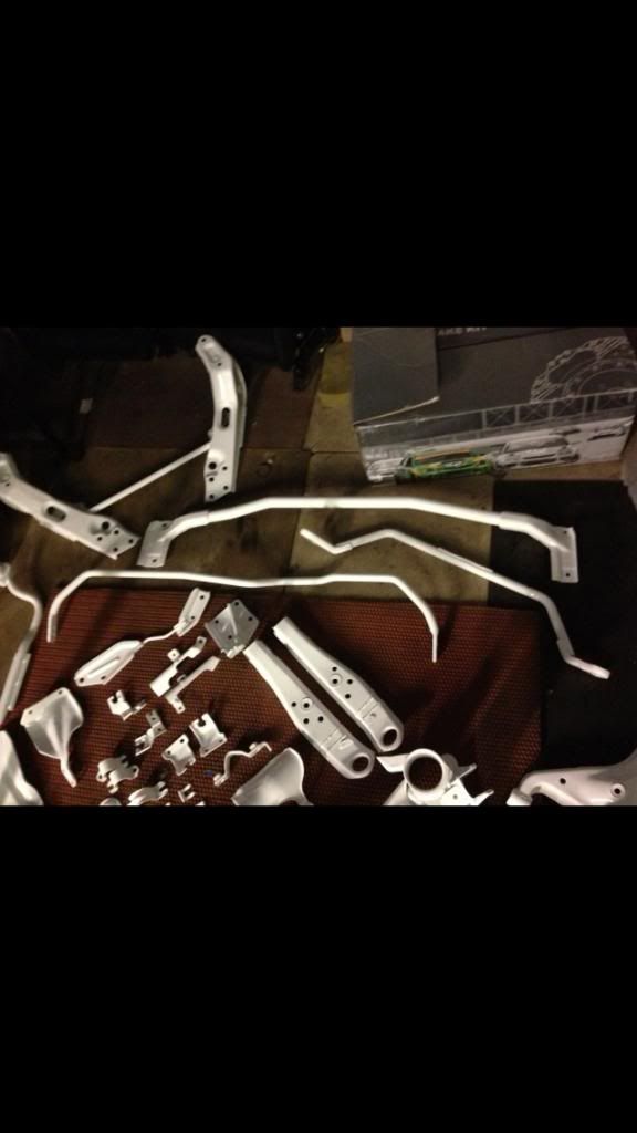

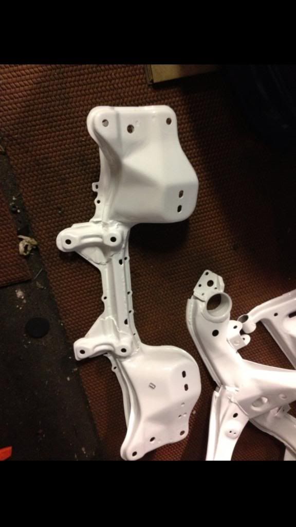

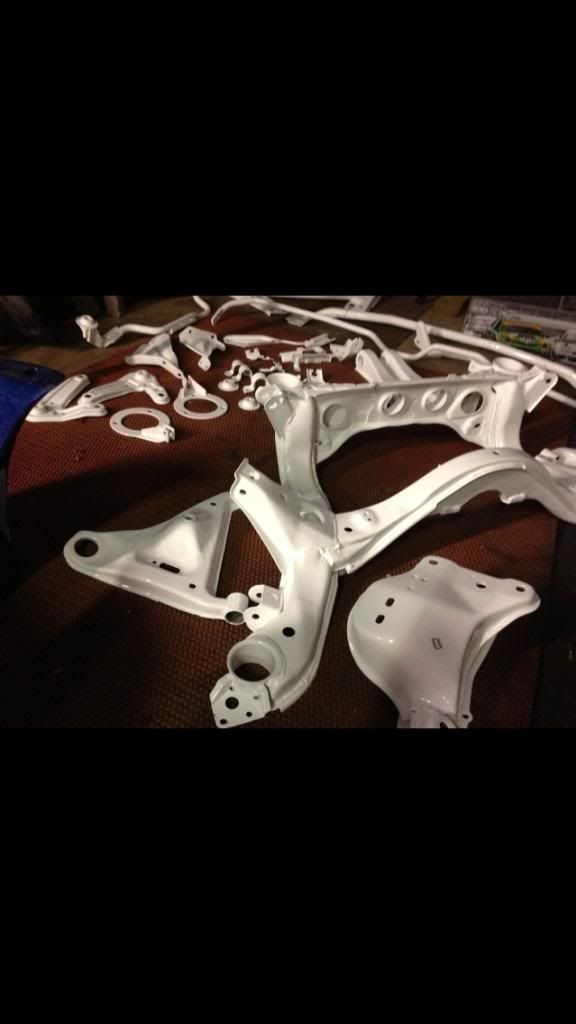

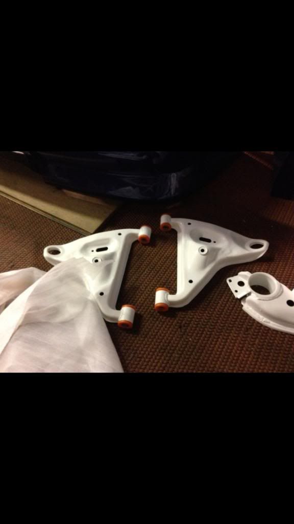

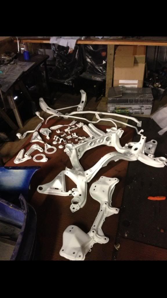

Picked this lot up from the powder coater's today super impressed and the price was spot on tbh.
Started fitting bushes:
Had to leave he unit so will finish next time I'm up there, havnt heard anything on my bolts yet so don't think there ready so isn't much I can do until they are.

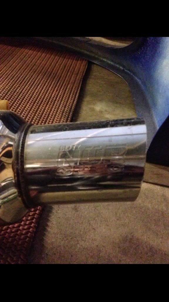

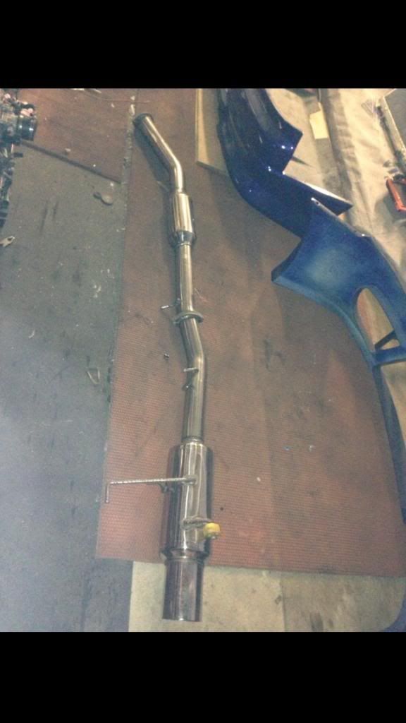

Picture of my new exhaust:
