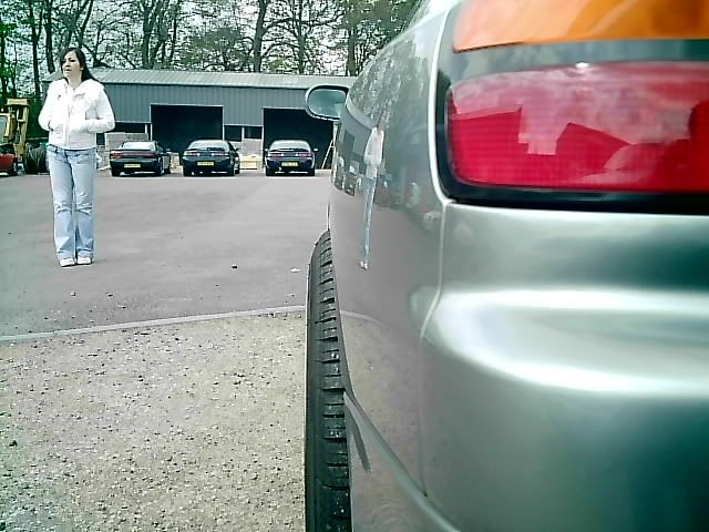

Once i had the camber adjusted it pushed the wheels out a good bit (pic below), as a result i was pulled by the police (1st time in the S15) and given 7days to change or alter the wheels as they were illegal. I went for the 8j +35's all round i have now.
