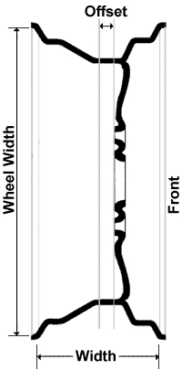

Below are a few of good fitments to show everyone what you can actually fit to the stock guards since everyone is so afraid to run lower offsets on their rides. I made this mistake and is regretting now! However this post is only showing what fits flush(my term of flush is top rim is very near the guards and bottom rim is sticking
alittle out) Hope everyone can learn from this post of what you can and cannot fit.
All the cars below are running at stock guards rolled unless specified.

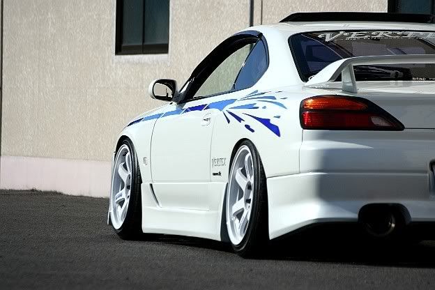

I'm sure some of you have seen ben's (SpecS15) s15. imho his has the best fitting

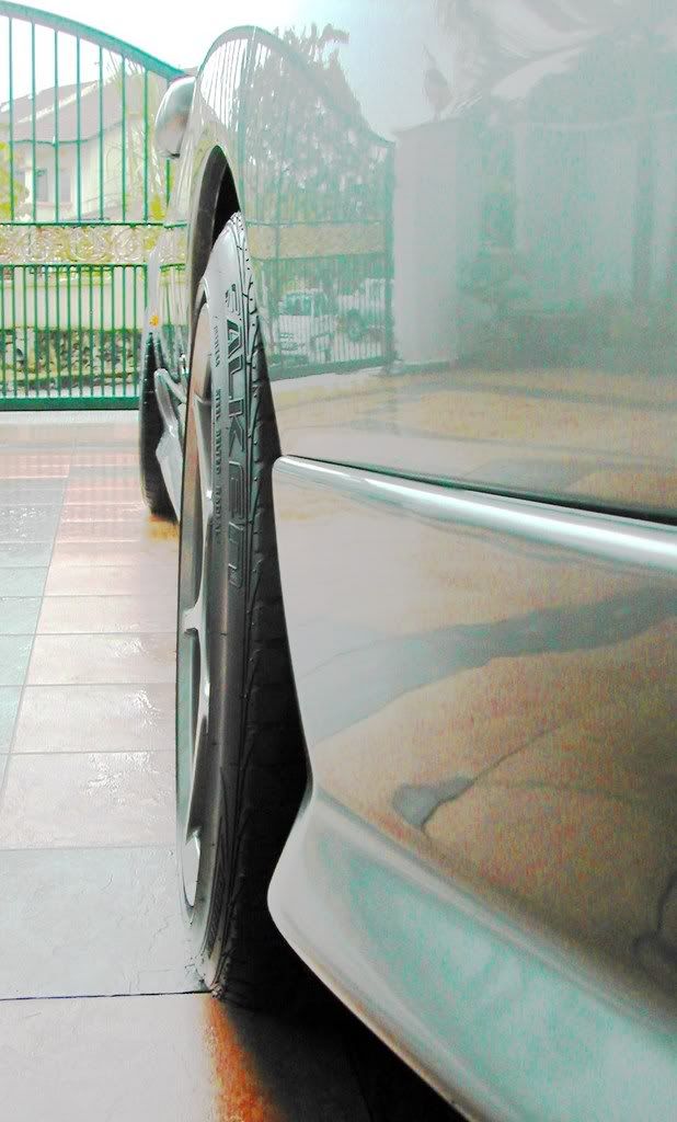

Wheels spec:
F 9J x 18 Offset +22 -2.5camber Tyres:225/40/18
R 10J x 18 Offset +25 -1.0camber Tyres: 255/35/18

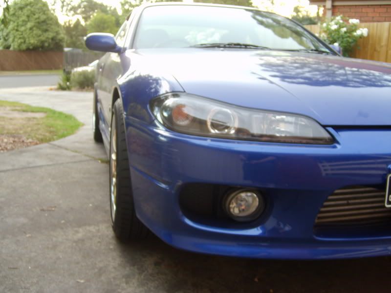

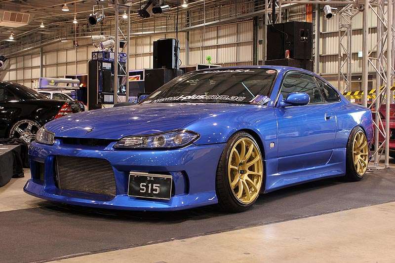

Wheels spec:
F 9J x 17 Offset +28 -3.0camber Tyres: 215/45/17
R 9J x 17 Offset +17 -2.0camber Tyres: 215/40/17

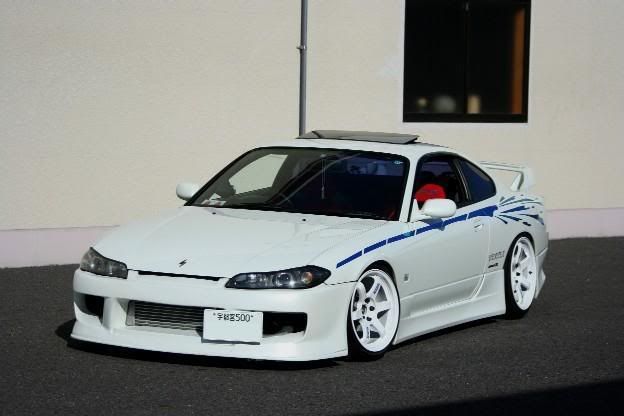

Wheels spec:
F 9J x 18 Offset +24 Tyres: 225/40/18
R 10J x 18 Offset +34 Tyres: 235/40/18
(The front protrudes abit, wider front arches will fix that but I still like it

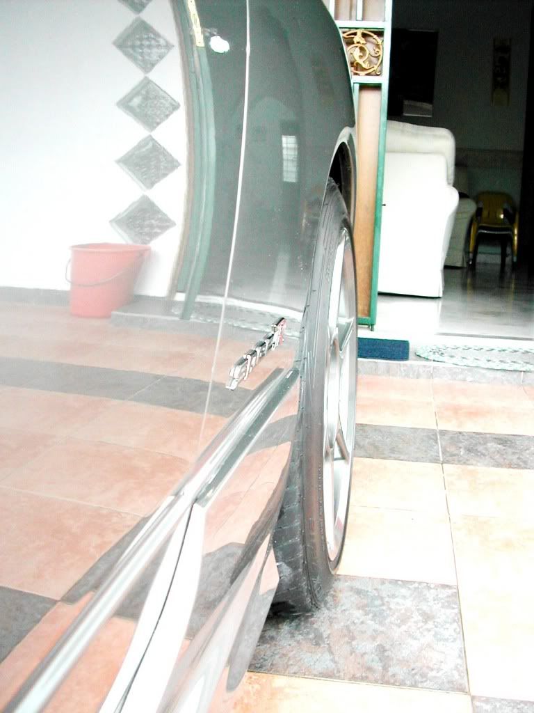

Wheels spec:
F 8J x 18 Offset +29 Tyres: 235/40/18
R 9J x 18 Offset +32 Tyres: 255/40/18

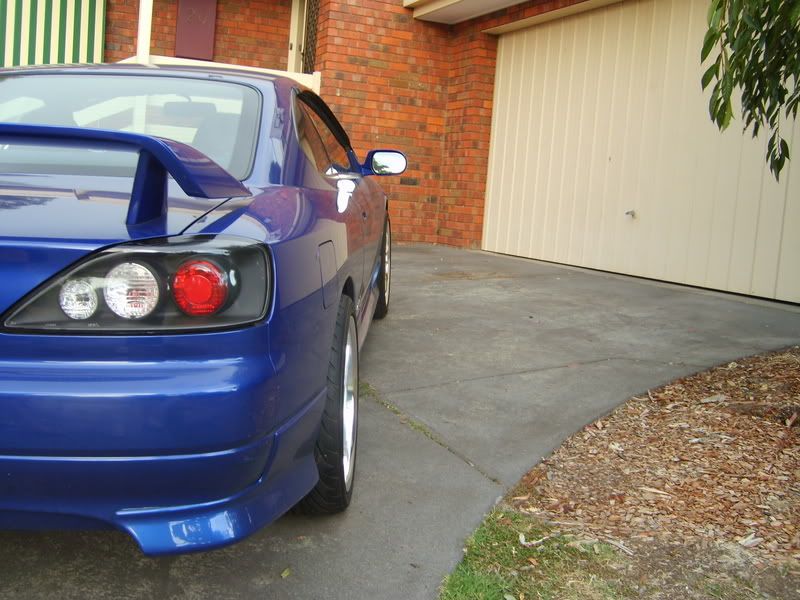

Wheels spec:
F 9J x 17 Offset +22
R 9.5J x 18 Offset +22
^^Not 100% sure but I reckon that's what it's running
