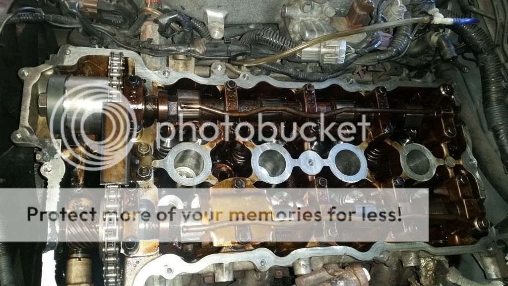

Just more maintenance to report, had the VTC sprocket replaced as it was sounding like a tractor. Took a pic this time as I can also see my shinny Brian Crower Valve springs and Titanium retainers I had fitted last year (didn't get a pic at the time).

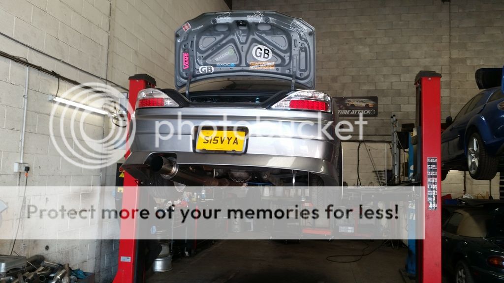

Boring update really, its MOT time so getting a full service done at the same time. Oil return was leaking from the top side so good job really as I didn't even notice that until we got it up on the lift.

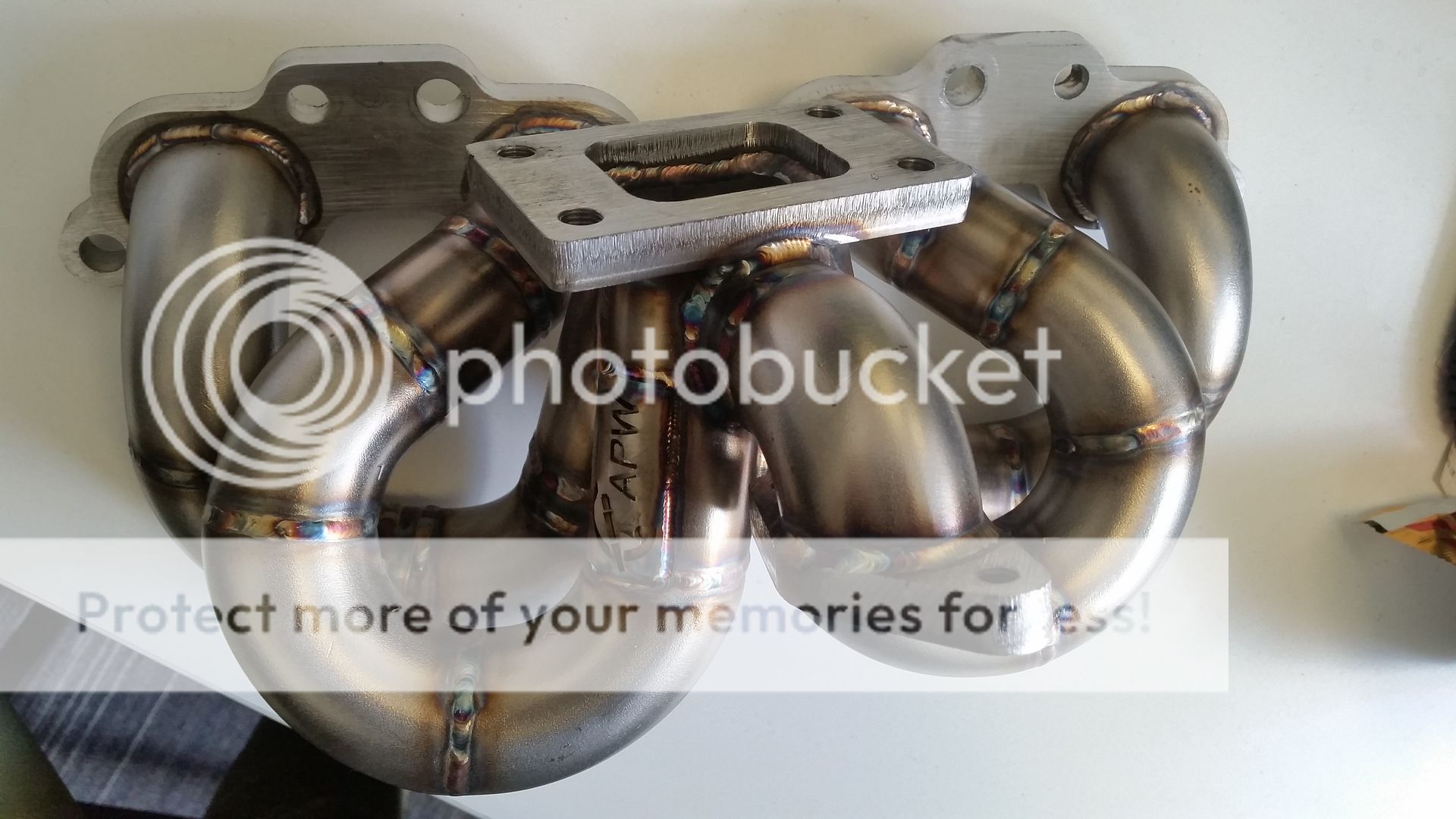

OK small update, Andy at APW did me his custom T3 top mount manifold, very impressed with it and life time guarantee :)

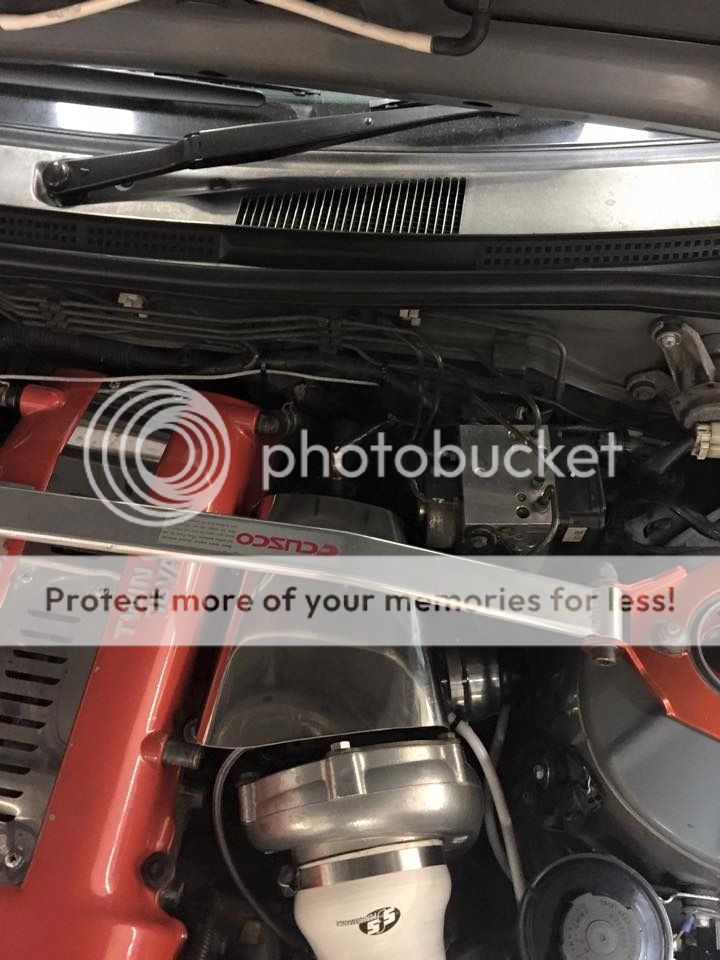

While it was off the car, I also got it ceramic coated in white by Camcoat in Warrington. The plan was to install it next year, but my turbo strung a leak, one of the bolts had sheared the tread, so when hot it was leaking. It was a turbo off job so thought might as well get it all done at the same time.
My usual guy Graham at DCMS did all the fab work as the turbo moved forward with the new setup so we could now fit a 3" down pipe, so he remade it all for me (down pipe, scream pipe, wastegate, heat shield, and re position the air filter).
Picked it up last night, and it dose feel more responsive now. The main reason was to get rid of the cheap Japspeed manifold as it used to blow gaskets all the time, so done it properly this time around.
I checked with Andy about coating the manifold and he recommended.
