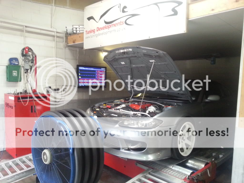

Still trying to find out why my car keep spluttering when launching, so I've had the vacuum/boost system smoke tested and its fine, and plugs changed.
So next idea was to get it on the rolling road and check the map/fuel/air etc, which all looked fine from the RR feedback
I took the s15 to Tuning Developments in Warrington, which is nice and close to me. Once on the RR they could get it to splutter around 2nd gear on boost. I did mention that my splitfire coilpacks have probably seen better days, as they are 3 years old now and were 2nd had the time. They took the coilpacks out and patched them best they could with this high intense tape which has fixed coilpacks for them in the past. So we put it back on the RR and we couldn't get it to play up so things were looking good, but on taking it out on the road and launching it, still the same :no:
So hence my thread about coilpacks. Everything else has been changed/checked, only other thing it could be is my loom breaking down!
Some pic of it on the RR
Only an inch left, clearance wise!

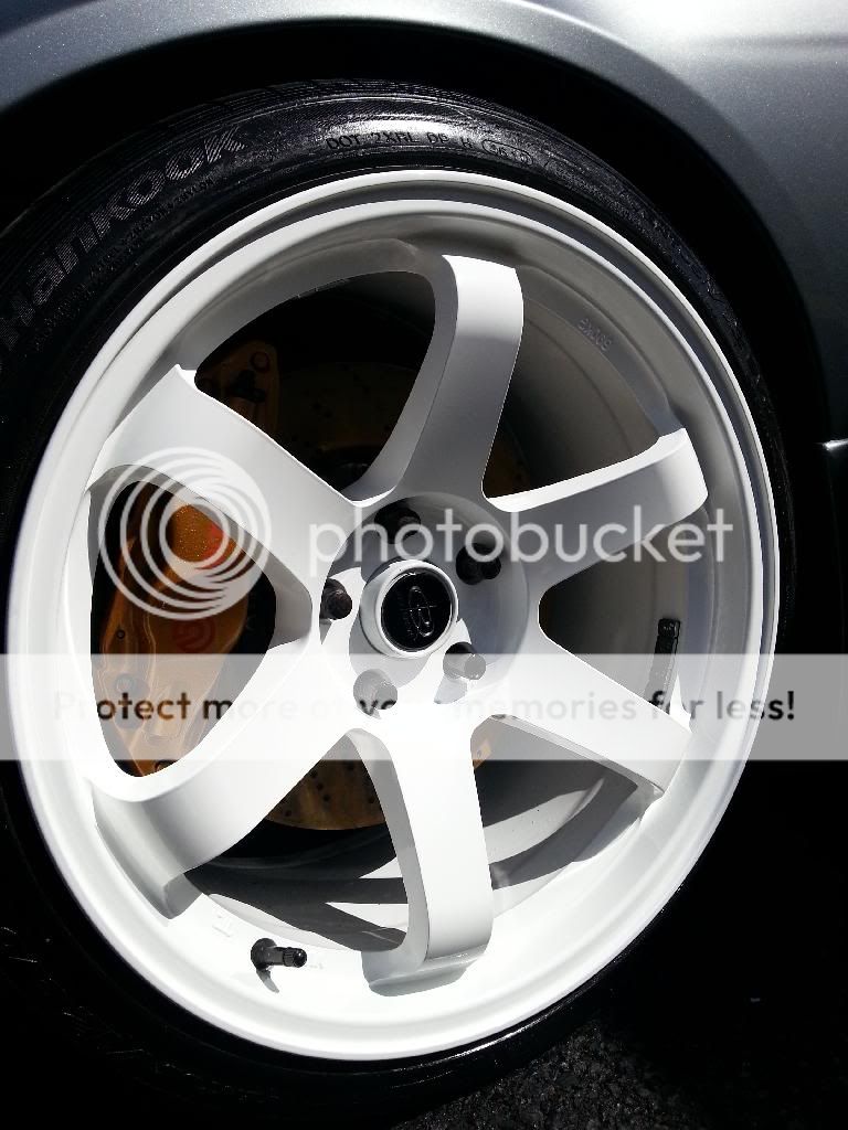

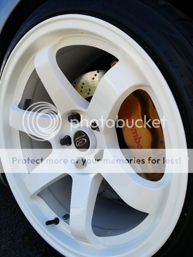

A little update, had all my wheels refurbished last week. Brilliant job they are like new!

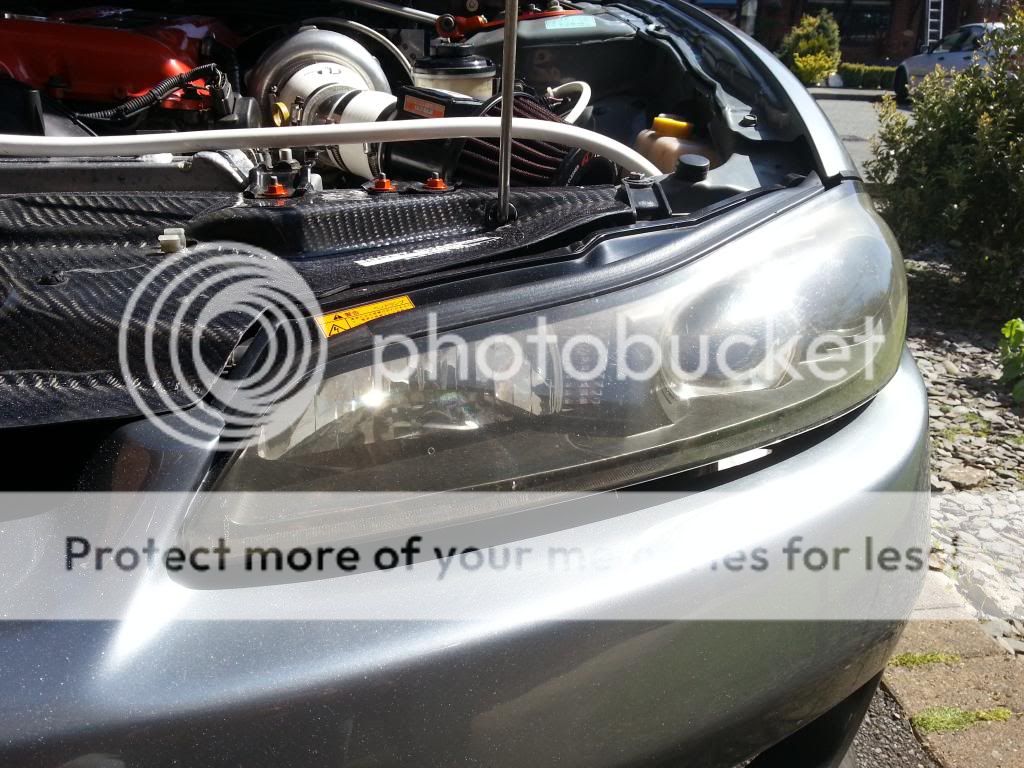

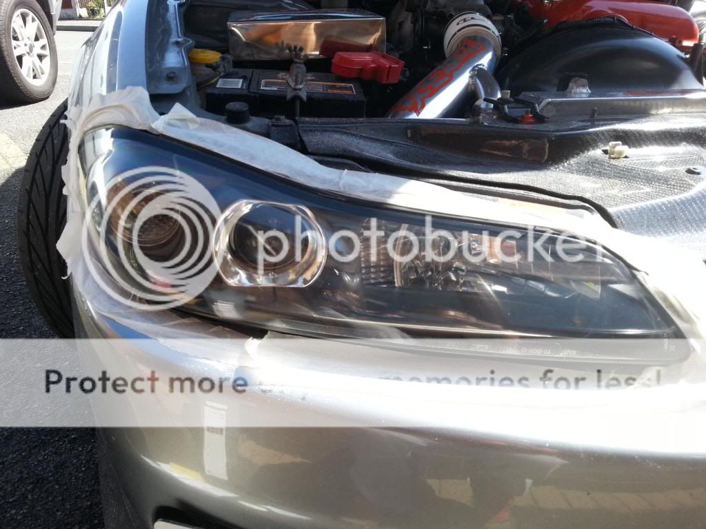

Another clean up job I've been meaning to do for a while, headlight restoration..
Before
After

What did you use for the headlights?
3M do a lens restore kit, I've had it for ages just never got around to doing it. I will have a look now what it was and post it up

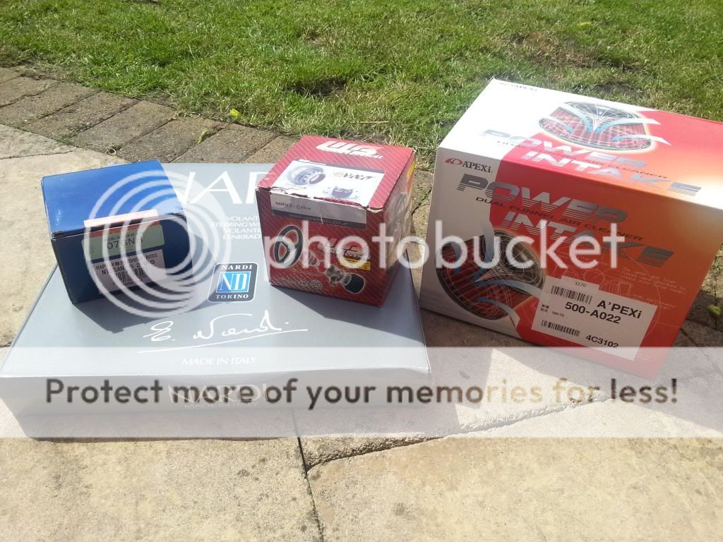

Goodies :)
Final decided on my steering wheel setup, most parts have been bought from guys on here so thanks :thumbs:
Nardi Classic Black Leather 330mm (shallow version)
Works Bell Short hub
Works Bell Rapfix 2 - Yoshioka Special Edition
New Apexi filter
